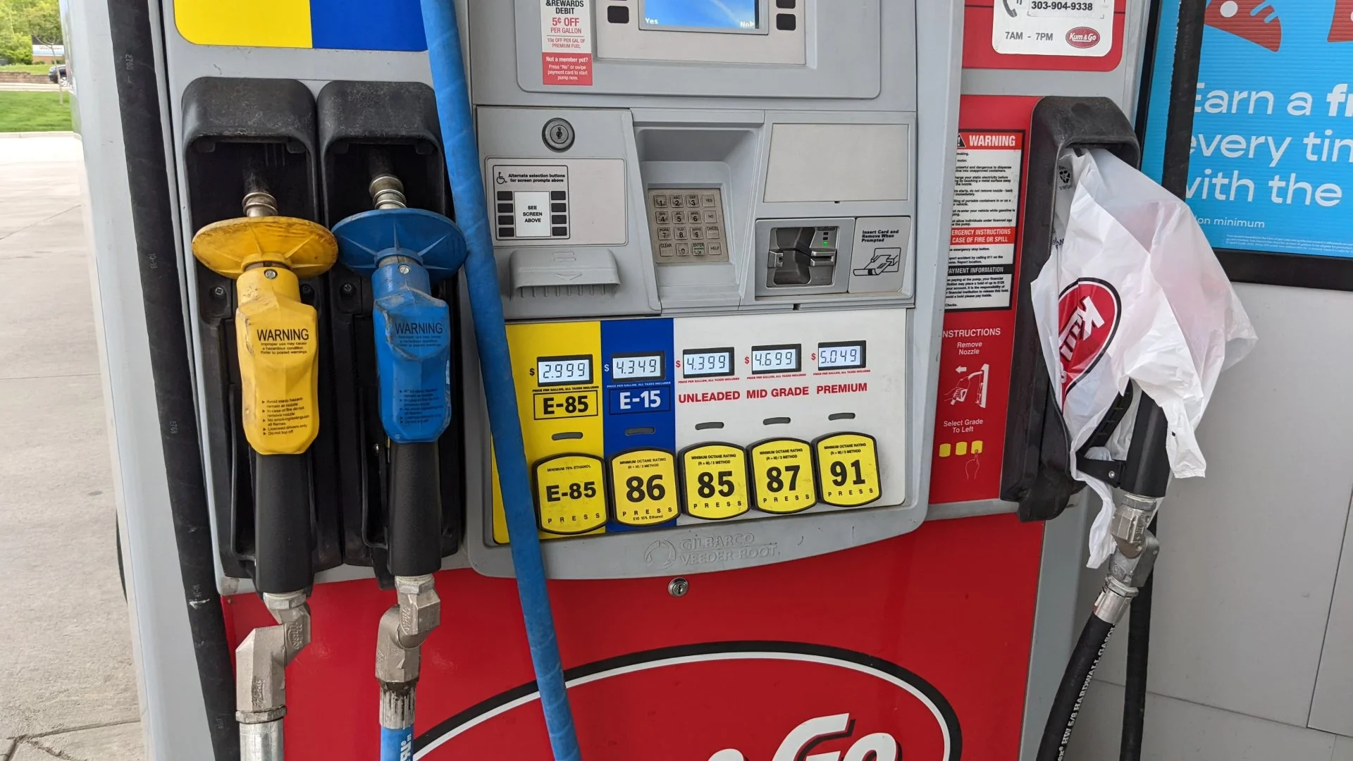

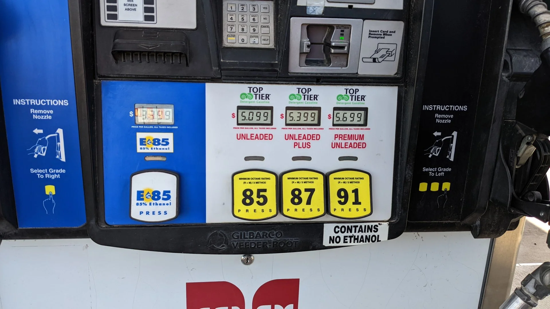

$2 difference between E85 and 91 Premium per gallon. $1.40 between E85 and Regular. Please keep spreading E85 rumors so nobody else uses it and it stays cheap 😂

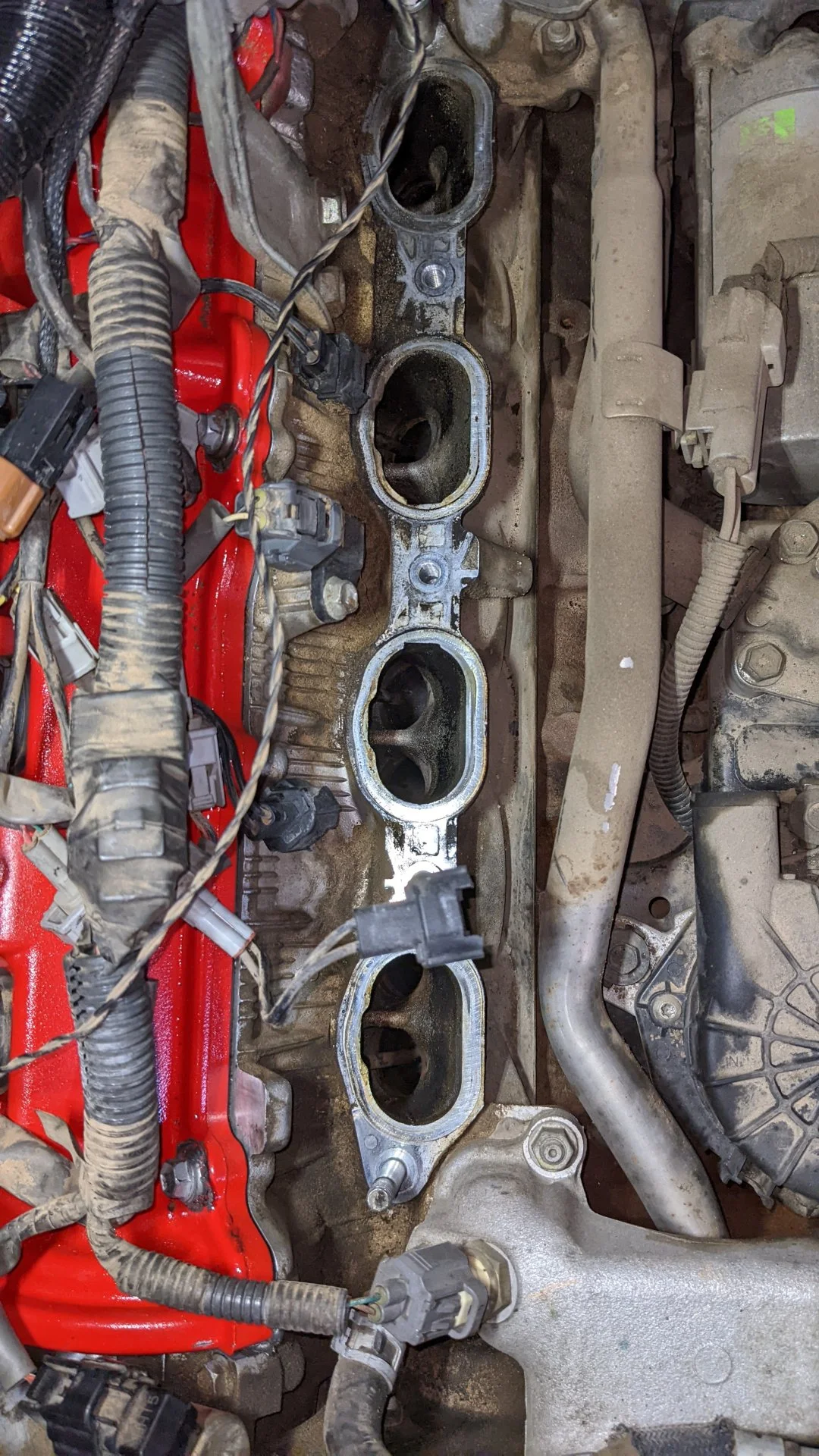

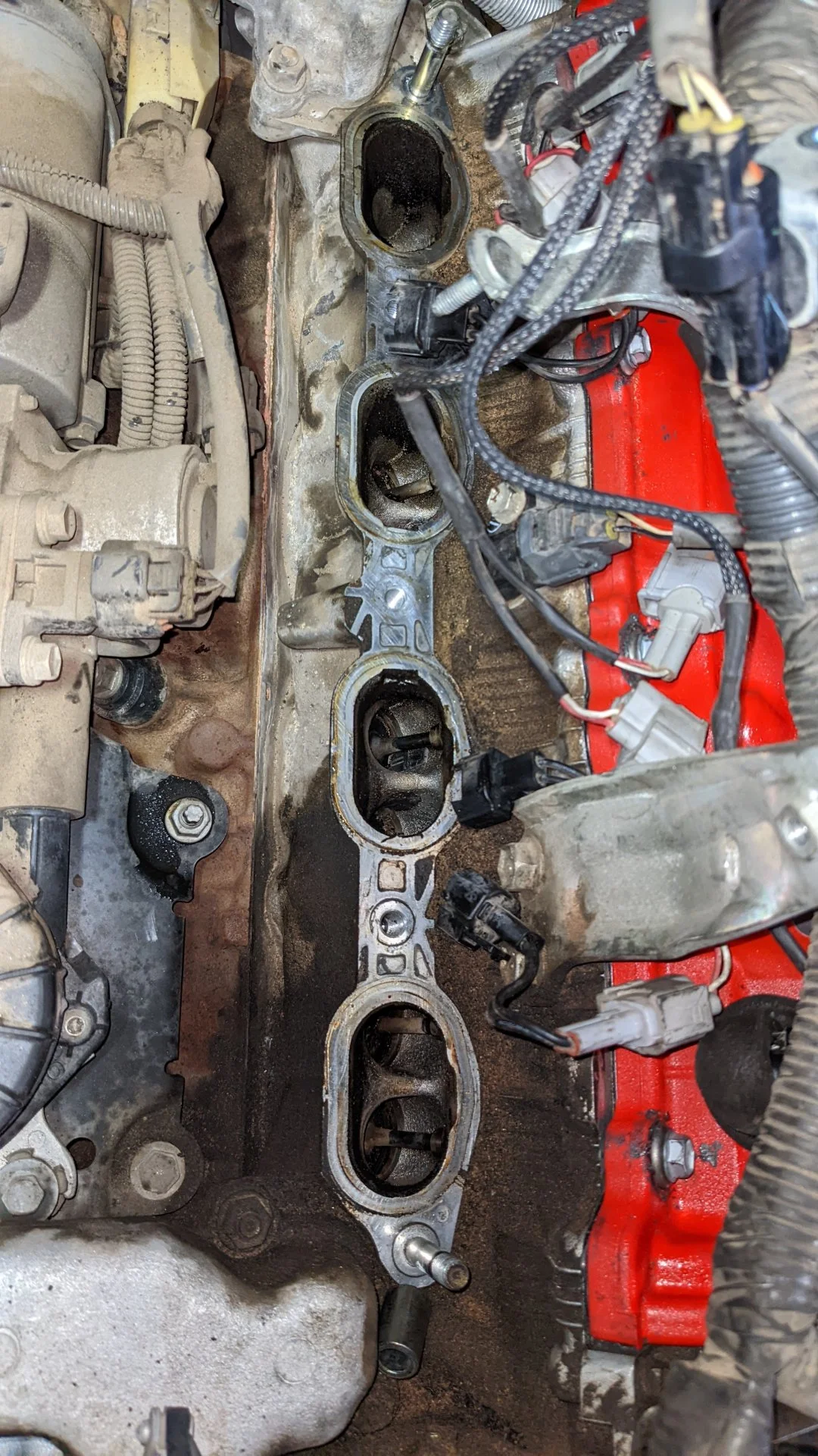

Pulled my intake manifold for some fun time and check out my ports. This truck had 200k on it before I got it on gasoline then I ran the last 80k on mostly E85. Self cleaning action of E85. In another 80k it will probably be almost clear. Pistons should also be cleaning up.
