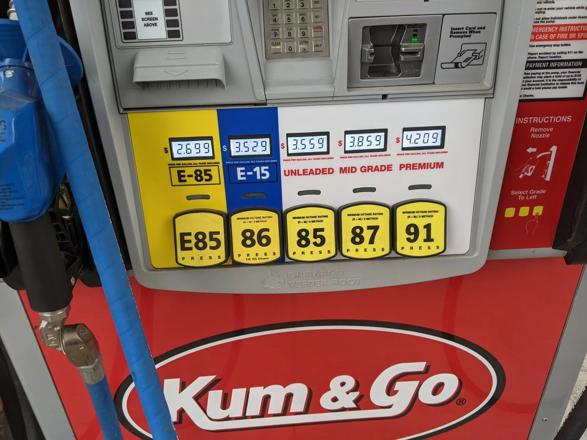

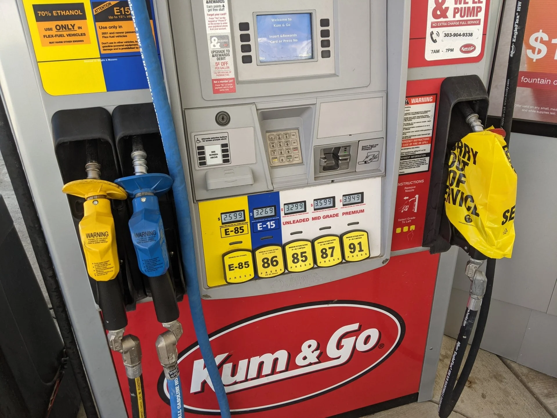

Never would have thought I would be so happy to have an E85 conversion kit as I am now. Gas shortage? High prices? E85 still cheap and available.
84 cent delta! When I was calculating my savings I was using 40 cent delta between E85 and 85-octane regular gas.
Gas pumps out of order, E85 still full.
