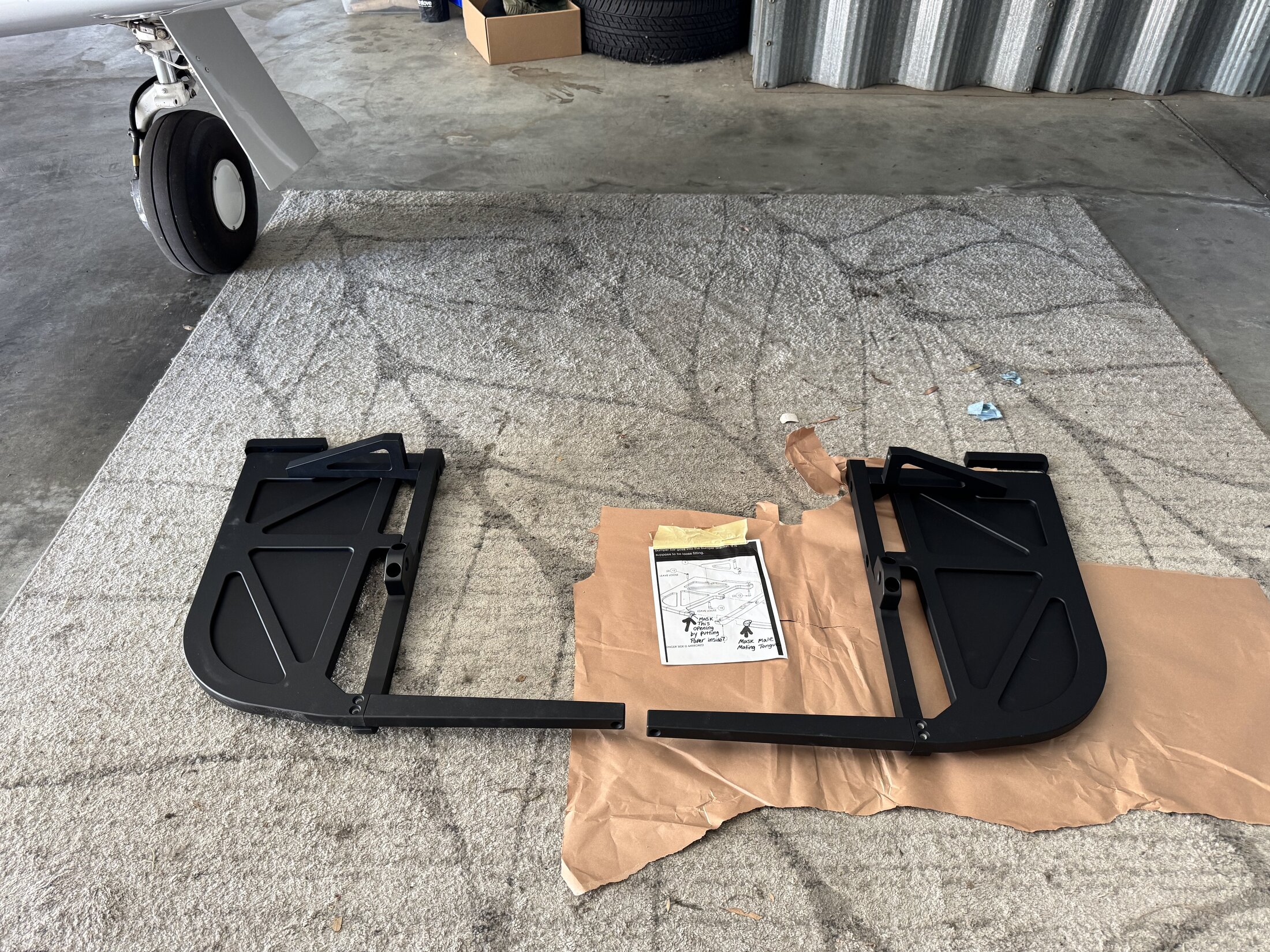

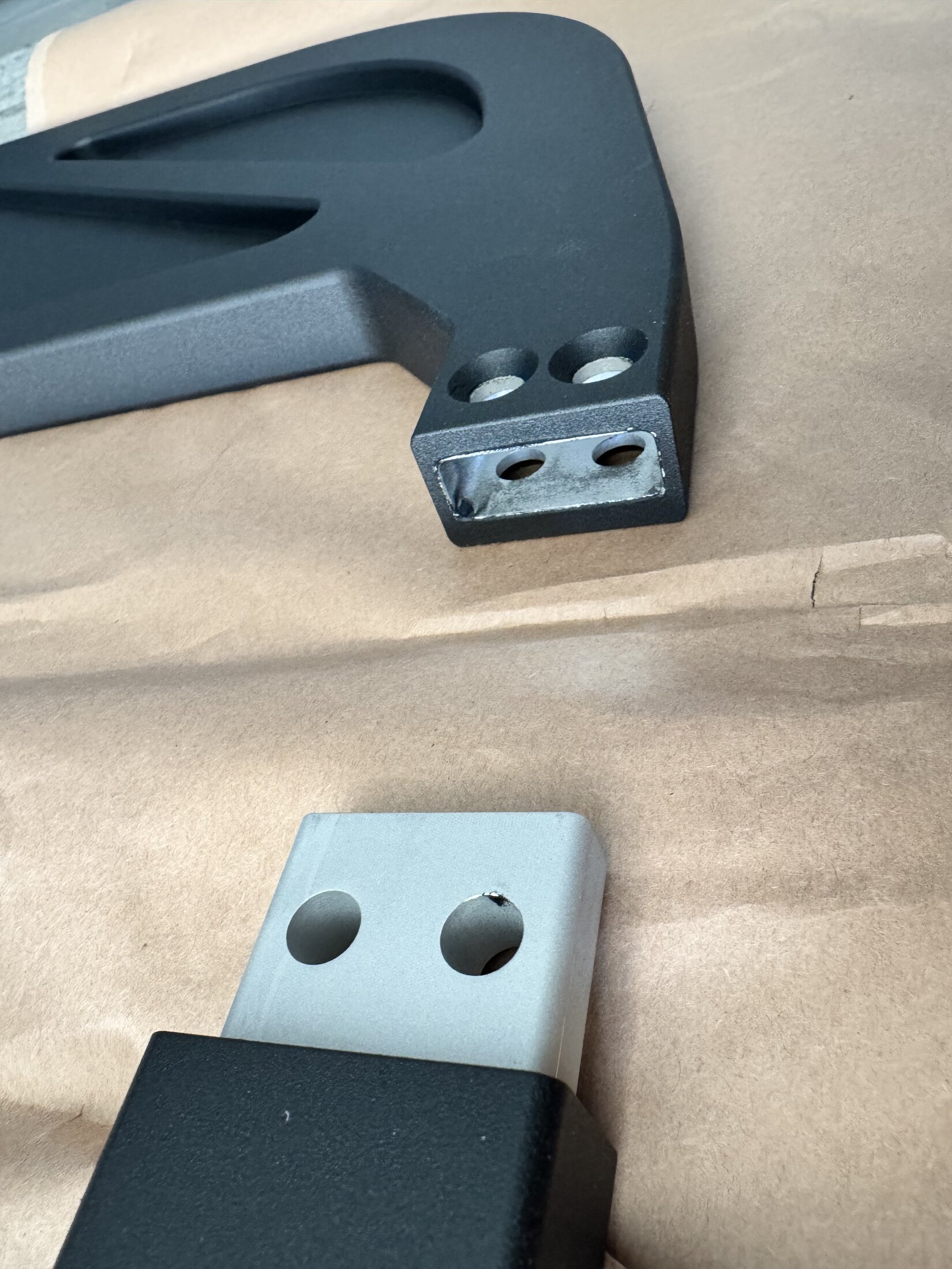

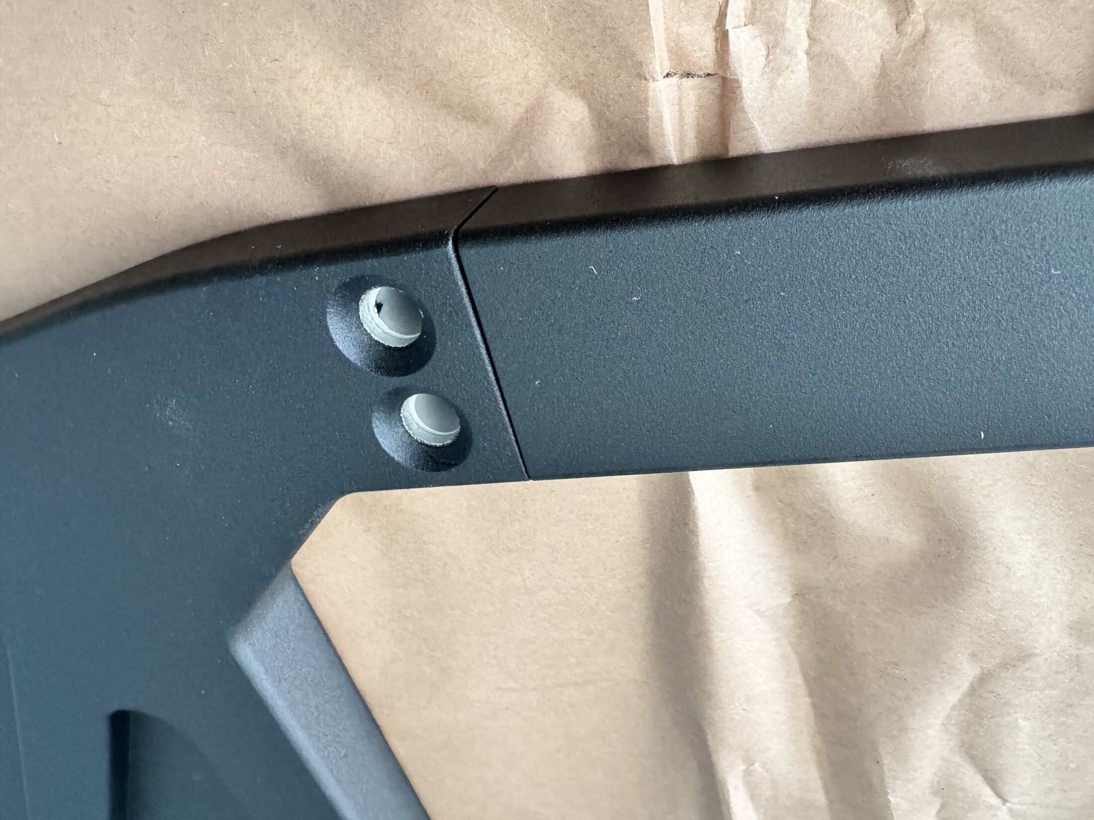

Just picked up from powder coat.
The filler pieces are definitely pretty sharp but that shows the craftsmanship and thoughtfulness of the design to me. I am not going to be using mine though and would pass them along to someone in need

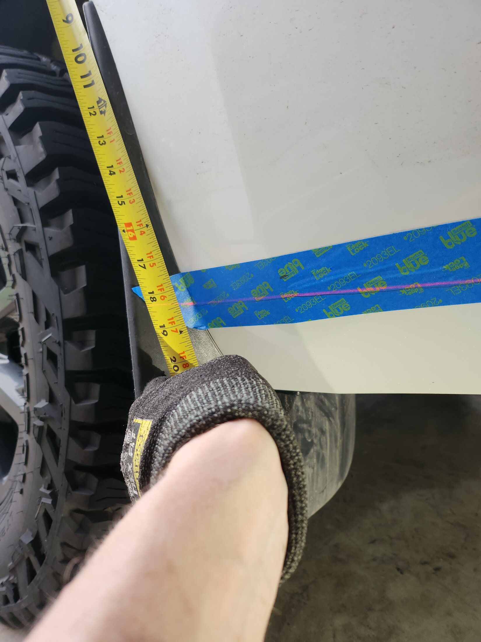

Taped and measured some reference points where I would make my first conservative cut on the bumper skin. The point here is to get enough bumper removed to allow the new bumper to be temporarily installed, so that the full gap required can then be measured, marked, and cut. I used a laser level to mark the line, then I traced it with pencil.
Then start cutting! I was happy that all my old scrapes were now cut off.

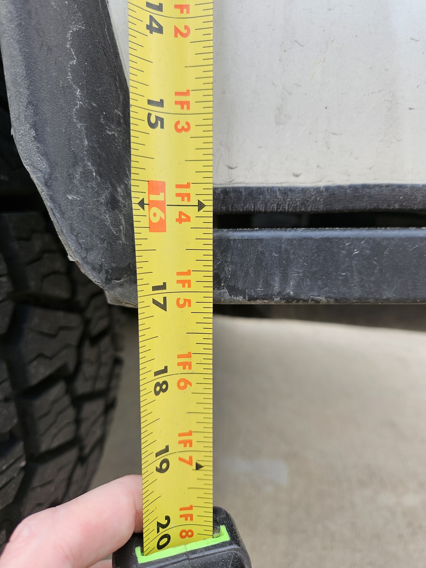

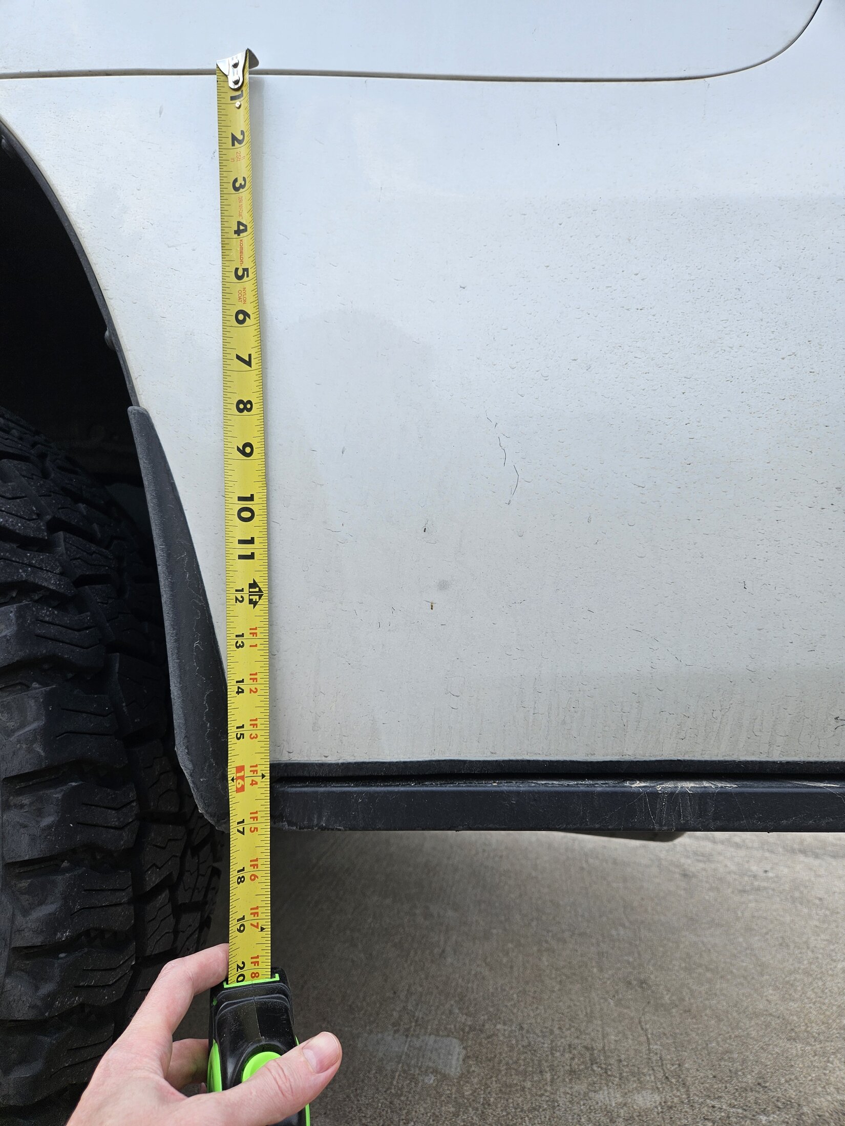

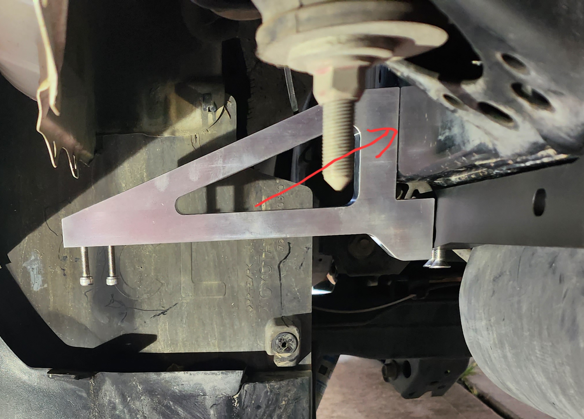

Working though install right now. The gaps between top the E&E bumper and the Toyota body to bumper line is 16.5” on the install page but more like 18” with the driver side wing on my truck- leaving a huge gap even though I made a conservative initial cut. Any idea what I might be doing wrong?
My initial rough cut was around 18.5", measuring at an angle that follows the wheel well (see photo). I just went out and measured the final distance, and it's 18". Measured straight up-and-down vertical it's almost exactly 16".
Also, make sure the cylindrical brace that goes inside the frame, around the bolt, is not caught up on the inside edge of the inner frame hole, that would end up angling the bumper lower than it should be.
So in other words, make sure this aluminum brace is flush with the frame.
Also, make sure these frame welds aren't interfering. The OEM weld slop can vary quite a bit, and definitely could interfere in some extreme cases.
Yup. That was my mistake. I took the 16.5” number on the install guide, added 1/2” to it for safety but the actual number is 18 leaving a large gap. I used some bulb type weather strip to clean it up a little. If I feel energetic tomorrow I might try to shim the main attach point with an m12 washer to tilt it up a little.
