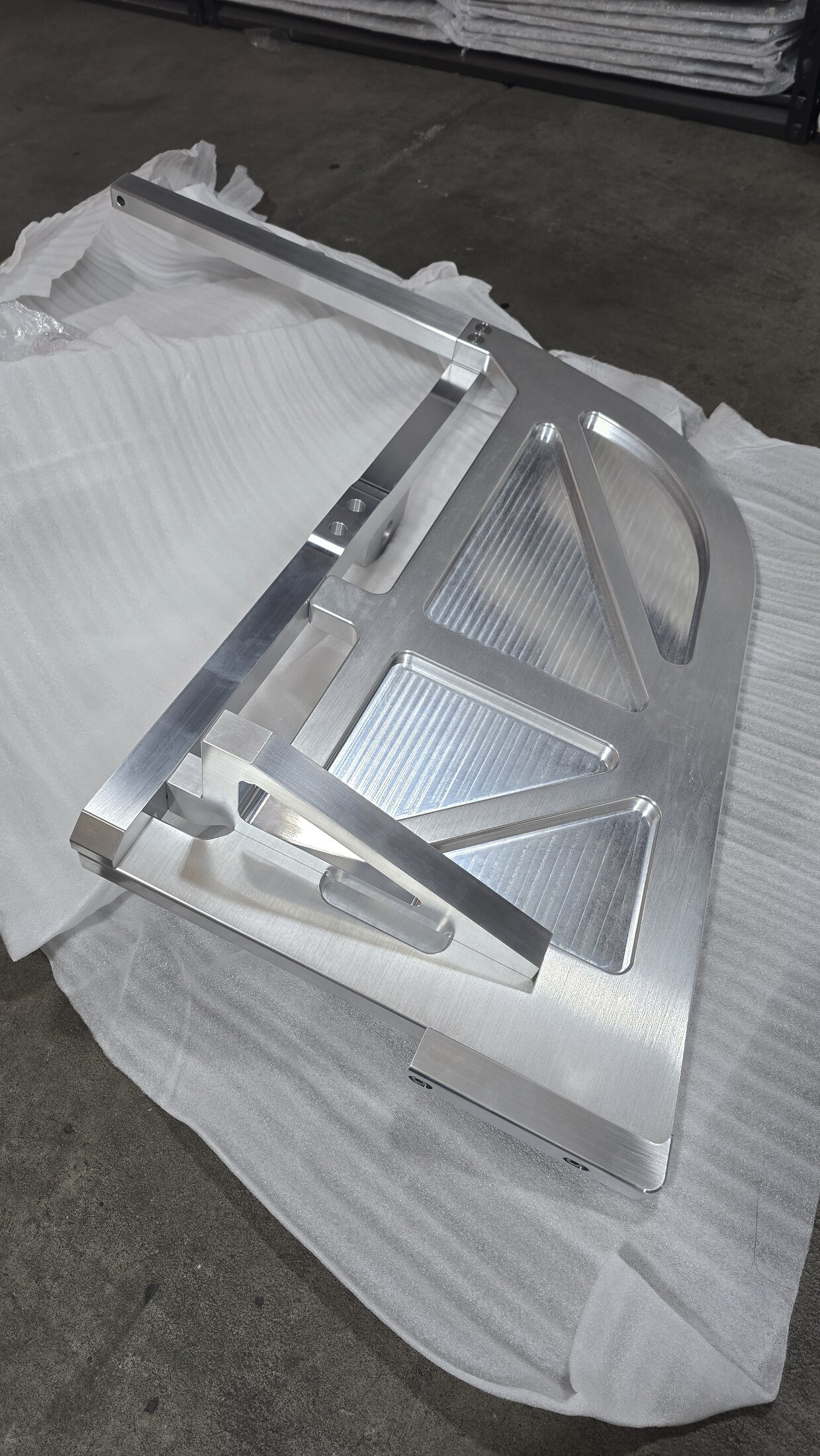

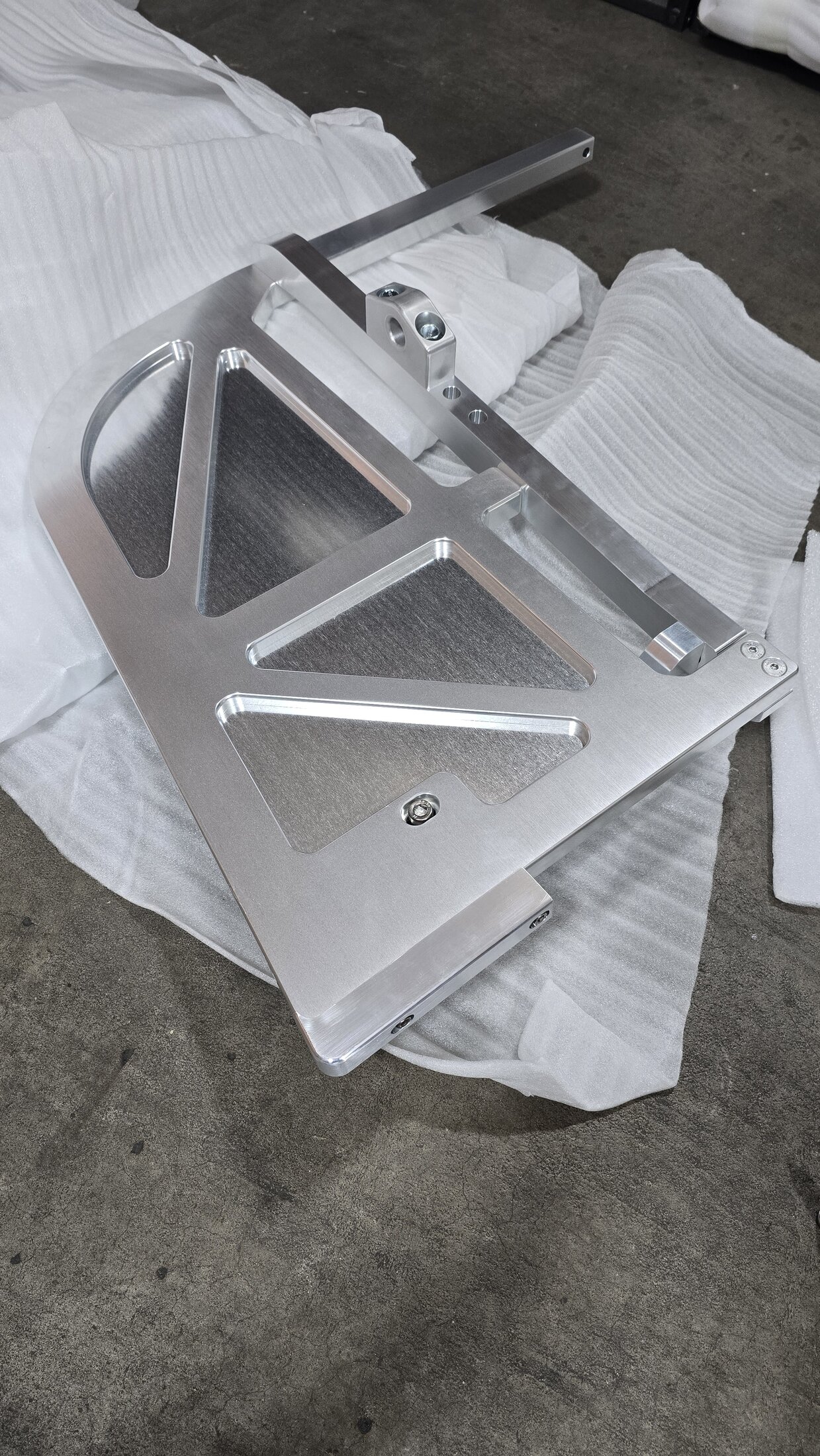

All the parts are 6061-T6 aluminum, so they will resist corrosion quite well. You can spray paint or powder coat them if you want.
Yours will ship out today!

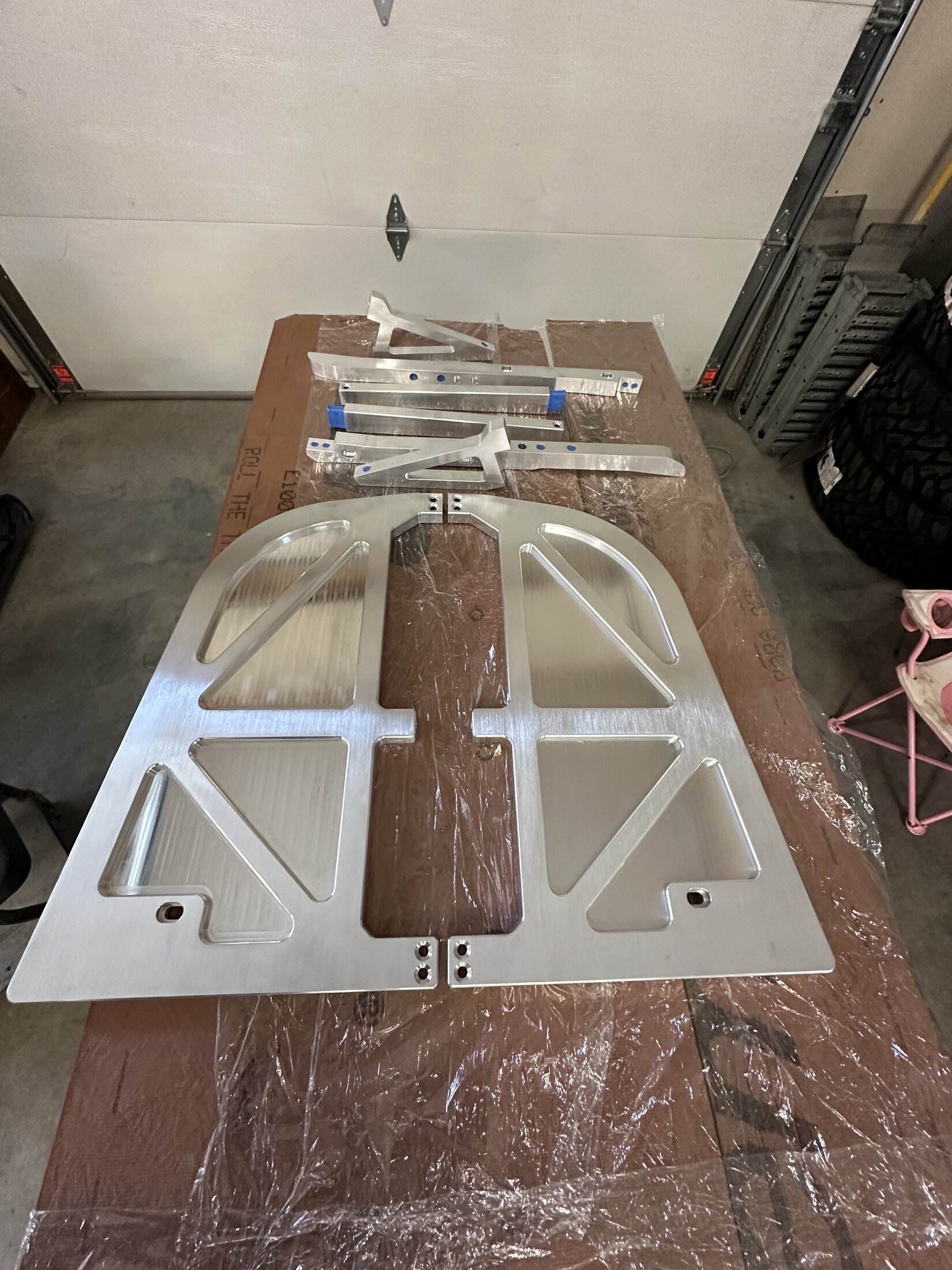

Received the package yesterday, dropped off at the local powder coater today. Should have everything back early next week. BK110 color.

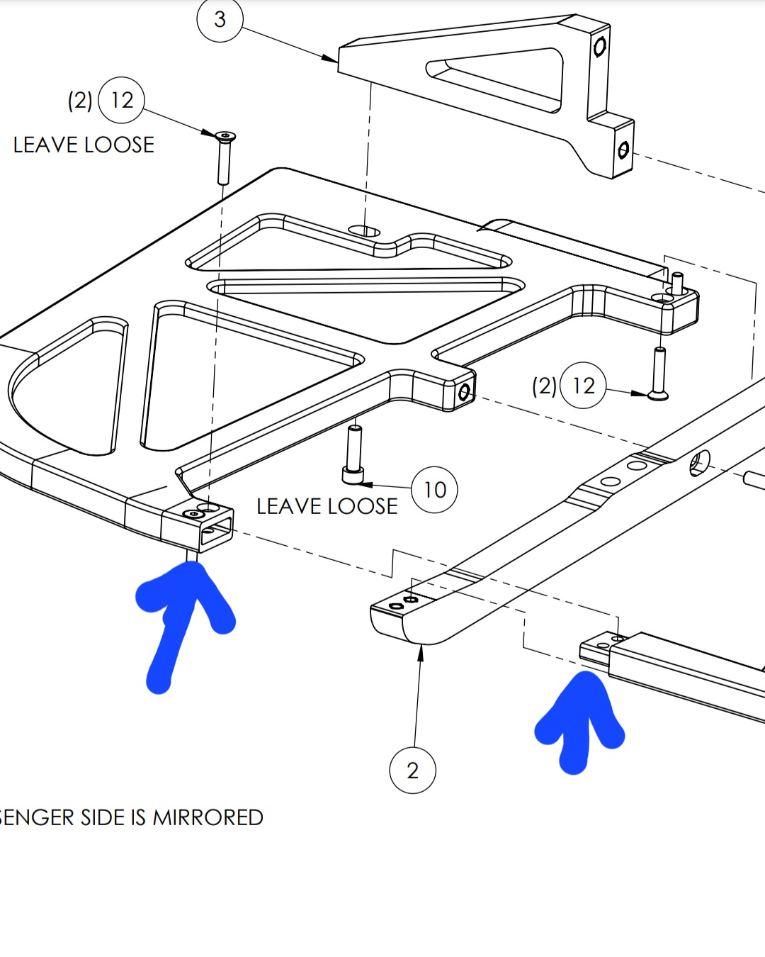

Make sure they don't put to much powder where the bumper bar goes into the bumper bracket. It is suppose to be loose fitting.
How buggered will I be if they coat those areas?
There is a .010" total gap top to bottom and a .015" gap for and aft. Typical powder coat is around .005"-.01" thick.
If each part gets coating on it, that would be a minimum of .02" of powder coat build up, which would make it pretty hard to put together.
I think you should tell them not to coat the the internal area, and then you should be ok. If you need to remove some of the coating, it will be much easier to remove from the other part.

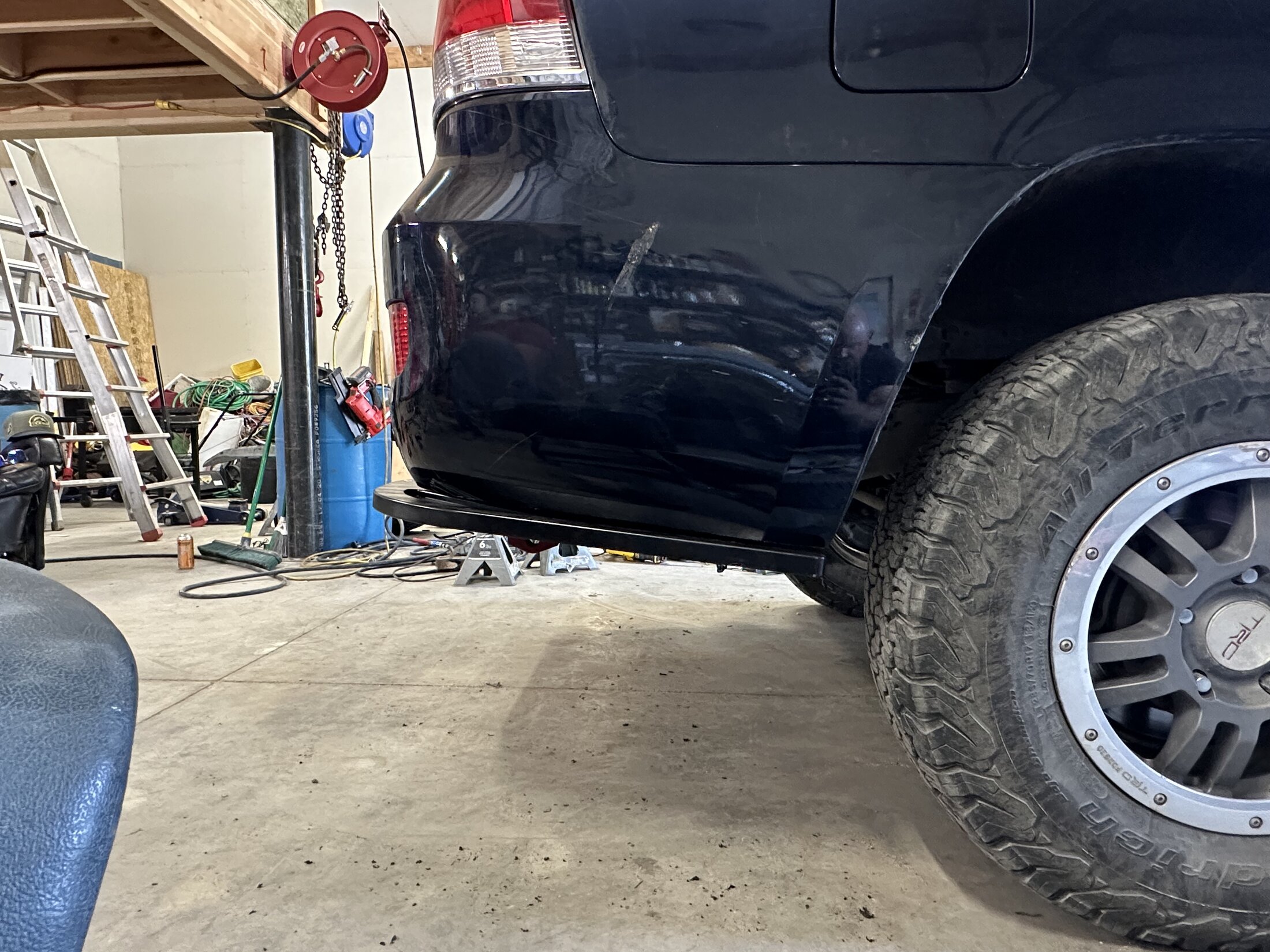

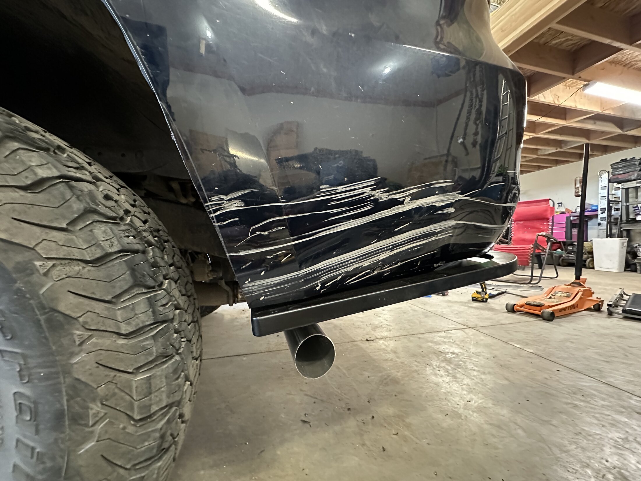

Well I got the bumper on and I’m super happy with it! Great build quality and looks great. Because of my 1.5ā€ body lift I didn’t end up cutting very much of the factory bumper off so my oopsie from Black Bear this summer is still very obvious but that’s alright with me. Also rerouted the exhaust out the side while I was in there. Can’t wait to test it out now!
This is awesome. How does it sound with the chopped exhaust?
