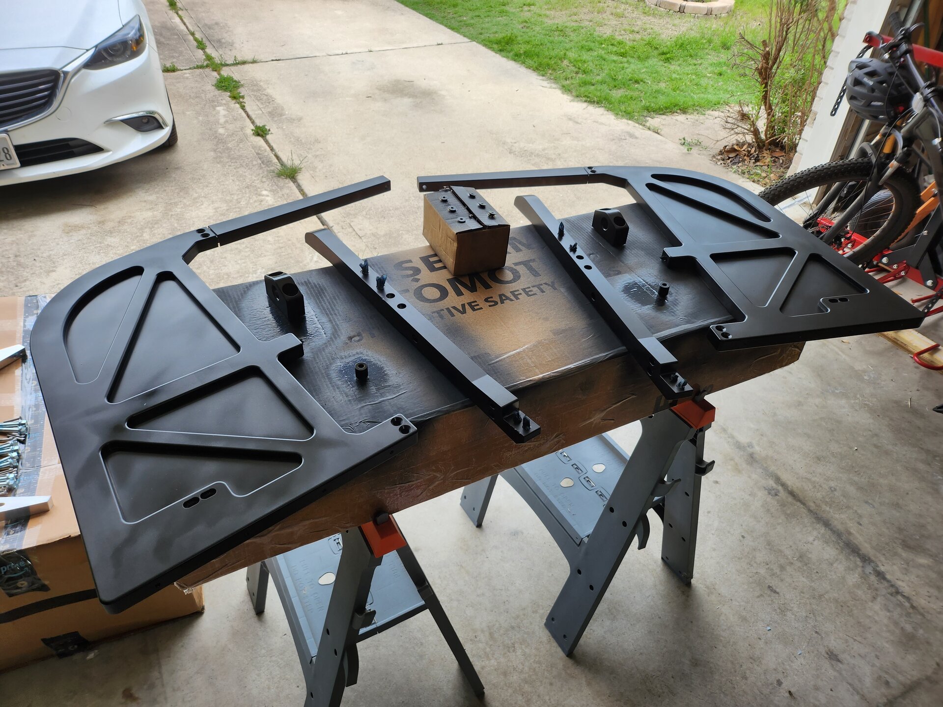

I painted it myself as shown below, but the paint is certainly not as durable as powdercoat:

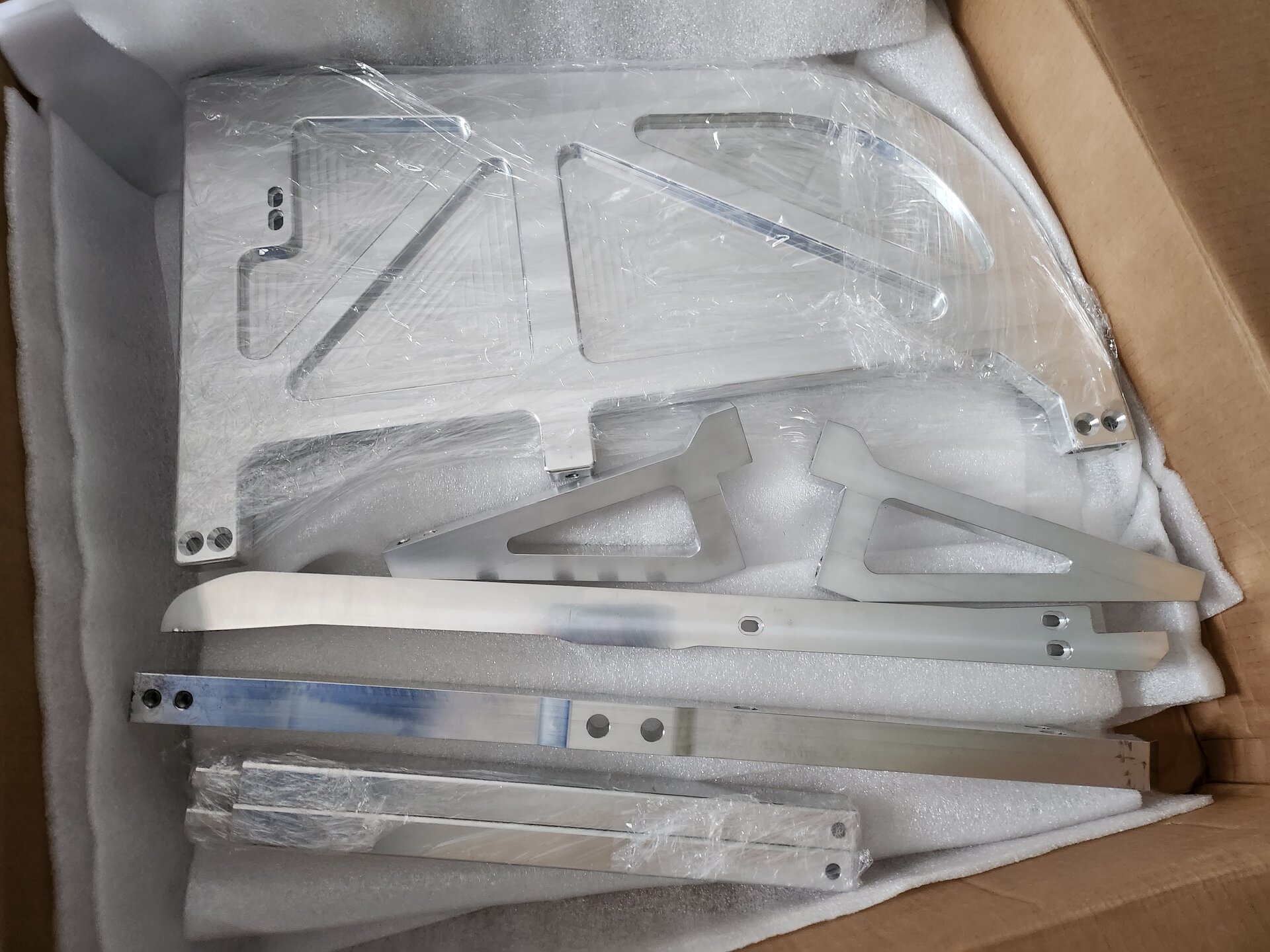

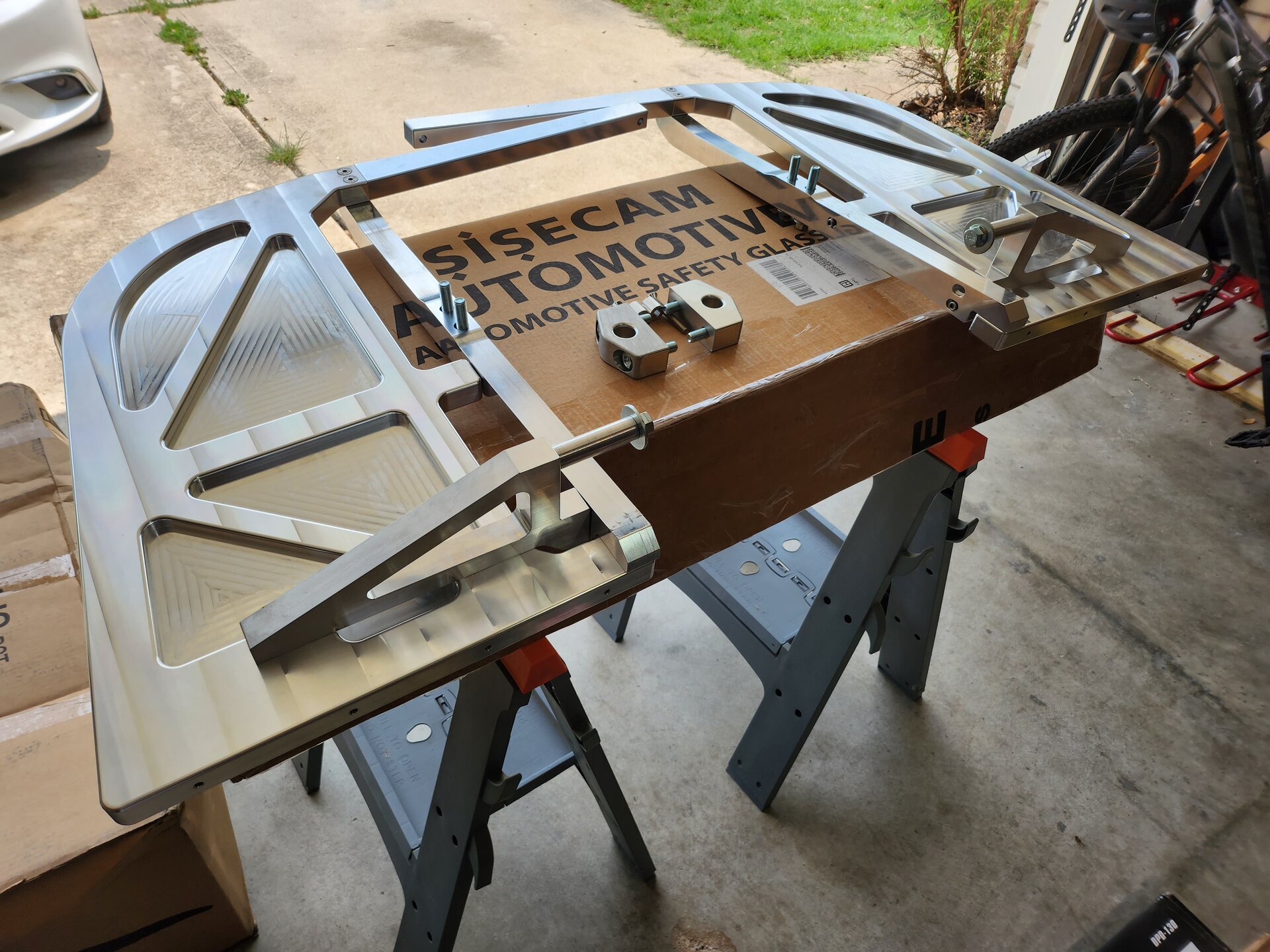

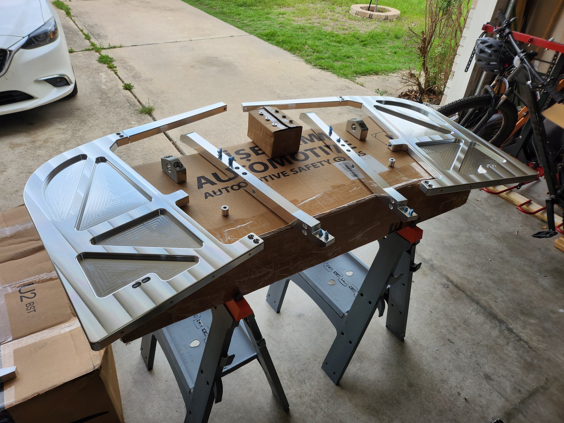

Really fantastic & stout rear bumper from E&E Off-Road (@turbo8). Test fit the pieces together, and it's clear these are made with extreme precision.

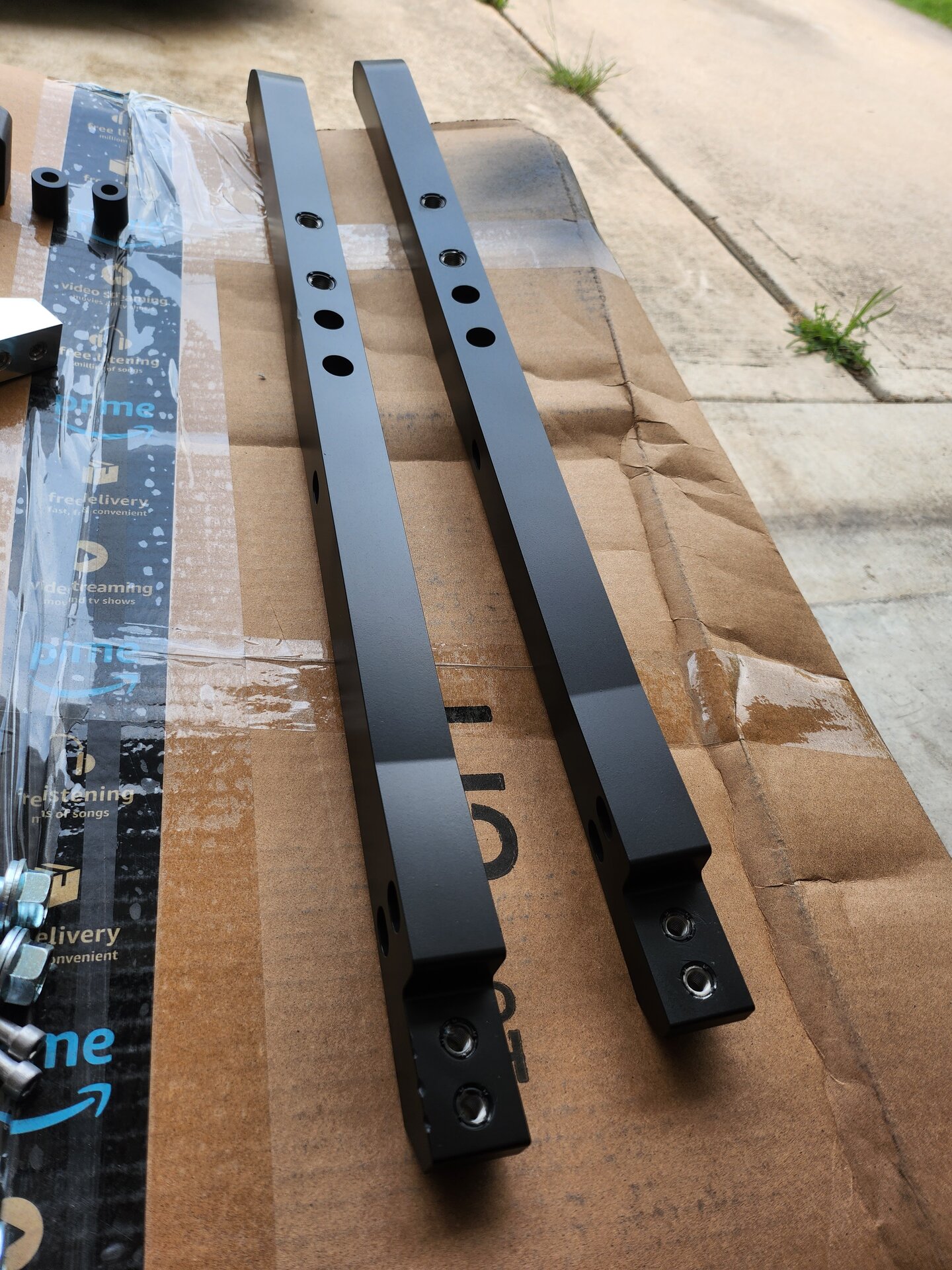

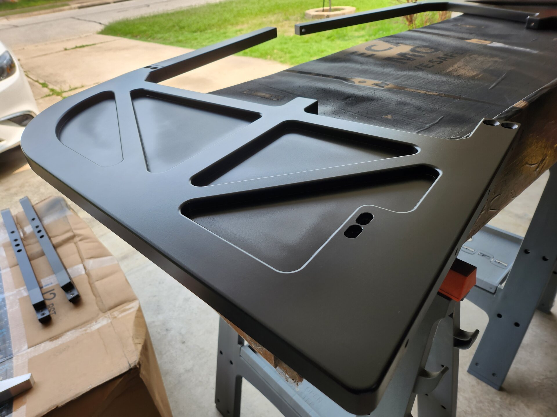

Determined which components were outward-facing and needed to be painted, then cleaned the aluminum and painted. Going to let dry for a couple days, then will install on Saturday.
SEM paint is self-etching / priming on aluminum.

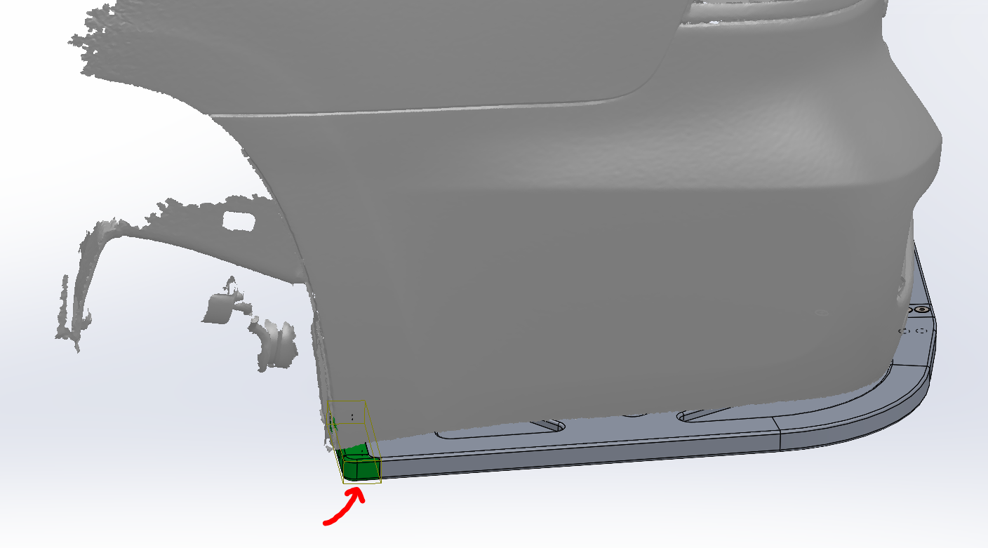

Would everyone like me to include this filler piece? The bumper is meant for up to 37" tires, the filler piece makes it look better for smaller tires.
Another vote for including the filler piece.
