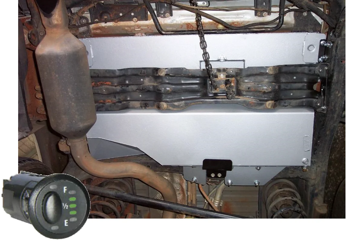

Some picks from the 12.5 below out of the LRA install manual:

The manual for the LRA says this, so at face value that is 1-1/8" lower;
"If there is only one set of holes ( later model 200s ), you’ll need to drill another set of holes 28mm ( 1.125 inches ) lower and insert a set of riv-nuts or similar fixtures. This will be the new ( and lower ) attachment point for the “L” brackets. Use the template from the kit to drill holes in the rail to match the mounting position for the spare wheel carrier in the new lower position."

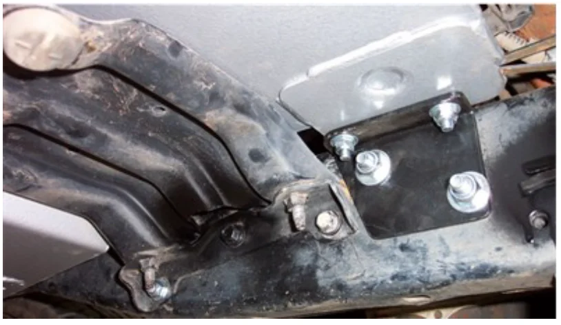

The picture from the manual below (do not know if this is accurate, maybe an Aussie 200 with no charcoal filter fitted slightly higher) shows the spare tire bracket is getting pretty close if not just below the level of the bottom of the frame.
It also shows the L-bracket holdeing the 12.5 LRA, so as long as the E&E bumper is mounted to the bottom of the frame and does not stick out inside the frame it should work out.

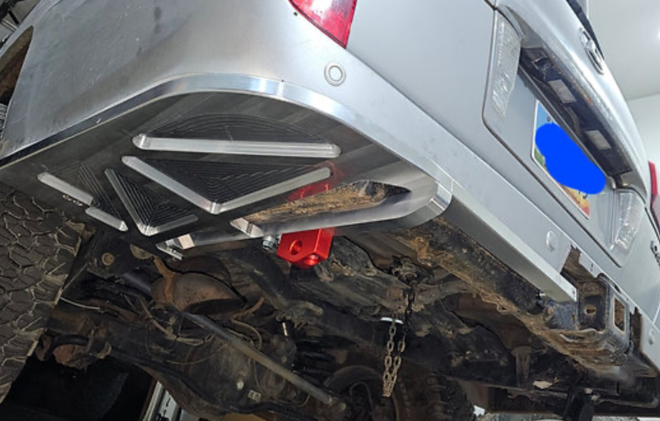

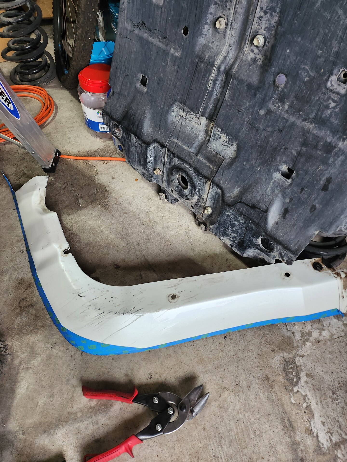

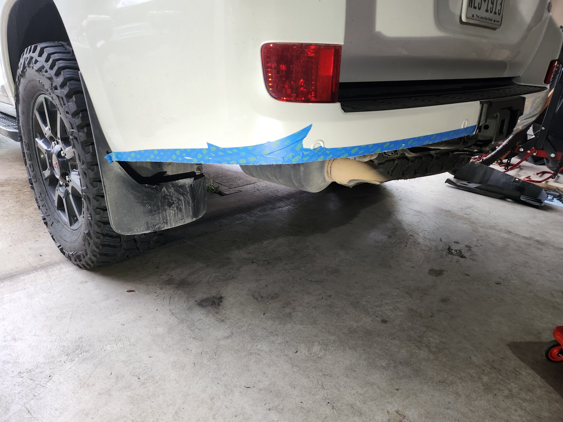

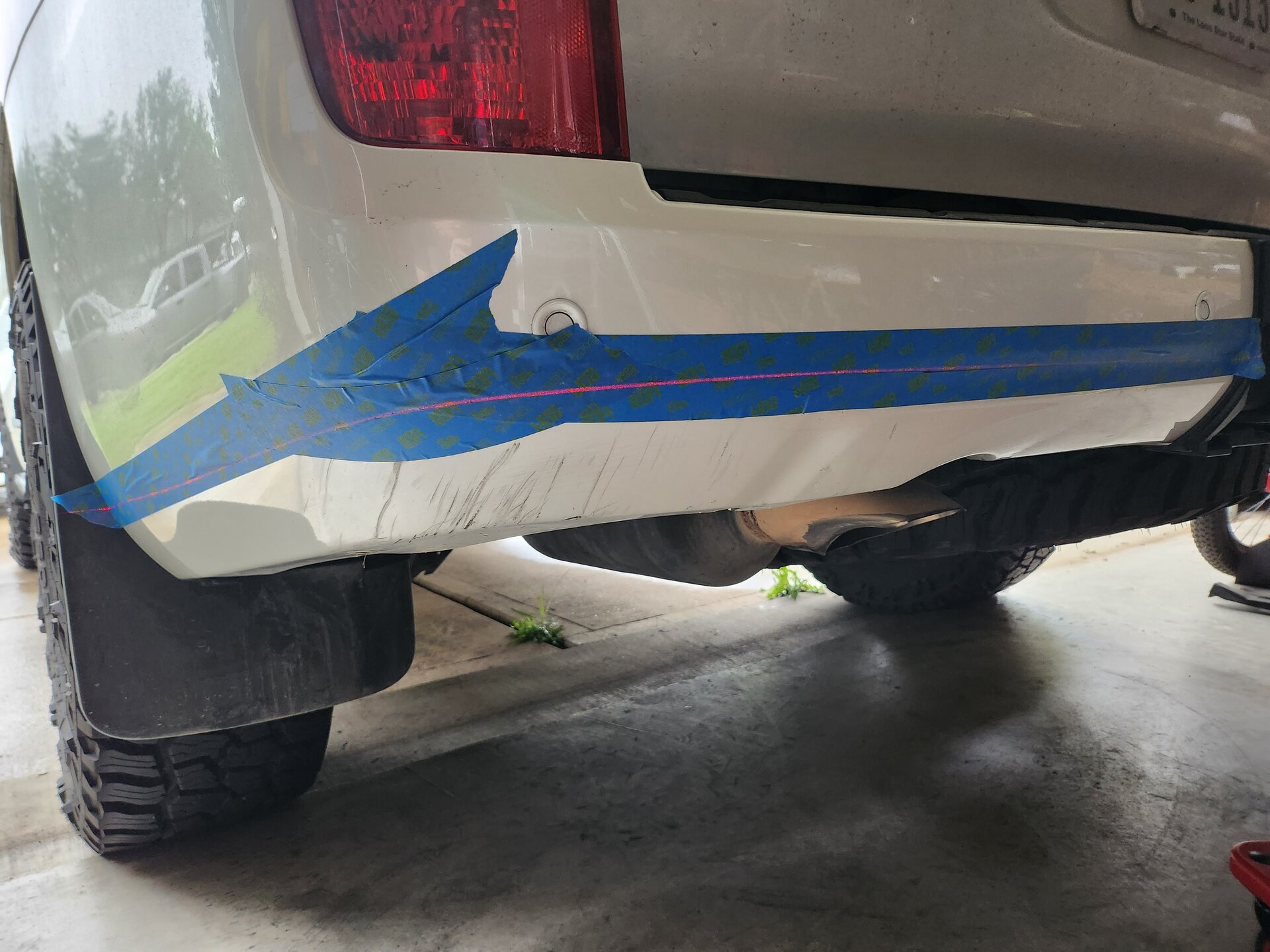

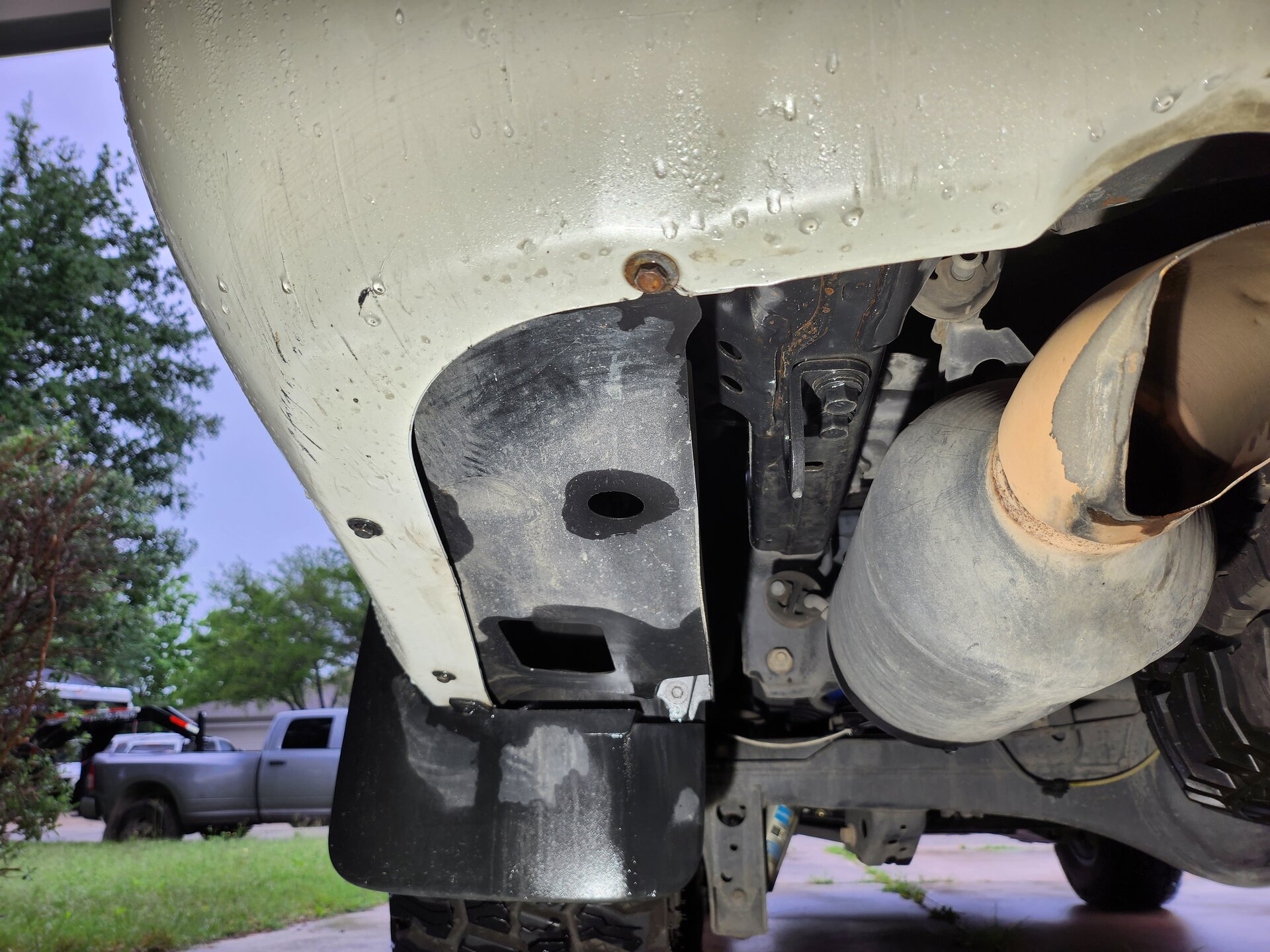

Here's how I installed this bumper (lots of photos, take a look):
Just going to cover the basics of the E&E Off-Road rear bumper install here, not every little step. Feel free to ask any questions, the install was good.

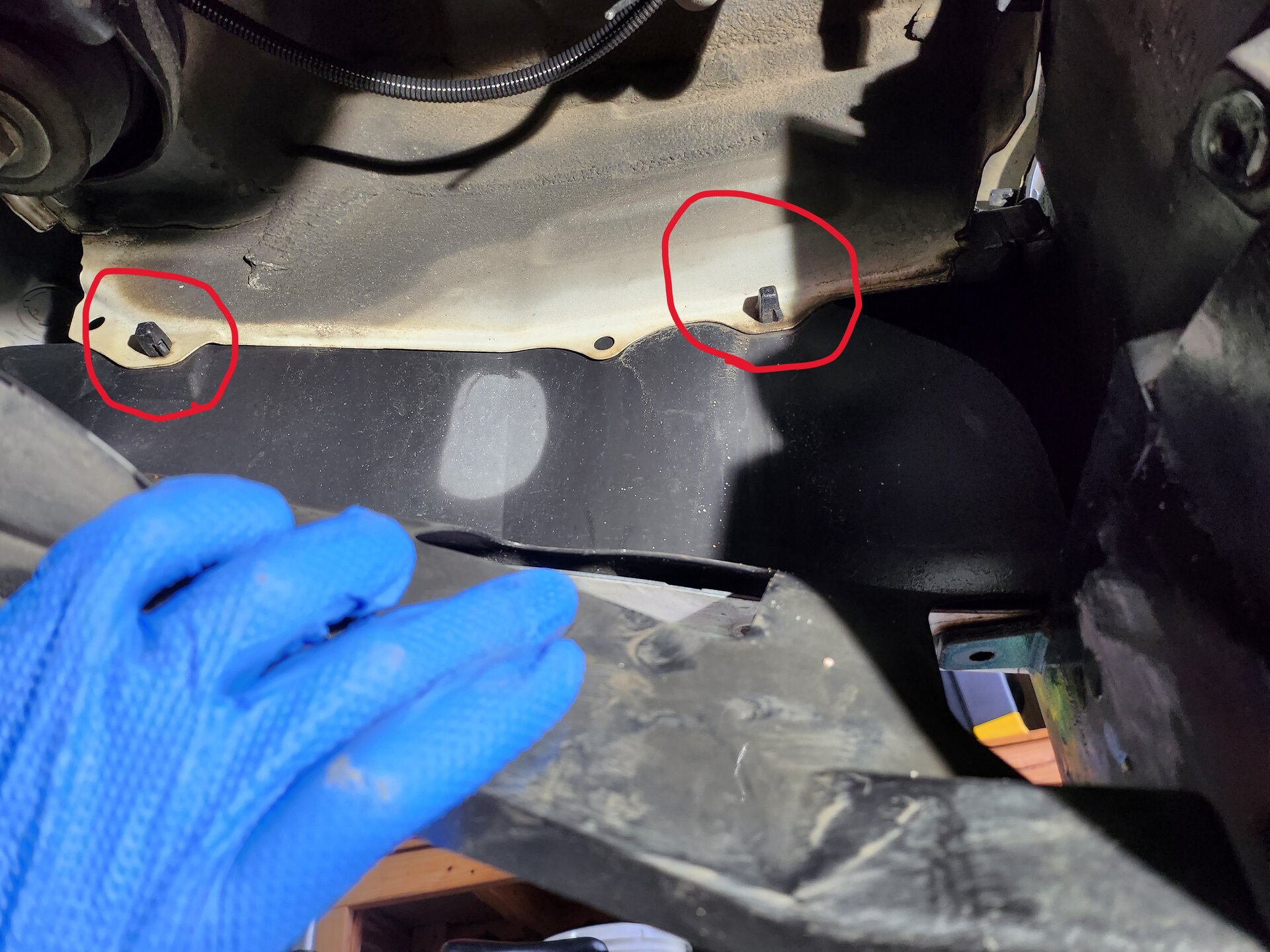

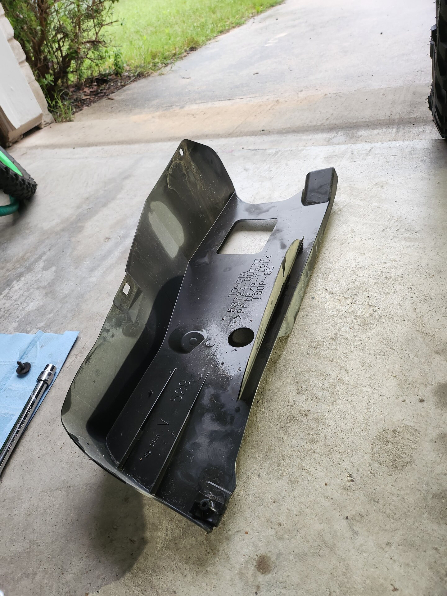

Remove the black wing underside covers. Once you get the main bolts out, you'll be able to wrangle it around to get access to the two hidden bolts that secure it to the body panel.

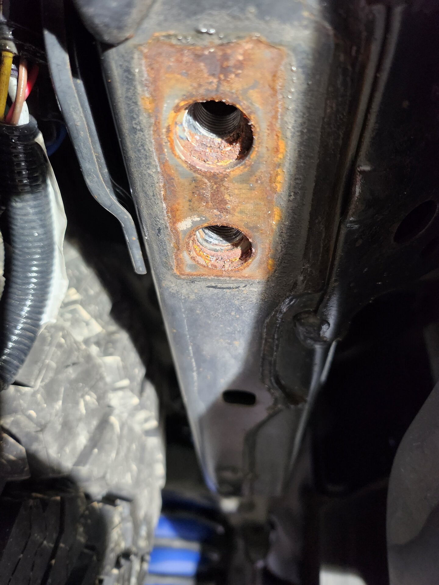

Remove the stock recover points. I was surprised to find out that the frame coating / paint is applied after the recovery points are installed. It's bare metal underneath, and it was starting to rust. I cleaned it up and sprayed some Rustoleum.

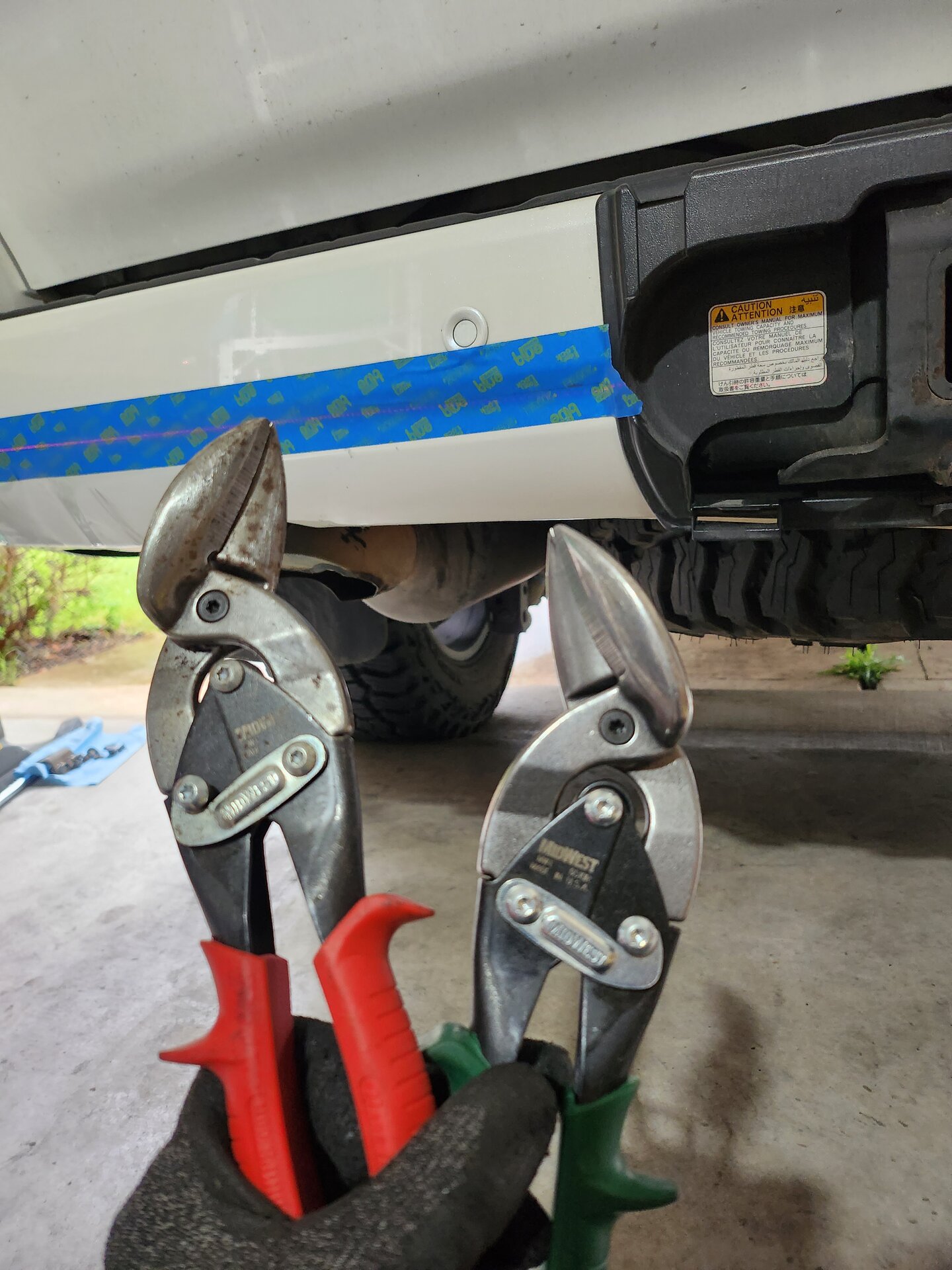

Taped and measured some reference points where I would make my first conservative cut on the bumper skin. The point here is to get enough bumper removed to allow the new bumper to be temporarily installed, so that the full gap required can then be measured, marked, and cut. I used a laser level to mark the line, then I traced it with pencil.
Then start cutting! I was happy that all my old scrapes were now cut off.

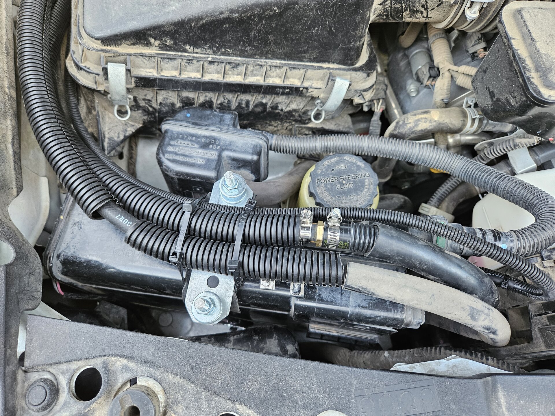

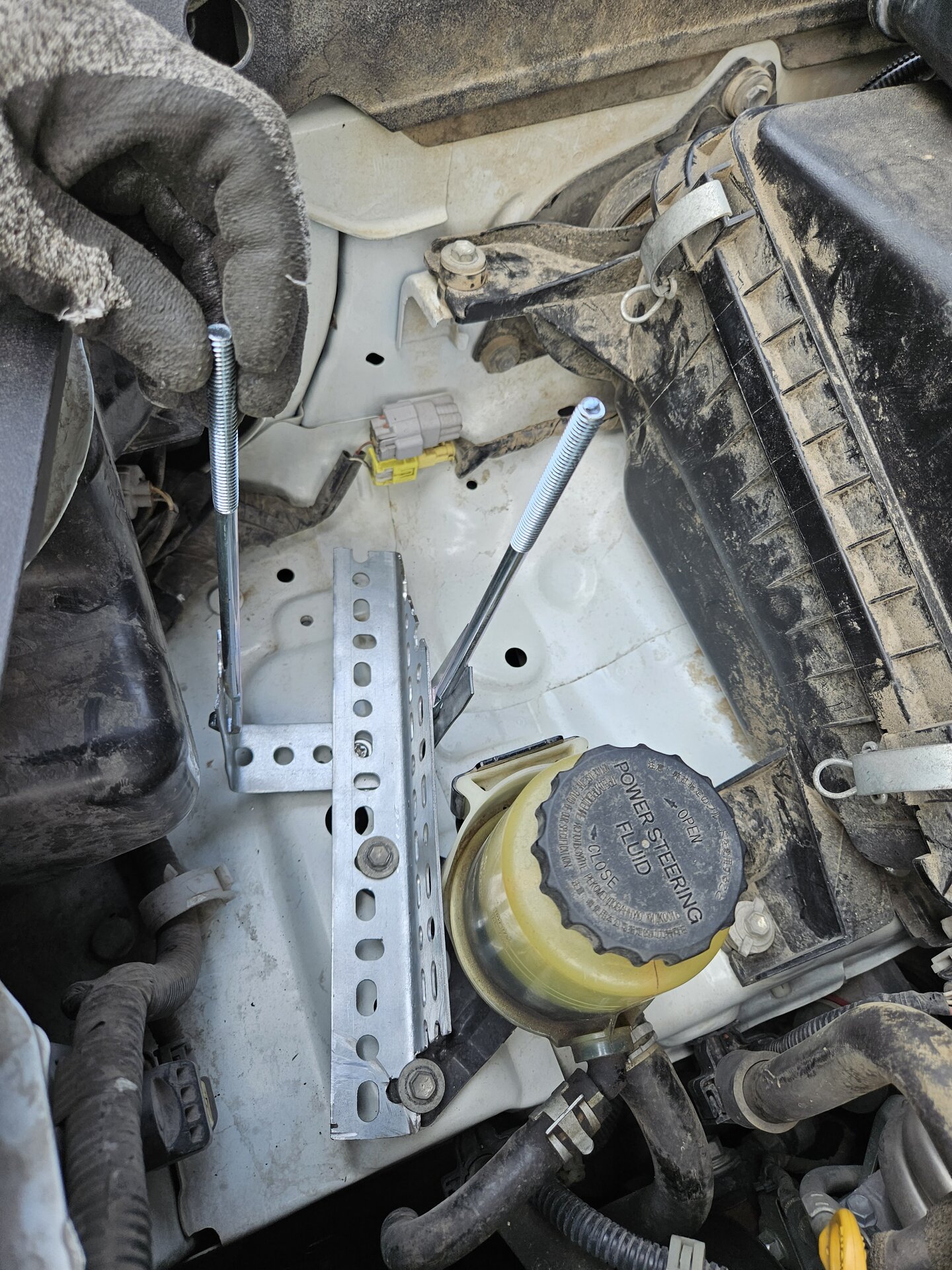

And here's how I made it work with the subtank:
I didn't have a lot of free time, but I did spend a little time each day and eventually get the canister moved up front. It's in a state that can be considered permanent, but now that I have a working bracket design, I'm going to design a more professional version after my trip that will be laser cut and bent (and can be ordered 1-off as needed for anyone doing the same thing). Routing the wiring up front actually wasn't too bad, and I was able to avoid getting it too close to the exhaust pretty much the whole way. I ended up not needing to relocate the power steering reservoir. These later models do not have the DRL resistor, either (at least not in that location). These later models' canister also has no threaded holes anywhere, unfortunately, so at first it wasn't obvious how I was going to secure it. In the end I strapped it down like a battery, which honestly ended up being a pretty great solution. It may not look like much, but it's solid.

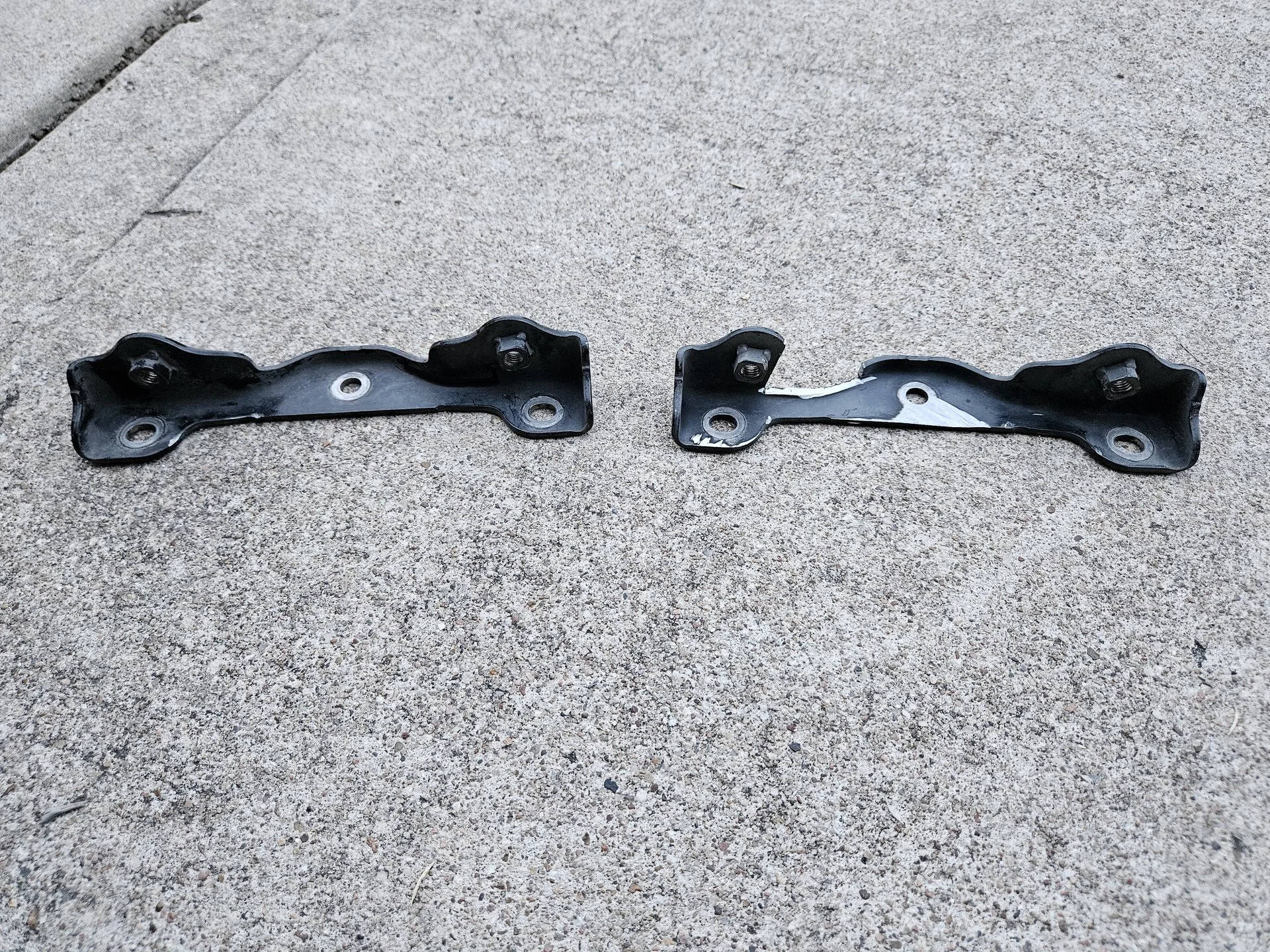

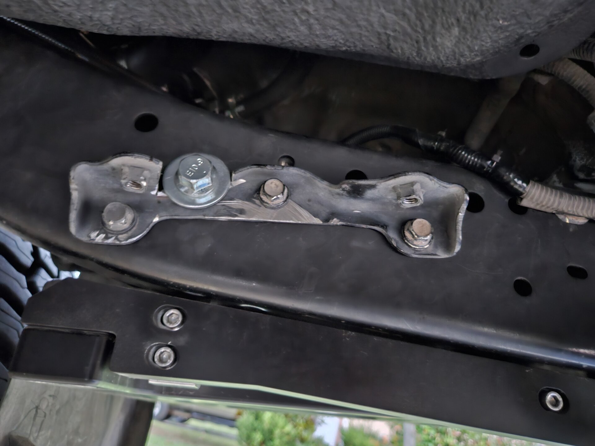

I did modify the brackets that hold up the spare tire brace, so that they would work correctly with the E&E (@turbo8) rear bumper mounting bolt. Test fit & works perfectly. Painted the cut brackets for corrosion prevention, then will install everything related to the spare tire tomorrow or Saturday. The frame holes for dropping the brackets already exist, but are not threaded. The rearmost two (per side) are the correct size for the m8 rivnut, but the frontmost is smaller and has to be drilled out slightly (7/16" bit).
(Don't worry, I will paint the brackets before permanent installation.)
Thanks very much FerrisBueller, that explains a lot.

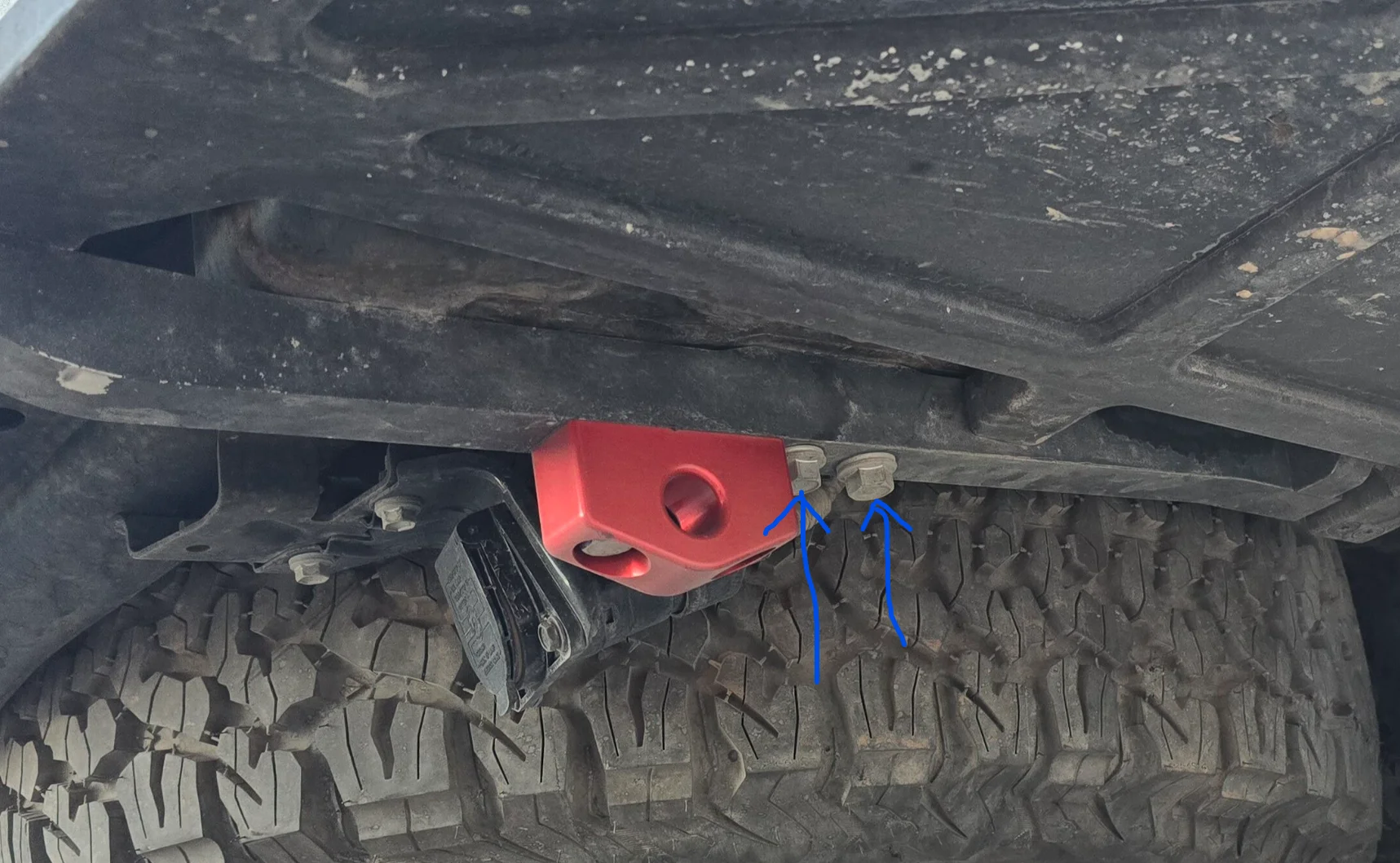

Do i see it correct that for dropping the spare tire bracket and 12.5 LRA you would only have to undo the blue arrow marked bolt each side?
And you can leave in place the E&E bumper and these two "vertical" bolts into the bottom of the frame?
