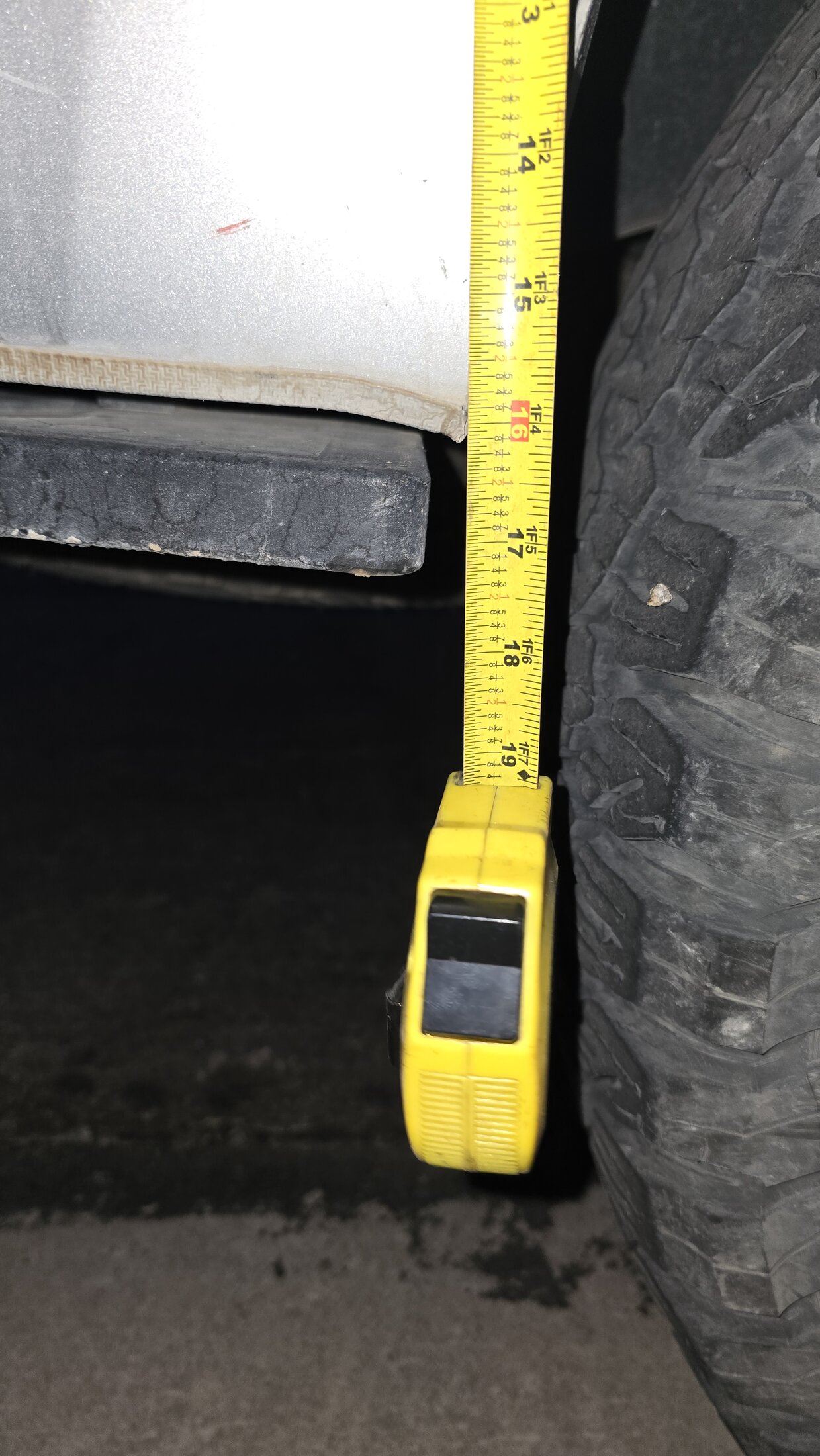

Yup. That was my mistake. I took the 16.5” number on the install guide, added 1/2” to it for safety but the actual number is 18 leaving a large gap. I used some bulb type weather strip to clean it up a little. If I feel energetic tomorrow I might try to shim the main attach point with an m12 washer to tilt it up a little.

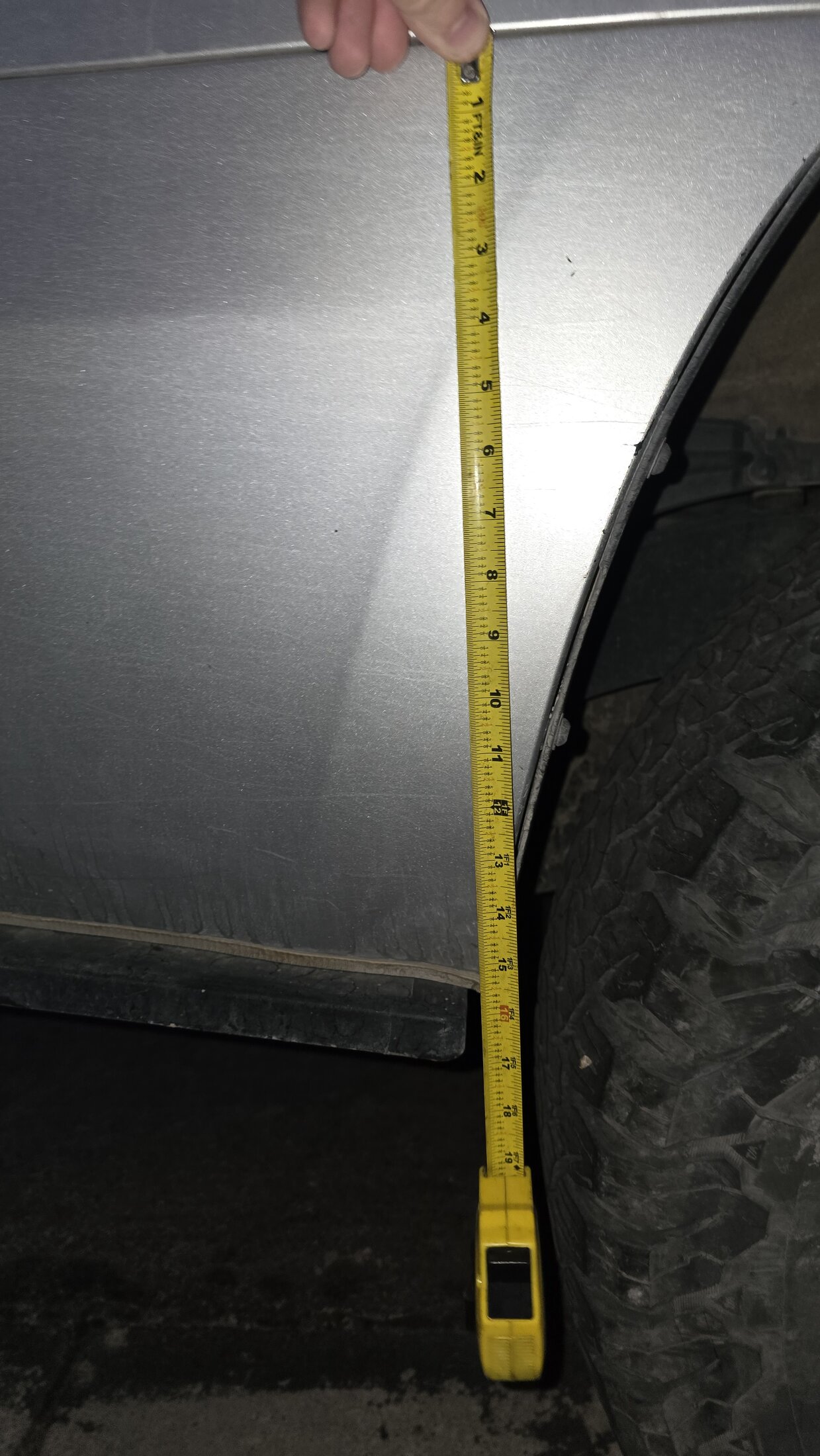

Can you post pictures with measurements? Is the LC bumper skin in a different location than the LX?
Like this:
Like this:
I think the picture shown in the instructions might be prone to misinterpretation, since the red line makes it look like you're supposed to measure along the wheel well arc instead of vertically like you've shown above. Perhaps updating the picture in the instructions would be sufficient?
Exactly. My vertical dimensions match up with Ferris’s…but the photo on the instructions link look like the intent is to measure along a tangent to the wheel arch. I added 1/2 thinking I’d be on the safe side but the gap there is over an inch.
