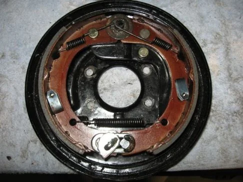

I can't get the t-case ebrake to work correctly. It's as if the cable is too long no matter how far adjust it. I removed the drum, cleaned everything up and check for actuation, it's working but not enough. Is this a cable length on 350 conversions? This is a 350 with an AA housing, LC 4speed and 3 speed t-case. I searched the archives for about an hour and I didn't find much on this.

You know what? I don't have a clue if it's installed correctly come to think of it. I installed the cable end inside the wedge shaped piece of metal, and it was a tight fit. I'll post some pics.

A couple of pics

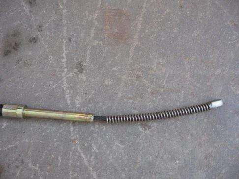

I just rebuilt my P-brake with parts from Cool C. Pic below. The cable shown has a groove cut in on the end. When the cable is installed on the P-brake, a clip is installed in the groove to prevent the cable housing from be pulled into the brake houseing. Does yours have the clip in the groove?
I don't think it does, and that would now appear to be the issue. I'll zip the drum off and look, but I don't remember any clip.
