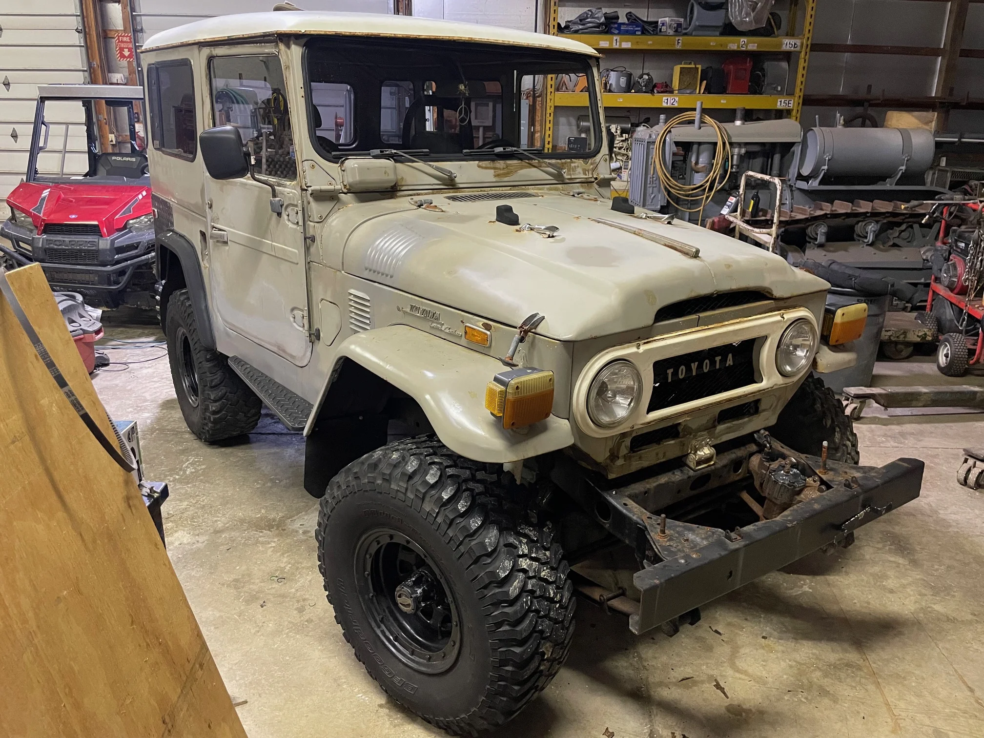

First post, first FJ40, This unit was built in 76, sometime during its life it was rewired with a painless fuse box, of course all the labels are faded away. I believe at a later date a Mercedies OM617 5 cylinder turbo diesel was installed.

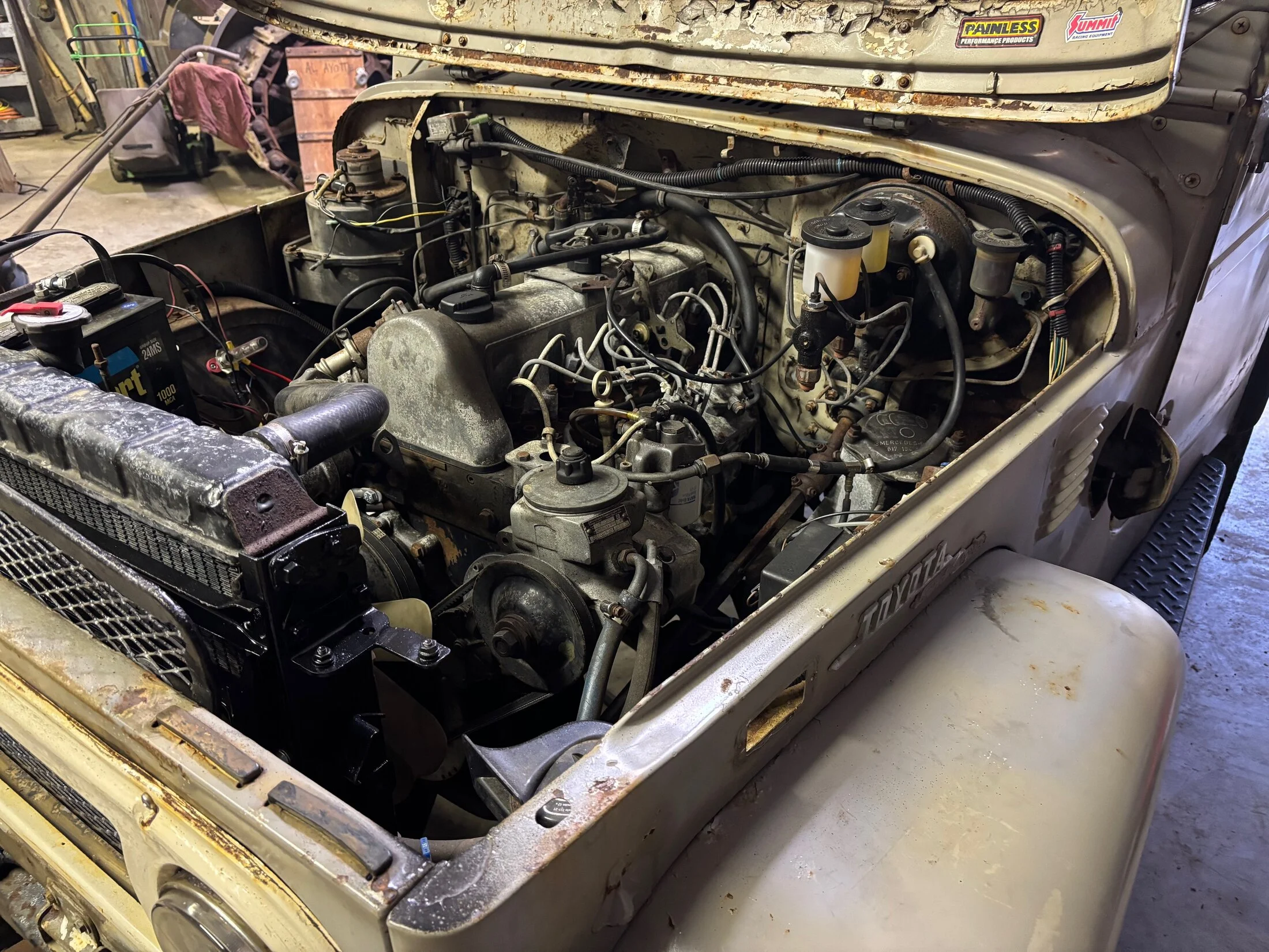

I took delivery in December and have been working on small repairs , lighting/ electrical, door handles, general inspection, oil change ect. Now that the weather is warming up I plan to get more serious. On the brake problem, one of the front calipers was stuck so both replaced with new pads, disk were OK. Also replaced master cylinder. I have not had the rear wheels off yet so thats unknown. The brakes are week, I first suspected a vacuum problem, found vacuum low around 5 inches, this was converted from millibars as thats what the gage from Amazon displays. I removed vacuum pump from Diesel, cleaned and inspect and it was in nice shape, after more investigation I learned the outlet check valve fails causing low vacuum, I installed aftermarket check valve and vacuum jumped to 20 inches. I expected my problem was solved, NOT I have never worked with a vacuum brake booster, not sure if that is part of the issue or maybe the proportioning valve. I will add no apparent leaks. looking for direction.

If you really have to stand on the brake pedal to get any braking I might suspect the booster first. 20" of manifold vacuum should be plenty for it, have you checked to see if you are getting 20" at the booster? when you replaced the Master Cylinder did you adjust the pushrod between the booster and MC?

As it was explained to me 30 years ago, on a diesel conversion it is necessary to install an intermediate vacuum reservoir to hold vacuum between the engine and the brake booster. A diesel will not naturally produce any vacuum of its own. Chances are that you have a vacuum pump on the engine; the pump will not produce enough vacuum in real time to properly operate the booster.
This does not eliminate the possibility that your booster is bad
Yea you should have a vacuum reservoir under the passenger side floor, but of it was originally petrol then you won't have that. I found one for mine from an Isuzu trooper - you'll struggle to find an original one.

the Mercedes 300d that the engine came out of does not have a vacuum reservoir (for the braking system) and those cars stop fine. I'm pretty sure the advantage of the vacuum reservoir is that if you make frequent hard brake pedal presses at low engine RPM you'll never run out of vacuum. it would not be a bad idea to add one after the OP fixes the brake problem.

I did verify check valve at brake booster is working and that was good. I have a small tank I can plumb in for an experimental vacuum reservoir , I am thinking a new Brake booster is in my future.

yea your on the right track. a smoke machine test would reveal any leaks in the booster, pretty sure its bad if changing your vacuum supply makes no difference.
