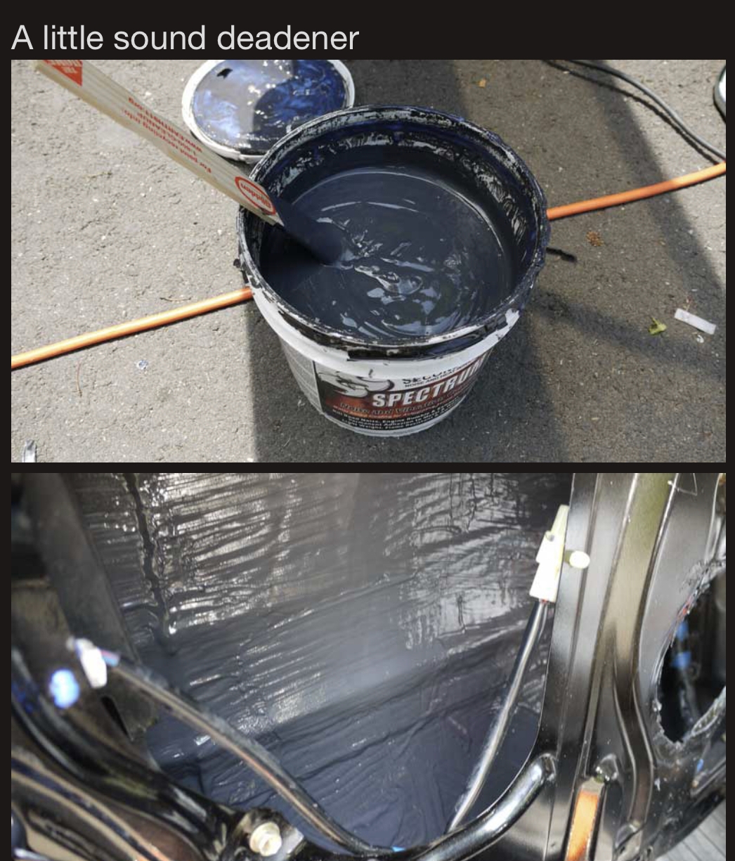

That’s in my 80 and it’s bank vault quiet. I did go a bit over board as I did the inside of the outer panels and the inside panel of the doors and the used a liquid sound deadener
on top… having a black truck I was also concerned about heat so I also painted the roof white and have a early model rhino rack which was a natural aluminum color.. so great at reflecting the sun. So it’s quiet and cool.
I don’t remember how many SF I used.. I also used Dynaliner over the Dynamat and used Rattle Trap Extreme when a ran out of Dynamat
