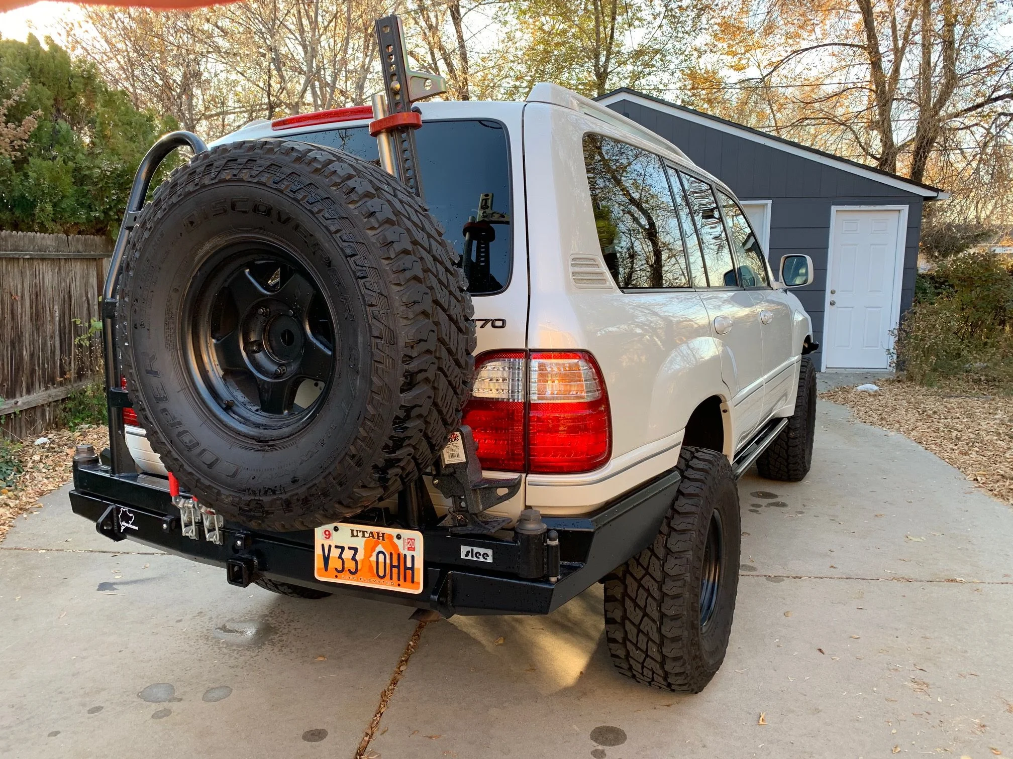

I love the finish on the Slee rear bumper. Is it textured? Any idea what the color is called?
Doesn’t have any texture to it. It’s smooth, a semi-gloss. You can see details on Slee’s powder coat on their site below:

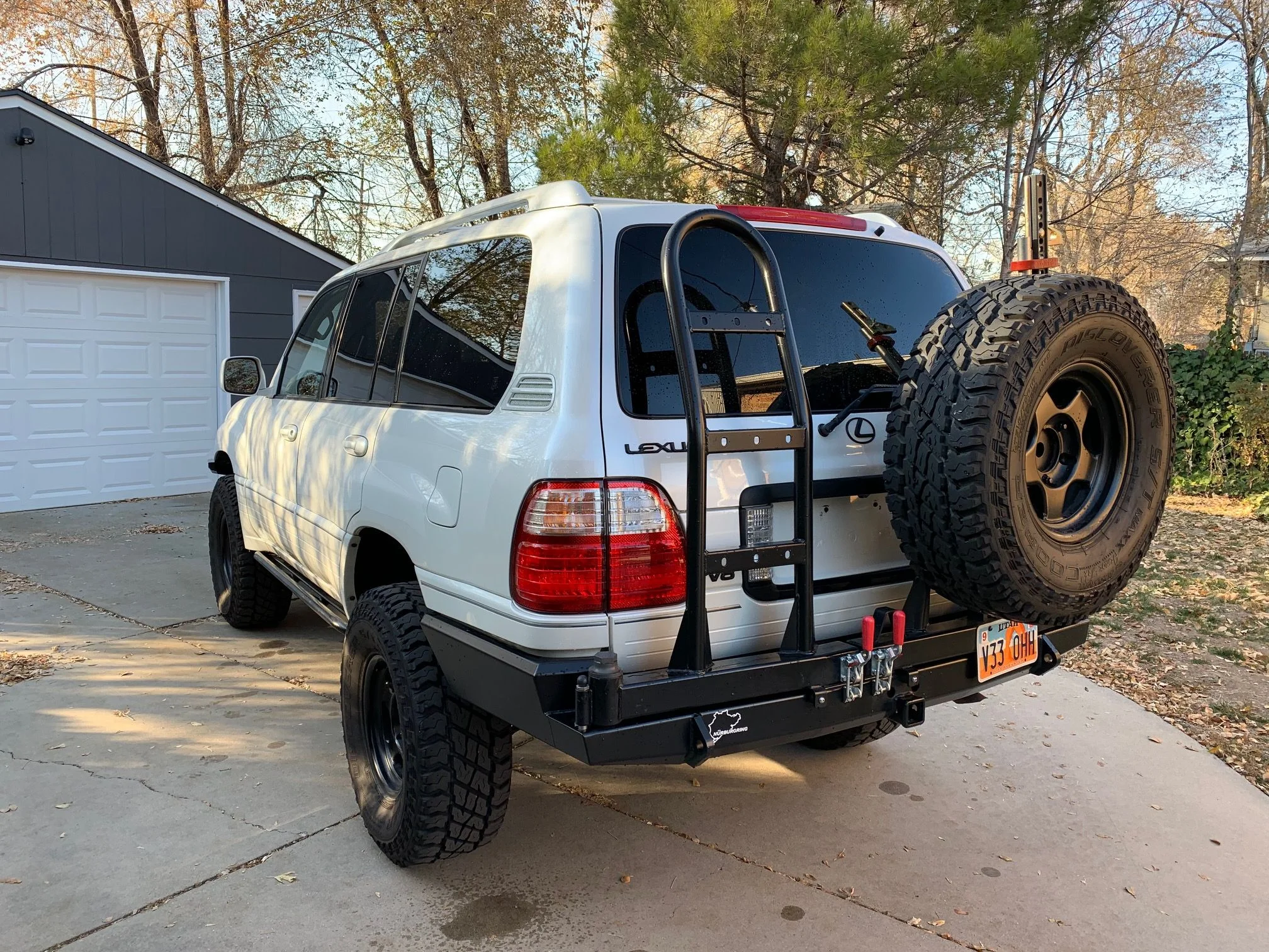

Here's how it's set up now:
Overall it is looking pretty good I think. Everything is set up and ready to roll. The sad part is we haven't even off-roaded it yet. We have taken it south for a few camping trips but nothing more than a fire service has it seen. We plan to, just life is too hectic sometimes.
