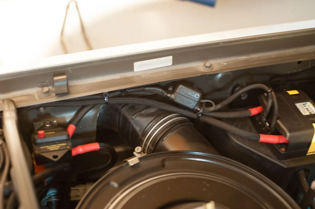

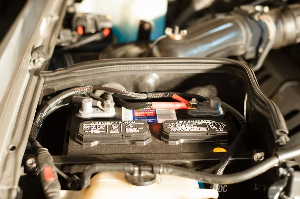

Hi Everyone,
I will be announcing my new website relatively soon over in the Small Business Storefront, but I wanted some input on a package I am putting together. I am a huge fan of BlueSea Systems and have been running their 7610 ACR, fuses, fuse blocks and circuit breakers for some time in my dual battery setup with excellent results. I love the simplicity and reliability of it. I plan to offer a “turn-key” solution for a dual battery setup. That is, turn-key less the second tray and battery. I might have an opportunity to get the second trays, but am not planning on it. For now, I’d like to know what type of interest there is for this. I will have all the cabling cut and terminated to the correct length and sizes, circuit breakers, and ACR locations all laid out with hardware to mount it all.
The plan for now is to include the following and release it sometime around 1/1/19.
One 7610 ACR
One 2151 Terminal fuse block at main battery - there will be an empty spot for expansion
One 100 amp fuse on the 2151 at main battery
One 100 amp 7187 surface mount circuit breaker for second battery
Pre-made 2awg ground cables (with braided sleeving) for both main and secondary batteries to fenderwells
Pre-made 2awg ground cable for secondary battery to engine block
Pre-made 4awg cable for between main battery and ACR
4awg cables for between ACR and secondary battery
Undecided on including two or four mil-spec battery terminals....
Here are some pictures of just about what I am envisioning.
Looking forward to what you bring to market. This is one of the mods on my soon to do list.

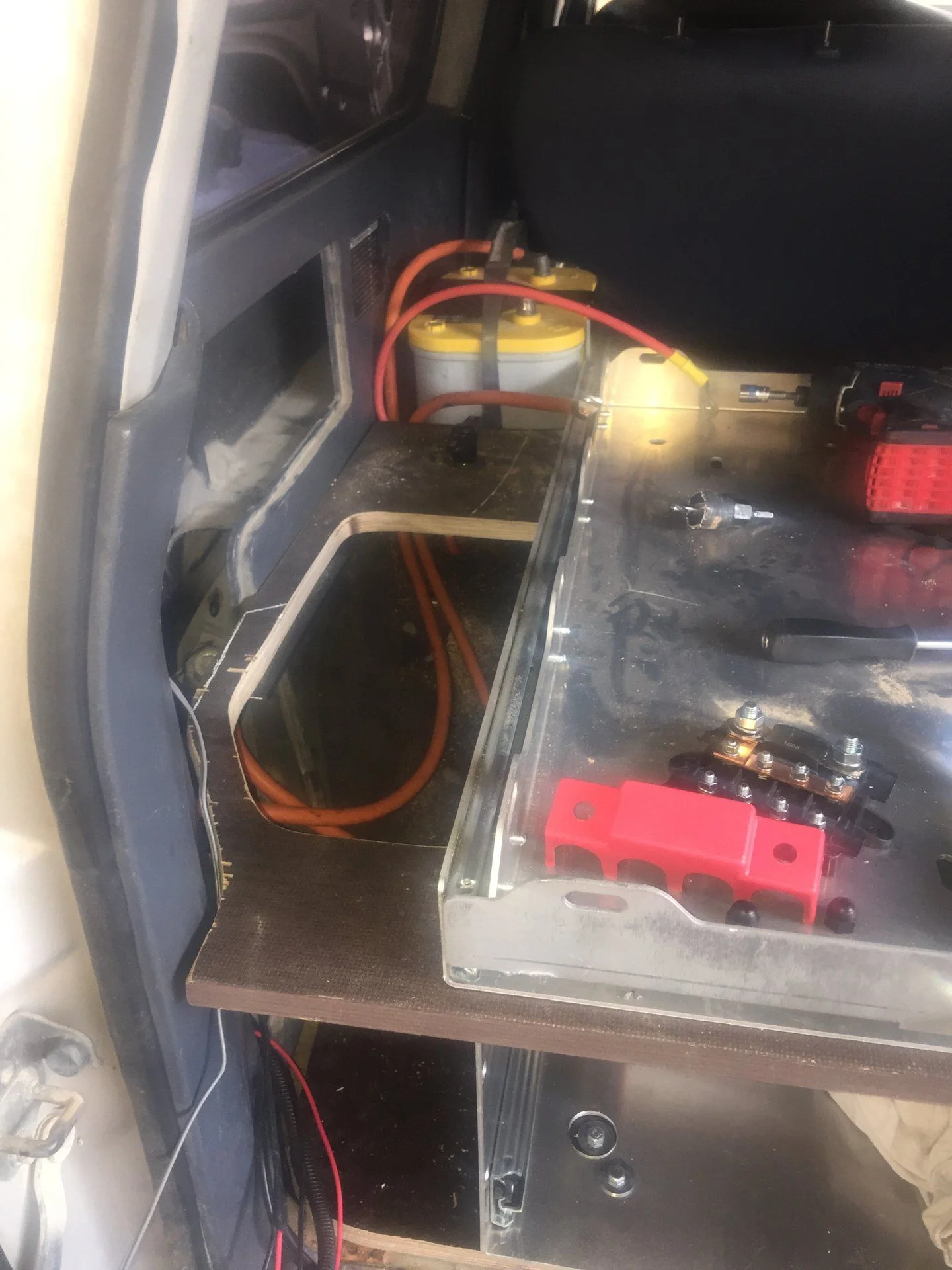

I have dual battery setup for supporting off road needs like refrigerator, winch, filed lights and camp lights and jump start all on a flip of a switch (Automatic charging, off, contentious link)more then 10 years it worked for thousand hours in extreme hot environment. no problem very HD used a welding triple insulated from the front to the cargo bay front 100AH seald led acide regular battery auxiliary battery yellow top Optima

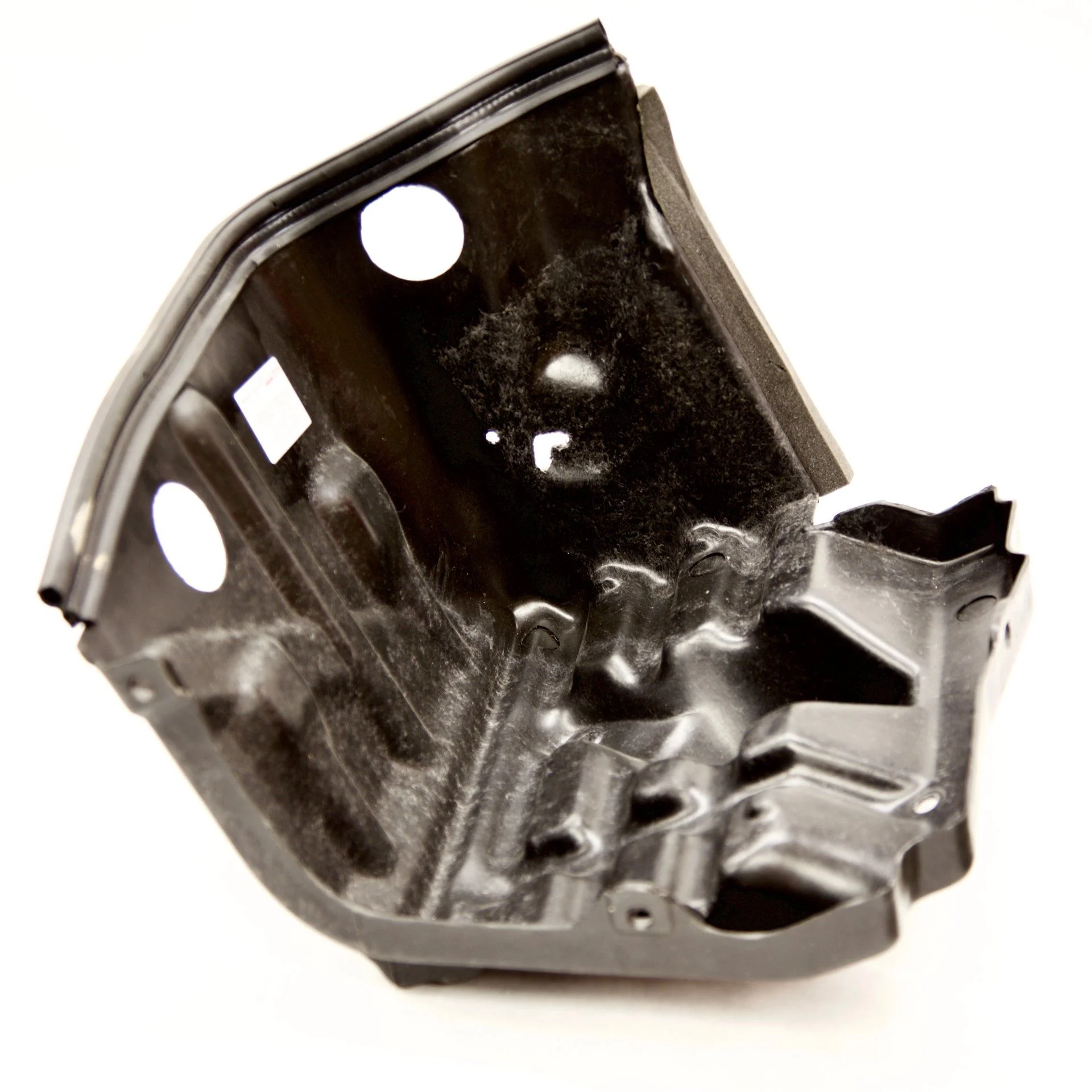

One stop shop is appealing to many people. Might want to reconsider offering the second tray.
Agreed. Its a bit more difficult to get and make money on Toyota Parts. I will make it easy to get a second tray, just not sure it will be from me yet.
Perfect timing on this @LC4LIFE! I just received shipment yesterday of new OEM Toyota 91/92 battery trays and got them listed on the site. Was planning to just market them to folks who wanted to build their own setups, but now it'll be great to have your kit accompanying them! We will be adding OEM hardware in the near future as an option, as well as upgraded hold-downs. Toyota Land Cruiser OEM battery tray
