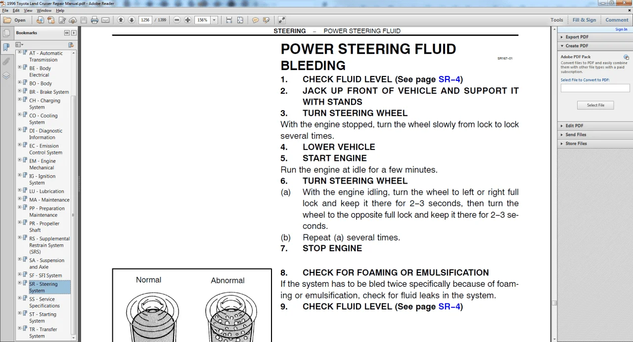

Has the pump been bleed properly? Turn the wheel lock to lock about a million times with the truck off and the front tires off the ground to bleed all the air out.
When you get bubbles, replace with fluid, compete until you have no air, then start and make sure you see fluid pumping in the resivour...
That's what we did. First with the reservior open turned the wheel lock to lock watching the bubbles comming out. Then we added new fluid three times and when the car was operating and wheels were turning there were no more bubbles comming out. But you think I should give the pump more time and turn, turn, turn?
I had to turn mine about 100+ times with the wheels off the ground, going SLOW, and HOLD at the locked position to allow the bubbles to come up. I had to fill with fluid at LEAST 5 times, and this was only after replacing the hoses, I did not replace a pump or a gear.
Thanks for the info! So I guess the pump might be good after all. I'll turn it more tomorrow (I can't get wheels of the ground in my place) and see whether that helps.
But... comming back to the main question: does it damage the engine when you drive with a damaged/not fully bleed-out pump?
Using the logic of the fact that it is a gear driven pump, cannot be disengaged, and runs the entire time the engine runs, I would say do not run it unless there is oil in it and it has been properly bled.
Air does not lubricate. If there is air, it will overheat and the PS pump may melt down and lock up, then break the driven gear on the engine, and thus, break the drive gear on the engine. I wouldn't do it.
Hmm... this might sound dumb, but from what you wrote I deduce you also bleed it with the engine OFF. I ask, as my mechs did it with the engine ON.
Otherwise I'd assume that the process of bleeding out the pump could result in overheating the pump and damaging the drive gear.
I'd also also assume that once the pump has been correctly bled out and has fluid in it, but it still does not work (e.g. pressure generating valve is damaged) one could still drive the car. Right?
Definitely bleed it with the engine OFF.
The "pressure generating valve" is a lobe type gear pump. It is just like another set of gears rotating inside each other. Once the gears have worn so badly that all the pressure is bleeding past, then, theoretically, you could drive it. HOWEVER, that means that any pressure and PARTICULATE that being generated is also circulating. I would have to have a SERIOUS reason to have to drive somewhere else with a non-properly functioning pump to continue because you will continue to degrade the pump, steering gear, and possibly engine parts if a catastrophic failure occurs.

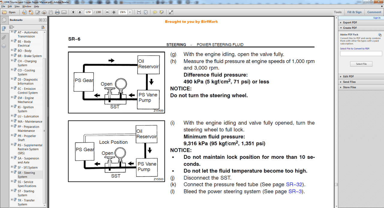

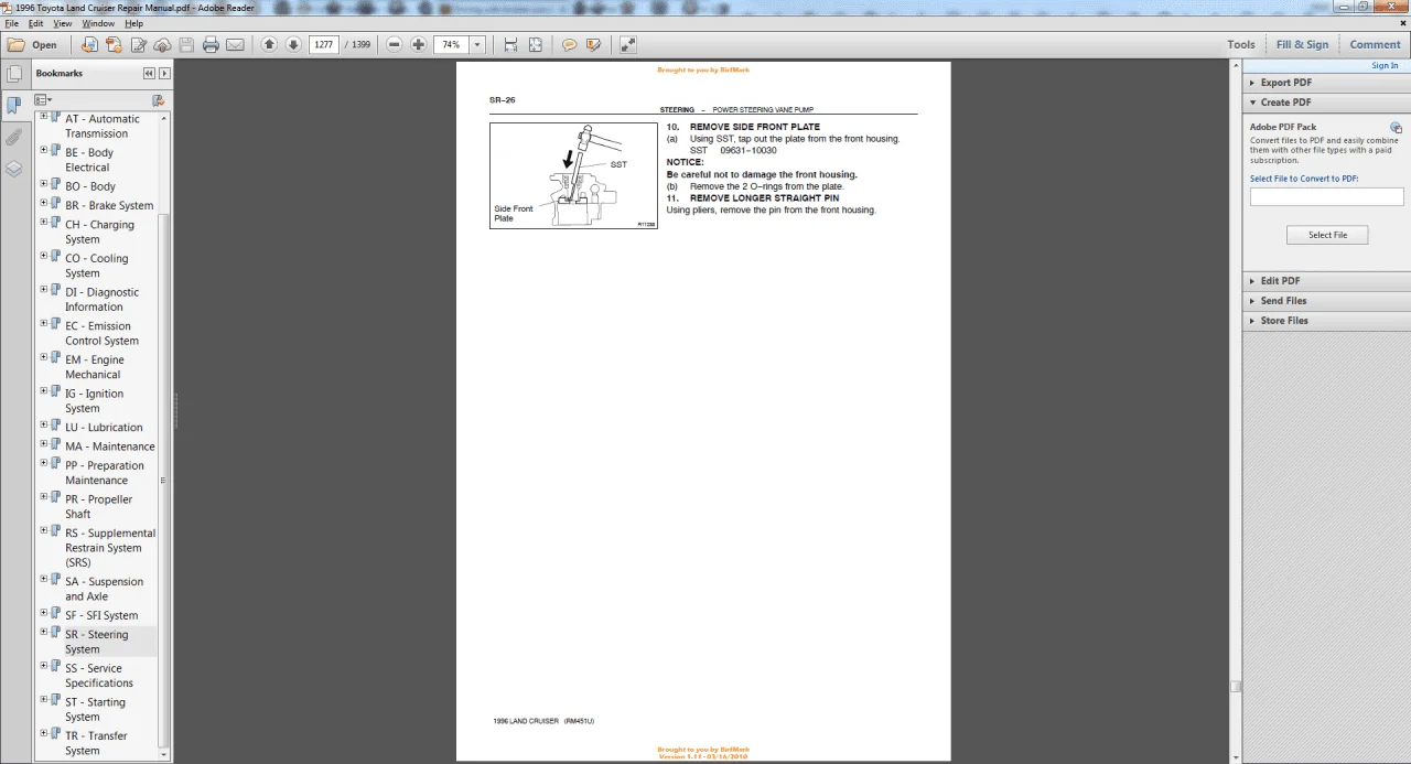

More info:
Look at the diagram at the bottom. If it is indeed not working and you need to get out, take off the pump, disassemble it, remove the 10 vanes of the pump, put it back together, making sure it is sealed up, pour oil in the system so it has oil in it, and drive it . It will steer INCREDIBLY HARD and you need to keep your lines hooked up to the steering gear in order to prevent all oil loss. Your will only be able to steer it while the vehicle is rolling.
Continued:
Could also remove the drive gear and put it all back together so the pump doesn't turn at all.
