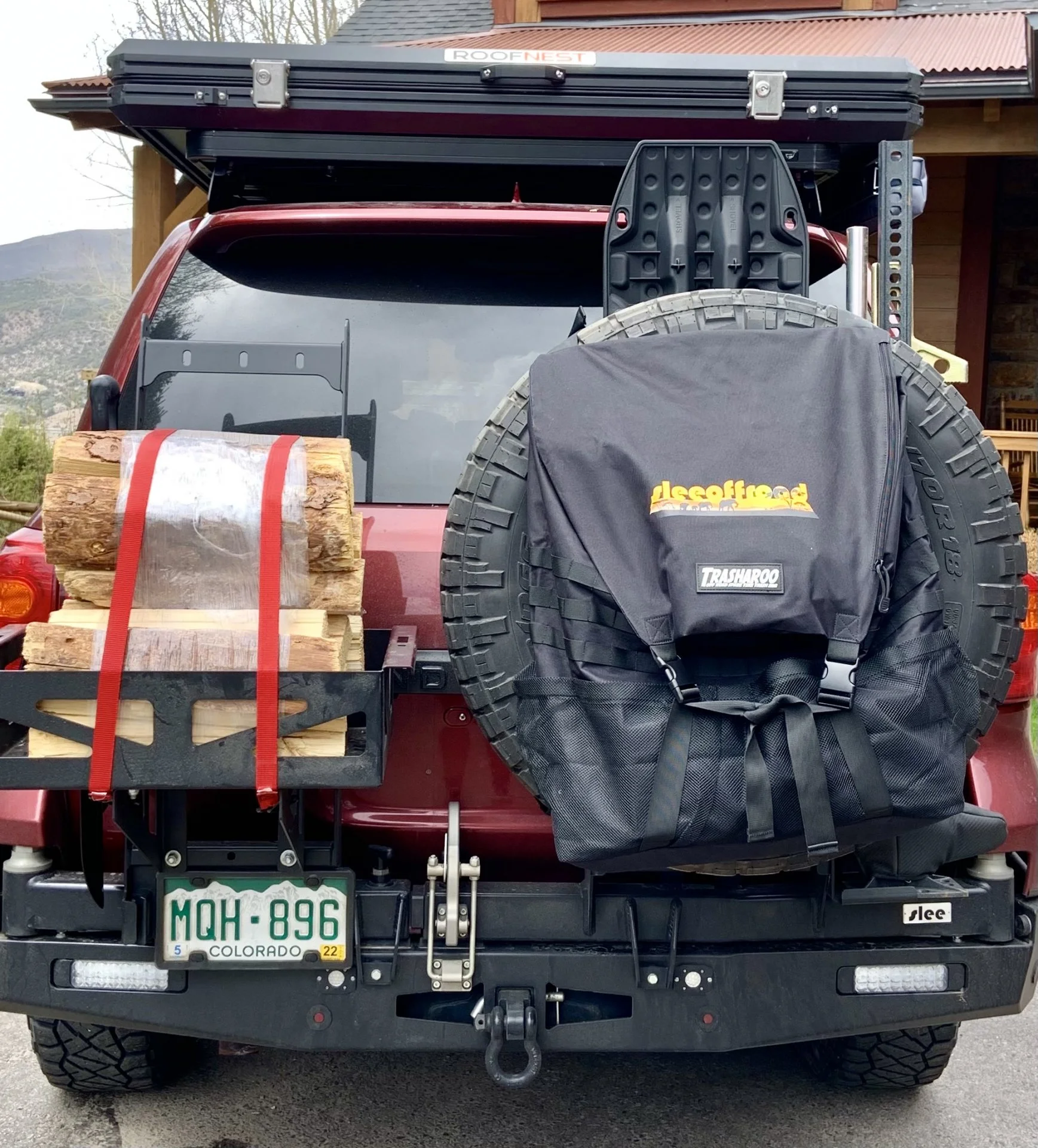

I also have a Roofnest mounted to a Frontrunner Slimline. You notice it a bit, especially in the wind, but very manageable.
