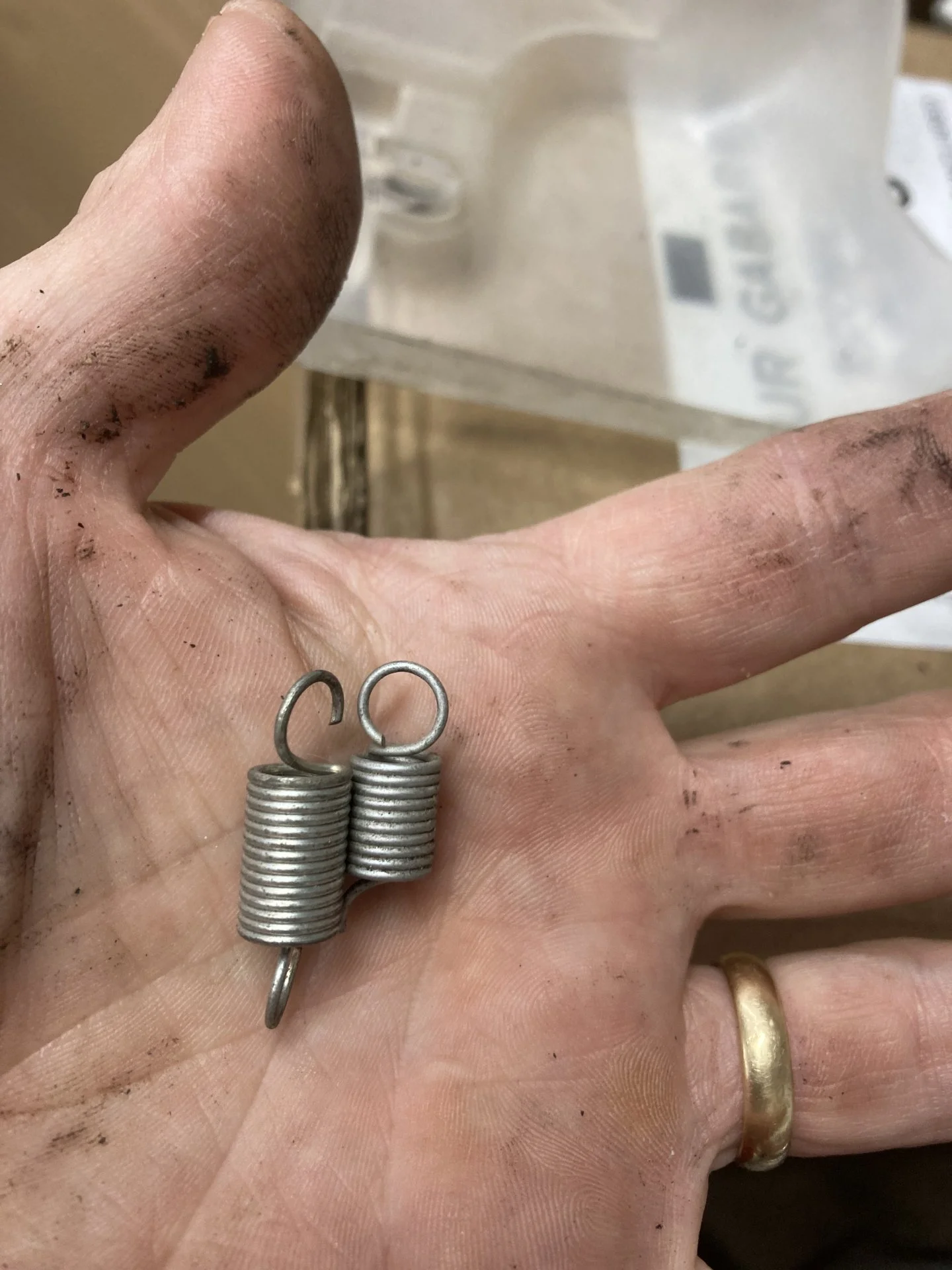

Drivers door worked fine this am, now it can’t be unlocked with the key or the pwr lock/unlock switch nor the manual lock/unlock knob.
The inner door handle will not open it either, it’s like it’s disconnected.
The lock/unlock knob will not full travel either.
I need to get the door card off but it’s gonna b very difficult if door is not open🤦‍♂️
Is there a way to slip a “slim Jim” down to manually open the door?
s***, just found a thread with the solution🤦‍♂️

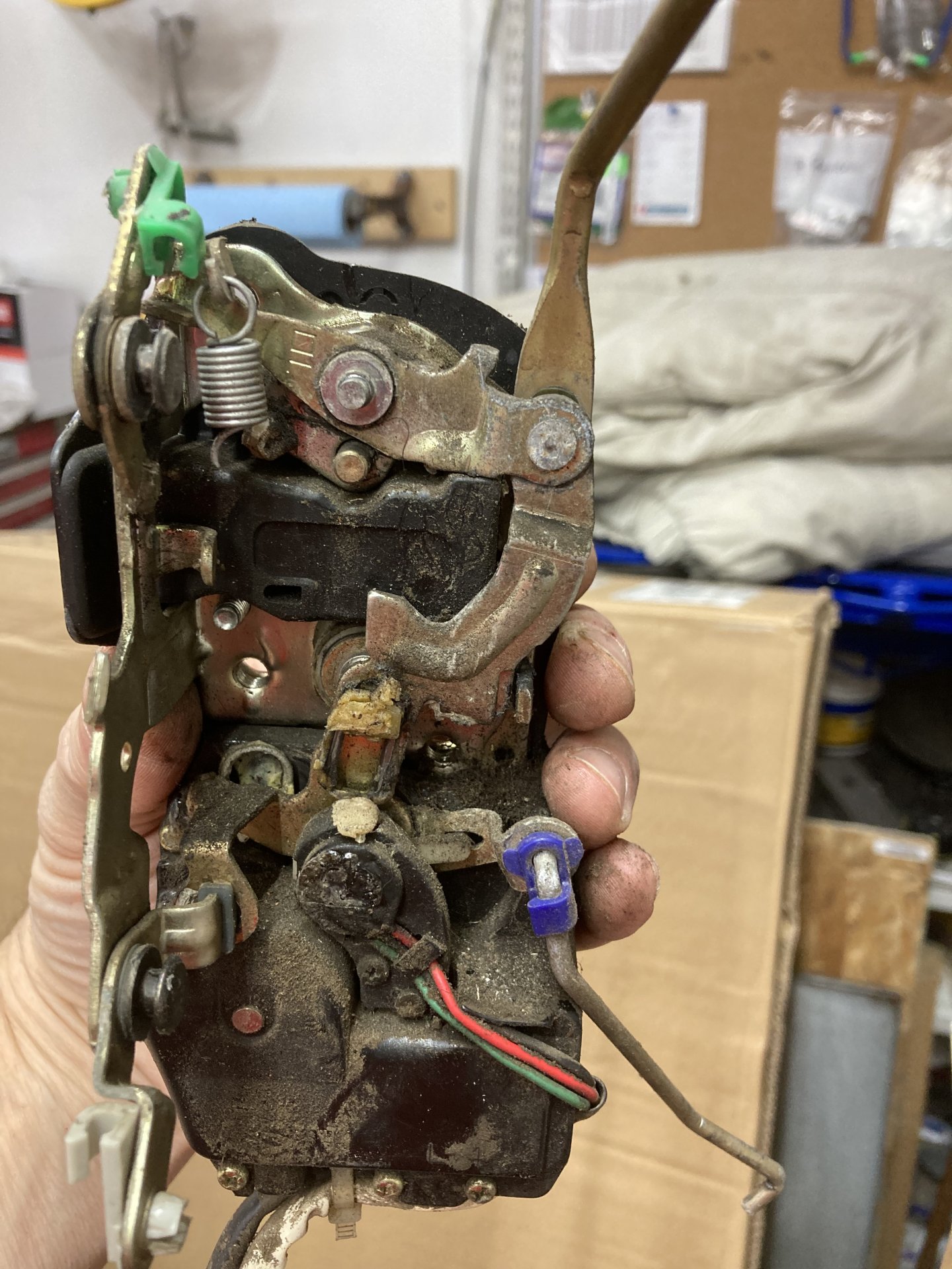

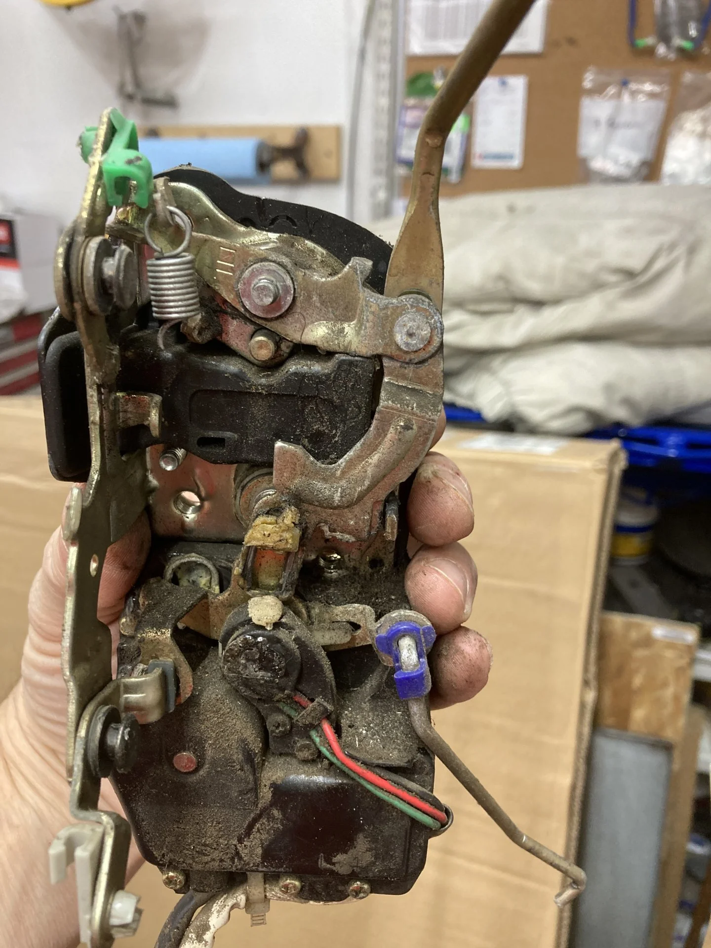

Findings and rectification

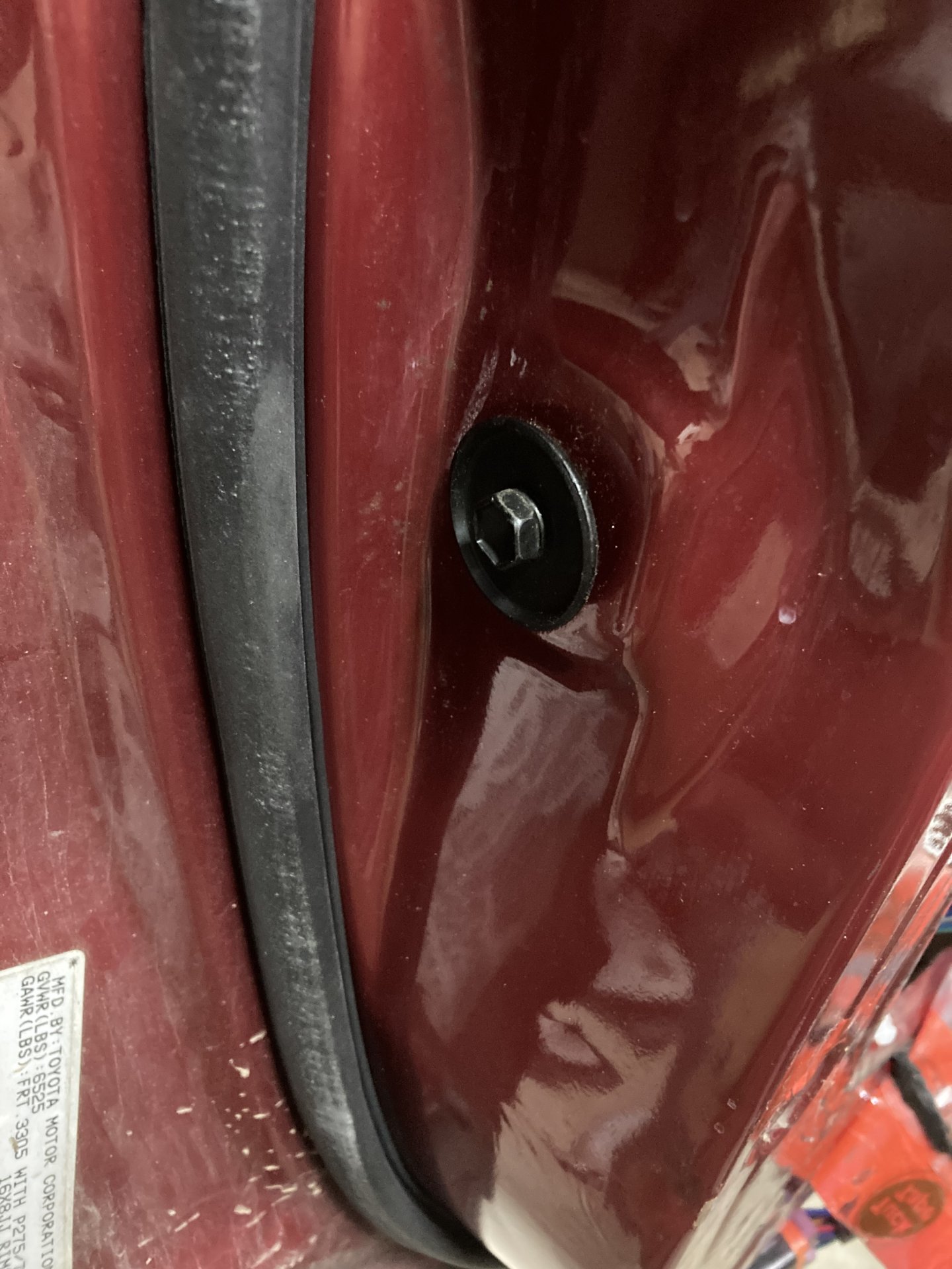

Access required

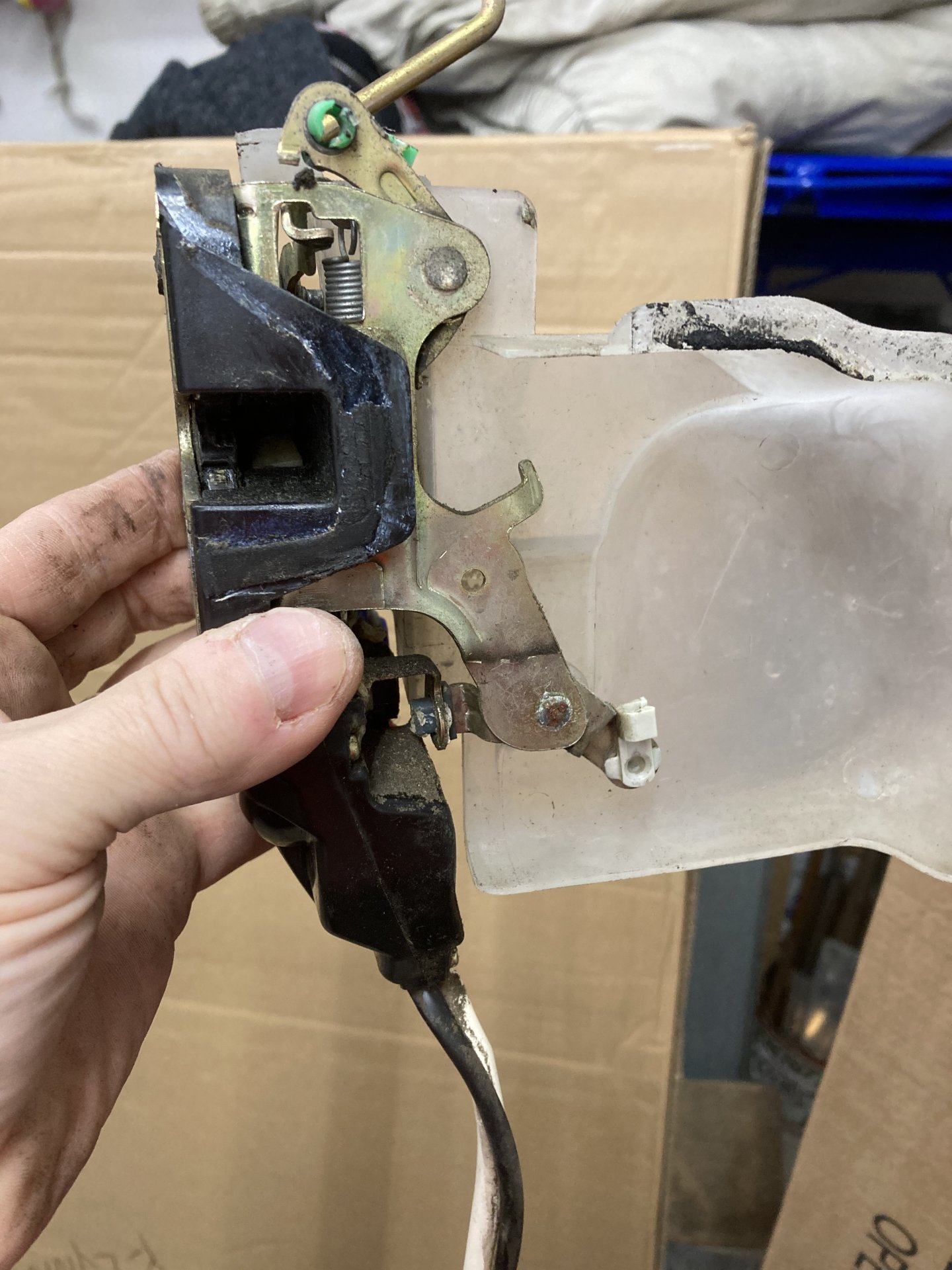

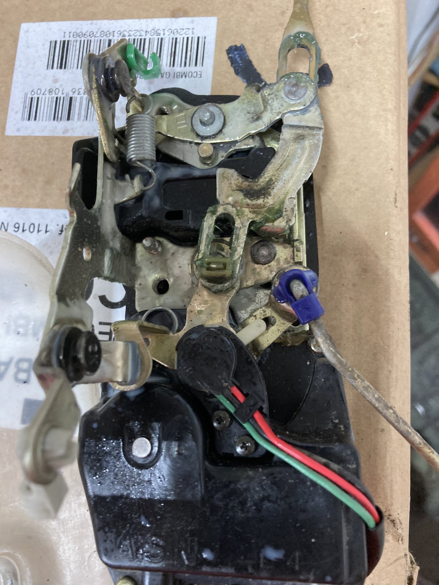

Cleaned, lubricated and spring replaced
Replaced spring and lubricated

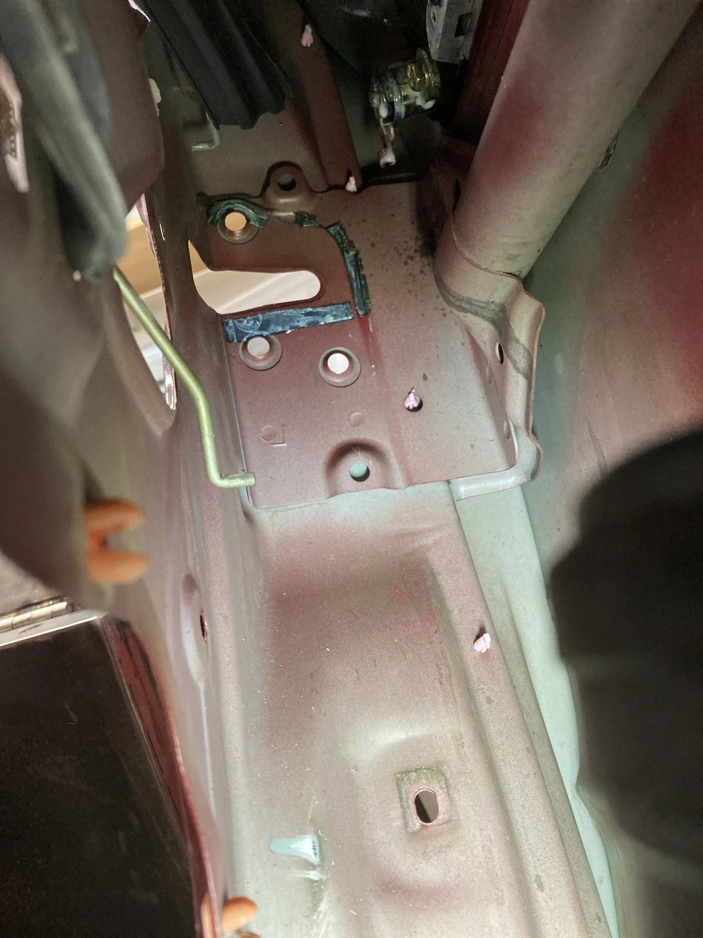

Access with lower window run channel removed

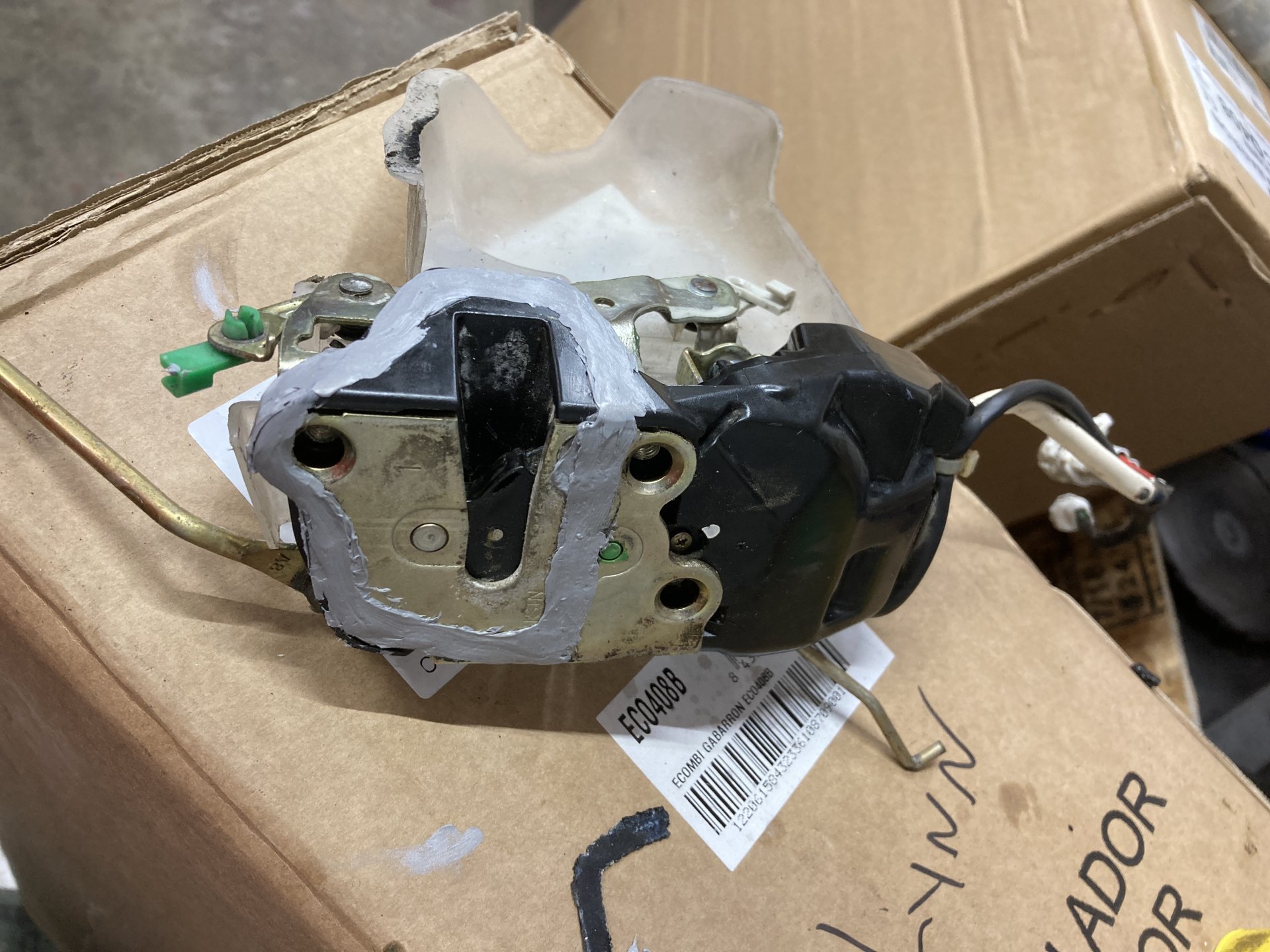

There is a thin foam gasket, it’s dead, so I used some gasket maker. Installed after it was partially cured.
Didn’t have any black
