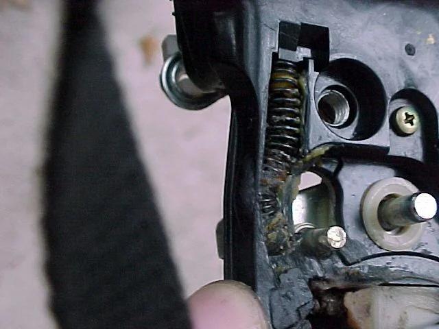

Apparently the spring has been “blowing out” this yellow plastic and causing the door latch to stop functioning.

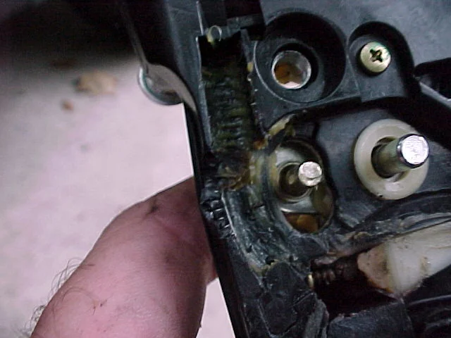

Is the OP discussing the known issue when a coil spring of the door lock actuator presses against the (too thin) side of the plastic which wears through over time then blows out??
If that's the same issue the problem is under the metal plate (see photos)
Here's one thread, there are others:
You nailed it @Kernal. That’s exactly the thread I needed, wish I would’ve found it sooner.
I’ll be saving that for future reference, or in case someone else post this issue. Perfect!
A few people have tried to fixed the issue, IIRC one person may have installed a short piece of metal with epoxy to fix the blown out plastic edge?
Search and you'll find it.
