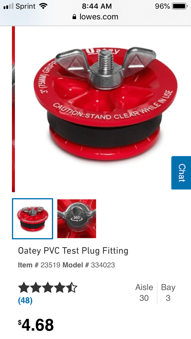

Still putzing with the gas tank, lotta rust in there to dissolve before I POR15 gas tank liner that thing. That gallon of EvapoRust I won at a long past raffle finally got some use. The only inlet I'm having trouble sealing for this process is the main 2" spout. Don't see a 2" pipe plug anywhere local. My next step is a piece of a truck rubber inner tube and a hose clamp.

Use one of these Dan
Thanks Burl. I hadn't seen one local, but just found a listing for that at a nearby HomeDepot thanks to you. Will hit it on the way home today.
