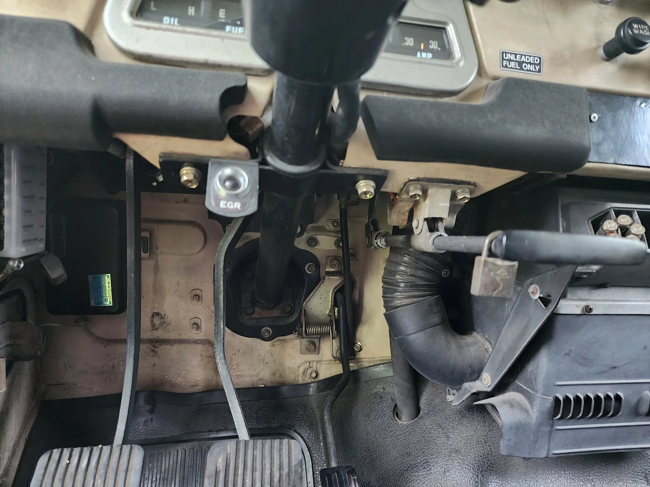

I’m going to jump into the conversation here because I have the same problem: the 2 rubber tubes on the engine-side of the firewall of my ‘73 FJ40 are completely dry rotted and falling out.
I need to understand a little better what these drain lines do. The lines look like they drain the well at the base of the windshield, but some of the posts here show pics of lines INSIDE the cab.
How do these lines work? Mine look like they simply go from the firewall to below the frame. Am I missing something??

You're correct that's what they do. Some later yrs the drain tubes went thru the trans hump, inside.

These are called rain leader hoses in the catalog. They are like sunroof drains for the cowl vent.

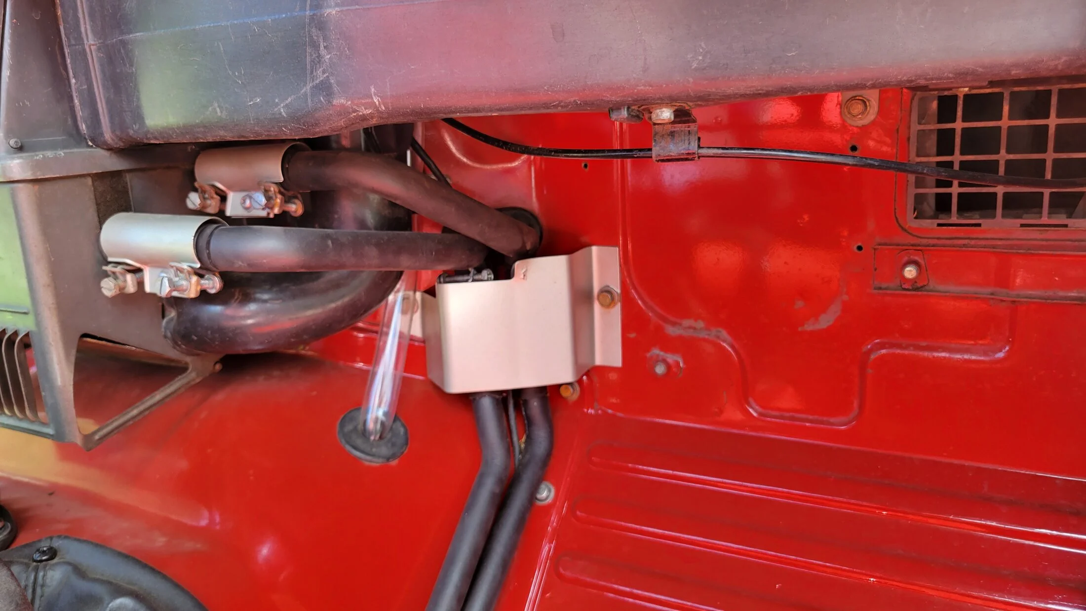

They exit out the firewall. Here is a pic of mine after I changed out the grommet on the pass side. This is a 66 so your's may be a bit different but you get the idea.
