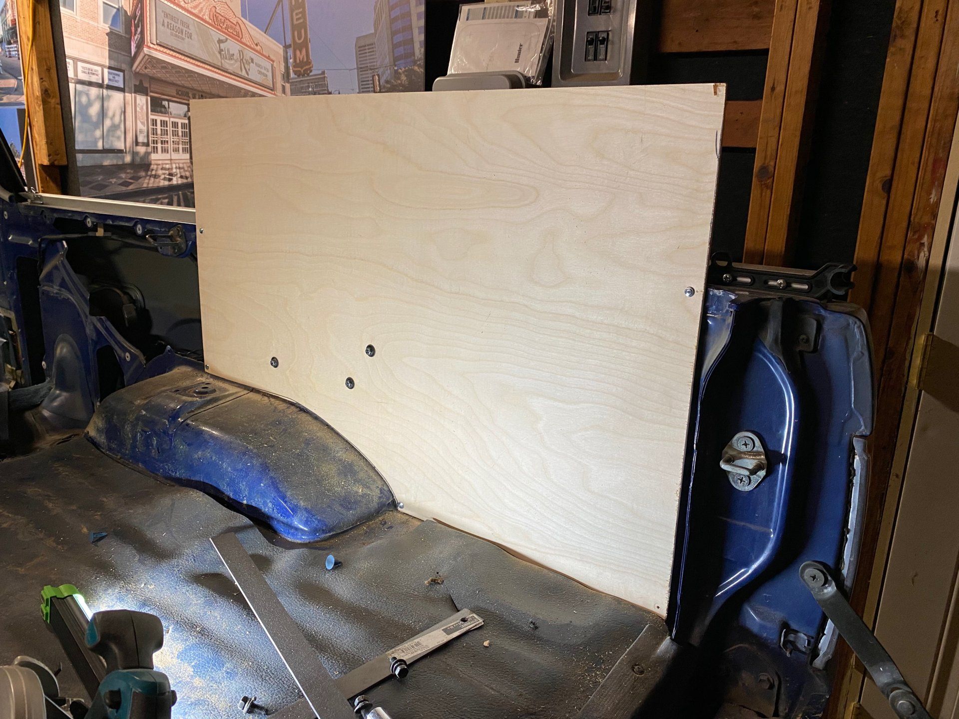

Working on installing my air compressor. So far this is what I have, everything is wired up and working. I think I am going to replace the entire side panel from the back seats to the tailgate with a single piece of wood. this will give me the ability to mount whatever I want and give me the strength of wood. The panel I have here is mostly a proof of concept.
Eventually I might wrap it in beautiful 80s blue carpet...

This is the full size piece of wood. I am planning to cut a storage section like the factory one in it. And of course cut it down height wise...
After that I'll put all the interior back in and should be good to go, filled the tires up with it today, very nice to have air again.

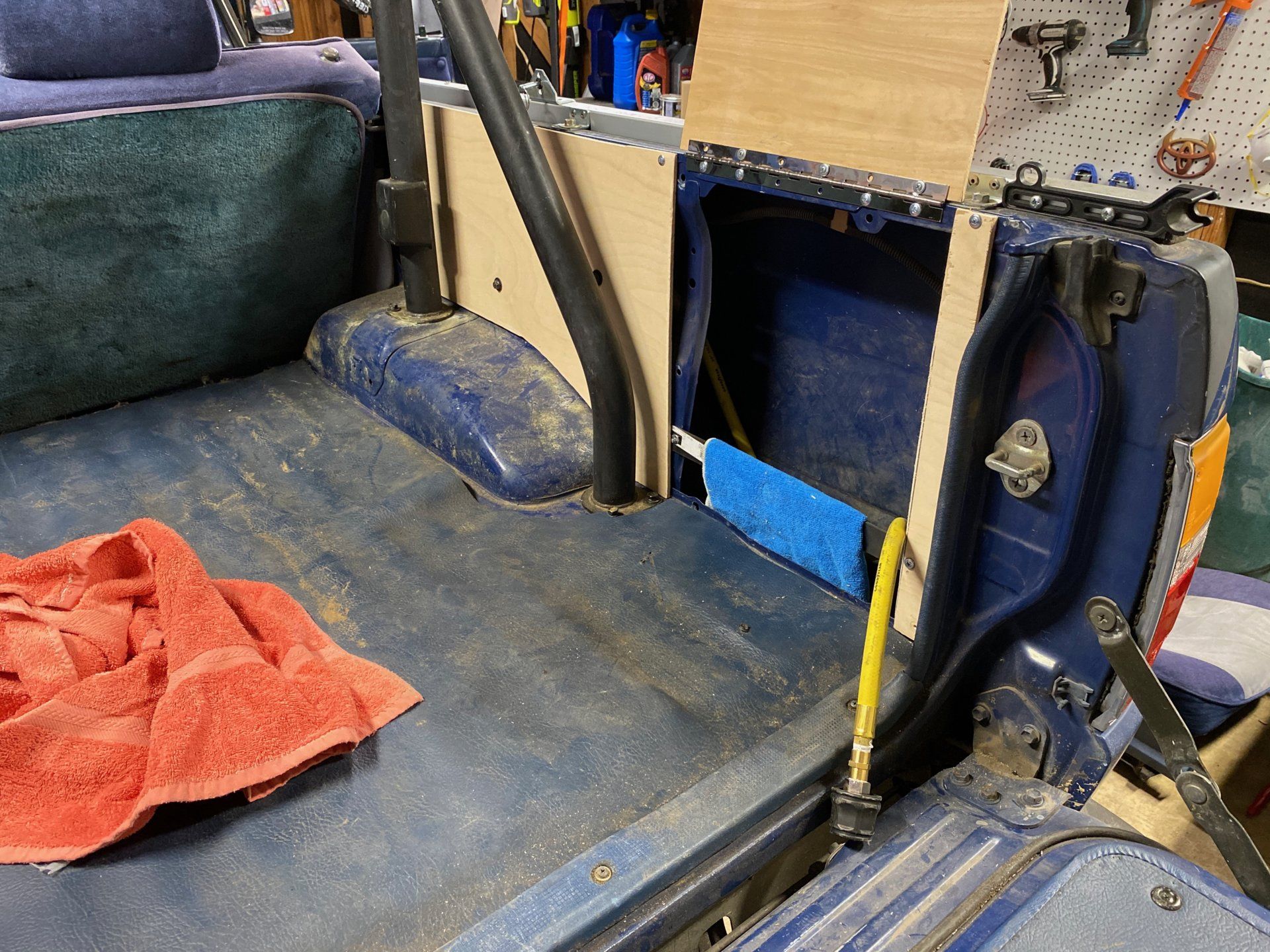

Here is what I am rolling with for now on the compressor mount and storage pocket. Once I am certain this is the final layout, I will cover it with carpet.
