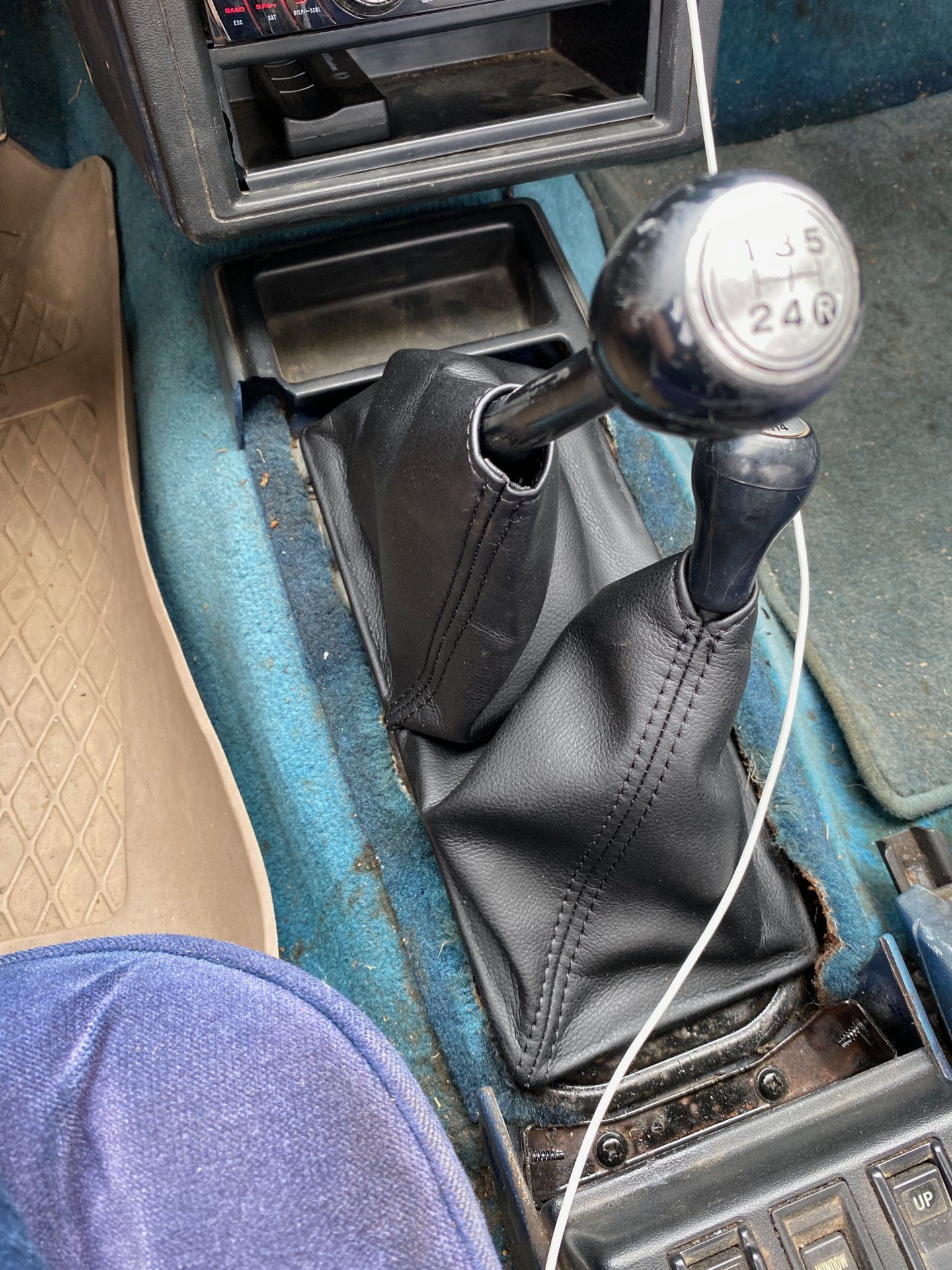

Well I replaced the shifter boots while I have the interior apart... The shifter trim decided it was time to make its exit and pretty much crumbled in my hands...
if anyone knows where I can get a replacement that isn't $300+ I would be forever grateful..
the new boots are nice though...
Poke around on your local craigslist for anyone parting these out. They are hard to find - took me months and months of searching to find one for a decent price.
