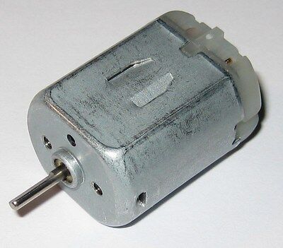

Will these work for a 04 Land cruiser as well?
Same here. 2004 LC. Did you find a solution for this yet?
EDIT: found the correct motor on eBay just using the similar items. The buyer I used for the incorrect motor had the correct one and he’s located in New Jersey not China so shipping is quick.
@fredward1 Did these work for you? I need to replace my passenger side front and driver side rear
I didn't read through this whole thread, so this might have been discussed already. I just replaced my driver door actuator. I watched a video on it and bought the motors the guy recommended, not realizing there is a difference between the earlier years (little brass bushing, plus the brass spiral part), and the newer ones that have a plain shaft w/ a D shape and a nylon spiral part. If anyone ends up in a bind, the brass part can be pulled off, and a little bit of work with a file and it'll fit everything just fine!
This feels like good information. I have a 2003 LX470 and it seems that a lot of my parts end up right on the split year difference. So it’s nice knowing that a little bit of custom work can make either one fit.
