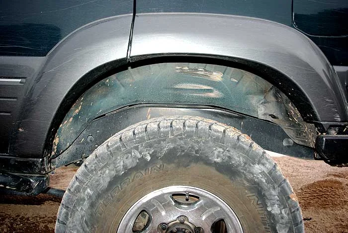

Typical 315 rub:

Rubbing seems to vary too. With 315/75R16 Goodyear MTR Kevlars on factory rims with factory bumpstops on the above lift, I get the inner rear wheel well rub shown in the photo above. However, before I added a 1" body lift, I also had a more problematic rub on the inside metal lip of the fender that was cutting the tires, as well as more pronounced contact in the front wheel wells. After a couple wheeling trips, I can confidently say that the 1" body lift has cured the problematic rubbing.
I'm very happy to run my low suspension lift (2.5") with 315's and zero rubbing problems on the factory bumpstops--I'm able to utilize the full range of motion offered by the standard OME shocks. With the wheeling I do (not extreme but not too shabby, either), I never lift tires. I'd worry about my coils getting loose with L-shocks, and I haven't found myself wanting more suspension travel.
