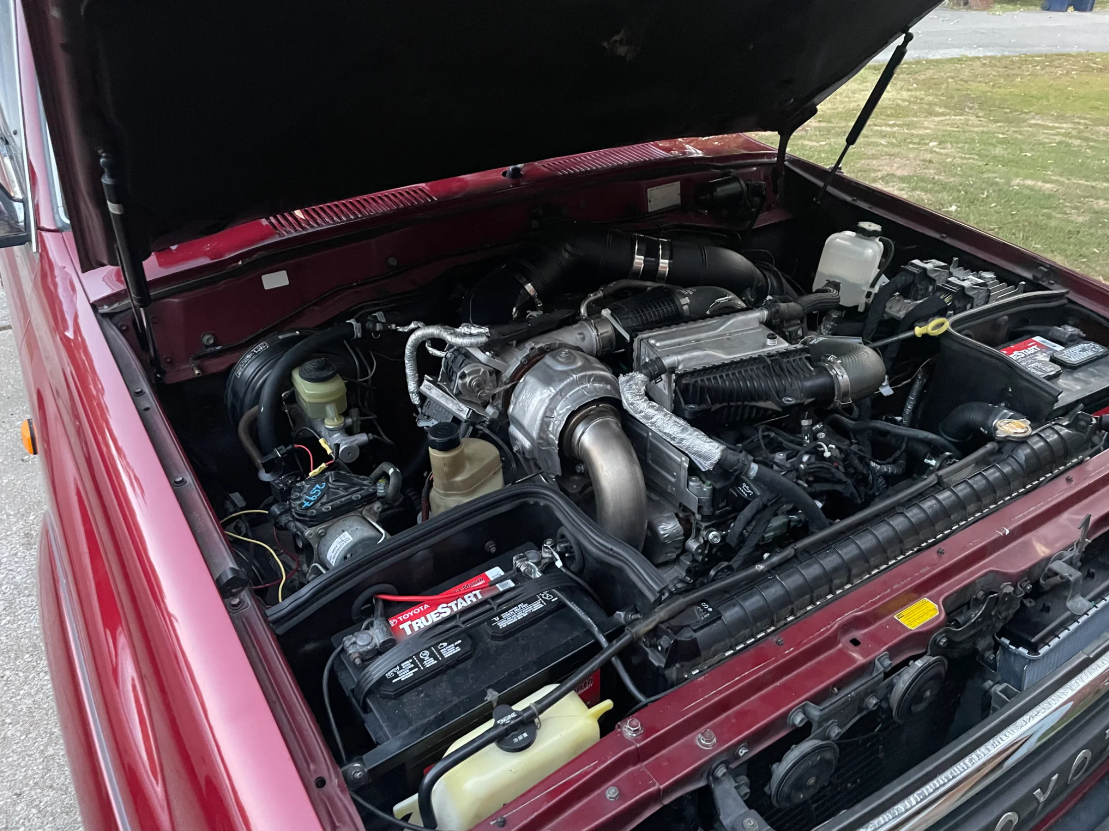

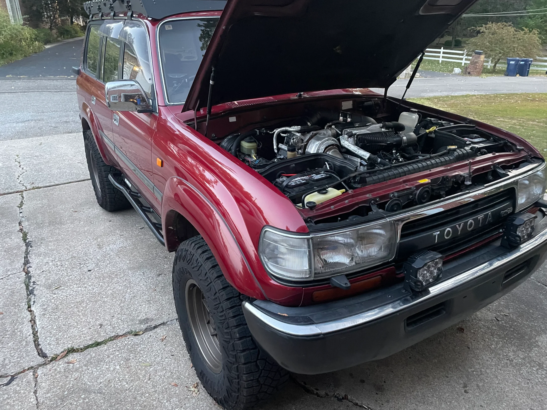

Attempting the next best engine swap for 80s IMO
Jealous of the cloth seats.
So I’m using the factory tcase. With the LT1 swap I used Torfabs adapter and mounts.
So with this I used the same transfer case adapter since it worked with this 10 speed and just made my own mounts

If I were a betting man, I wouldn't expect to get better than it does in its original home. Not sure how the weights compare, but the 80 is aerodynamically, terrible. They put those big front ends on all the trucks now.

Time for a little update. So I’ve got the truck up and driving after a hard battle with a no shift situation lol. Ended up being either a bad TCM or it didn’t take the tune very well. These new GM engine and transmissions are no joke when it comes to programming compared to any LS based stuff.
So this is cool I ended up buying an auxiliary radiator from a new Camaro that fits in its fender well and it fit perfect behind the front grille. That is the new heat exchanger for the intercooler
So this was the other pain in the ass about this swap. Power steering and power brakes.
So here installed is a Volvo electric power steering pump
And for brakes I just ended up going the easy route. My plan originally was to buy a Ibooster from a Honda or something but didn’t feel like dealing with brake lines at the moment, maybe in the future.
But this is a vacuum pump from a Tesla Model S I’ve used these on a couple builds and they are hard to beat for the price and they are super quite.
Also I picked up a vacuum switch from a Volvo also so the pump doesn’t run constantly
I still need to tidy up the pump wiring I was just in a hurry to drive the thing
Then made a mount for the ECM on top of the fuse box, and the TCM lives under it. Also mounted my heater exchanger tank on the same mount
And that’s about it for now. I’m waiting on a new MAF sensor to show up since I guess the one I have doesn’t work.
I don’t think it’s making full power at the moment because of the MAF sensor but damn is this engine and transmission smooth going down the road. I personally think way better than the LT1 and 10 speed but after some long road trips I’ll know for sure
Last thing is I got some 37s today that will probably go on this weekend. Should bring RPMs down on the interstate hopefully helping a little with MPGs
