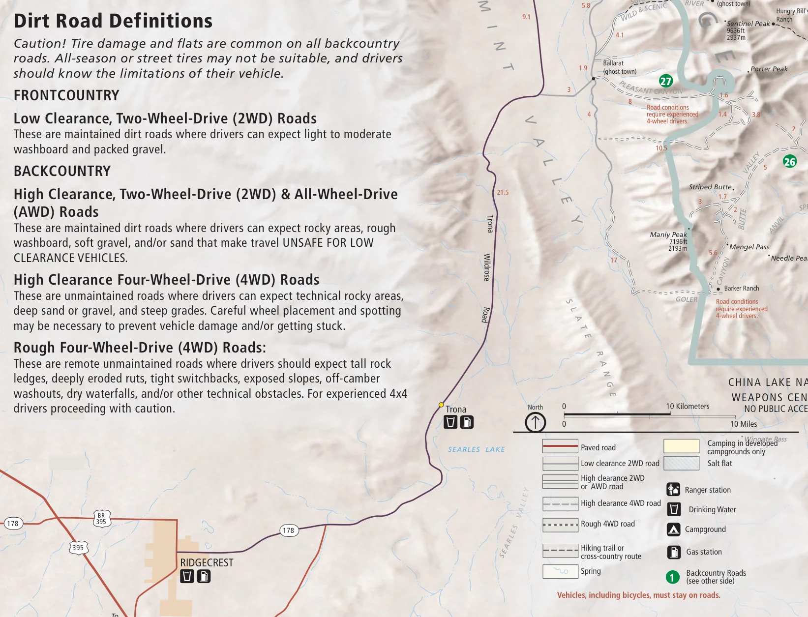

Q2. I ASS-ume that the 'high clearance 4wd' roads (as opposed to the 'rough 4wd') in DVNP will be easy enough if I go slow enough in the LX. Approaching from the north via 395.

as long as you stay on the 2 tracks (noted park roads), you should be good.

I take it that means what the park officially classifies as "high clearance 2wd/awd roads"?
Like, gravel or dirt/light sand and not sharp rocks? I guess I'll know once I'm there, did check some YT videos and anywhere that's not deep sand or rocky seems pretty passable and unlikely to cause tire damage.
