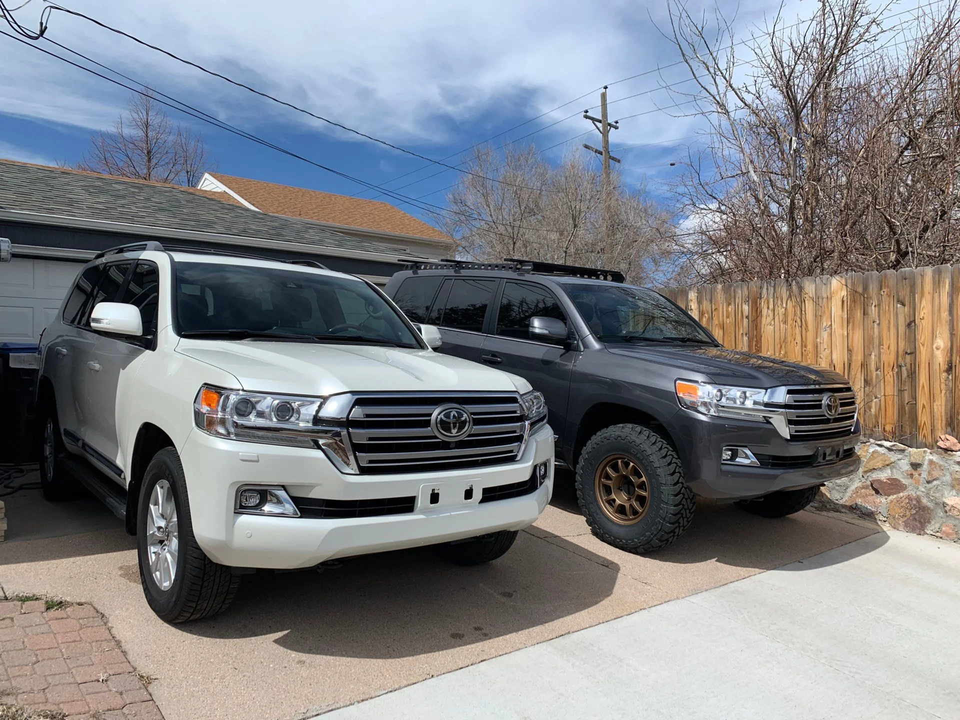

As with previous vehicles, figured I'd create a build thread for my 16 LC200 Dog Hauler with 26k miles out of Texas. Originally purchased the Gray one with mods and mentioned in post #51 I decided to get the White for a clean slate. Dubbed the Dog Cruiser because my pups have a serious influence on finding the perfect overland vehicle!
Current Mods on Gray, Clean slate on the White one:

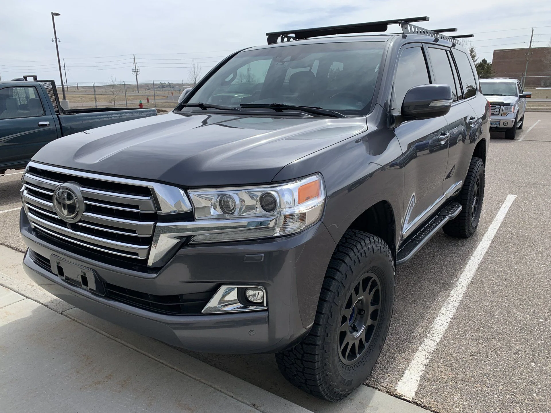

interesting that you are having rubbing with those wheels and tire size. I'm guessing on the kdss.

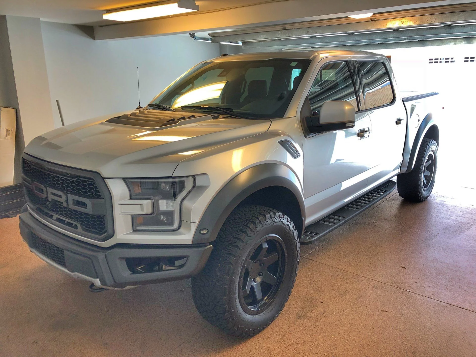

Thanks. I really love the Raptor, it's a great platform and besides reliability and size I didn't have much to complain about. It's by far the funnest vehicle money can buy IMO. That said, my 18 was in the shop for almost 2 months in a 1 year period for failed injectors - dealing with Ford service is a nightmare and that feeling of being stranded without a 75k truck is kinda sickening.
I missed Yota reliability and wanted less of a payment. Having previous history with a T4R a used LC200 just makes sense to me, more power and better interior which were my primary complaints before.

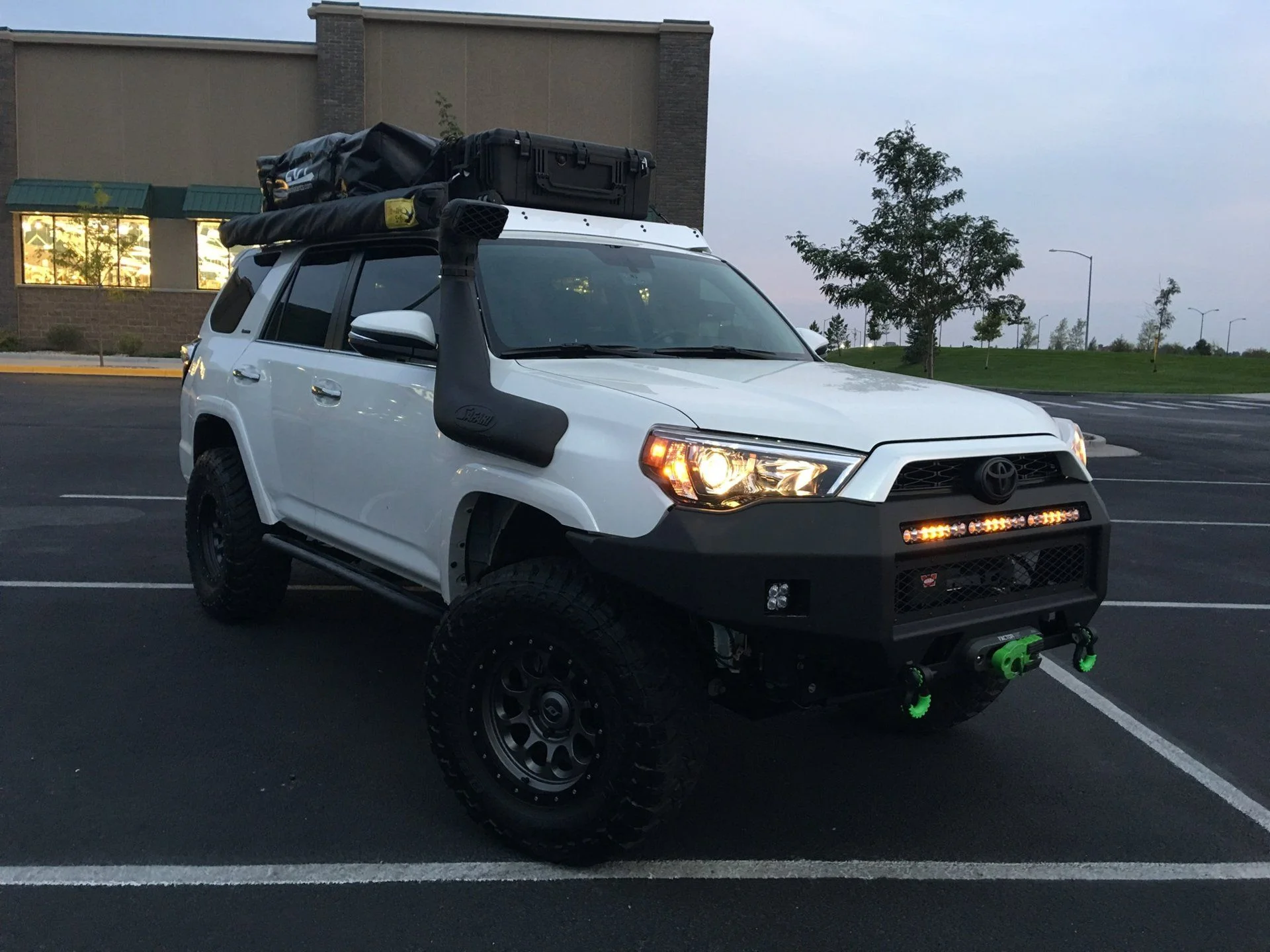

There's some T4R pics here:

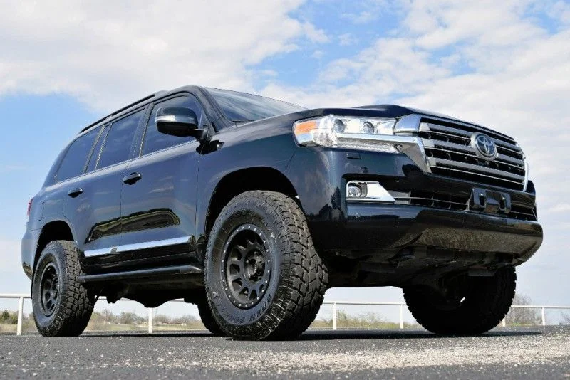

Here’s an LC on 17x8.5+0 Method NV with 285/75R17 Open Country’s and an Icon Lift:

Some people would rather fit the tire and others would rather fit the wheel, I guess myself (I have some 17x8.5+0 wheels on the way) and OP fall into the latter category.
True, but down sizing will help a decent amount, and hitting that fender liner with a heat gun and unbolting it with the 4Runner method, and then pushing it out wherever it rubs should easily fix any rubbing. I do concede that unfortunately some downsides are unavoidable, such as any serious up travel being lost (no tucking past +20mm really). Method does however make a wheel in the same design with a +25 offset instead called the 313.
He said he was going to stick with the 285/75, that's why I mentioned that the new wheels won't help. Keeping the Evo Course, but losing the spacer will solve almost any rubbing.

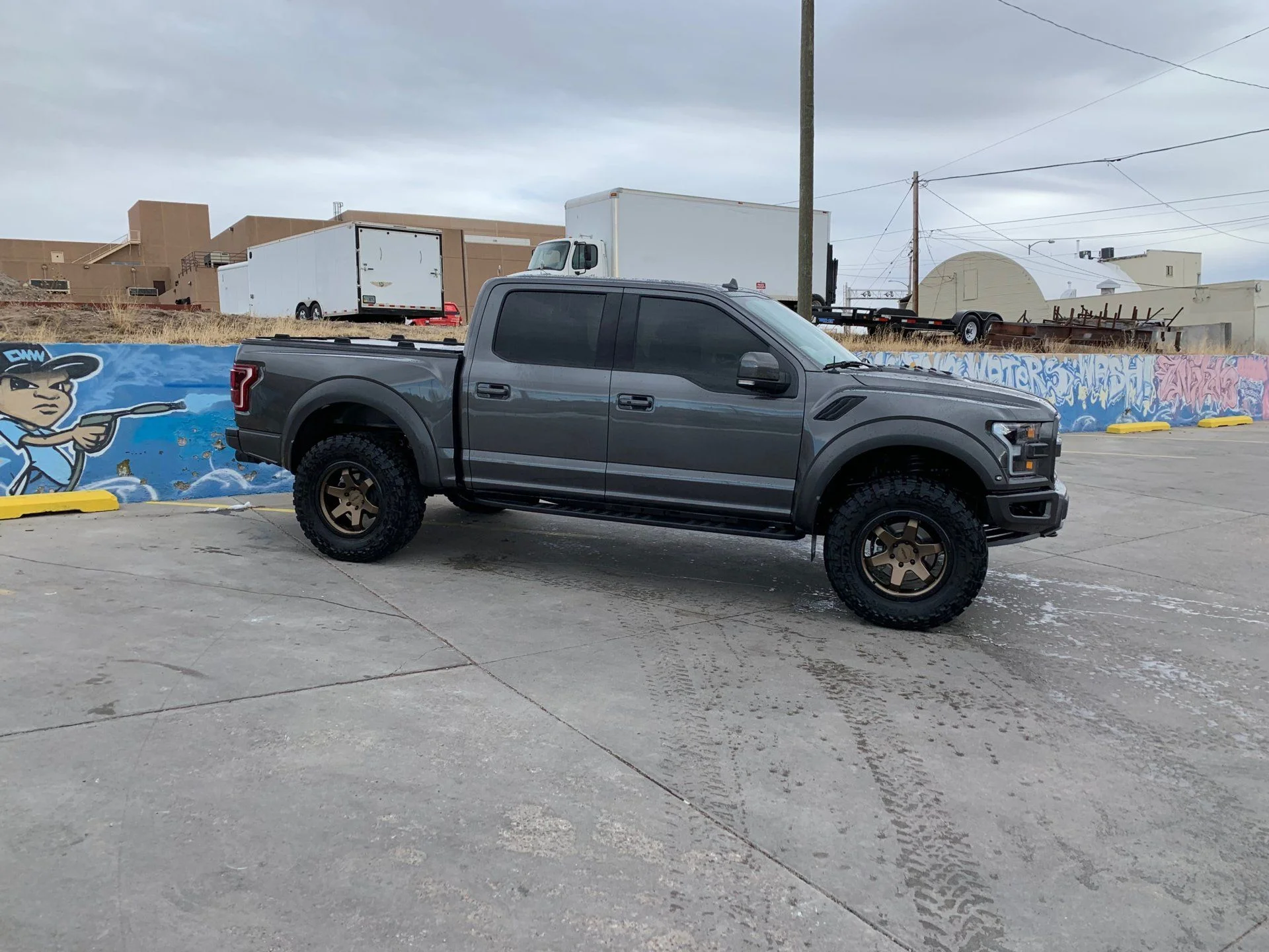

Glad to see someone else jumped out of their 2018 Raptor for a LC200... We were virtually twins... had the same Rotiform wheels on mine. We followed virtually the same path... I sold my built '16 TEP 4Runner for the Raptor and quickly jumped into the LC200 after experiencing issues with the Raptor (Ford Service is a nightmare). I will echo the comments of one of the funnest vehicles I have owned but the shear factor of not trusting a $75k truck did not sit well with me.
That's funny, the guy I bought the LC from did the same thing also! Although, I'm a little ashamed to have gone from a 18 to 19 then the LC 😕.

Ah gotcha, my bad, I only noticed him talking about going to 285/70 for the lower offset wheels. However, that LC I posted is running 285/75, so I still think it’s possible. Sorry if I came off defensive, I just feel it’s worth supporting and considering other options than what this forum normally suggests (Rock Warriors or other very conservative offset wheels). When I put on the 17x8.5+0 wheels I would in fact be going with 285/70.
