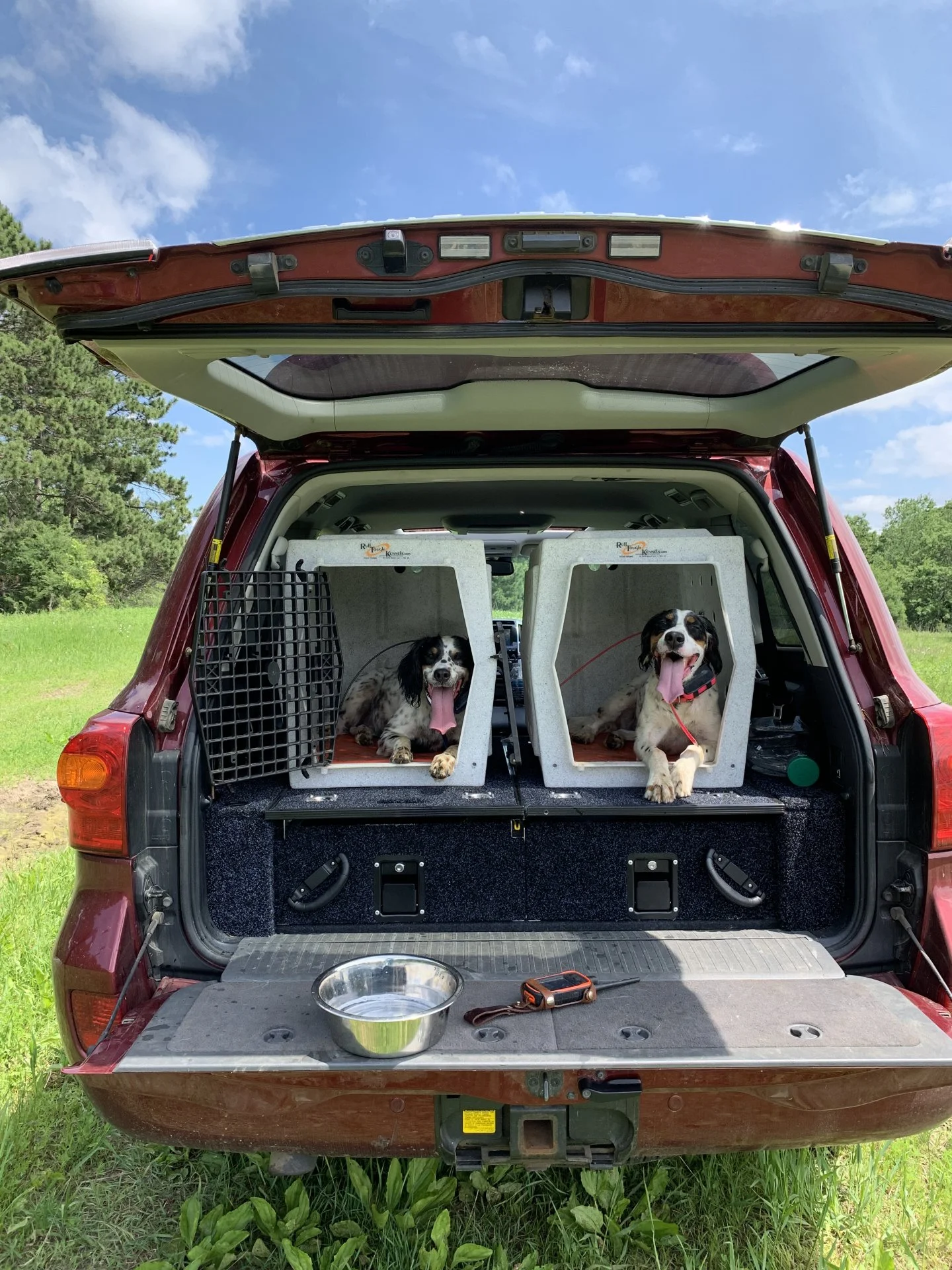

My setters are 40#. They are in Ruffland intermediate sized kennels. The drawers are Dobinsons. The kennel hold downs align nearly perfectly with the D-rings on the top of the drawers. I can just see over the top of the kennels when using the rear view mirror. I’ve been using it daily for several years and am happy with the set up. HTH, Ken

This is the setup I was hoping to see in use. Thanks for sharing and confirming the size and fit. Have you tried two large Rufflands side-by-side?

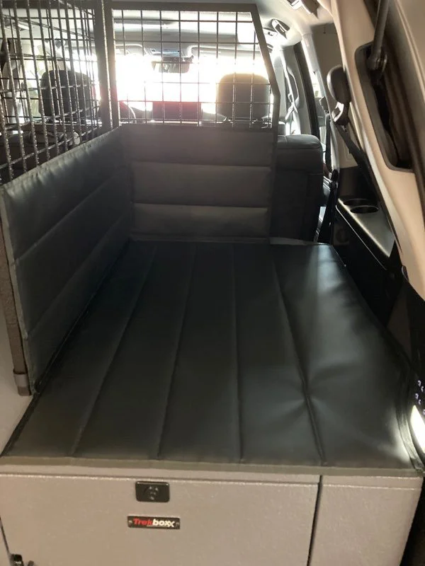

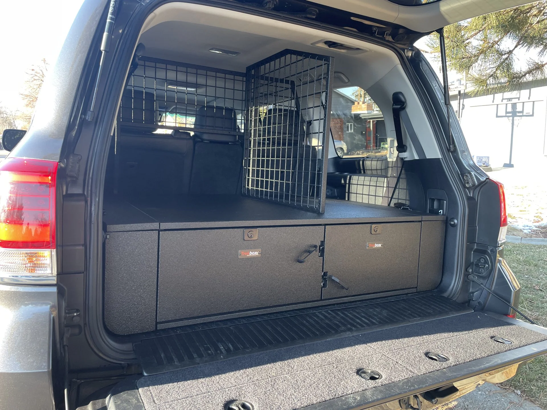

I asked Trekboxx to add a center divider to the Bravo system. Divider is offset to work with half the seat folded down. Four bolts to remove the center divider when not needed. Worked great for my Golden. He preferred the smaller side. currently sitting in my shop because my girls have too many friends. Loved it when I had it.
I have not. I don’t think they’d fit length, width, or height.
Mock up a piece of cardboard and use the outside dimensions from their website starting with length and height. I don't think you’ll get the SUV door closed. The kennel will be tight against the glass and the 2nd row seat back. If that works, mock up height and 2X width in cardboard. I don’t think that’ll work either. You’ll hit the headliner or seatbelt brackets in the upper corners.
if it does fit, it’s going to very close. It’s going to depend a lot on the height of your drawers. The SUV option might buy you some length help, but it’ll still be close.
Local to me both Cabelas and Sportsman’s Guide has them in stock and on the shelf. Ruffland themselves show up with a booth at a dog/hunting annual event nearby called GameFair. If you’re set on Large you’re going to have to find one or two to try in person. Ask if they’d let you take one out in the parking lot.
I’ve since added the bolt-on D rings to my kennels and now the kennels are fastened to the drawers. I notice they‘re missing from the photo. It takes 5 minutes to disconnect everything, 10 minutes to reconnect.

I asked Trekboxx to add a center divider to the Bravo system. Divider is offset to work with half the seat folded down. Four bolts to remove the center divider when not needed. Worked great for my Golden. He preferred the smaller side. currently sitting in my shop because my girls have too many friends. Loved it when I had it. View attachment 3053245
This solution is growing on me and has me rethinking the drawer + kennel option. Thanks for sharing.

I like this a lot. I have 2 Airedales, 22" and 24" at withers, 52 & 65 lbs. So, I will need the bravo. I hope the Trekboxx move is completed soon.

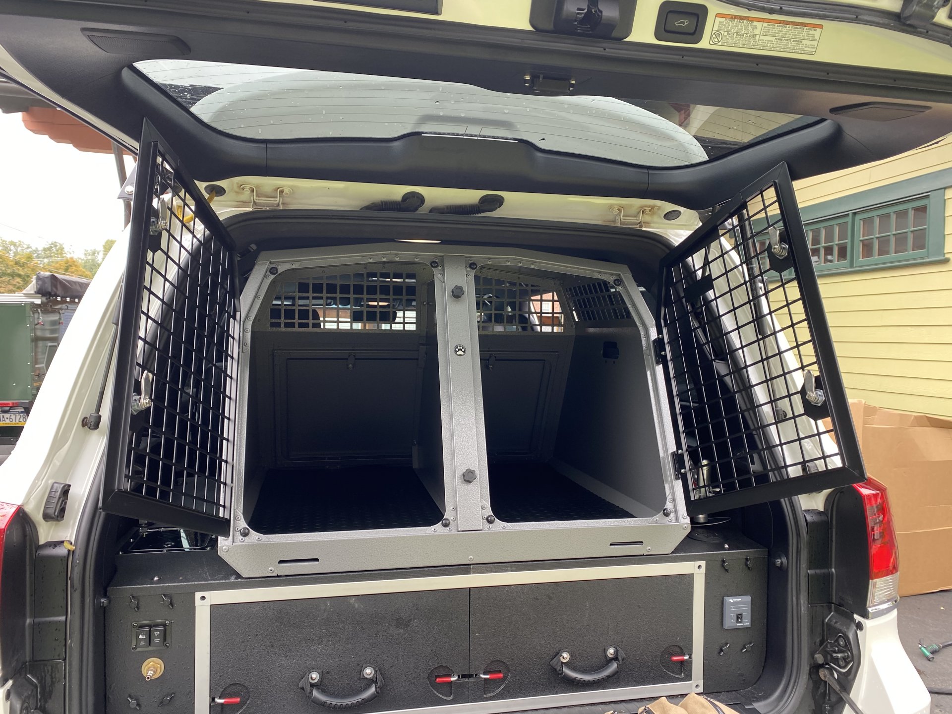

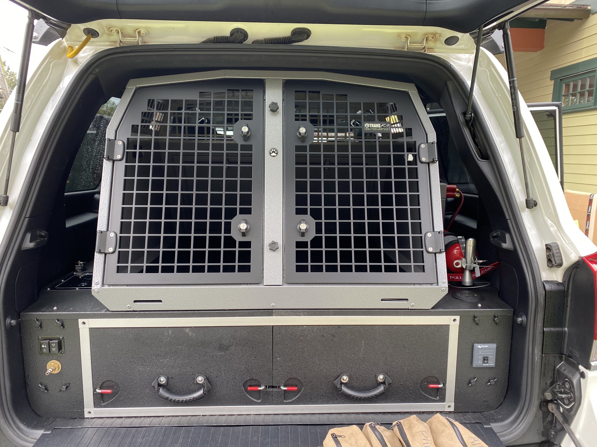

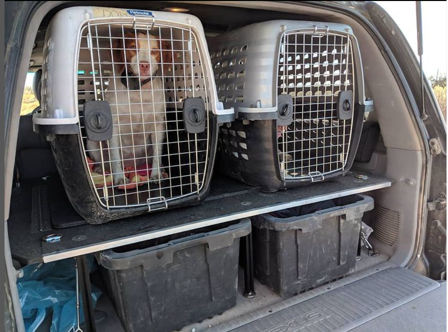

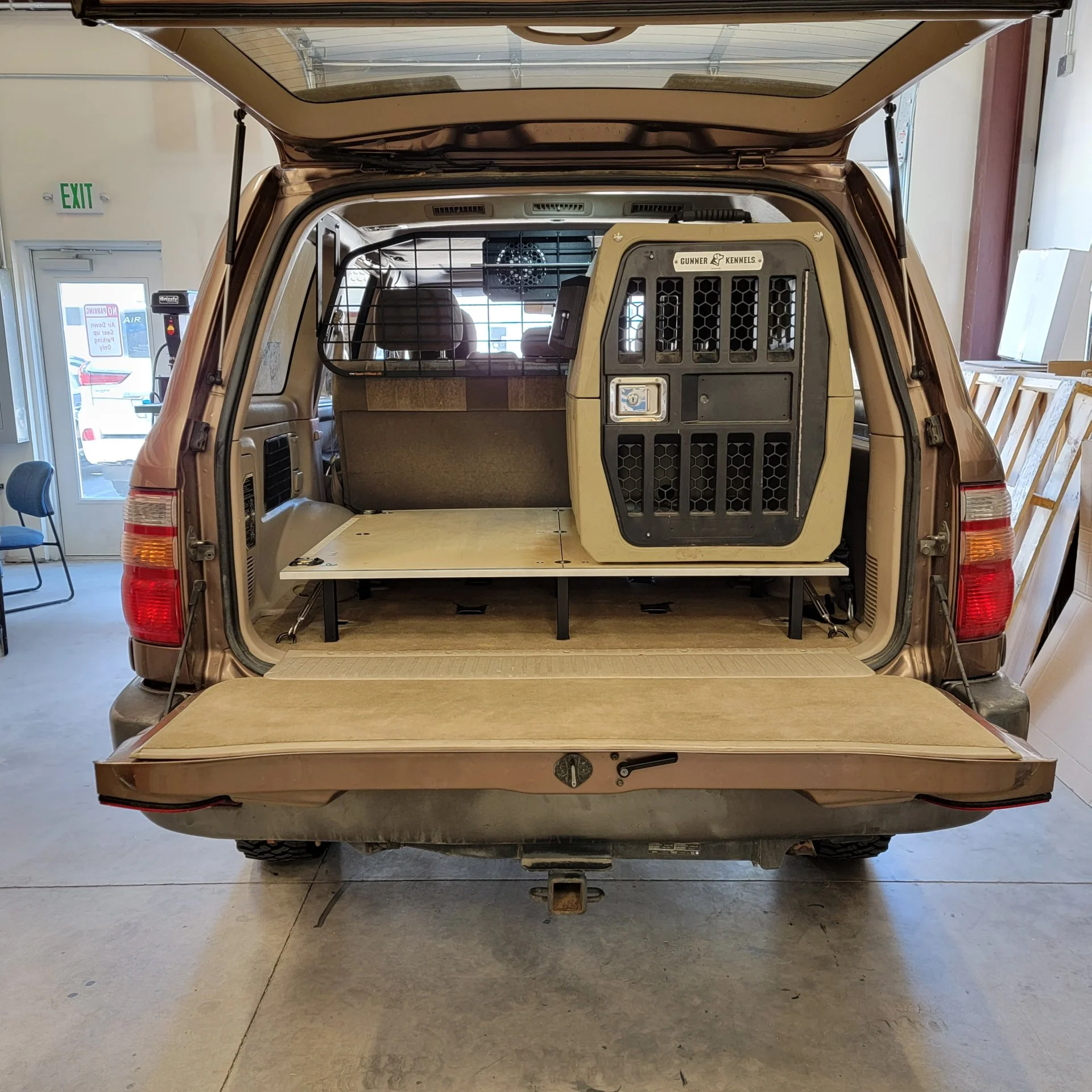

We have had a handful of Air Down Gear Up customers running various kennels with a few of our configurations. First picture is obviously a customer that opted to not have the drawers themselves, but that can certainly be added to the system. Second picture shows another kennel on top of a set of drawers. 3rd Picture is a recent install we did with a very-low-profile platform to accommodate two large kennels. We could accommodate a low-profile drawer with that as well.
We've used the Gunner kennels in the past, good stuff.
