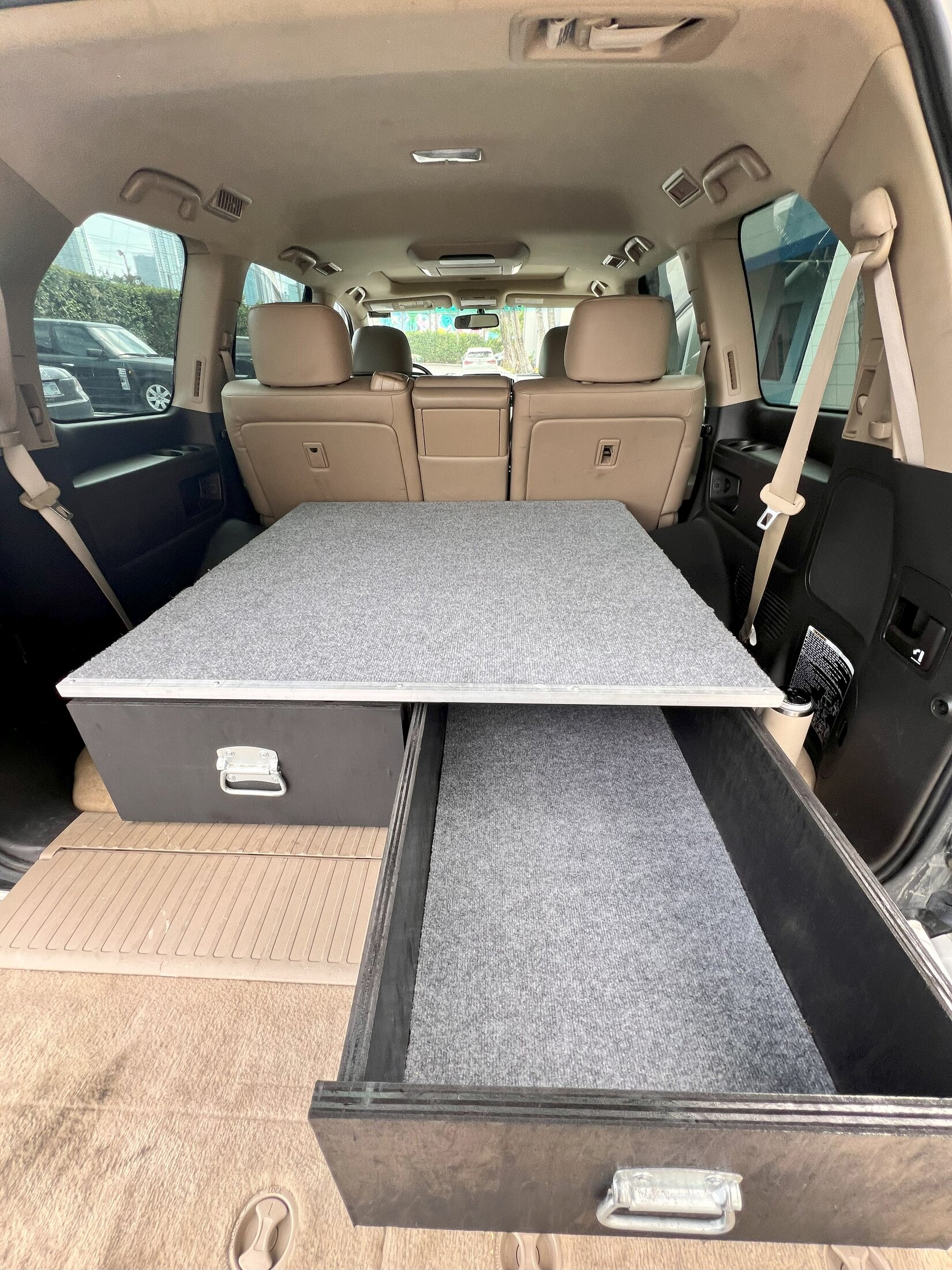

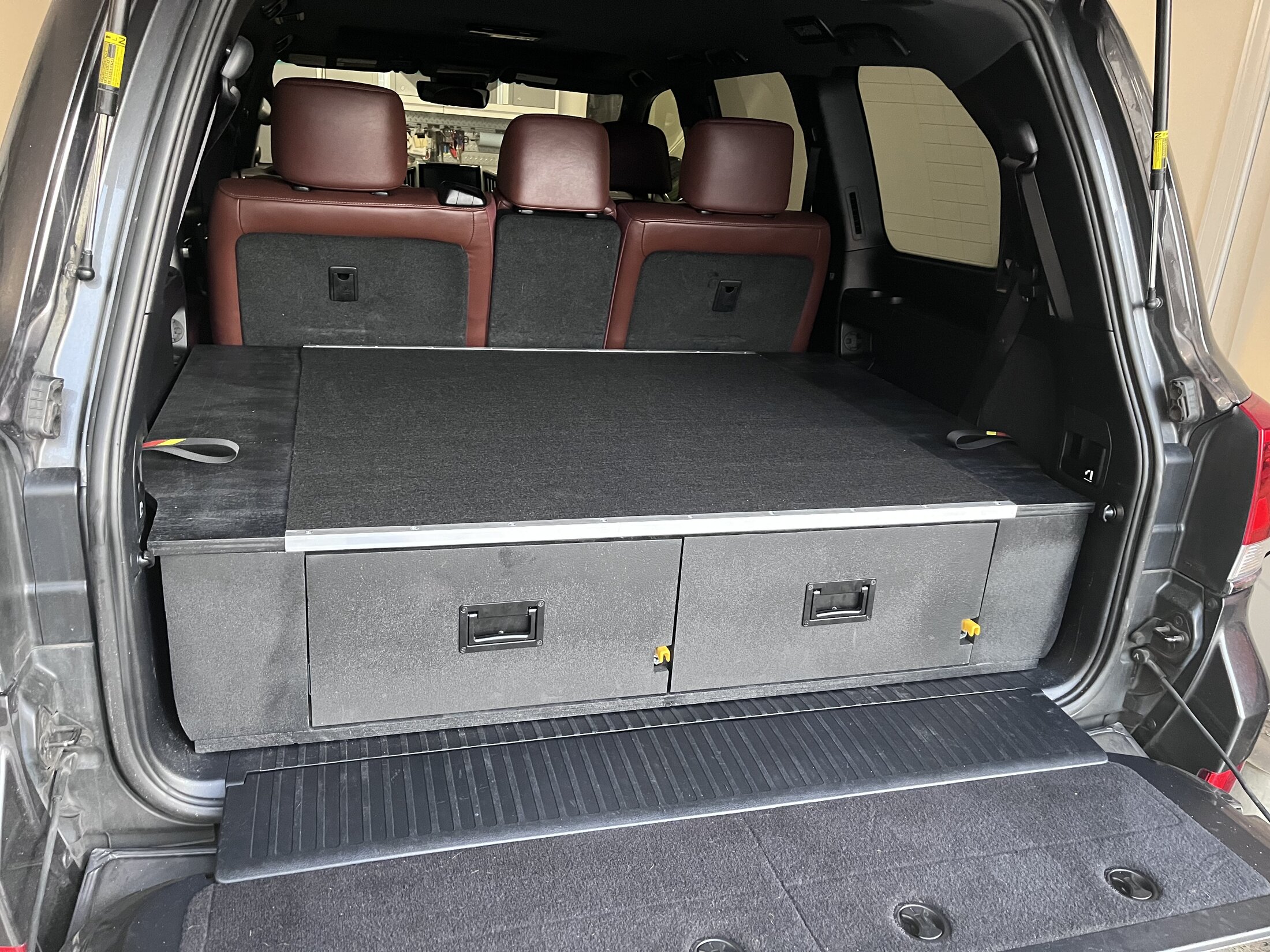

Not sure if I can be much help. I bought these drawers years ago when they were first introduced to US (Toyota Land Cruiser 200/Lexus LX570 Twin Drawer System - By Big Countr – Rugged Bound Supply Co.) They offered a significant discount to like the first 10 MUD members to order.
WAY more useful than the 3rd row I never needed or used and much better than just an open space. I don't have any slides, or a fridge. I did install this Truck Bed Anchor Kit - Aluminum L-Track & Stud Fittings to tie down cargo on top and coolers/bags when camping/hunting. I use a drop in box to hold a portable compressor, hatchet, foldable shovel, winter gear (extra gloves, hand warmers, emergency blankets etc) For road trips put in extra shoes, jackets, tools, etc.
The wings are super useful for storing small items like a portable power supply, binos, first aid kit, etc. These pull straight off and are not hinged which I think it a good design, easy to access if your cargo is loaded right next to it.
If I go to the range I can put my pistols, ammo, range bag in there, hidden and locked up.
Honestly my main use is for putting stuff like groceries in the drawers, small purchases, etc. Keeps you stuff from sliding around, bags tearing, stuff opening up and spilling. Almost weekly someone walks by while I am loading the drawers and comments something "cool" "so useful"
The only negative with these drawers is they are not really removable without disassembly. I bought them knowing that so not a big deal but there are few times a year where I would like to take them out to put stuff in there and keep it out of sight.
I don't sleep in the truck so I can't help you there, though it is fairly even with the middle row folded down. I suppose with some padding over cargo rails sleeping would be a def option.

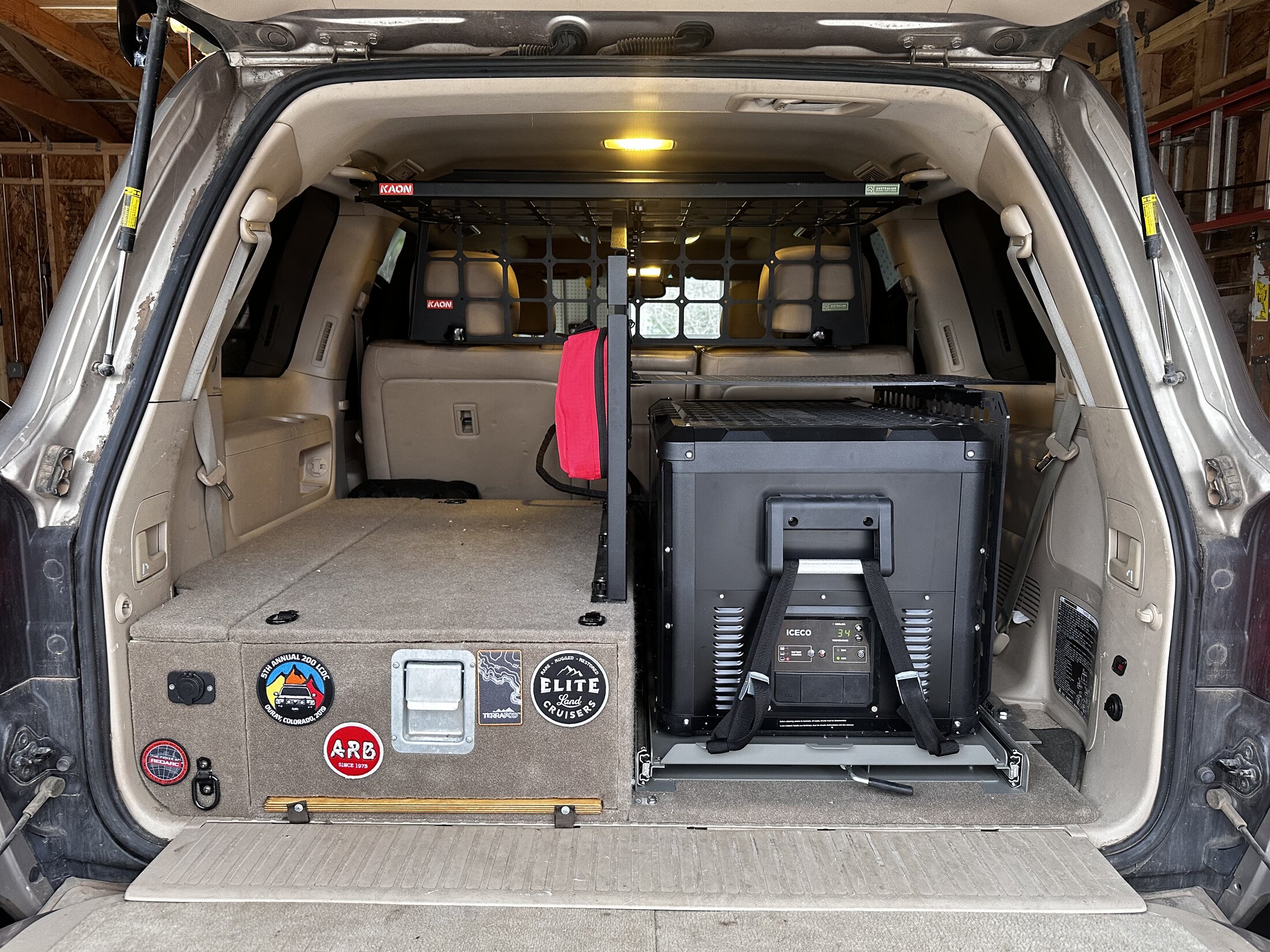

Definitely depends on use / need.
I have a refrigerator that works very well placed on the top of a sliding platform. Under the sliding shelf, I can store heavy gear that would be unsafe in a rollover or accident. My system is attached to the rear seat hoops in the floor. just takes a couple clamps to remove and no mods to the truck.
I also have it so it only takes up half the rear space, since I still need to use at least one rear seat for the fam.
For me, the drawer / slider works great for me. I'm not sure how I would install my fridge otherwise.

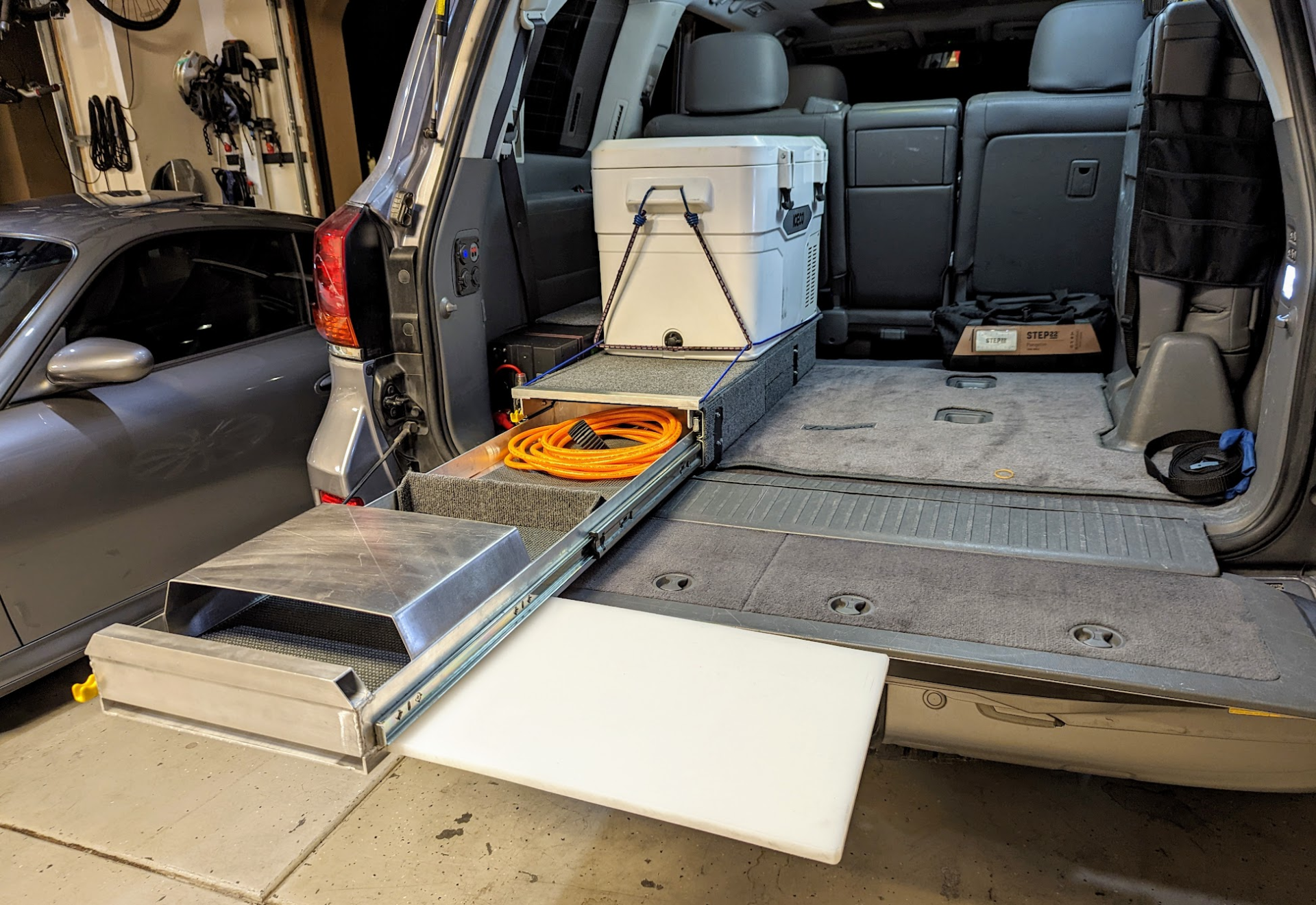

Not quite the same thing but here's my take on drawers. Fabricated primarily of aluminum, lightweight, and can be taken out in 5 minutes.

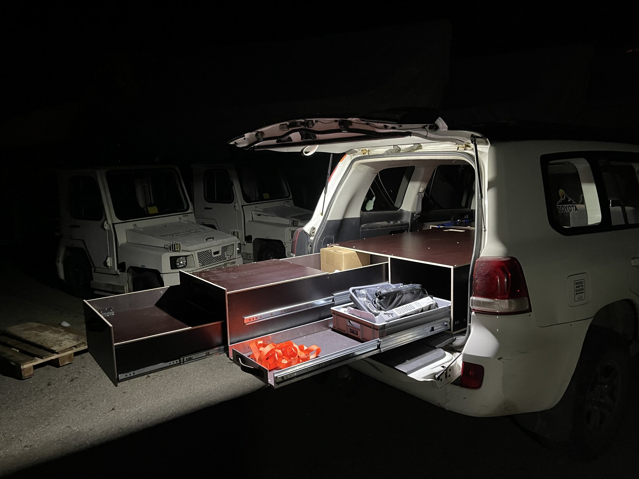

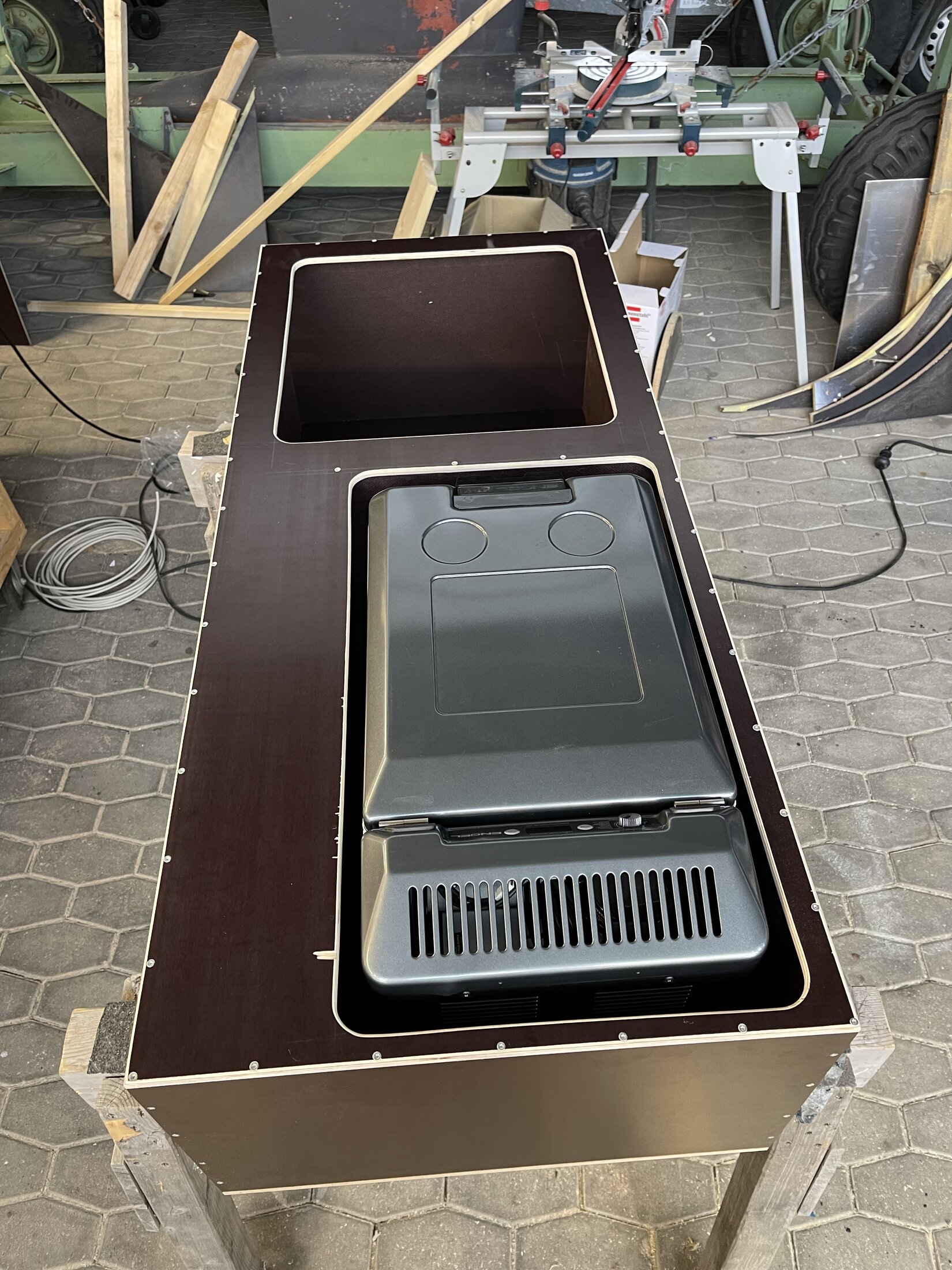

It rly depend alot by what you want do do in many ways.
But just for ideas here is my full rear box. Two big drawers of wich one contains euro containers for tools, spare parts, other stuff or just beer crates and the other one has multiple pull outs to contain a water tank and storing cooking stuff.
Everything sits on a steel frame that I just level out with wood and strap it down.
It is two parts that are screwed together like a T so you can „easily“ (an hour… the hardest part is getting the seats out and in…) disconnect them and remove everything.
At the T the part behind the passenger contains my fridge in a position I can access easily from the drivers position and also from the rear left door and also the charging stuff. The other side contains the third battery (diesel 200, they came with two batteries from factory) where I put clothes and other stuff.
The whole thing gives a nicely big sleeping platform from wich the fridge standa out only a little bit.
Btw the whole thing is made of 12mm (top and bottom) and 9mm wood and after I built in everything I was loading it fully and did some higher speed jumps to see if anything comes loose - it didn’t :)

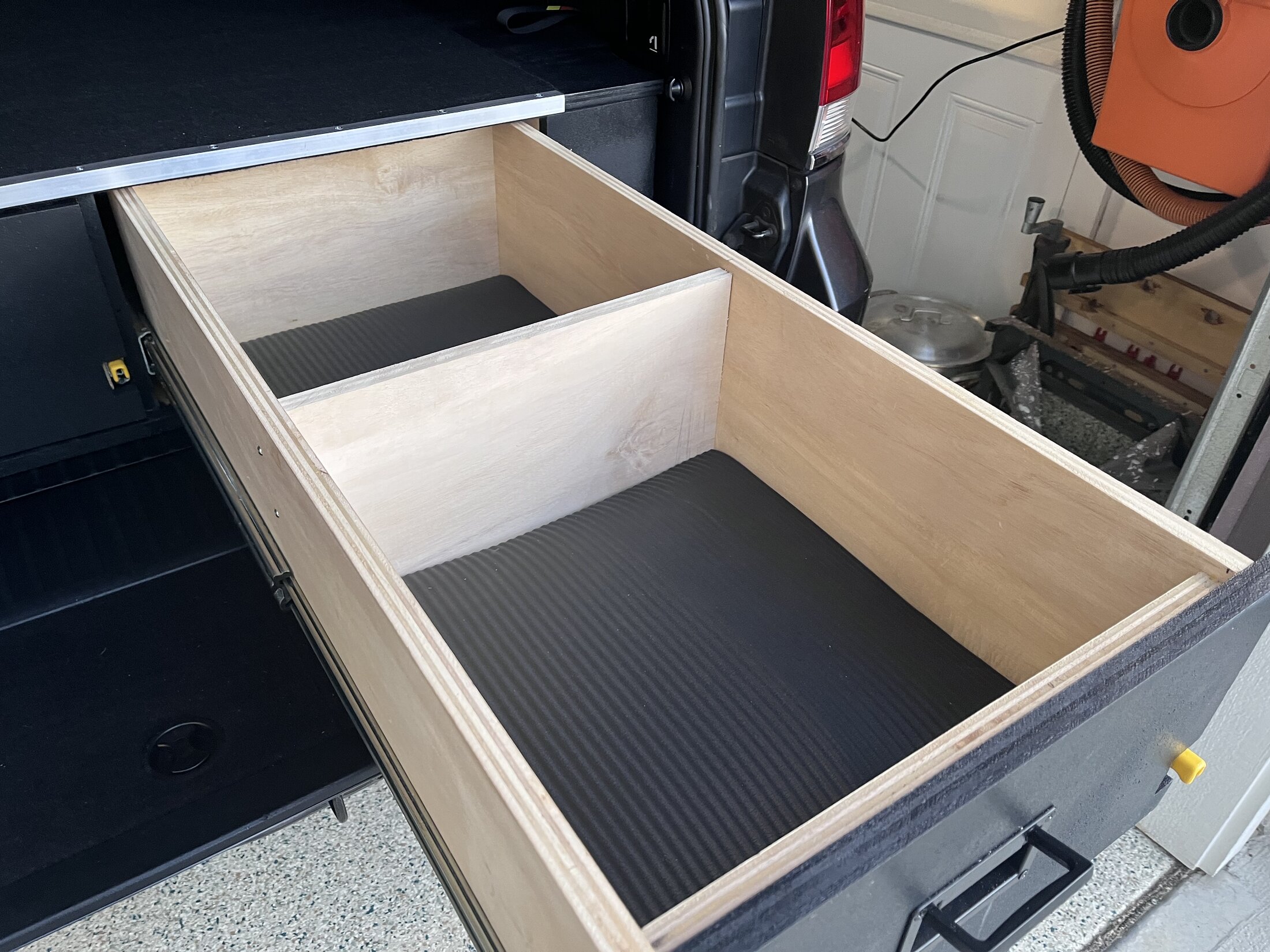

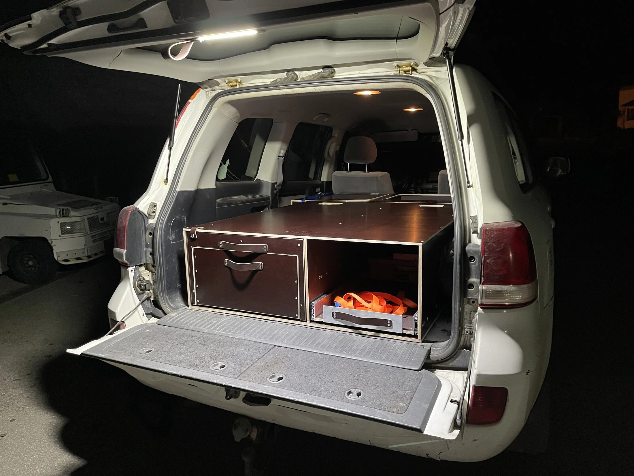

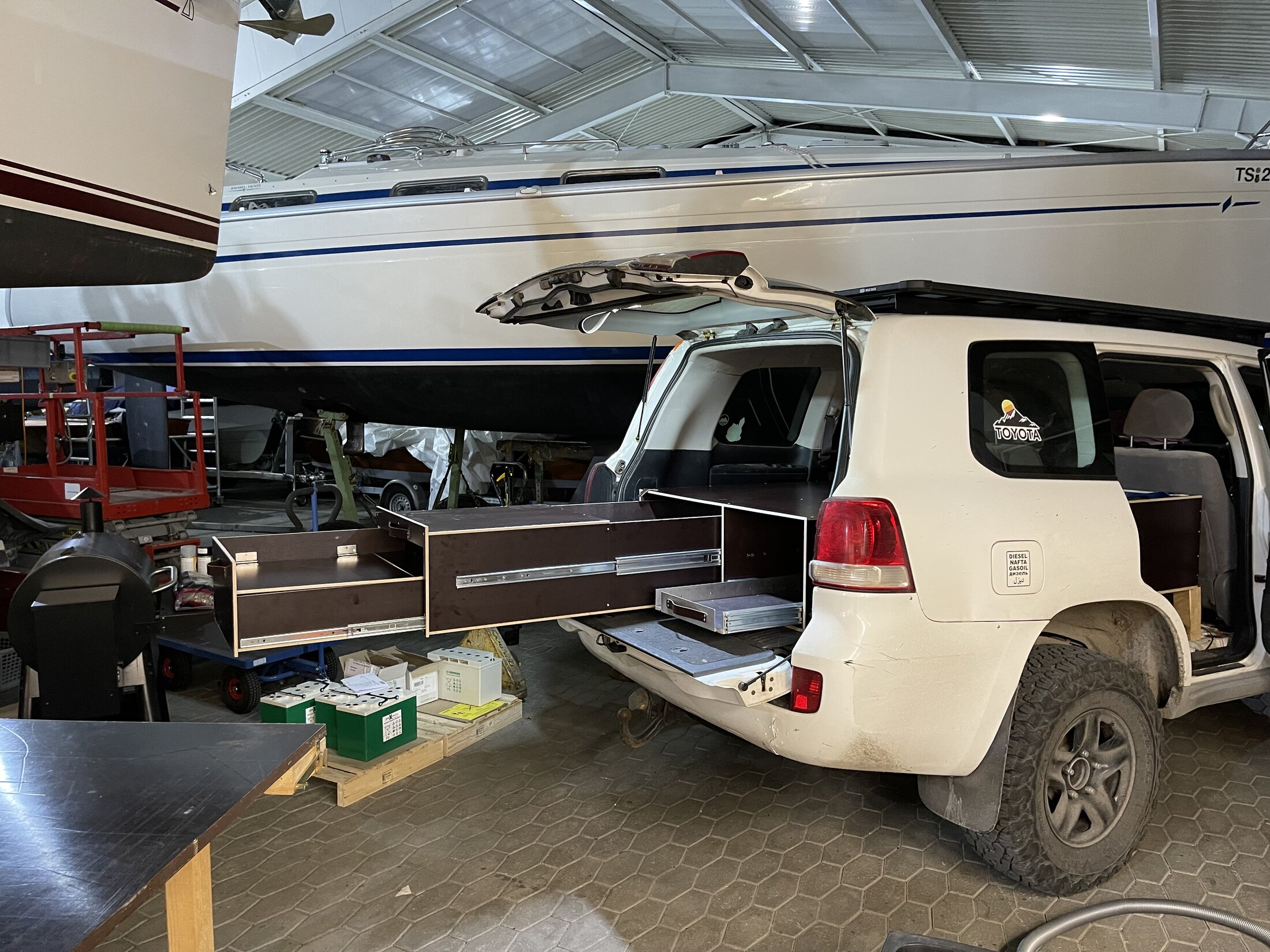

I wanted a single drawer so I could sometimes use the 3rd row, so I built my own. Everything commercially available kind of sucked as a single drawer, with a rough side where the passenger would go.
The good. About $500, made of 1/2” Baltic birch. Carpeted. I designed it so I could add a platform on the other side if I removed the 3rd row seat so I could add a fridge. I remove that in the winter and put the 3rd row seat back, then remove that and add the fridge slide in summer. I also added a small storage area at the back of the drawer accessible from the 2nd row. I added a slide out “table” under the drawer which is great when we stop for a random lunch break. Throw some extra carpet in the drawer to help keep things quiet
The bad: I used UHMW slides which are fine for light duty but with 100#+ of gear it’s SOOOO hard to slide open. I would 1000% do it again with real slides. Also as noted the drawers eat space… there are definitely times I’d rather take my gear out and have a huge truck space which I can’t do now. But if I took the gear out I’d likely leave it out all winter, yet it’s been convenient to have tools in the trunk when I’m not at home (more for helping others than myself).
I recommend the fridge on a platform at floor height because your trunk is already soooo high that you’ll have to climb onto the tailgate to access it, and then it might not open all the way because of the hatch.
Pic of my setup (for reference). I also have the Kaon divider system and attic, which I really like. I want to fab a removable metal platform above and to the right of the fridge… this pick has one but it’s a fiber plastic material that bends and sucks
