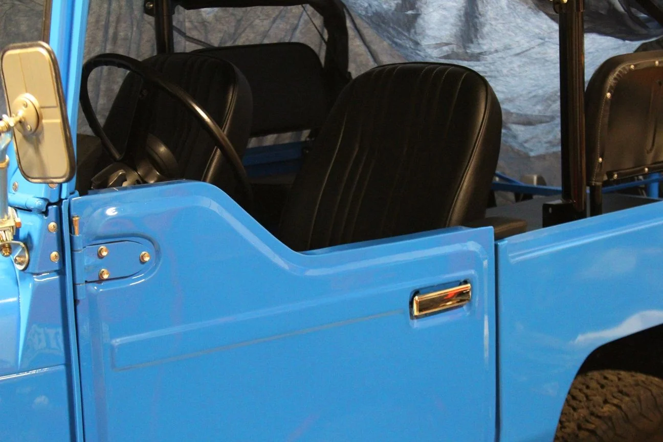

A big Thank You to @SMG for his upgraded hinge pins and bushings. They arrived promptly and look to be very high quality. The set for the doors will be installed for the summer driving season. . . I've half convinced myself to pull the hood and windshield hinges too for a complete look.

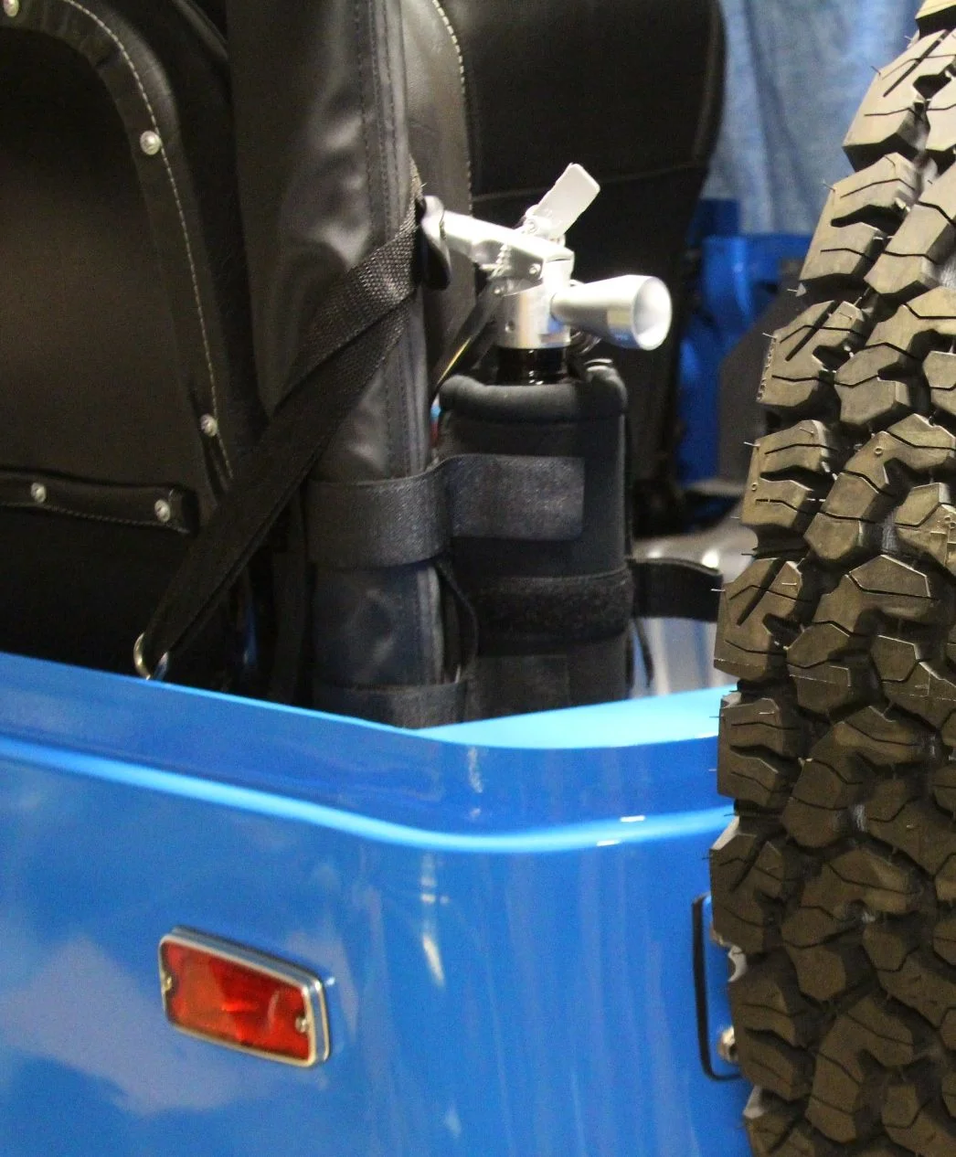

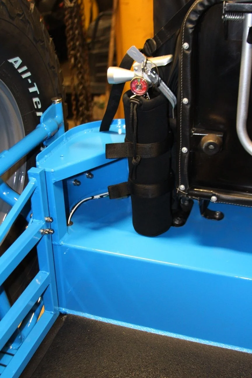

Put Safety First today with an upgrade to the fire suppression system.
Prior to today I kept a fire extinguisher wrapped up in a towel (to keep it from rolling) somewhere in the tub while I drove around. It usually sat in the passenger side foot area or behind the driver's seat and always looked liked an afterthought. . . technically it was.
The little Velcro holder snugs it up to the roll bar securely and it fits between the jump seat/spare tire area -- almost like it was meant to be there.
I went with the black extinguisher vs. the red or chrome finish to match the look of the roll bar. The holder hides it anyway so it really did not matter.
I hope I never need it, just like the insurance card in the glove box.
I acquired the cable material to wire up the inverter, that should be the next project to cross off the list.
Hey Doc that is a very cool fire extinguisher! Where did you find it? That would resolve my storage issue on the 45 . I wanted to mount one to the bed rack that is currently in the works but I wasn't keen on welding a bracket to the stanchion.

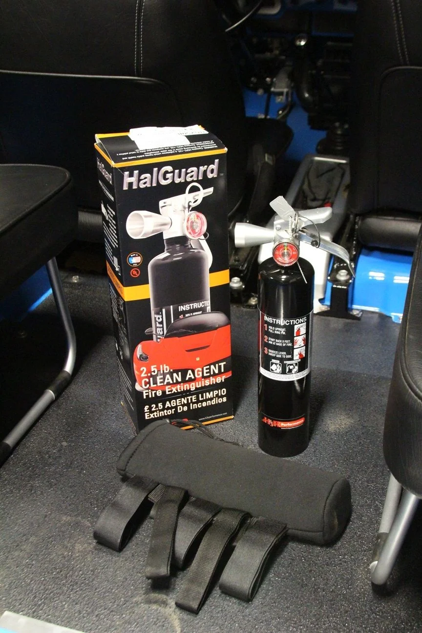

I went with a 2.5lb. H3R HalGuard, a clean agent extinguisher to minimize mess/contamination if I ever did have to use it. Going back to my firefighting days I know the principle to stopping a fire is to cut out a component of the fire triangle (fuel, oxygen, heat/temperature). Halotron1 takes it a step further (thinking it acts the same way as good old Halon) by not only cooling and smothering but also chemically reacts/stops fire's chain reaction. The mind is dusty and full of cobwebs, but I think Halotron 1 was introduced to replace Halon in the early 90s due to environmental concerns/the EPA. I'm not for making the ozone hole any bigger (last I heard it was getting smaller?) but I have no problem emitting some Chlorofluorocarbons if it means saving the 40.
The mounting sock was acquired separately (on E-bay as well).

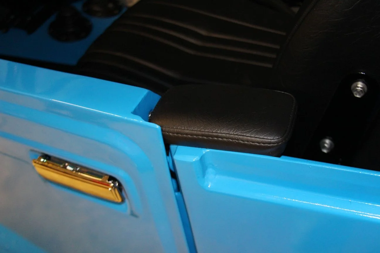

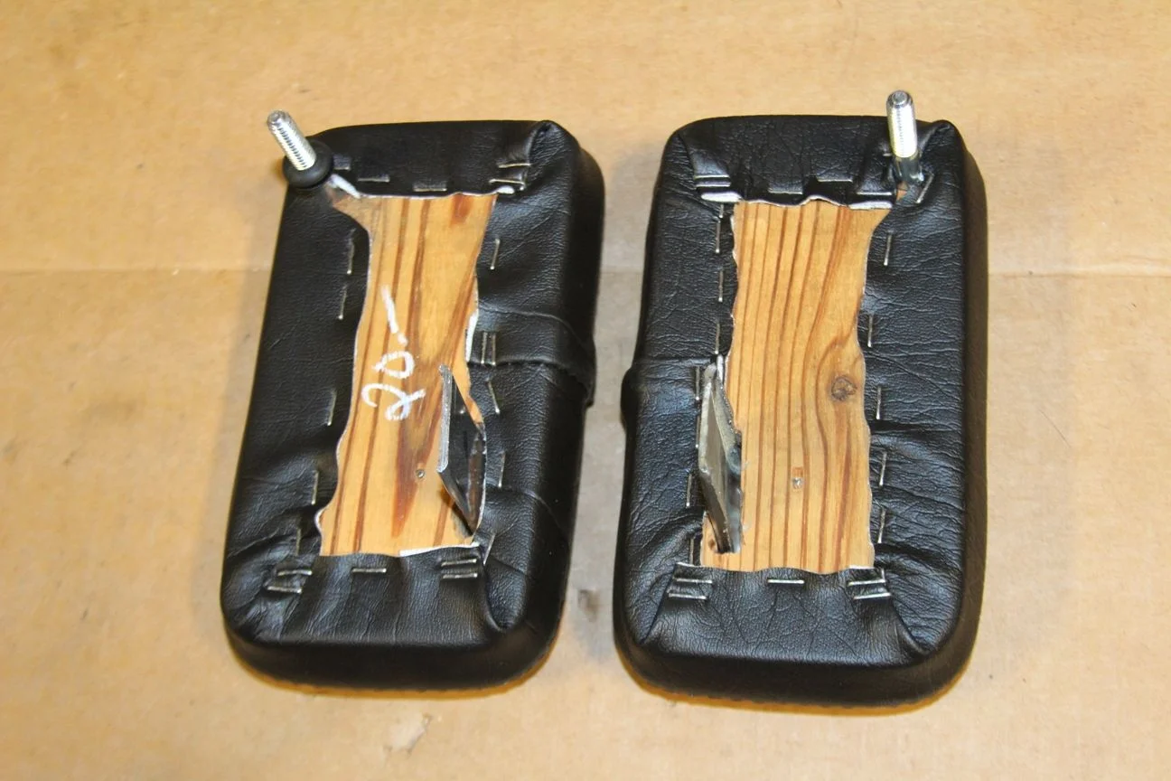

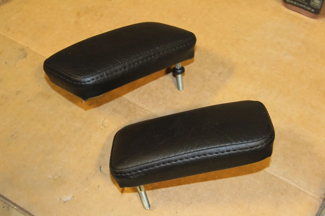

While running errands yesterday I stopped by the upholstery shop -- ready and waiting were the B pillar covers/elbow pads (still have not decided what to call them). He also had a pair of my nicer gloves waiting that I thought I had lost. . . I couldn't for the life of me remember where I had put them (or in this case forgotten them).
Yes, for the grand sum of $20 (for both!) I think Aaron did a nice job.

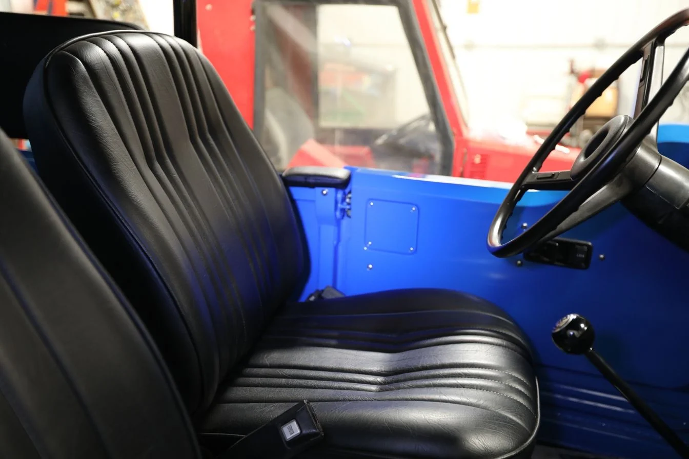

For reminders, this large unfinished area just behind the door was the target:
I only had time to set the cover in place, but I do think it looks. . . better.
Standing back the cover blends in and my eyes are not immediately drawn to it -- that was one of the goals.
This weekend should allow some time to secure them in place and perhaps a better full truck view to get a large scale effect. Right now I'm leaning toward keeping these covers vs. making a new set of blue painted plates. OR, perhaps I will make the simple plates, paint them, and have . . . options. :hmm:

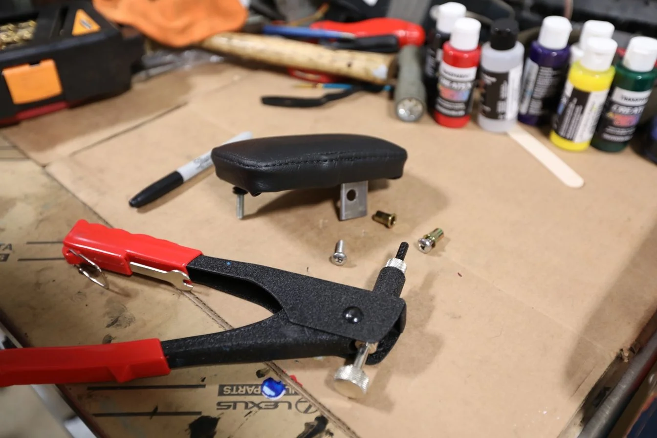

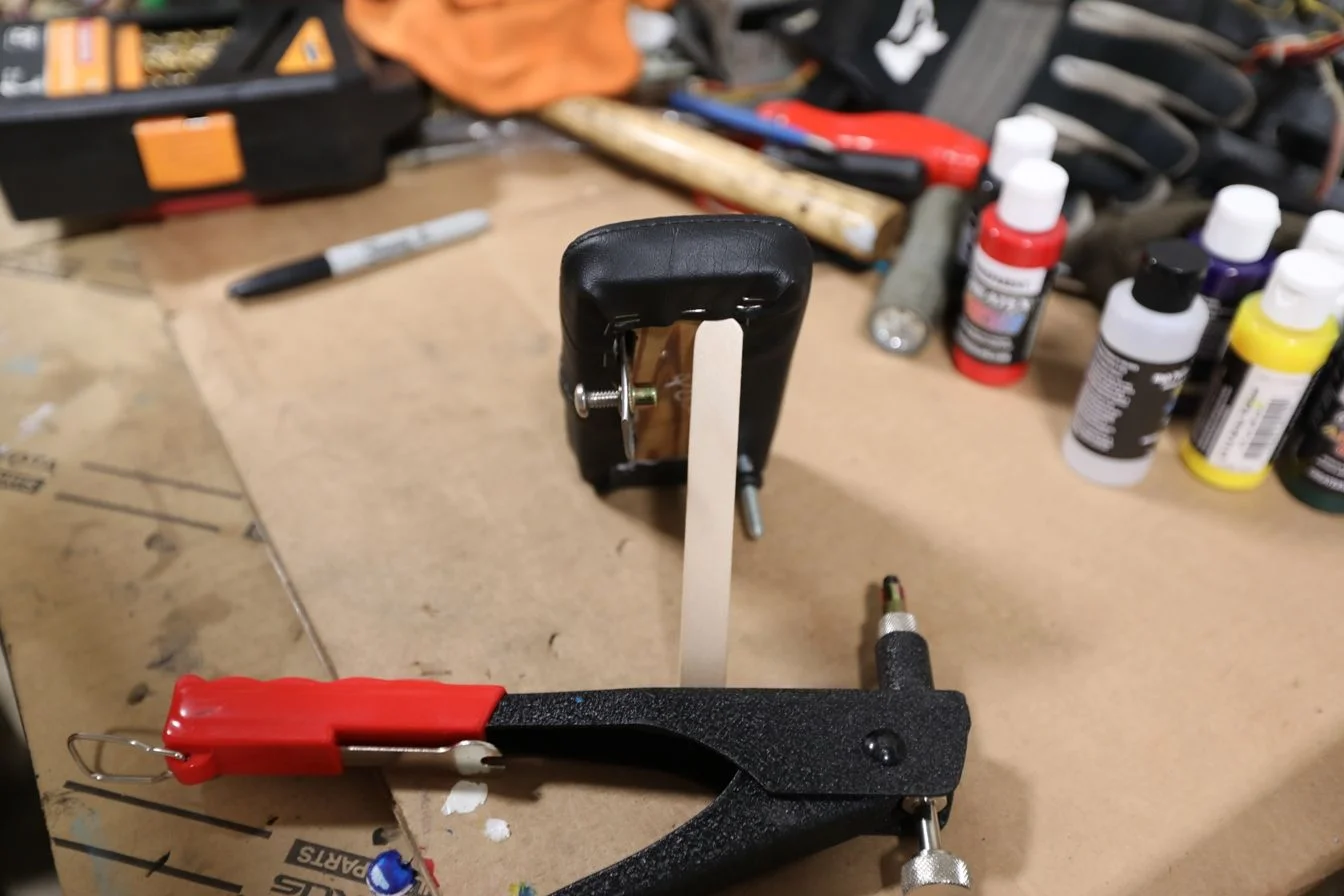

That allowed me to focus long enough to mark and drill the holes in the cushion mounting tabs.
Installed a 1/4" Rivnut -- handy when you do not want to weld a nut inside something or do not have access to install a nut -- even on thin materials. I used the same hardware when attaching the bikini top channel to the top of the windshield frame.
In less than half an hour I had both cushions installed. Slightly out of focus, but a view from the inside:
