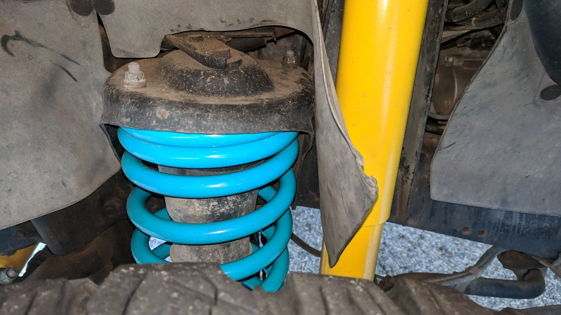

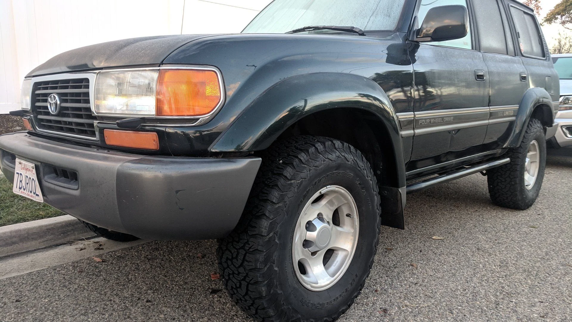

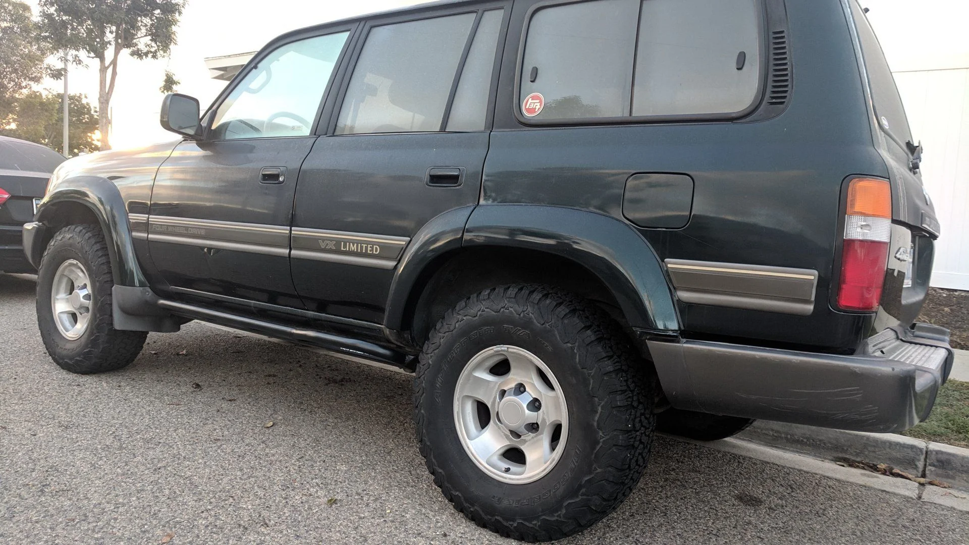

Gentlemen , i recently installed a dobinsons "lift kit" , coils & shocks . front coils Model# 220v (40mm lift), rear 269v (45mm lift) , shocks gs59-683 & gs59-682 . I run a 97 80 series that was basically stock with the exception of 1 1/4" (aprox) spacers on all 4 corners , with 32" tires . I havent yet had a chance to run the rig for a test run . My center of hub to flare was a bit different on all 4 corners pre "lift". after i get a good run in i will measure the post install height . I dont know what 40mm & 45mm lift means respectively from whatever the "standard" height coils in the catalogue was ? I didn't re-install the spacers yet , i want to see how the ride is first with just the new "kit" . this weekend will be a good 200 mile + test run on & off road . If i decide to use the spacers , im concerned about potential castor correction ? I already purchased the dobinsons bushing "kit" just in case . Is there anyone LC owners here in orange county ca , who have a reasonable mechanic , that could perform the control arm bushing work ? I have already been to several shops , just to get an idea of cost$$$ . I have been quoted as high as $500.00 for the labor !! Iam not a weekend mechanic man myself , but if i cant find a reasonable price then "lifting " any higher (with the spacers) may not happen . I did my research with many of the usual suspects (other suspension companies) that everyone knows , and searched on this forum as well, and i believe for the $$ the dobinsons variable coils are the best designed & engineered (regardless of lift desired) for best fitment on the LC 80 series . the shocks are descent for what they are , yes i could have spent $300+ per shock with the dobinsons model mr59-60682/3 , or another high performance like fox , radflo ect....
