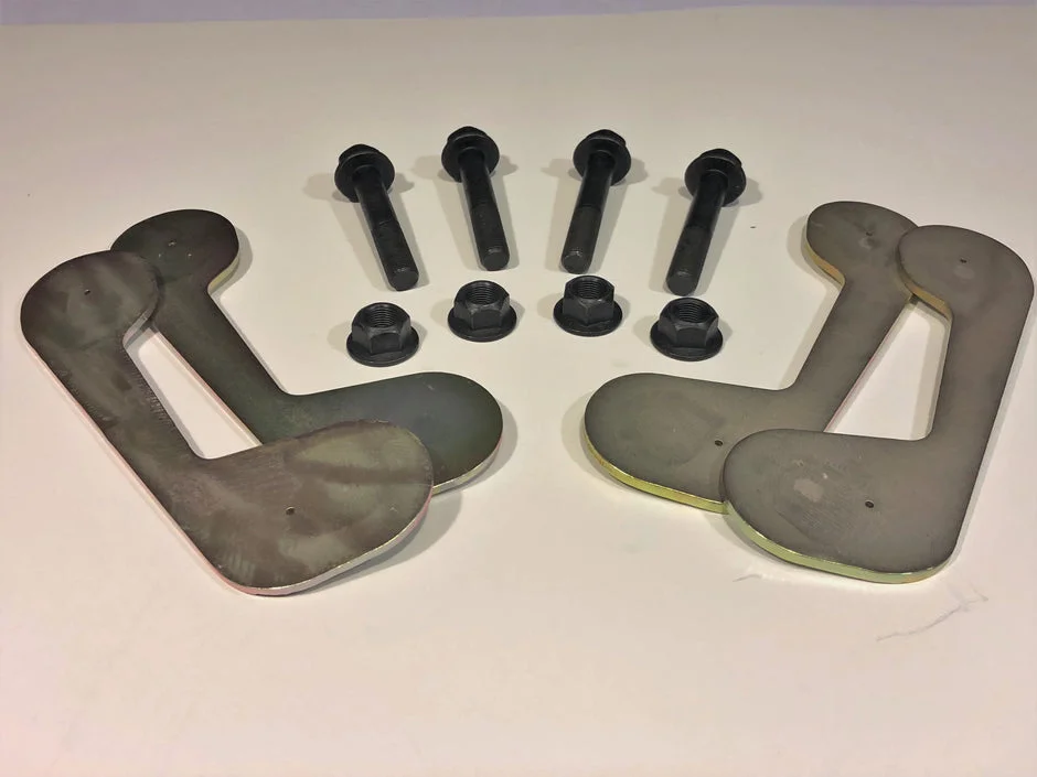

Replaced the OME 2” lift with the 3.5 LT, the old caster plates are rated for 2-3” lift best I remember. I need more correction and all my google foo searches come up with 4-6” lifts. What is the suggested plates for my new lift?

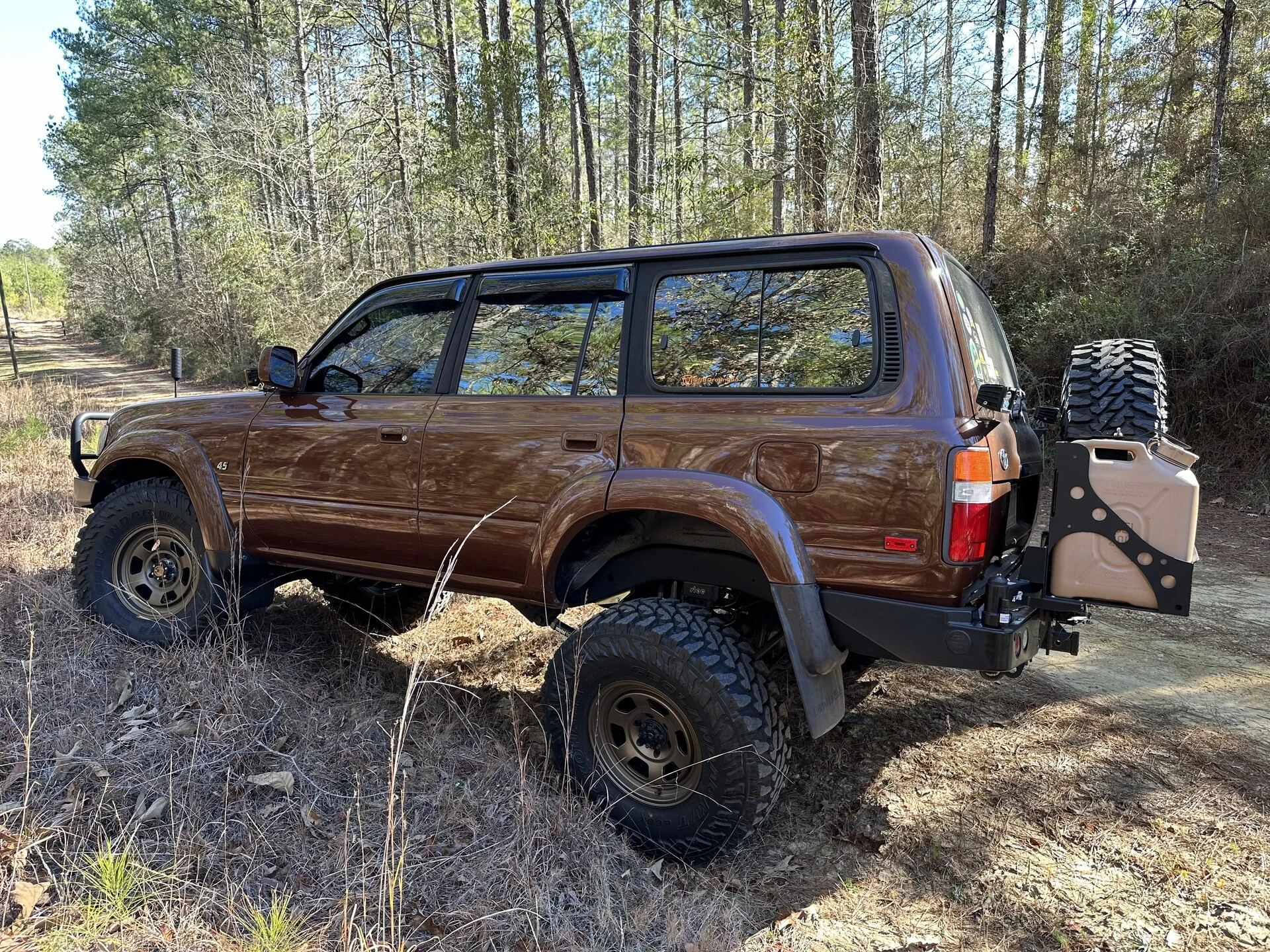

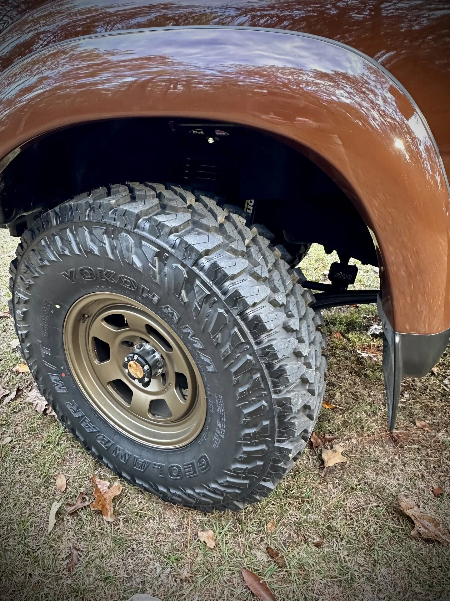

^^^ I have the 2.5 VT’s but they generate 3.5” of lift. Had the Landtank 2.5” plates and the truck was drivable but caster was short. Bit the bullet for the Delta 4” arms and wow what a difference. I went from comfortable two hands on the wheel to two fingers with one hand. Still need to get the 555 tie rods swapped in but man the arms are really nice, can’t wait to see what the flex is like.

I did nothing about the notch ground into the housing. The original bolt holes where still there so I mounted up the arms and torqued the hardware to 130#. If I was a welder I would have probably repaired the notch.
