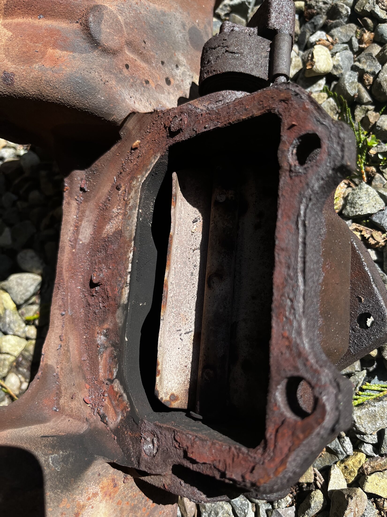

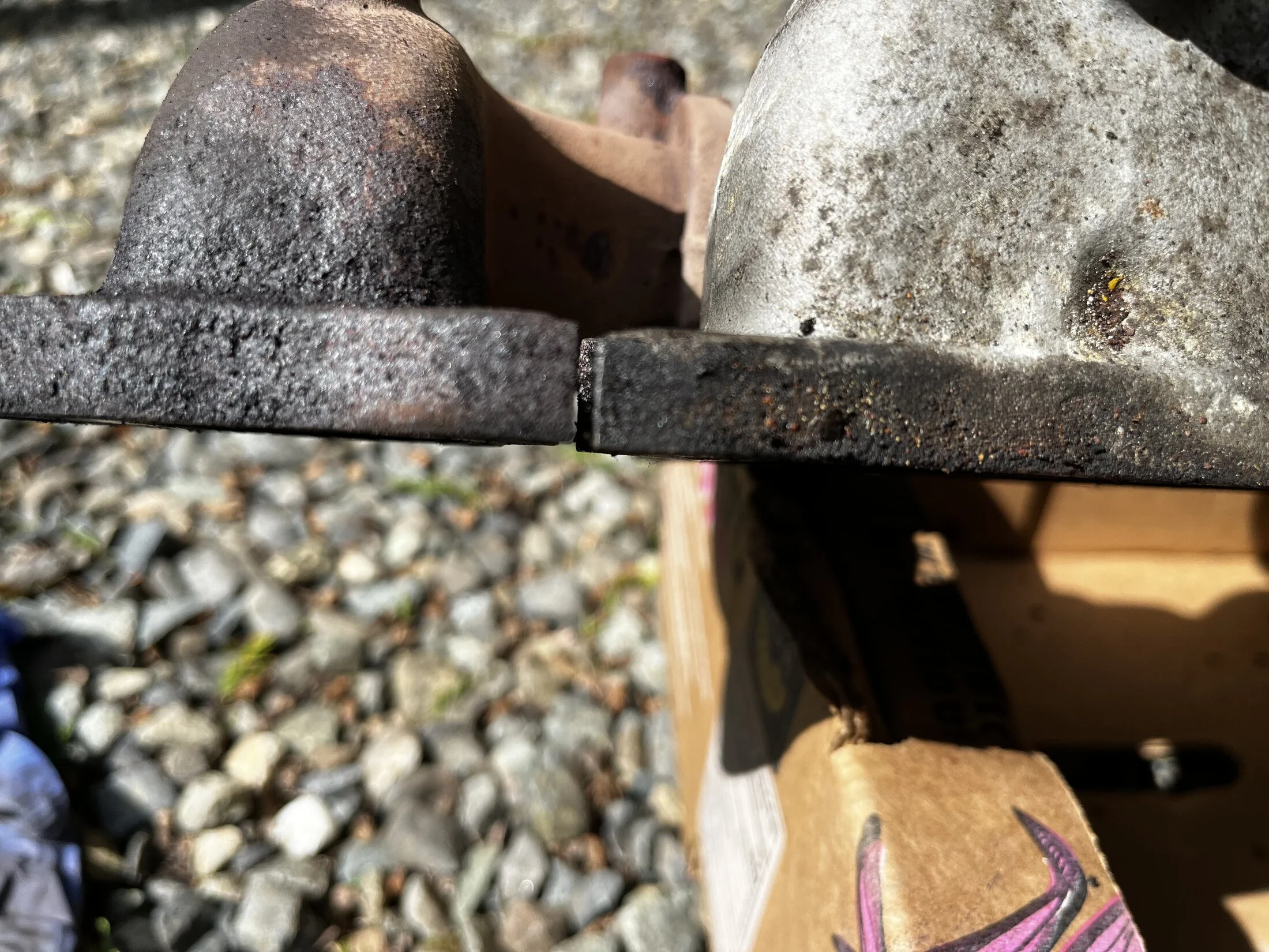

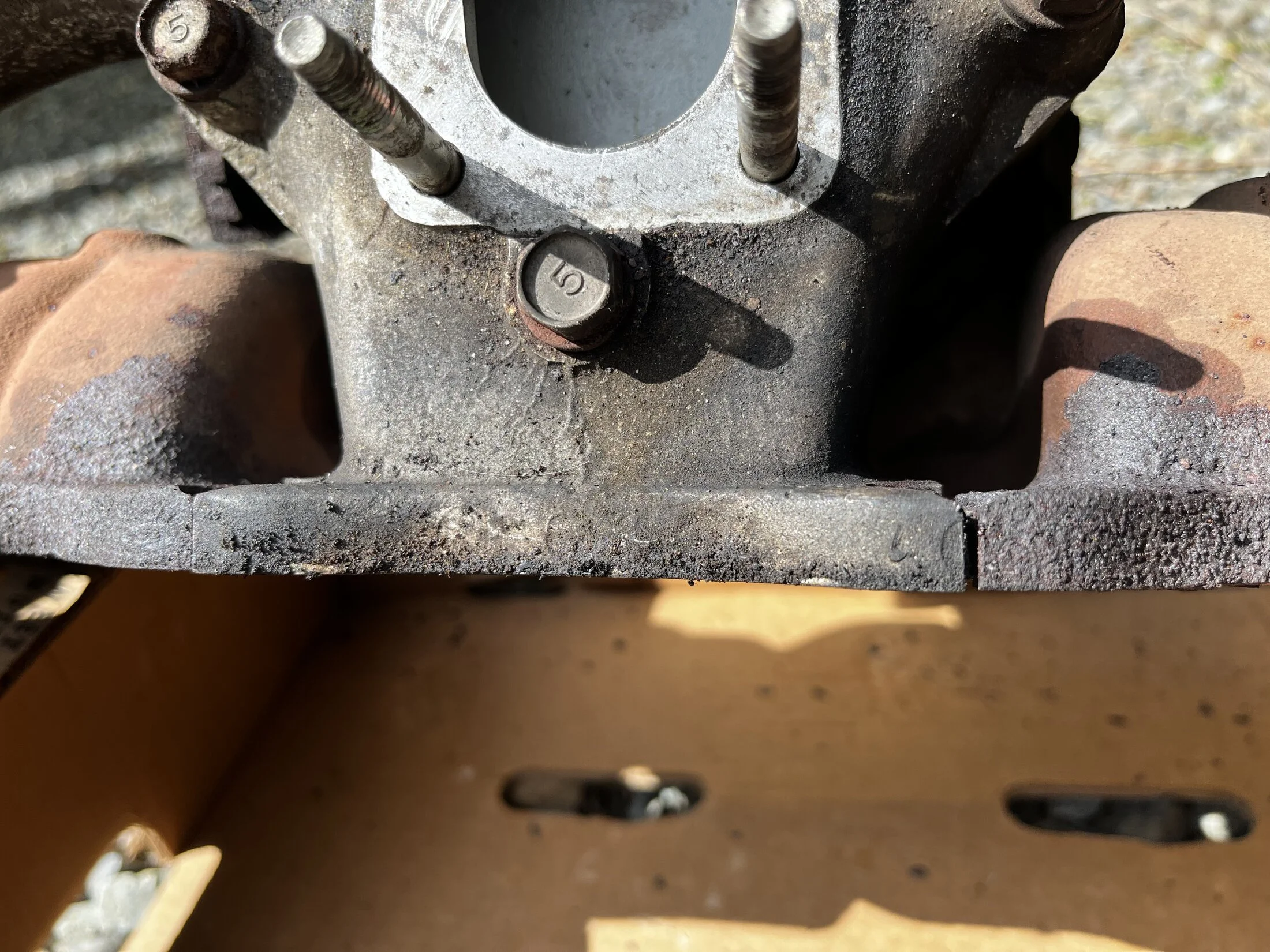

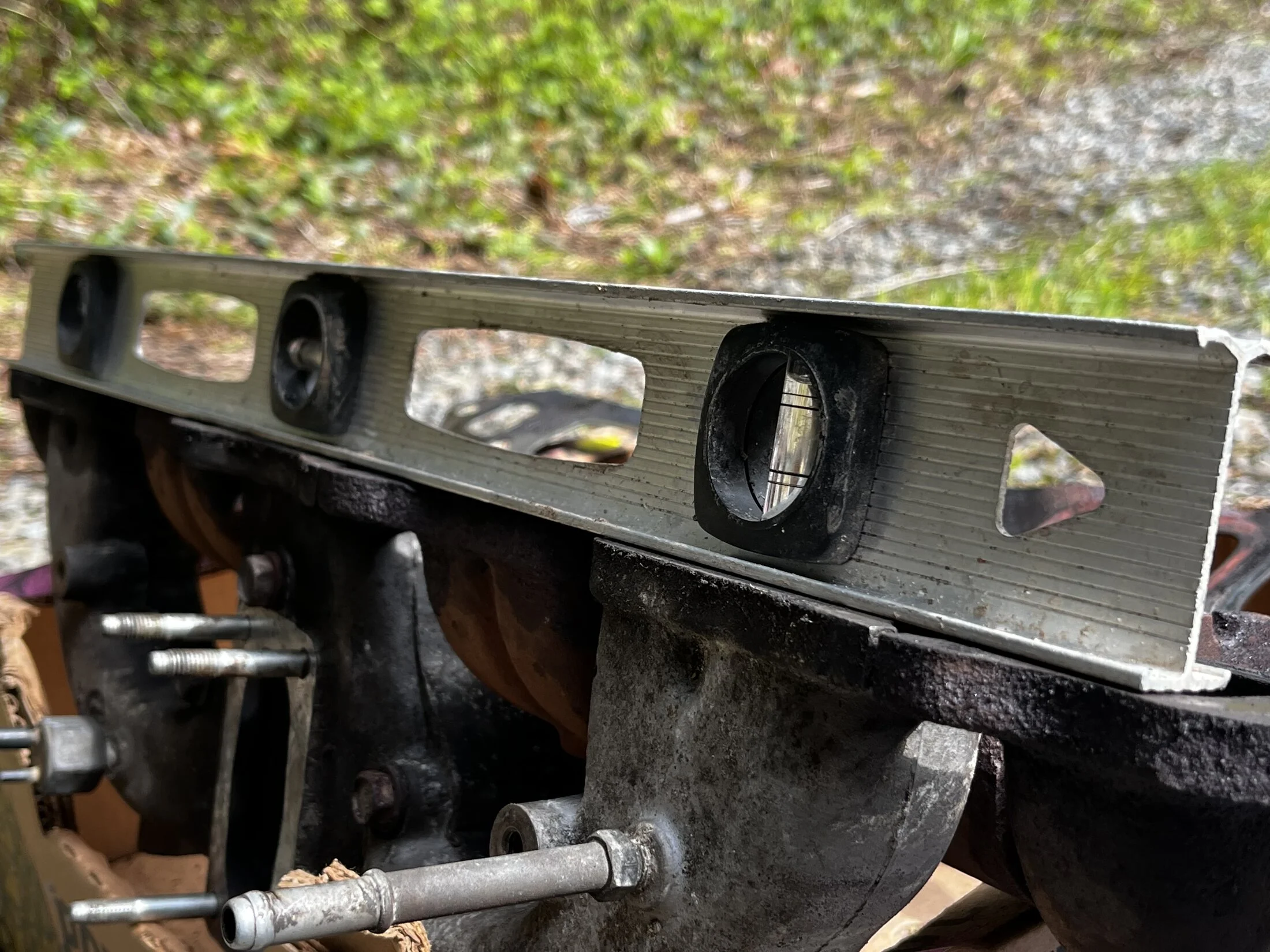

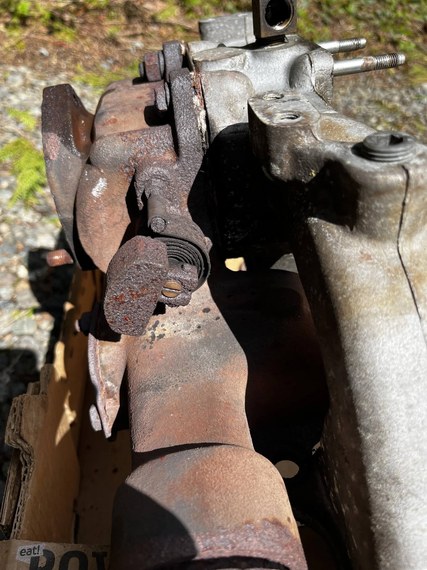

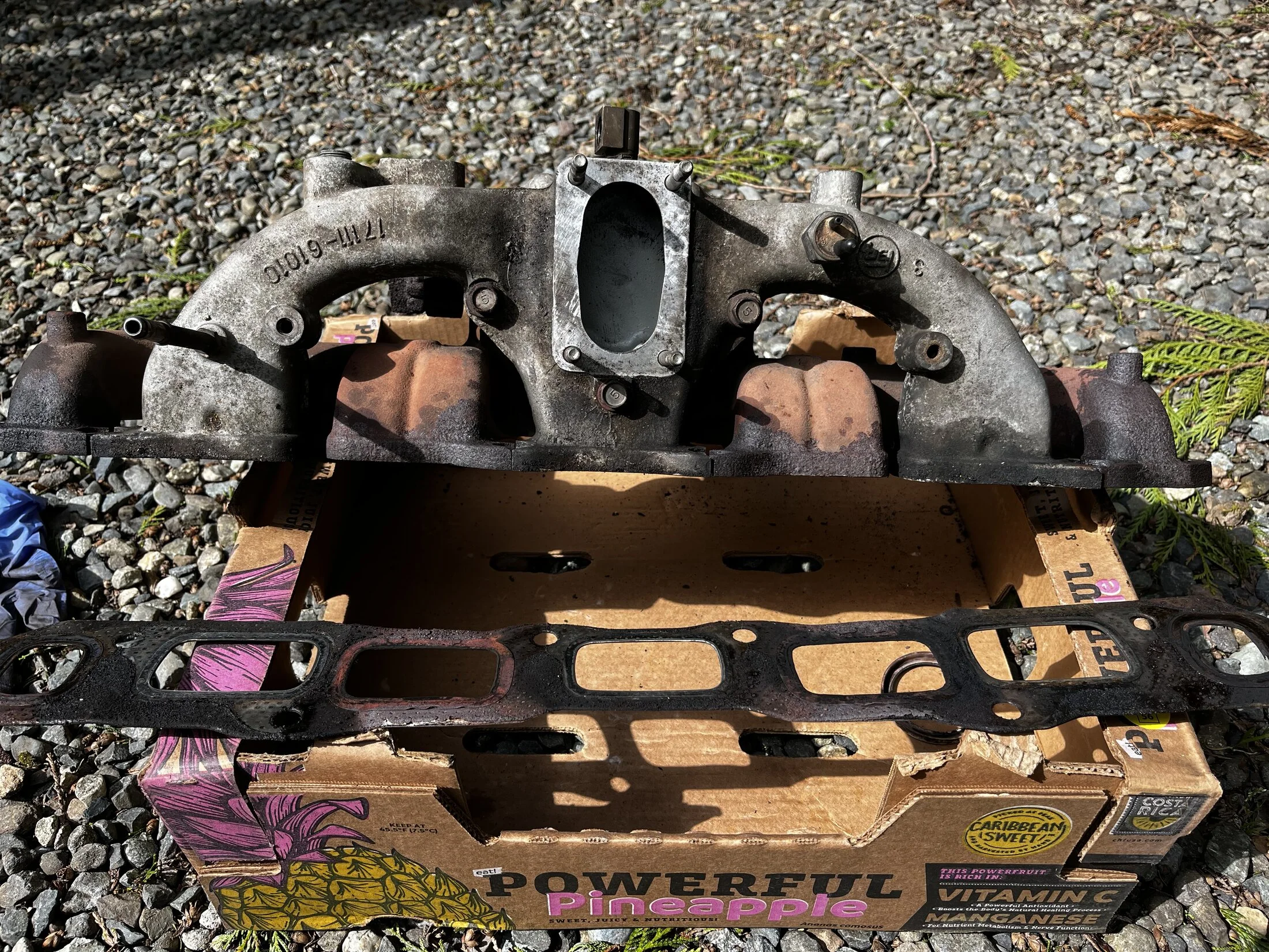

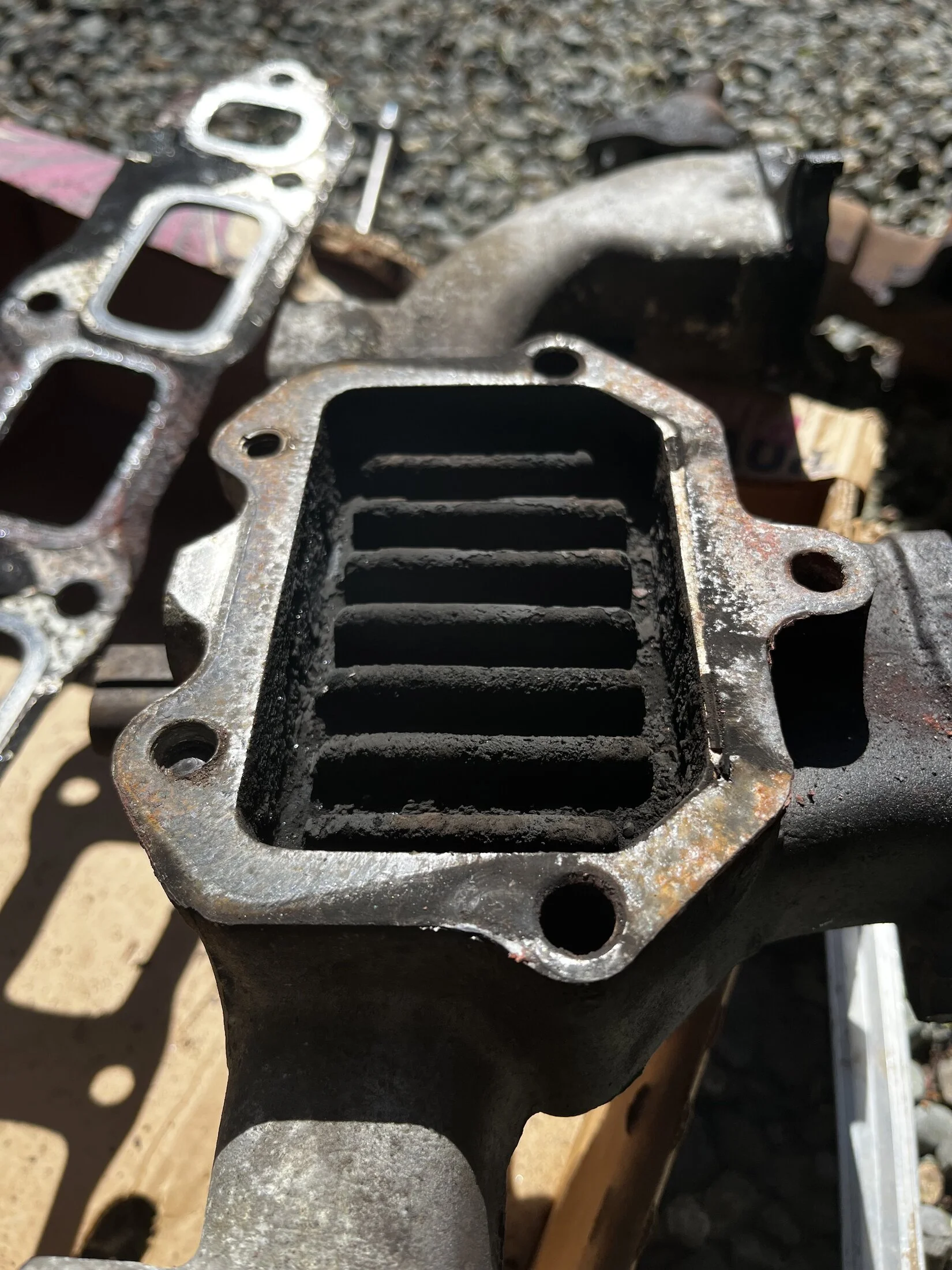

The old girl has been running rough after warm up. She’s happier when choked. I thought it must be the carb but after rebuilding it twice ( thanks to pinheads YouTube videos) I’ve moved on to the next most likely problem. I did try torquing it down before removing it but I wasn’t able to change anything. So now that it’s out I’m thinking it doesn’t look that bad apart from the cheese sandwich mess where they bolt together. But I’m no master mechanic by any stretch. So what do you think? TIA

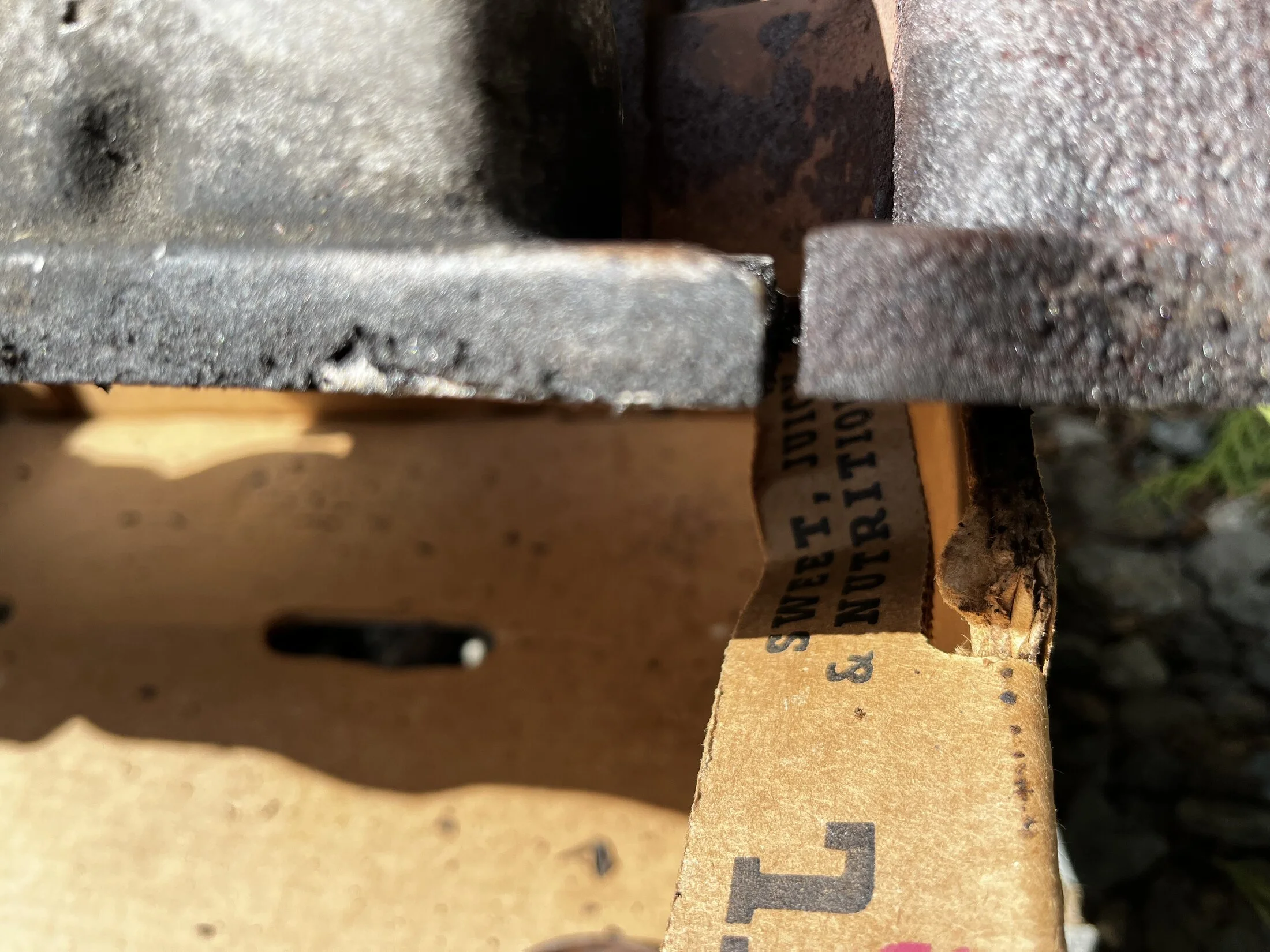

One of the last pic's in post 1 shows me, the intake manifold is warped some. The rest of the pic's don't show much to me sorry.
Make sure head is clean on the mating surface. I would loosen the nuts holding the intake and exhaust together. Mount the assembly on the engine without a gasket and torque it in place in the pattern by 1/3. After you get to full torque then take a propane torch and heat the aluminum intake to like 300 degrees where it was warped toward that end runner. Let it cool slowly. Now torque the manifold together. Remove the assembly and see how flat it is. Hopefully its flatter than it was.
Soak your new manifold gasket in warm water for 1/2 an hour - this will soften it and allow the high spot to sink in better. Install the system and again do the pattern by 1/3 three times. After it runs and gets good and hot (15 minutes or more) retorque at 100%. After several heat cycles check it again.

RE: manifold condition; put it on a surface plate (or granite counter) and attempt to put a .5mm feeler on the perimeter of manifold with mating surface on counter. If it slides in, do exactly what @charliemeyer007 said. Use Felpro or OEM gasket and a nice clean thin bead of high temp copper then torque to factory or slightly more. Check/Retorque after driving a bit.
Take care on the two bolts going into aluminum, they might pull the threads especially looking at the condition of yours so be prepared with Helicoil and a thread die for bolts.
my local old school machine shop planes the bolted together manifolds so they are flat and true, they also check the washer side to make sure the washer sits flat against both manifolds

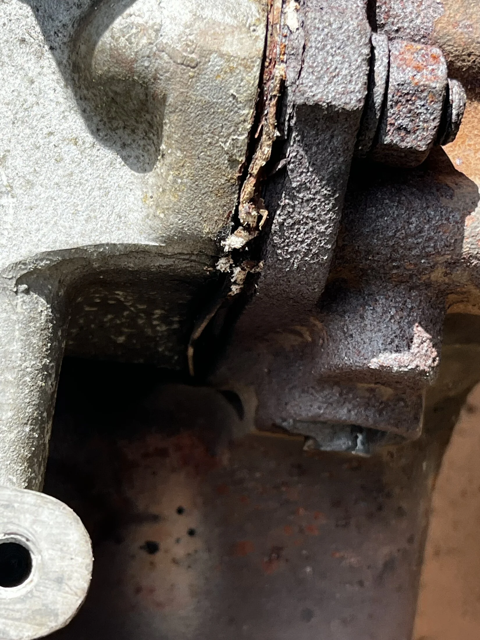

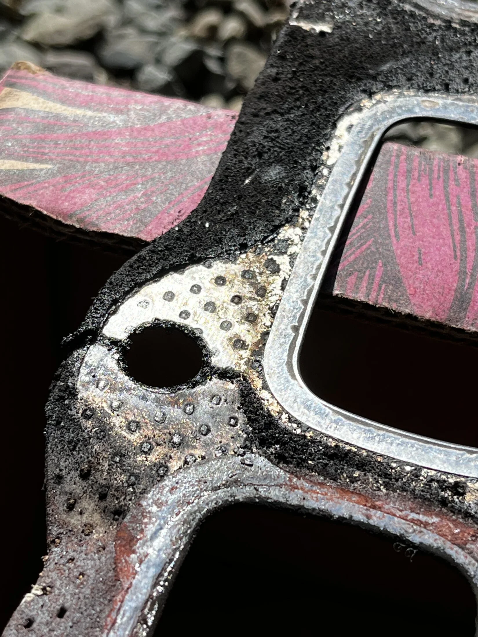

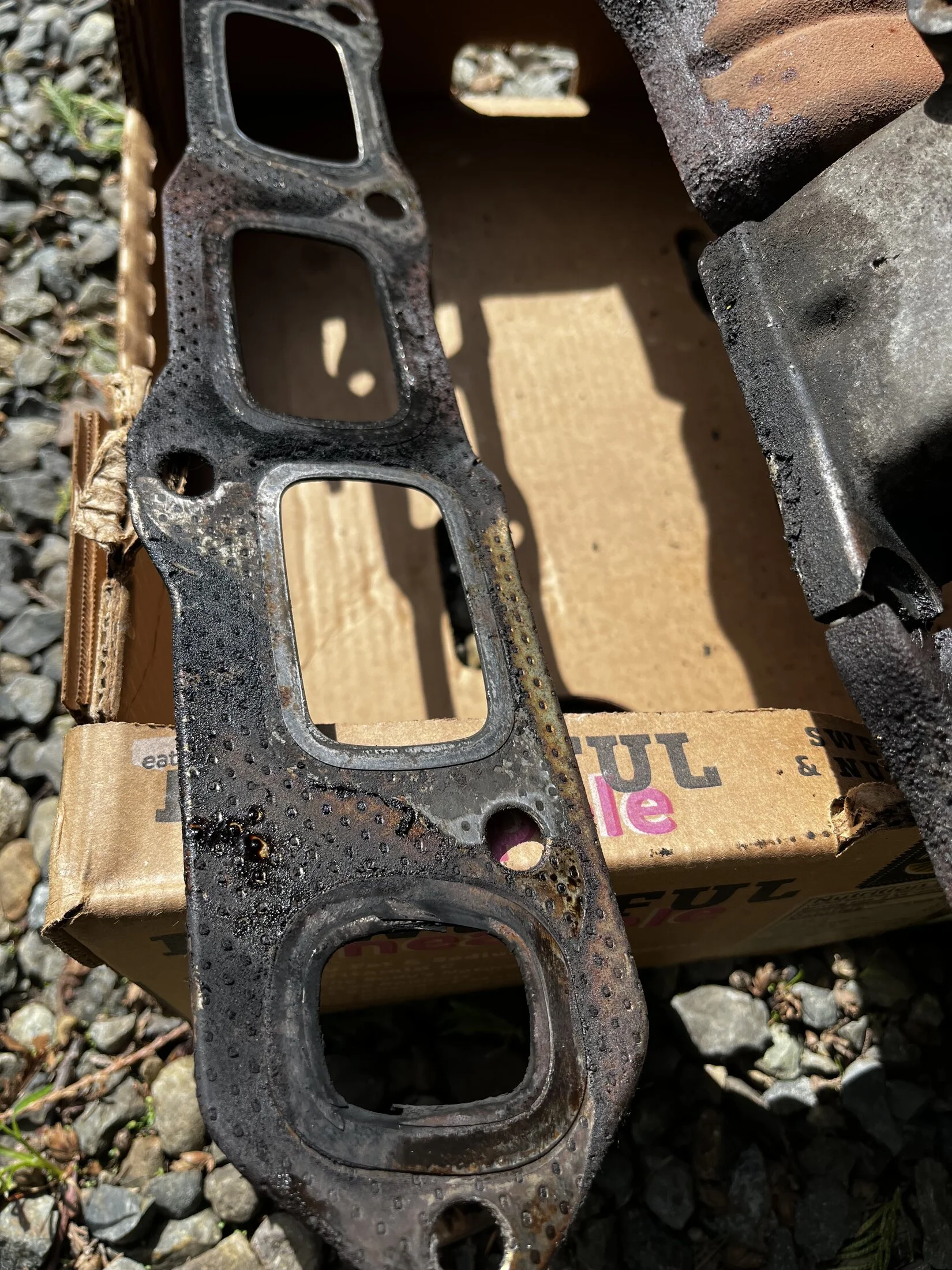

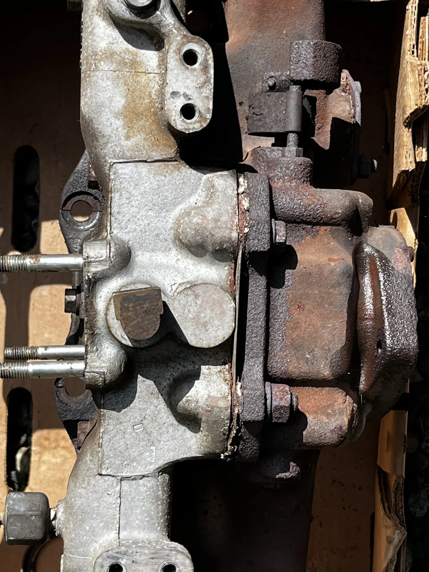

I appreciate all the advice. I’m feeling more confident about the process. The one piece that I’m still worried about is the gasket mess between the two manifolds. There’s a SS plate, a gasket and what appears to be some sort of goop squishing out that might have been applied afterwards. If I loosen up the connection bolts I think that I might as well take it apart and replace that gasket also. I’m concerned that might create a problem. I don’t see how to avoid it though

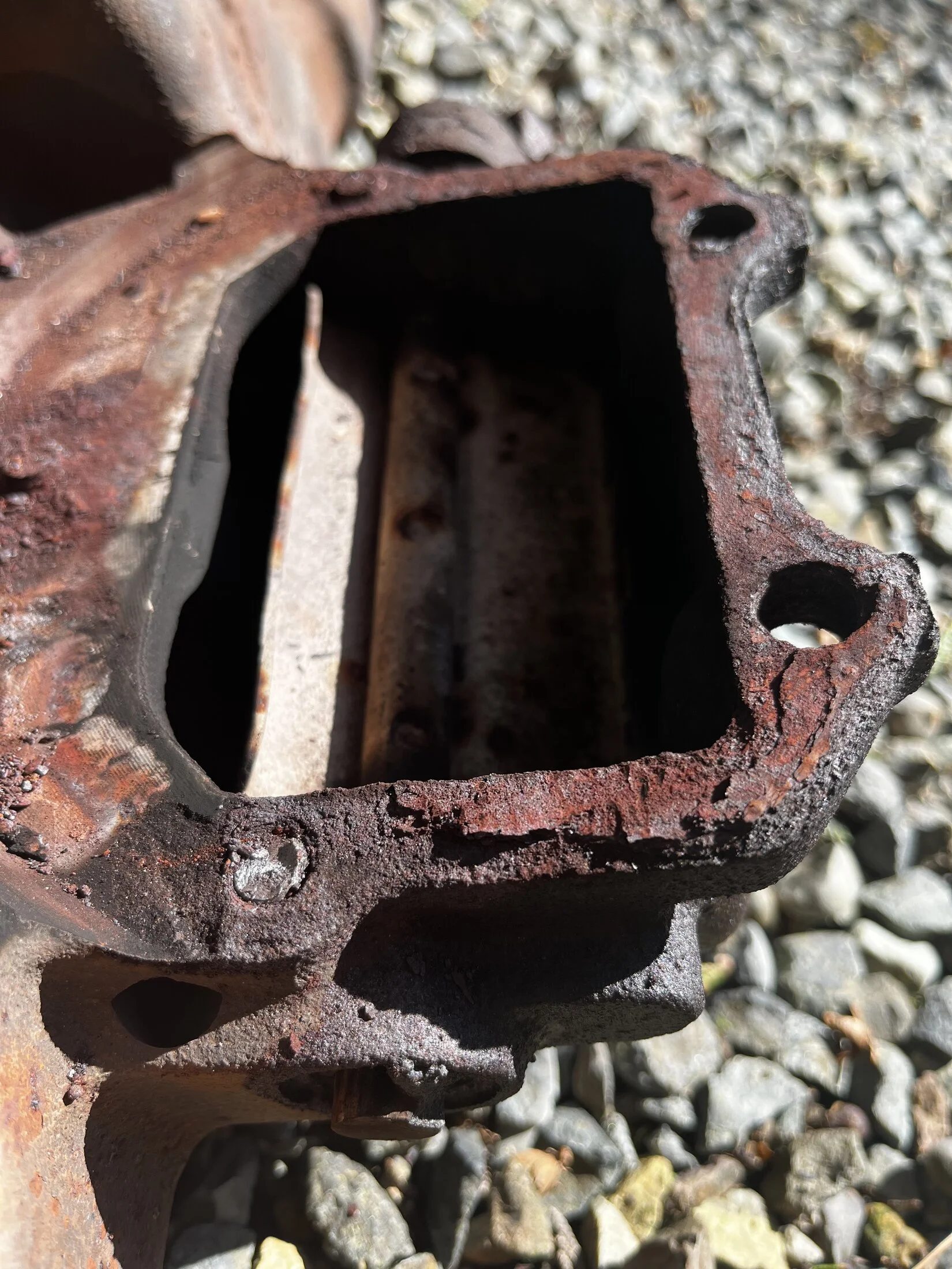

I decided to take them apart which was the correct call. The intake looks pretty good apart from needing a Helicoil or two. The mating surface of the exhaust is in poor shape. The iron is crumbly and easily falls apart with a little tapping. I don’t imagine it’s something that can be saved. Decision time I guess

Your parts except the heat riser look really good IMO, some of the straightest old ones I've seen. Fix up that heat riser and if she only runs on choke your idle circuit is plugged.
