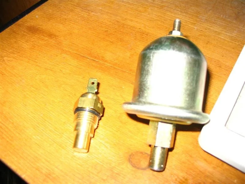

just picked these up at the local parts store (canada) do these look right ? i have never seen the toyota senders before because i am running small block . i am going to try the stock dash guages . i could not afford the toyota ones so i ordered these at the parts store . i hope they are right . i am waiting for the temp bushing from toyota right now that fits the small block . before i try them out . just thought i would ask if these look familiar thanks any info would be great

Yep, those look correct. The temp bushing is available from many sources. I have a couple lying around. The oil sender unit, if you plan to run the stock guages and an after market guage also, will have to run off a tee. Any parts store will have those. Last time I check on the LC oil pressure sensor at Autozone, it was $40 :eek: I dug up an old used one I had in my parts chest. Downey and Man-a-fre sell those adapters also.
