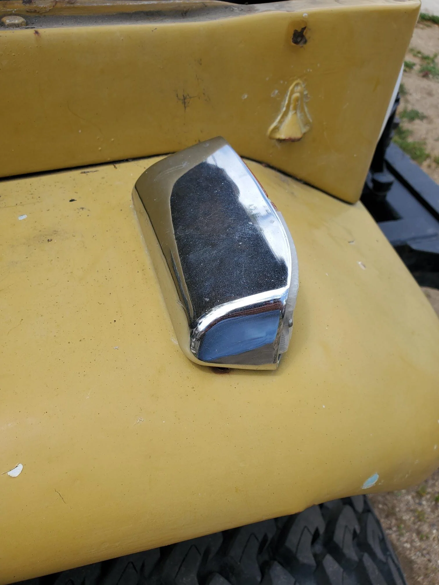

Red part of CA.
So I'm looking for new front turn signal lenses but I don't know if mine are stock . Maybe they're from other vehicle all together? Originally this BJ42 is from New Zealand (I don't know if that makes a difference), but I can't even find pics online of the ones I have. The original fenders have no other mounting holes besides the ones being used by current light fixtures. I like the design so I'd like to move them to my new fenders.., eventually.
Anyone know somebody that knows somebody?

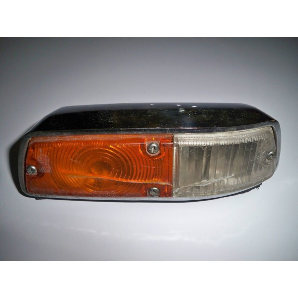

They're probably not stk. I think they would be koito. It looks like you can see cracks, filler and rust where the stk ones would be.
I'm gonna go out on a limb here and say those are not stock. Those look more like a tail light for some other Japanese vehicle.
Stanley is the light manufacturer for old Hondas. Others makes too, but they are more recent than that looks of that light.
Looks like it was an optional upgrade, or probably Euro market only light. Most early civics seem to have the larger amber only signal lights.
