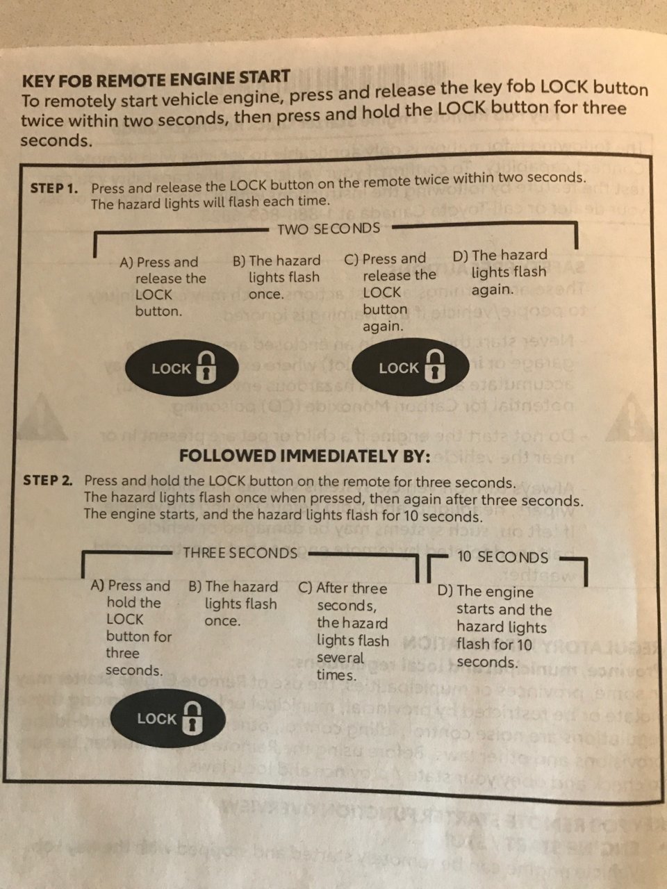

Yep, knew about that. You can also remote start the truck via the app. The truck doesn’t stay running though and will turn off as soon as you open the door, security for anti theft.
Same with aftermarket remote start on my 18. Which is annoying since the factory Entune has a DVR capability and you can rewind up to 20 minutes of live radio but when it shuts off it goes away. This past winter I ended up still going out to my truck with teh key, starting it up then tuning to my morning radio show and pressing pause. Radio commercials are the worst.
