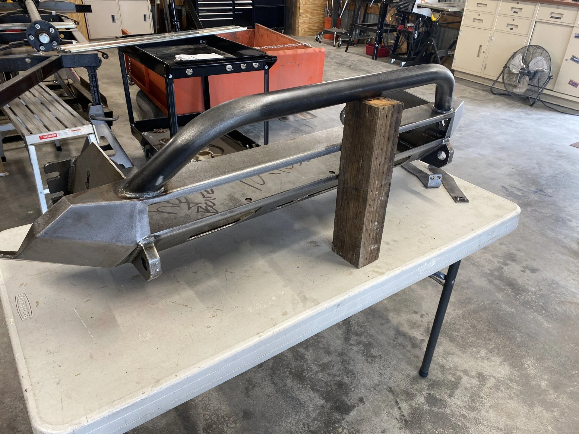

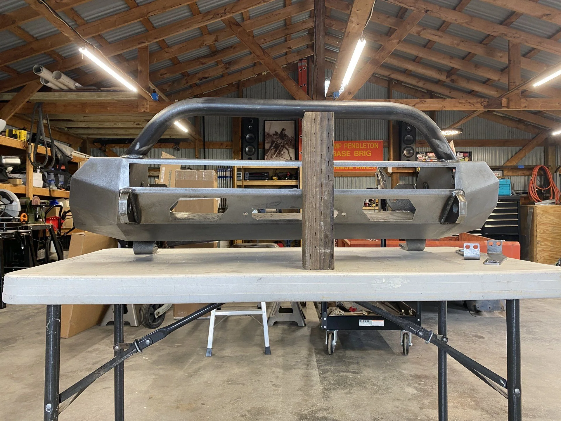

Bumper/winch mount arrived today. At this time I want to keep the bumper low key so I opted for the Southern Style Off Road Slimline bumper. It replaces the center of the plastic bumper (black area) with a steel insert. I choose to have the universal winch cut outs and a 30” light bar slot.
Now to get it cleaned up and painted.
I have the same bumper on mine, but got it Line-X'd (aluminum model.)
I've been happy with it so far. Nice choice!
Nice! How long did you have to wait for it?
FOREVER!!!
Not really. I ordered it on April 15th knowing that the shop was closed due to COVID-19 state mandate. They didn’t reopen until after Memorial Day. Don’t know how backed up they were but I feel they processed a custom fab order in an appropriate amount of time.
Long after my order and after I was notified that fabrication had begun did I find out that I could have just ordered a kit and welded it up myself. :meh: Would have saved a lot of time and some $$$.
Really?? I didn't know they did kits. I already have a light bar right below the grill so I'd go without the stinger. You still have to cut the painted part of the bumper for this one to fit right?

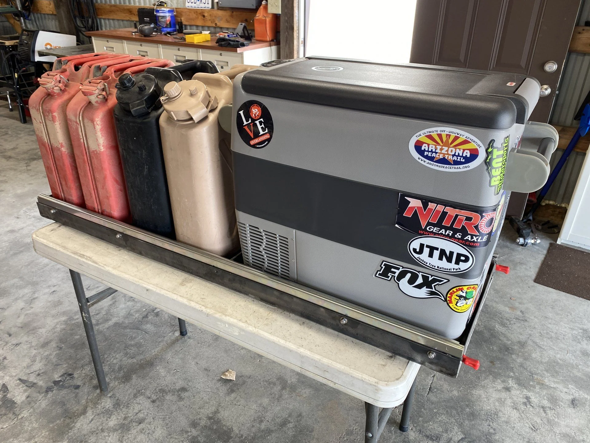

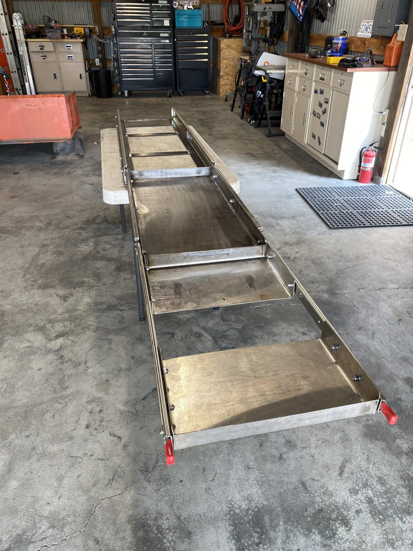

Finally getting caught up on things. Got the fridge/jerry can slide rack complete. Now I just need to add the strap attachments, paint it, and mount it in the bed of the Tacoma.
