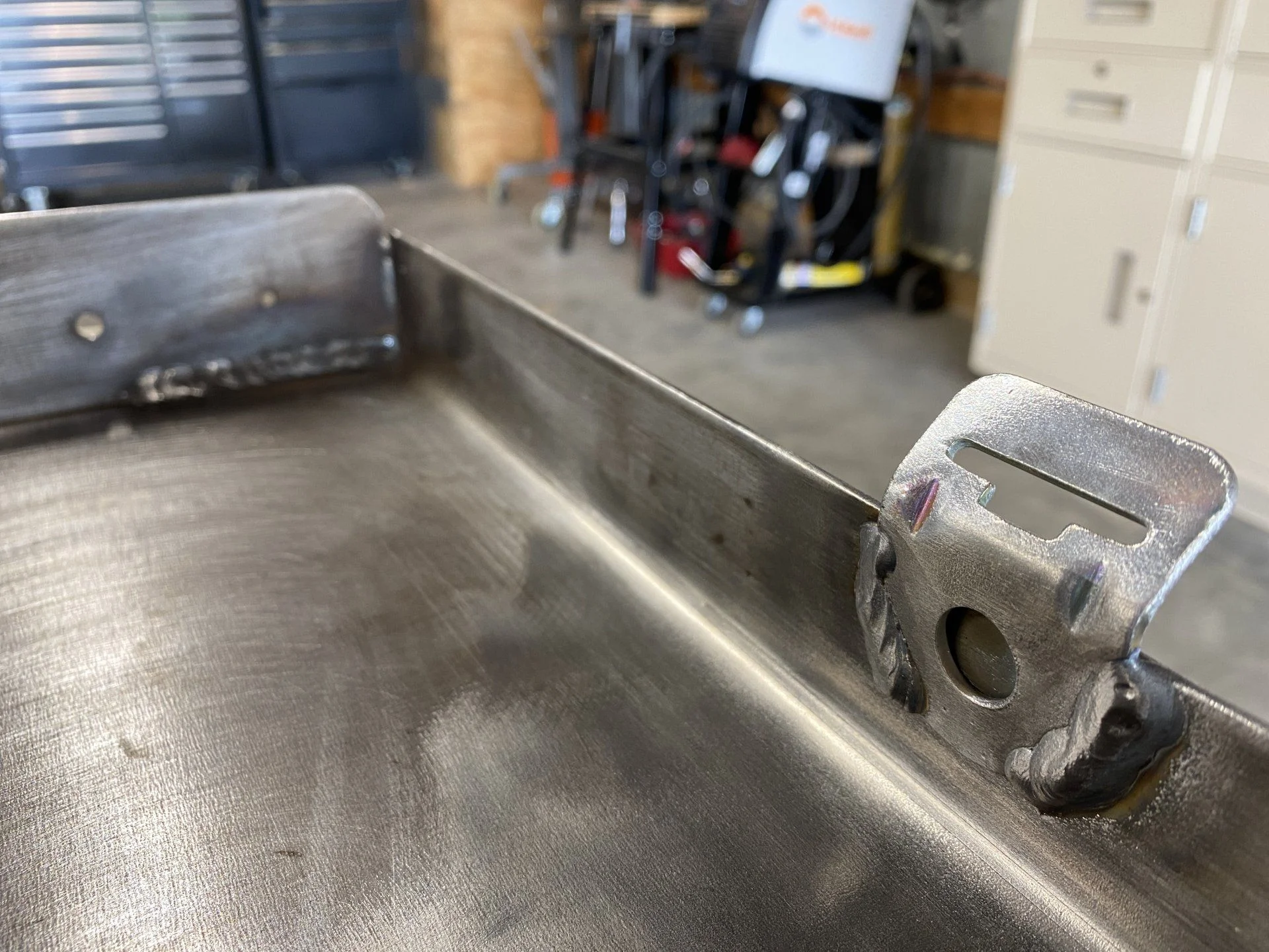

Would I trust my life with this weld... I’m guessing the tab will break first. It’s not bad for 115, I miss having 230v in the shop. this dead power leg is killing me
A flat bill welding hood maybe? We need you back here to fab for us!!

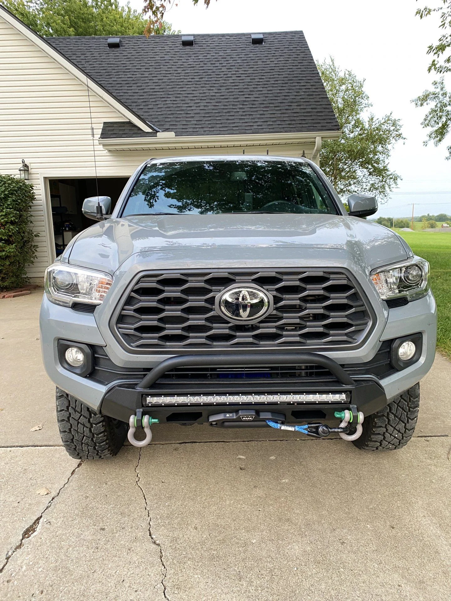

Bouncing back and forth between different projects. Got the bumper, winch, and light bar mounted on the truck.

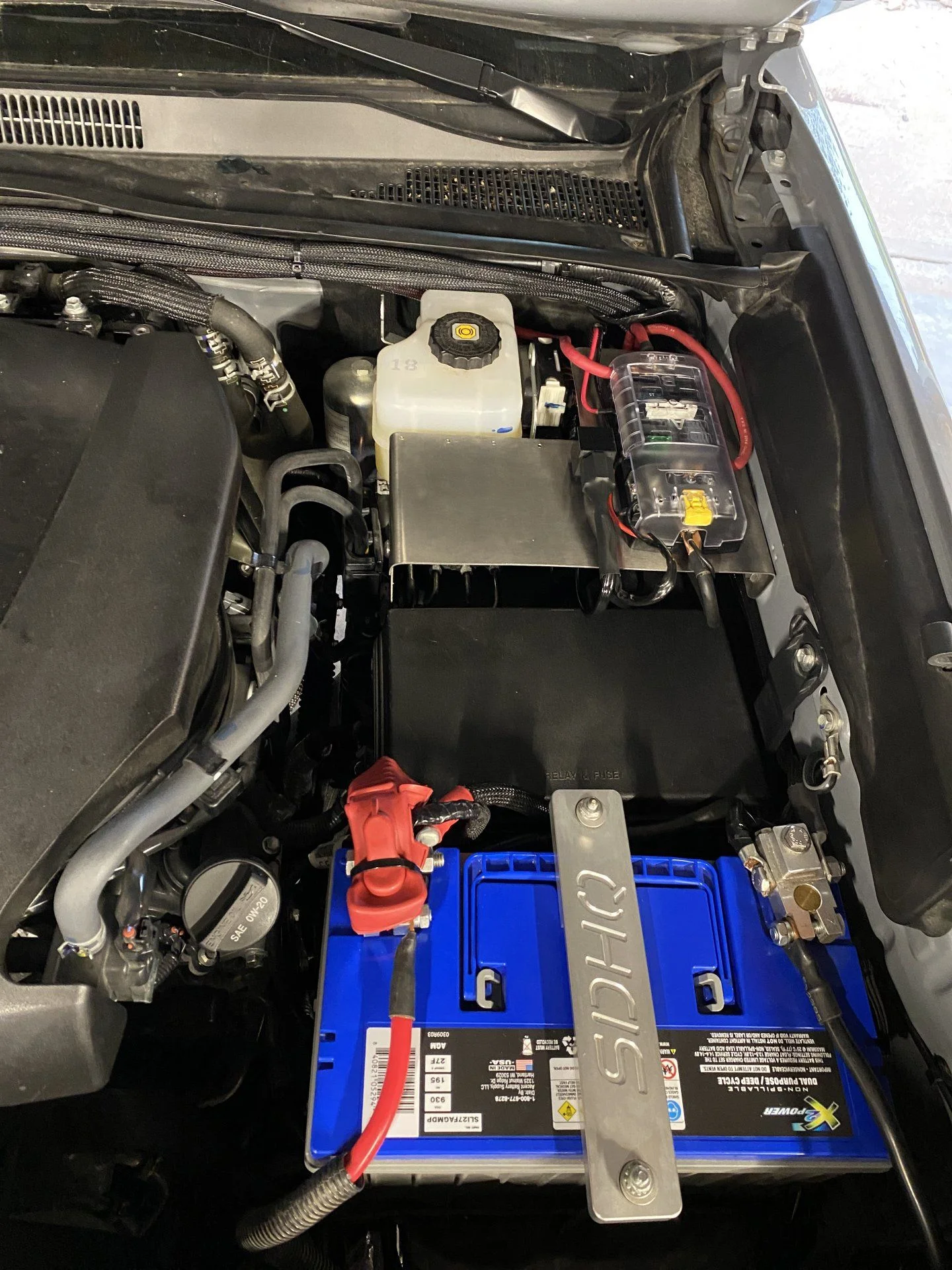

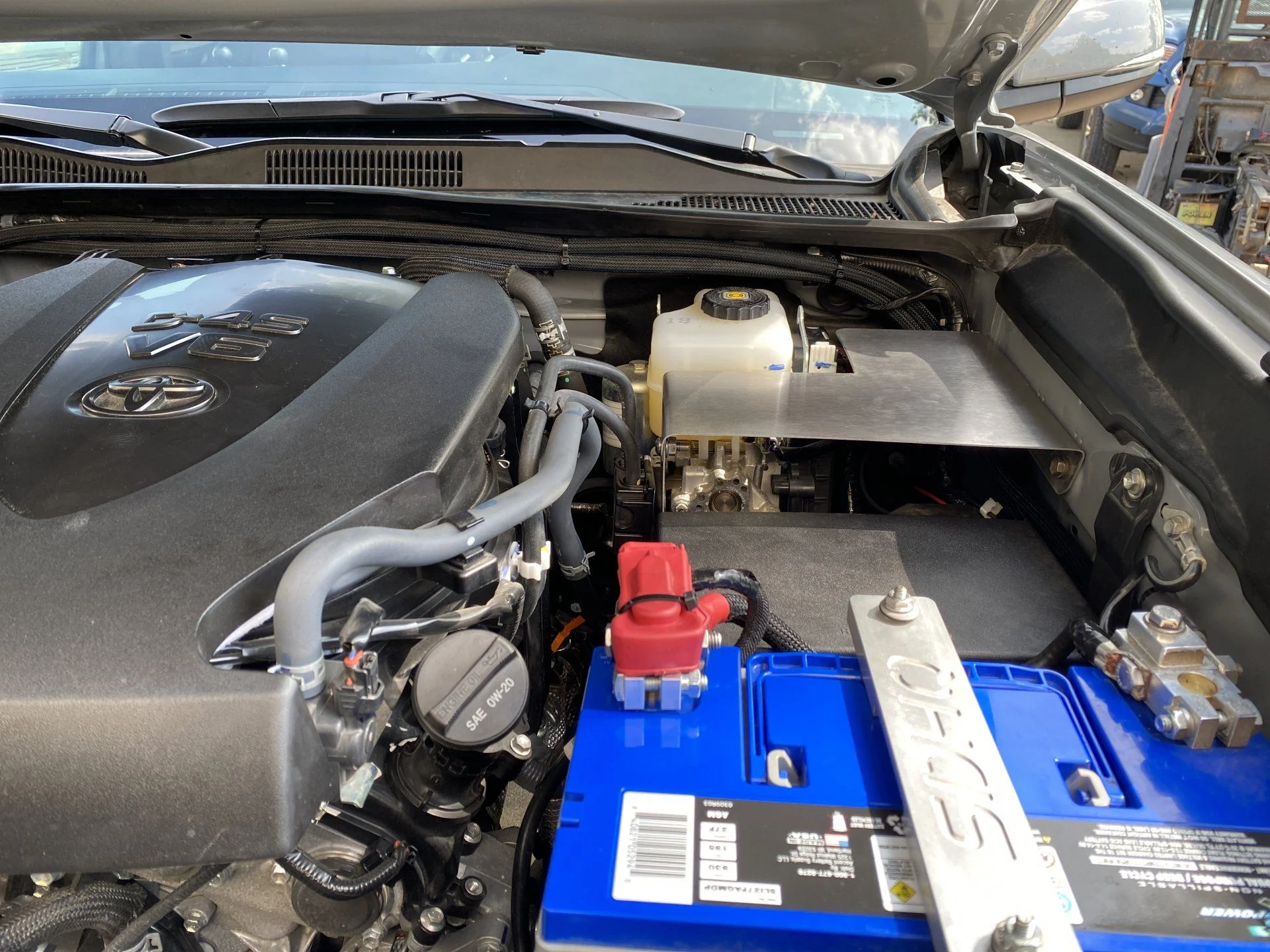

Which meant I needed to start thinking about my accessory circuits. Bent up some more stainless and made a “power tray.” I have 4awg going from the house battery through a MIDI fuse to the Blue Sea 50/50 switched fuse panel to the B leg (always hot). I used an 80amp relay to provide power to the switched side A Leg (ACC Power) and used an add a fuse in the factory engine bay panel to trigger the relay. The relay is mounted under the tray in the rear. I have the tray setup with enough space for 5 40amp relays on the top. Hopefully that’s enough for expansion. I was I. A bit of a rush this evening and used the wiring that came with the light bar to hook it up. I’ll redo it in the future with a weatherproof relay when I have more time.
Still need to wire in a new circuit for power to the bed for the air compressor and fridge. One step at a time.
Bouncing back and forth between different projects. Got the bumper, winch, and light bar mounted on the truck. View attachment 2443383Which meant I needed to start thinking about my accessory circuits. Bent up some more stainless and made a “power tray.” I have 4awg going from the house battery through a MIDI fuse to the Blue Sea 50/50 switched fuse panel to the B leg (always hot). I used an 80amp relay to provide power to the switched side A Leg (ACC Power) and used an add a fuse in the factory engine bay panel to trigger the relay. The relay is mounted under the tray in the rear. I have the tray setup with enough space for 5 40amp relays on the top. Hopefully that’s enough for expansion. I was I. A bit of a rush this evening and used the wiring that came with the light bar to hook it up. I’ll redo it in the future with a weatherproof relay when I have more time.

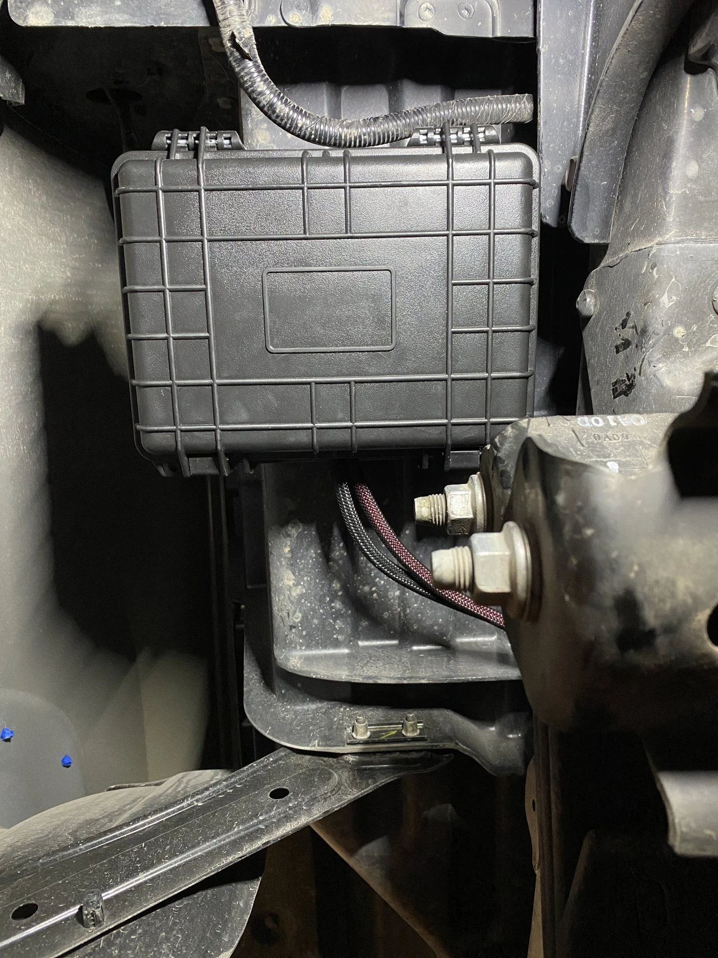

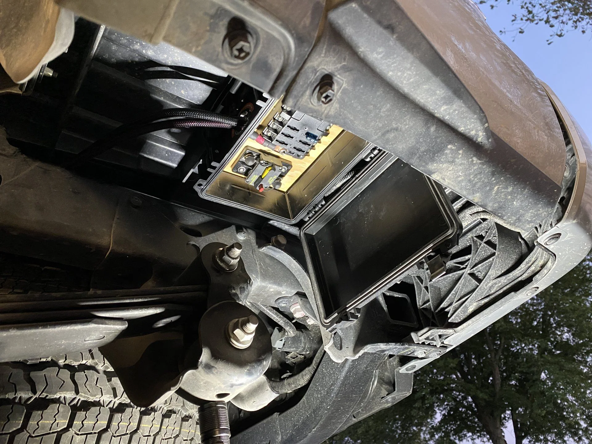

I’d been trying to come up with an idea of where to put a fuse panel in the rear of the truck for power to the fridge and air compressor. I’m going to try this and hope I don’t burn the truck to the ground. I carefully ran 4 gauge from the house battery along the driver side frame rail following the factory loom to the bottom of the bed. I mounted a Harbor Freight “weatherproof” case under the bed in the rear for the fuse panel and circuit breaker.

Seems clever - does the box have a gasket? On my phone, tough to see. Since water and snow will be flung there.
People modify Pelican boxes and small Ammo cans into junction boxes for marine applications.

Yes, it has a gasket. It just doesn’t have the higher end cam style locks like a real Pelican Case. Otherwise the construction is pretty good. Time will tell though.

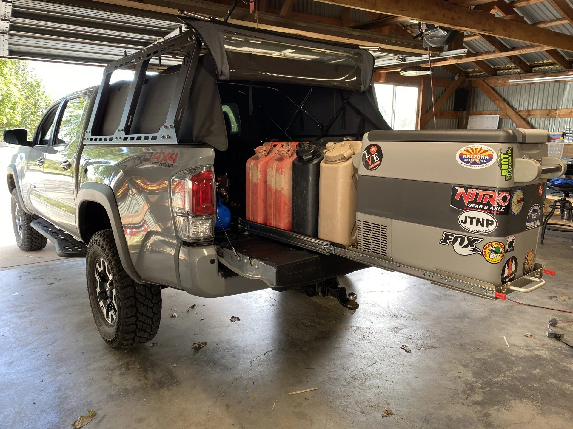

Finally installed in the bed of the Tacoma. I hope the composite bed holds up.

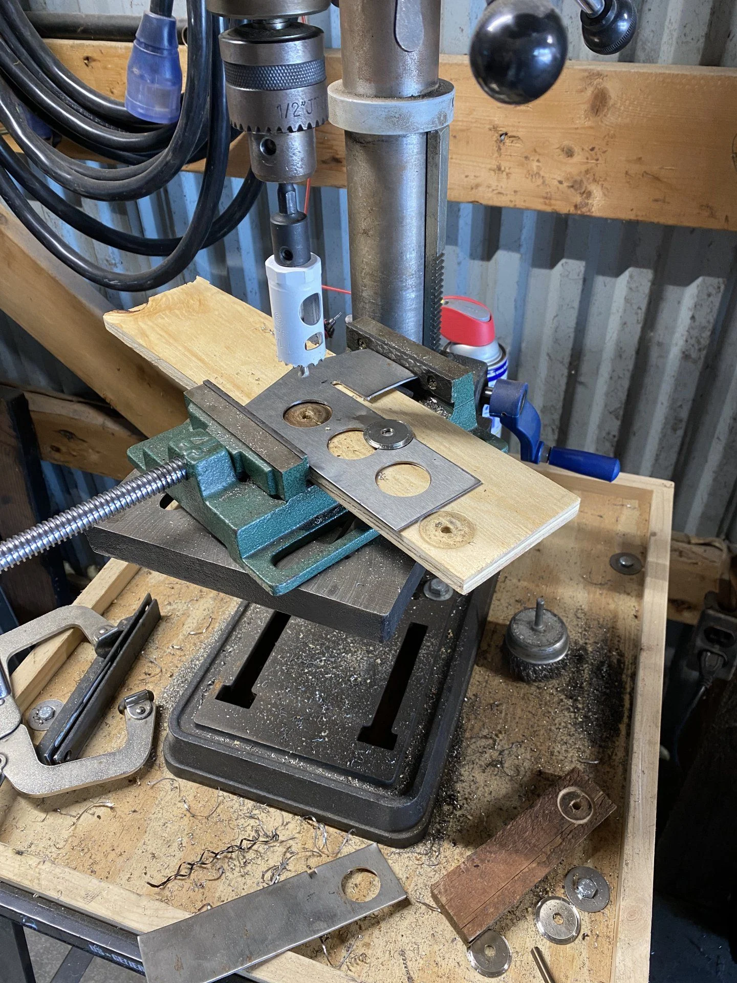

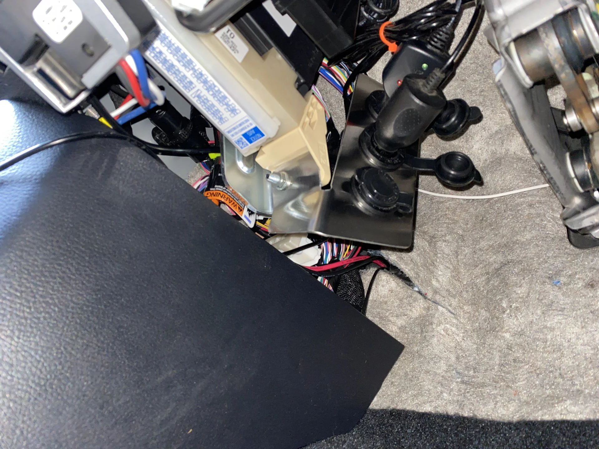

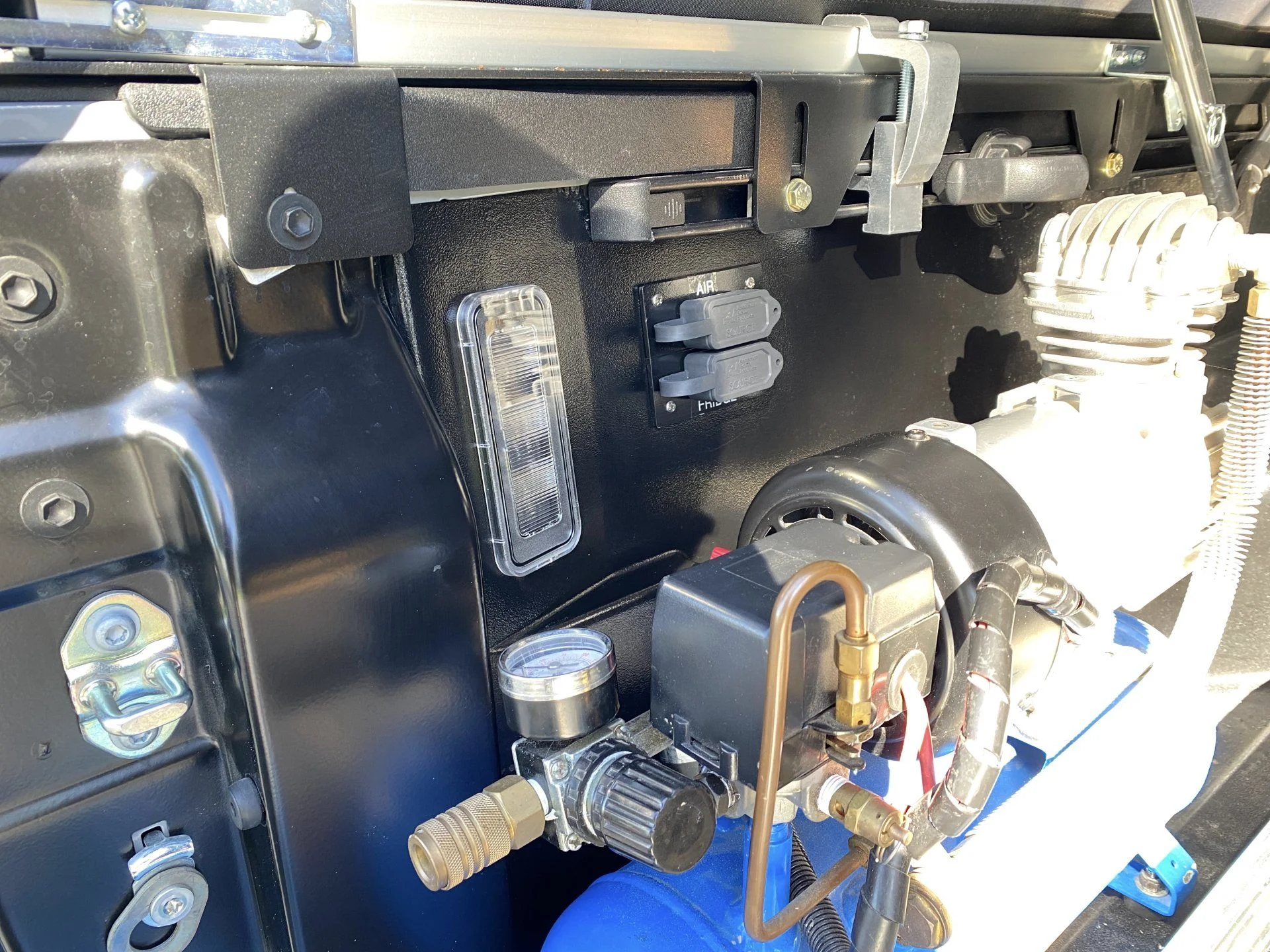

I wanted more auxiliary ports in the front for the dash cam, Garmin GLO GPS receiver, etc. I know I could just cut the ends off the cables and wire them in directly but I like having options. On my LX450 build I had made a aux port mount in the driver kick panel so I figured I’d do the same here. Stainless steel seems to be my main media lately since I have a scrap sheet of 14ga.

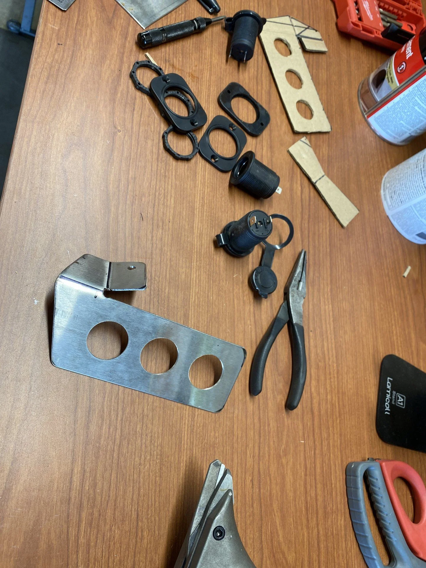

Cardboard Aid Design again to dial in a prototype before cutting it out with the metal shears, a little hole saw action, some bending, and voila! A mounting bracket!
Added the Blue Sea aux ports, now just need to wire it.

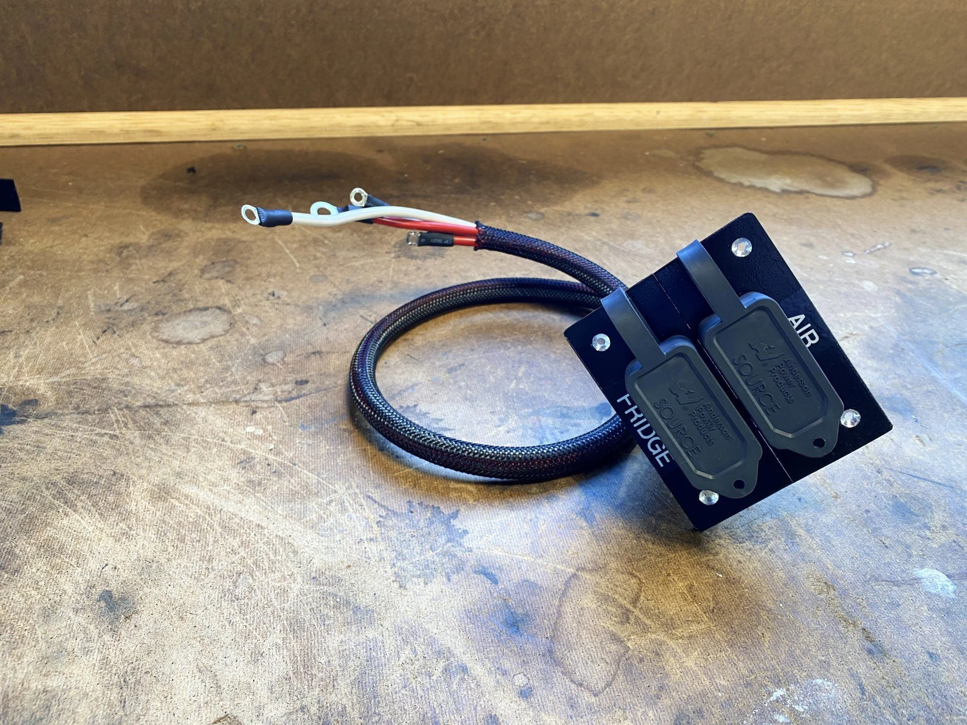

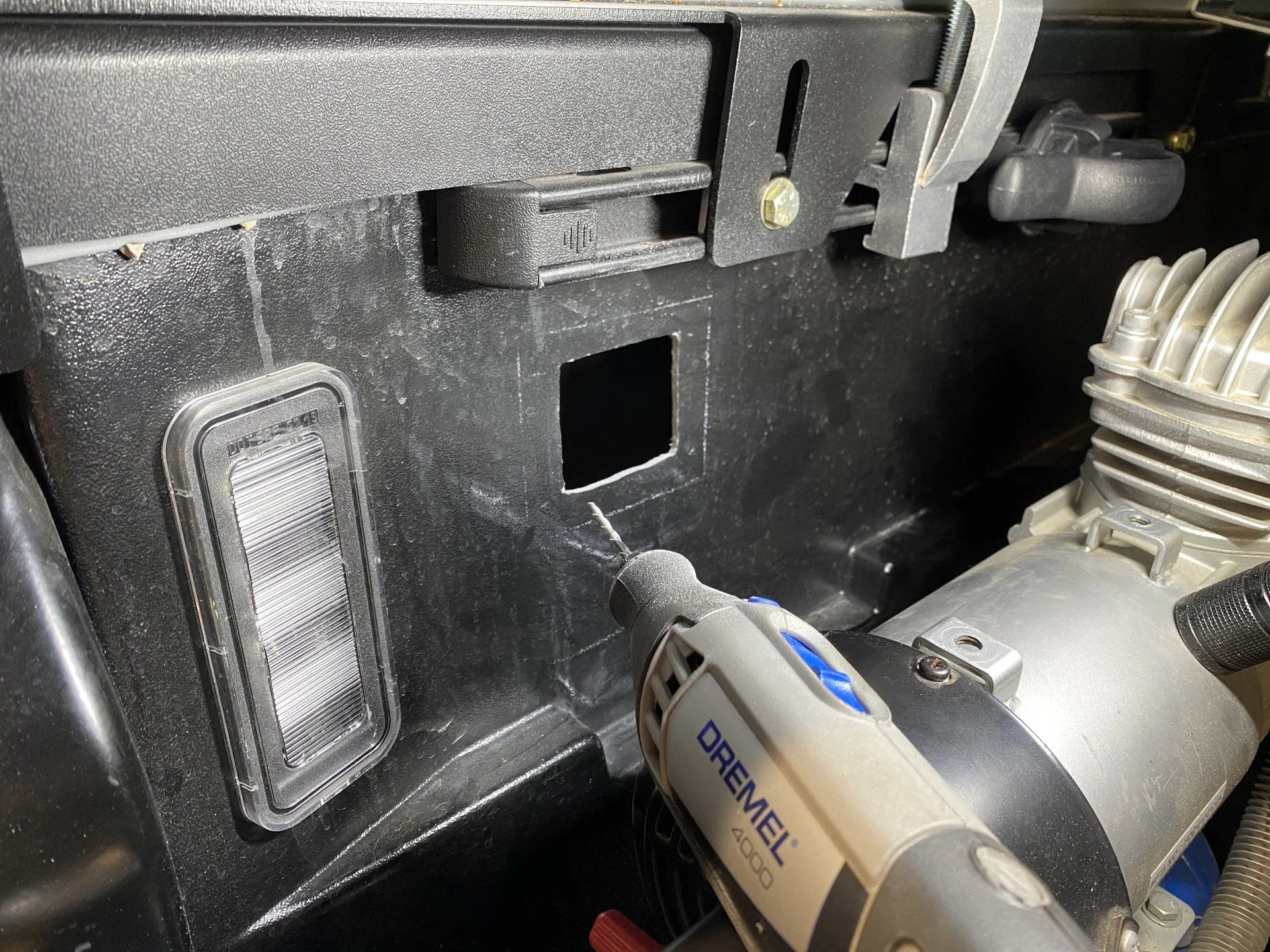

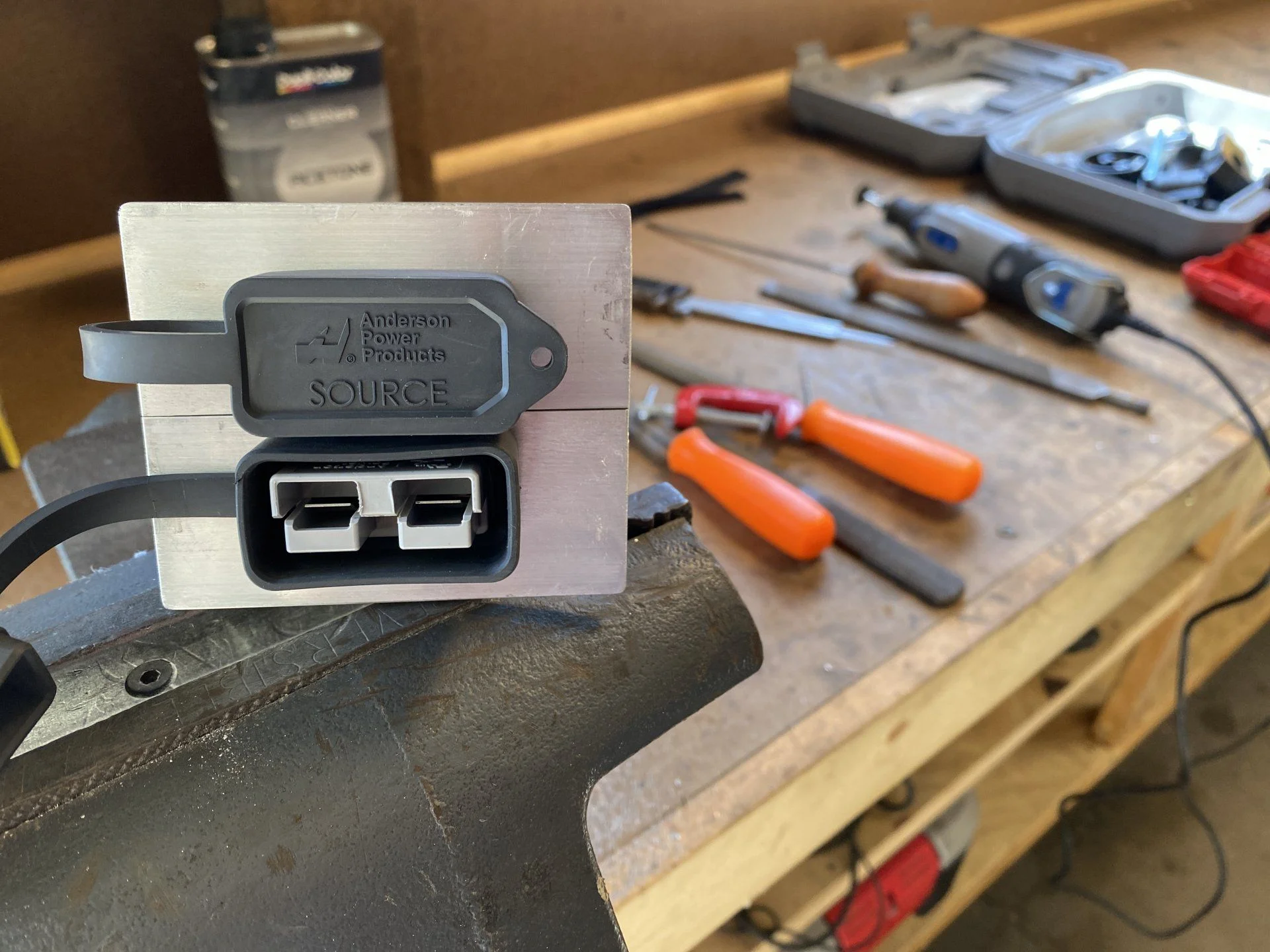

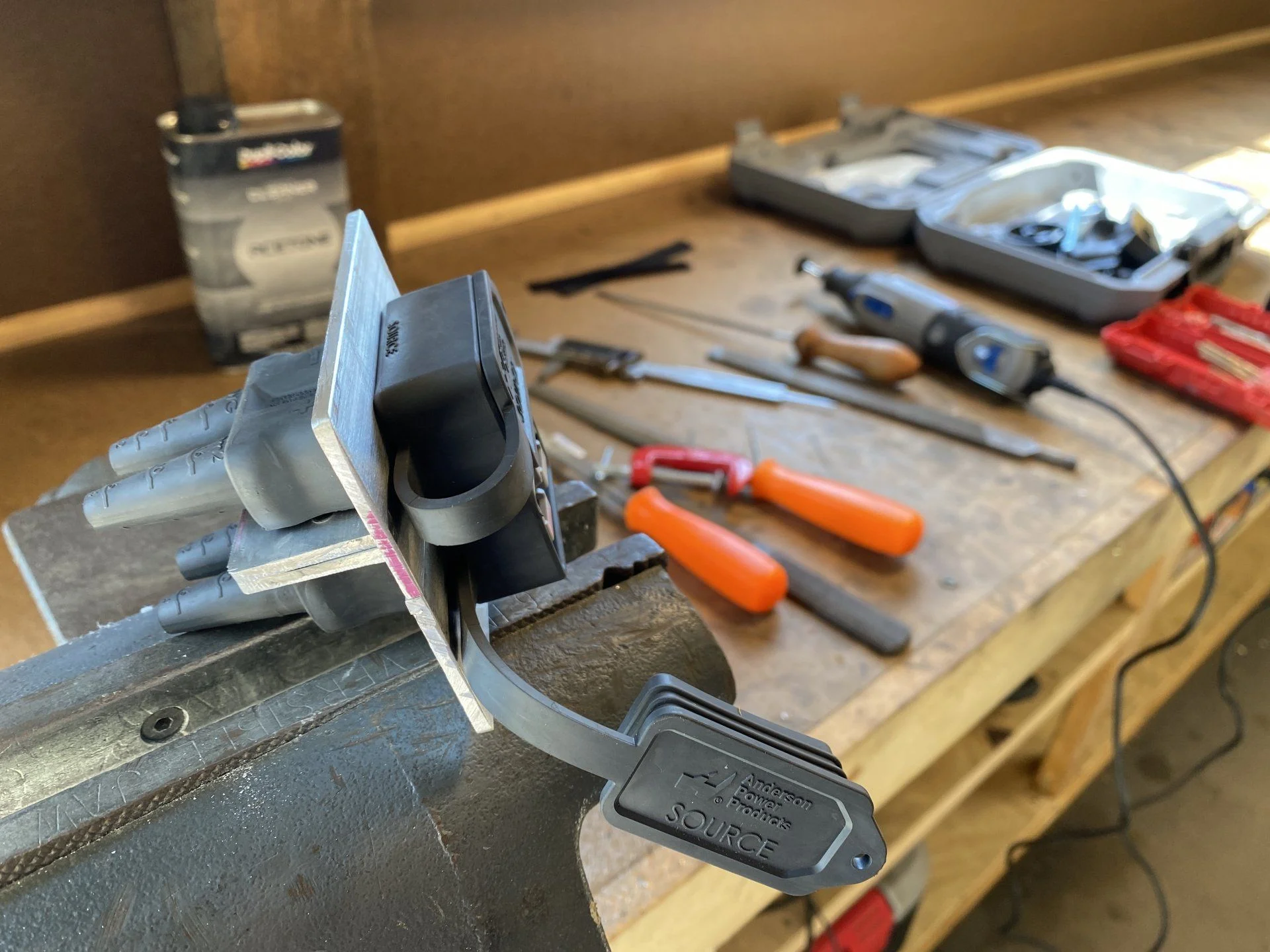

A little more progress. Made a bracket to hold the Anderson SB50’s for the fridge and air compressor in the bed of the Tacoma. Hopefully the environmental boots will keep the moisture out. Cut a hole in the bed to mount it, the drywall attachment on the Dremel worked perfectly.
Finished up the bracket and wiring this morning, installed in the truck. 15amps to the fridge and 80amps to the air compressor. (Compressor peaks around 65 at startup then runs at 35).

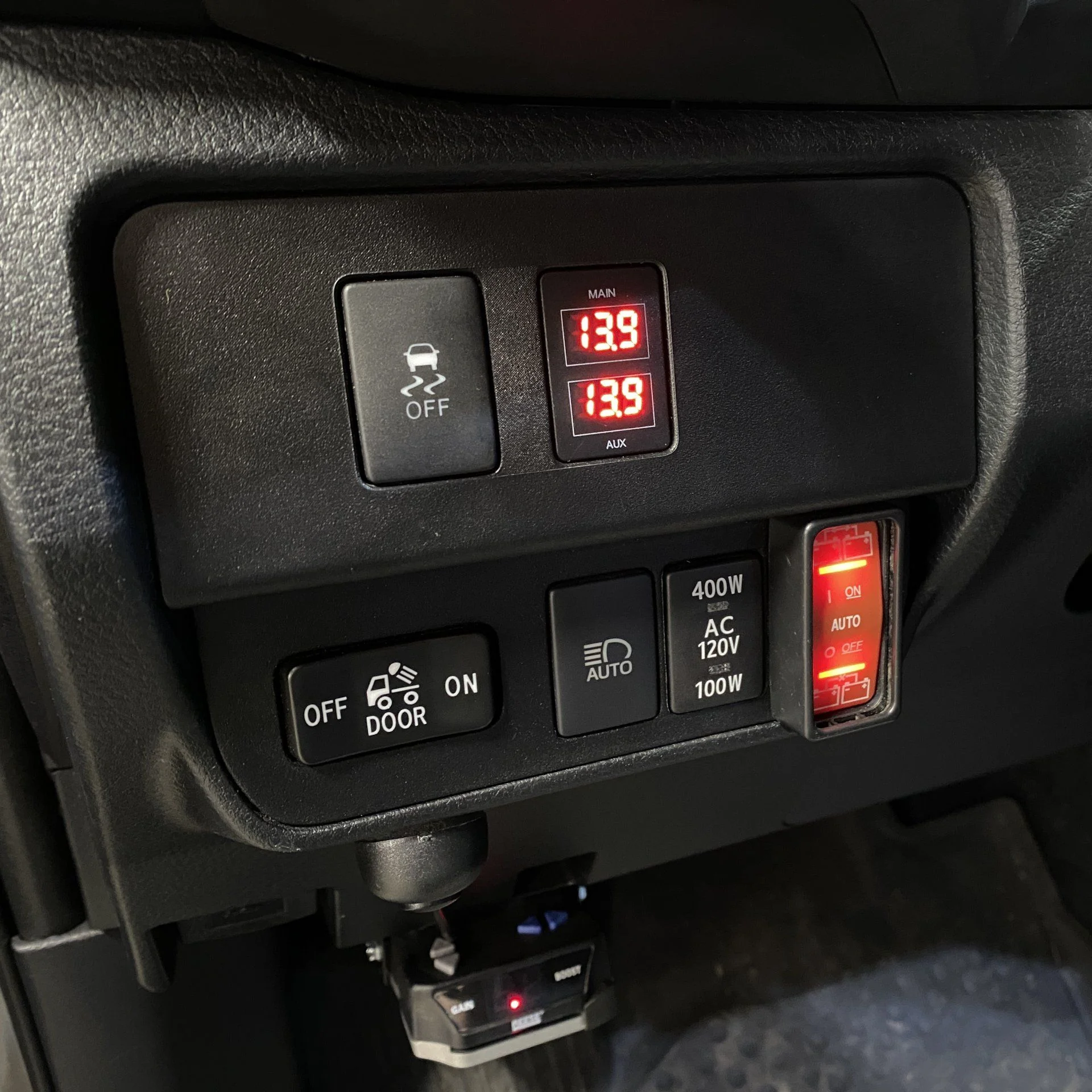

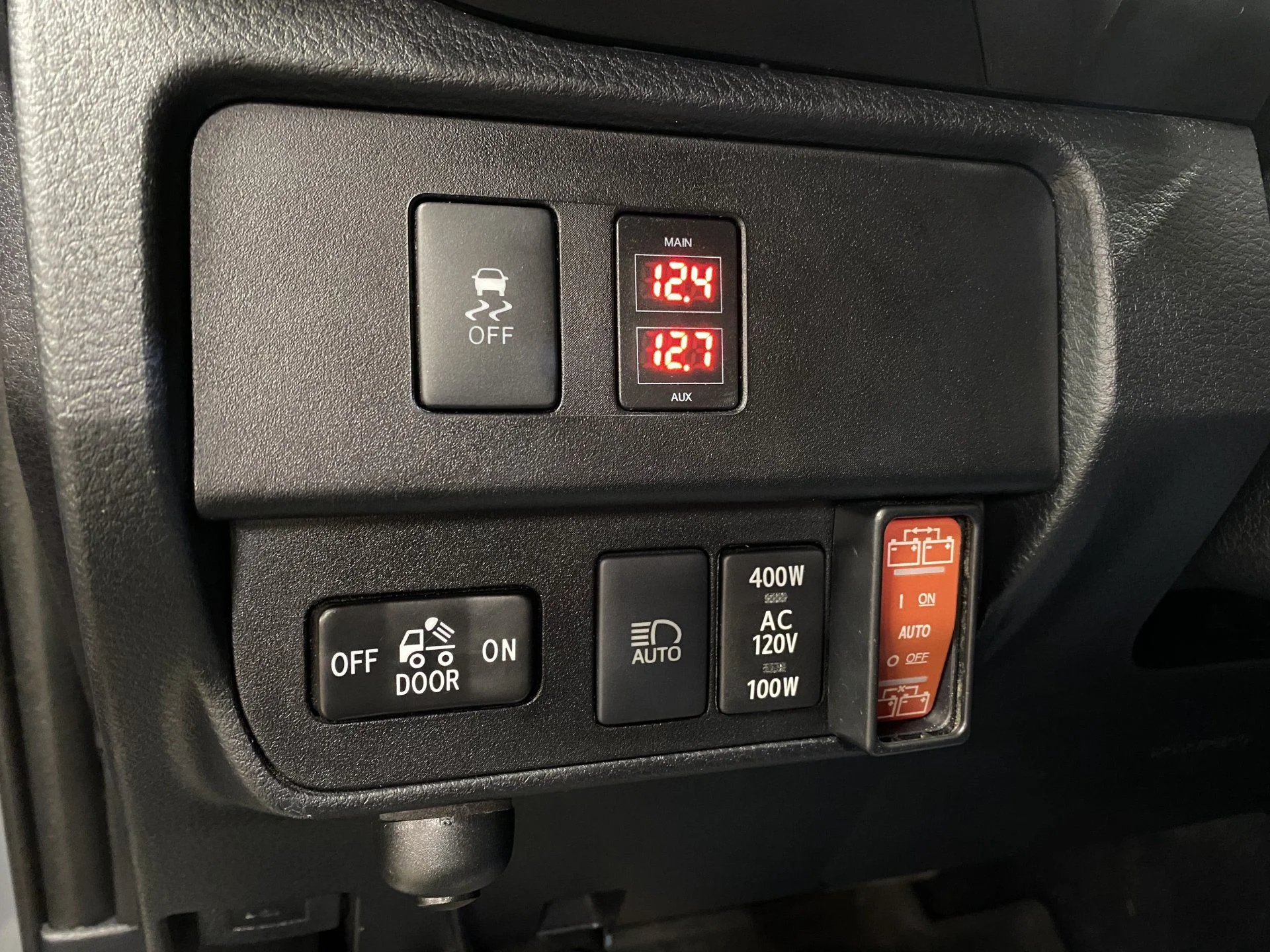

Finally got around to wiring in the dual voltmeter. I purchased the voltmeter from SolidKits out of Australia as it was the only one I could find that would fit a factory dash blank. After a quick bench test to see how if functioned since it didn’t come with any instructions I found that both displays are hot all the time. So I was going to need some relays.
The Main display I wired up to the start battery (pin 30-pos of battery w/in-line fuse, 85-gnd, 86-to switch power of the stinger relay for the auxiliary fuse block, 87-to voltmeter). The Aux display was much easier, direct to the switched power side of the auxiliary fuse block w/in-line fuse. Both displays are grounded by tapping into the BlueSea remote dash switch ground that goes back the the House battery.
I wired it this way so that the displays are both pulling directly from the batteries without going through the factory harness so I shouldn’t see voltage drops. Truck idling with the switch set to automatic shows a steady 13.9 to both batteries.
Manually disconnected and left to sit for a few hours.
