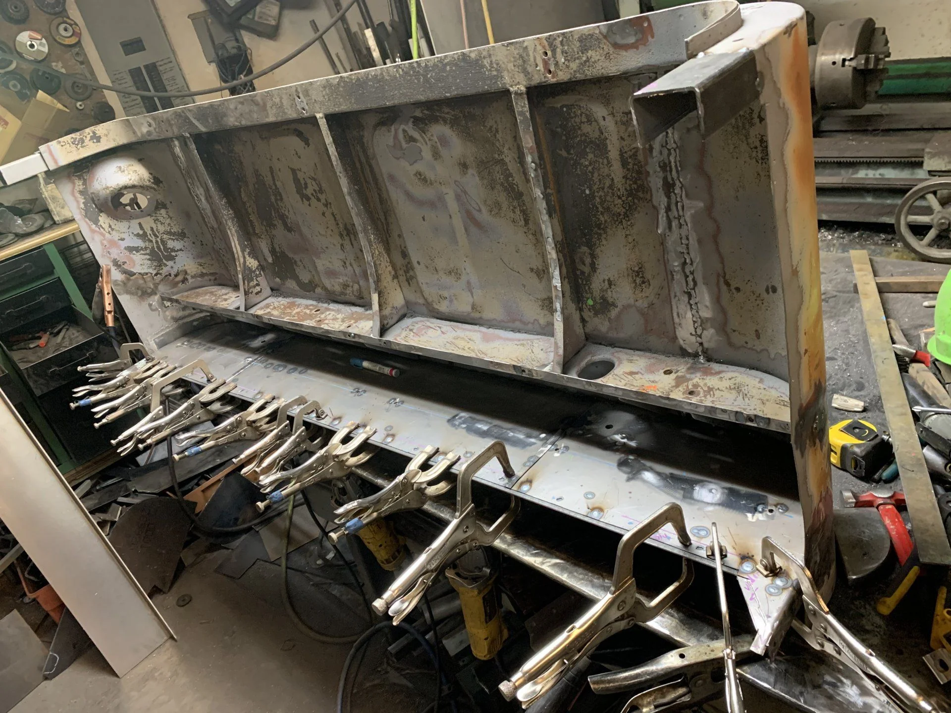

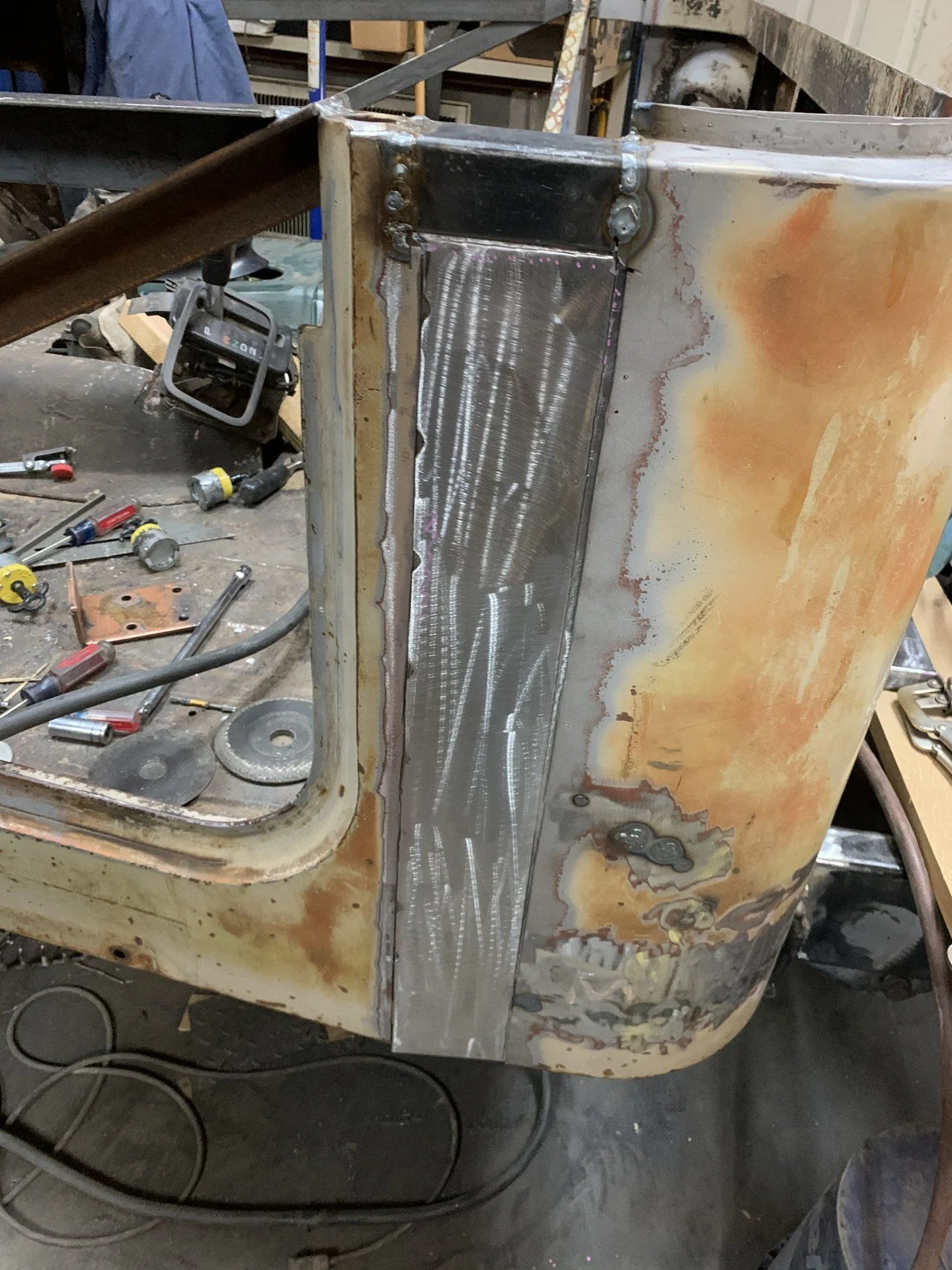

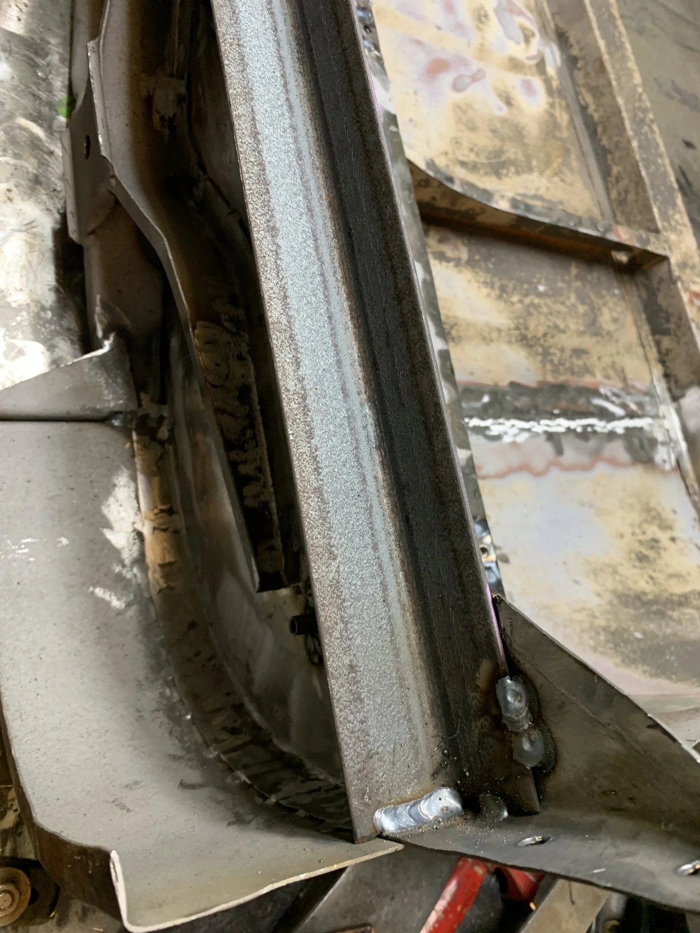

And on. Also started cleaning up the welds.
Been busy on some house projects but making slow progress on this. Cleaned up all the welds

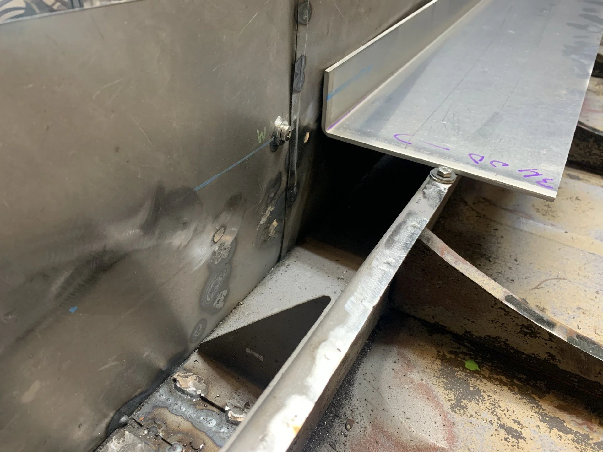

and decided to use some 3/16 bent aluminum to make the cover for the old box, new storage area
welded in not retainers for the aluminum piece

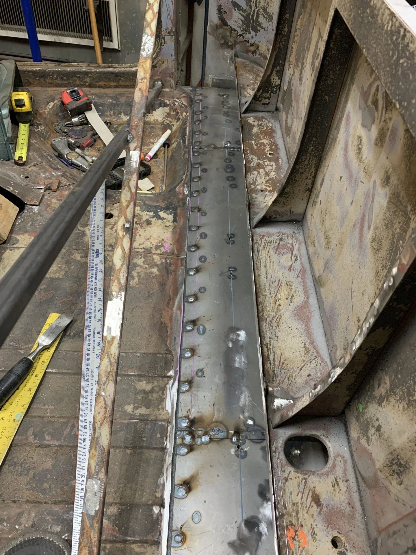

I forgot to take pictures of the second test fit and alignment that led o final cut and now I’m putting the angle iron support under the joint
Ta-da. I think we’re about ready to install it..
Tacked in place and my son came out to help me put pressure down in the center as I had no clamps long enough
Everythingseems to lineup

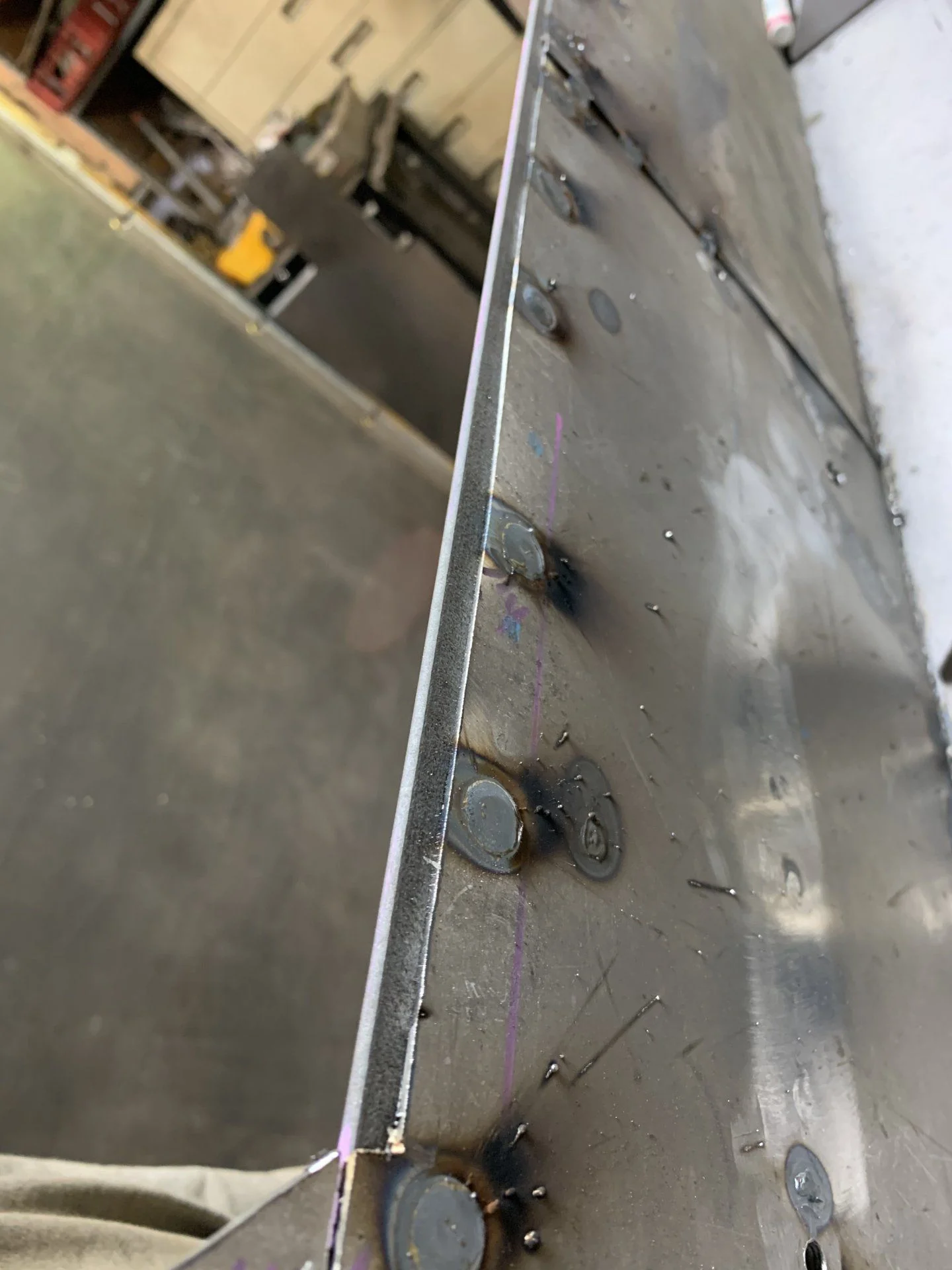

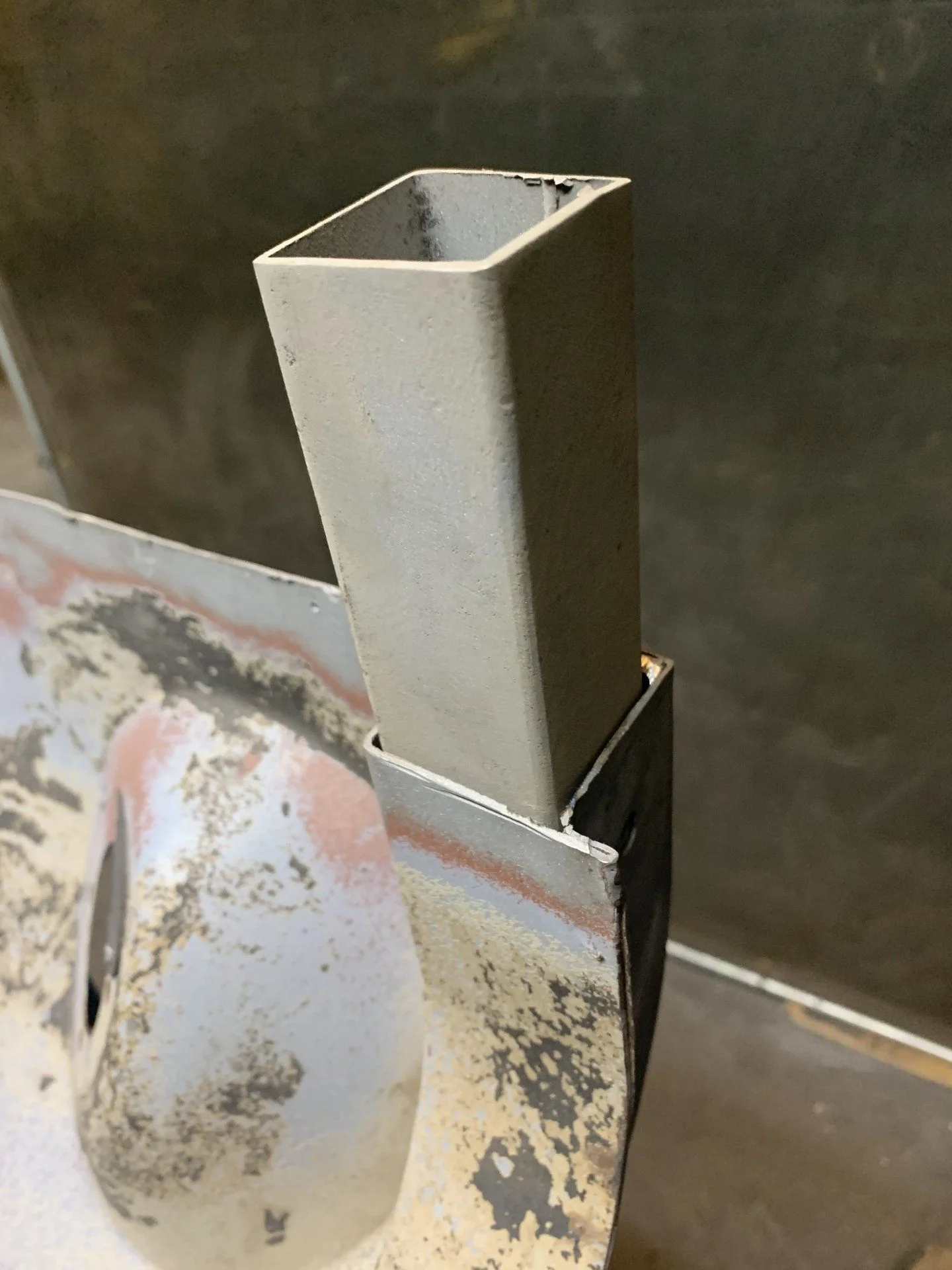

Then started making the 3 1/2 inch filler pieces
Tacked.

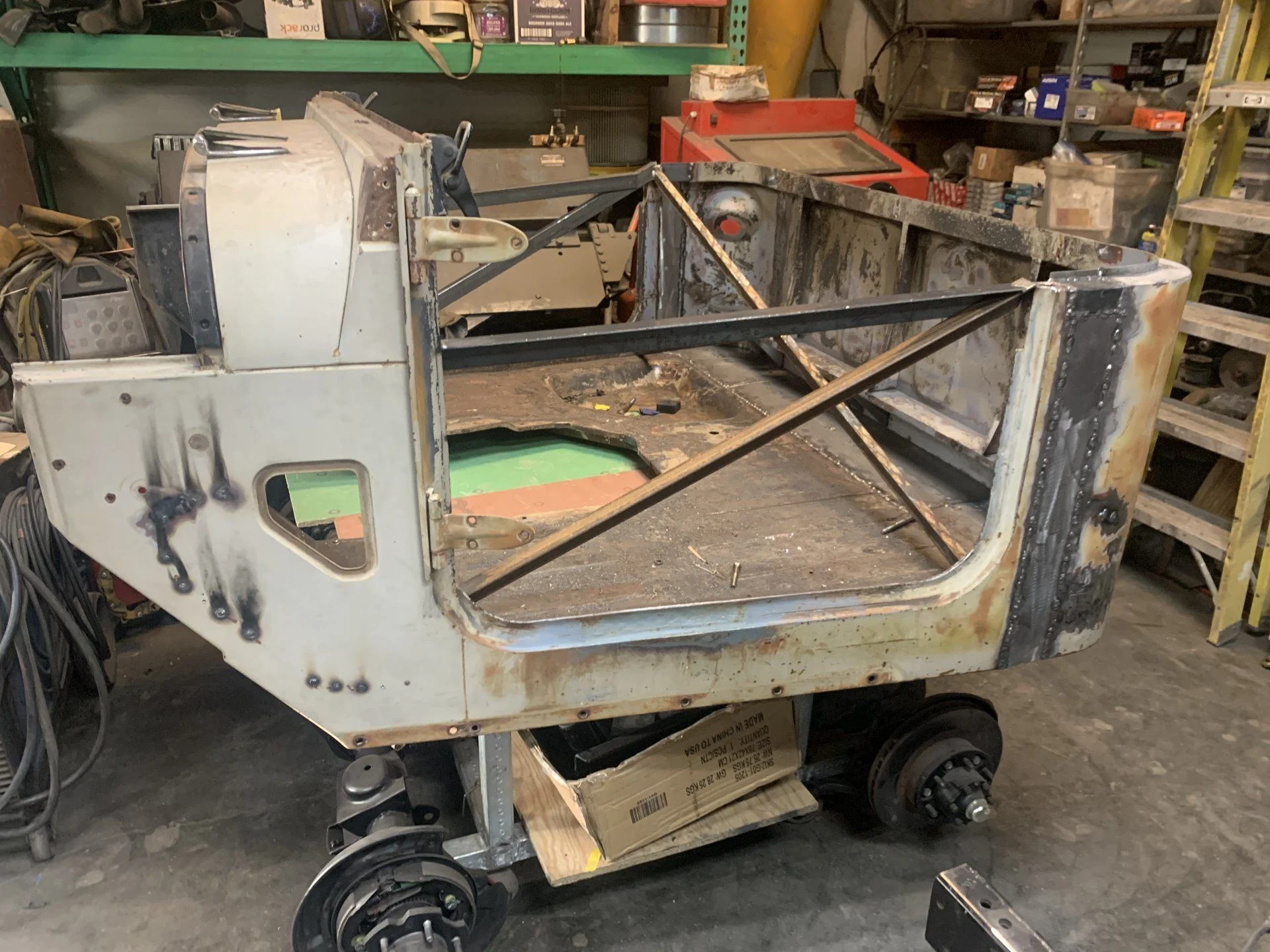

@tornadoalleycruiser stopped by on Saturday and helped me get the frame separated from the cab. He also help me make a points list of all the things I need to do to the tub. He has a build of a 45 going now with a 3FE that you can find over on the 45 forum. We have a little wager about who’s going to get finished first.

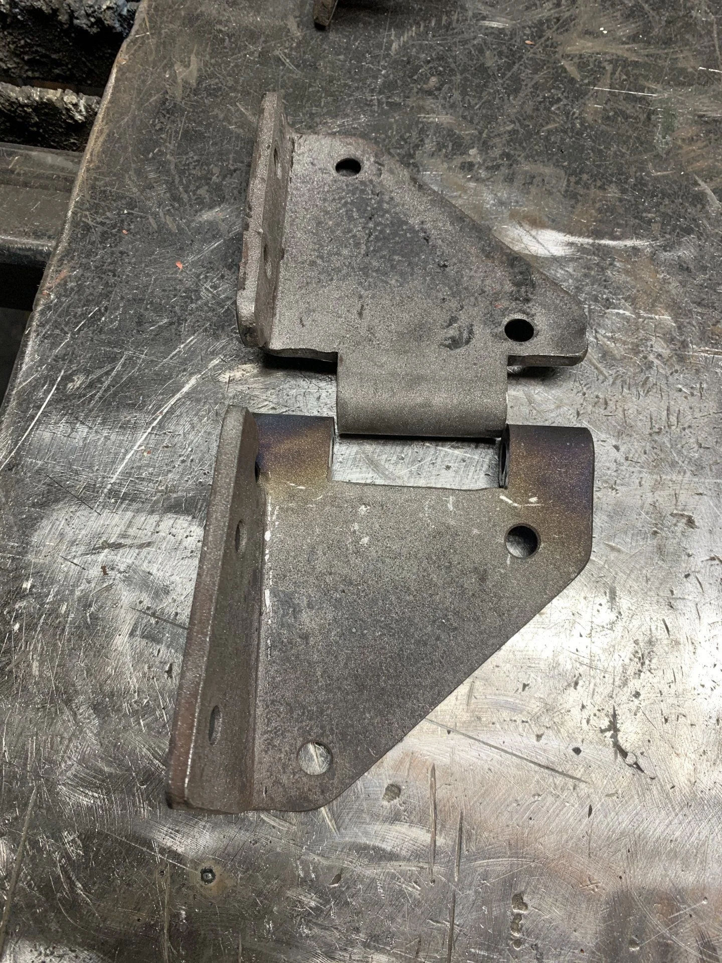

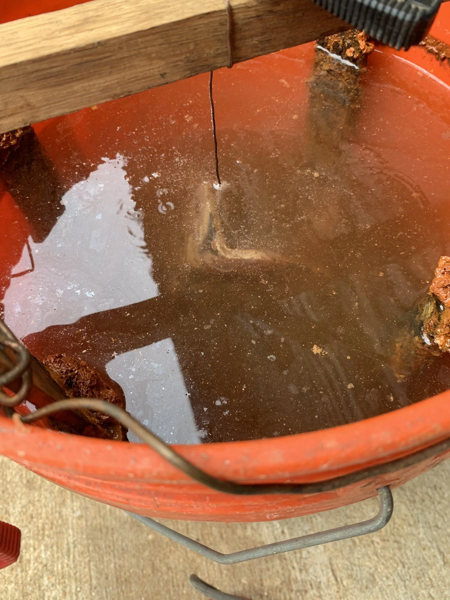

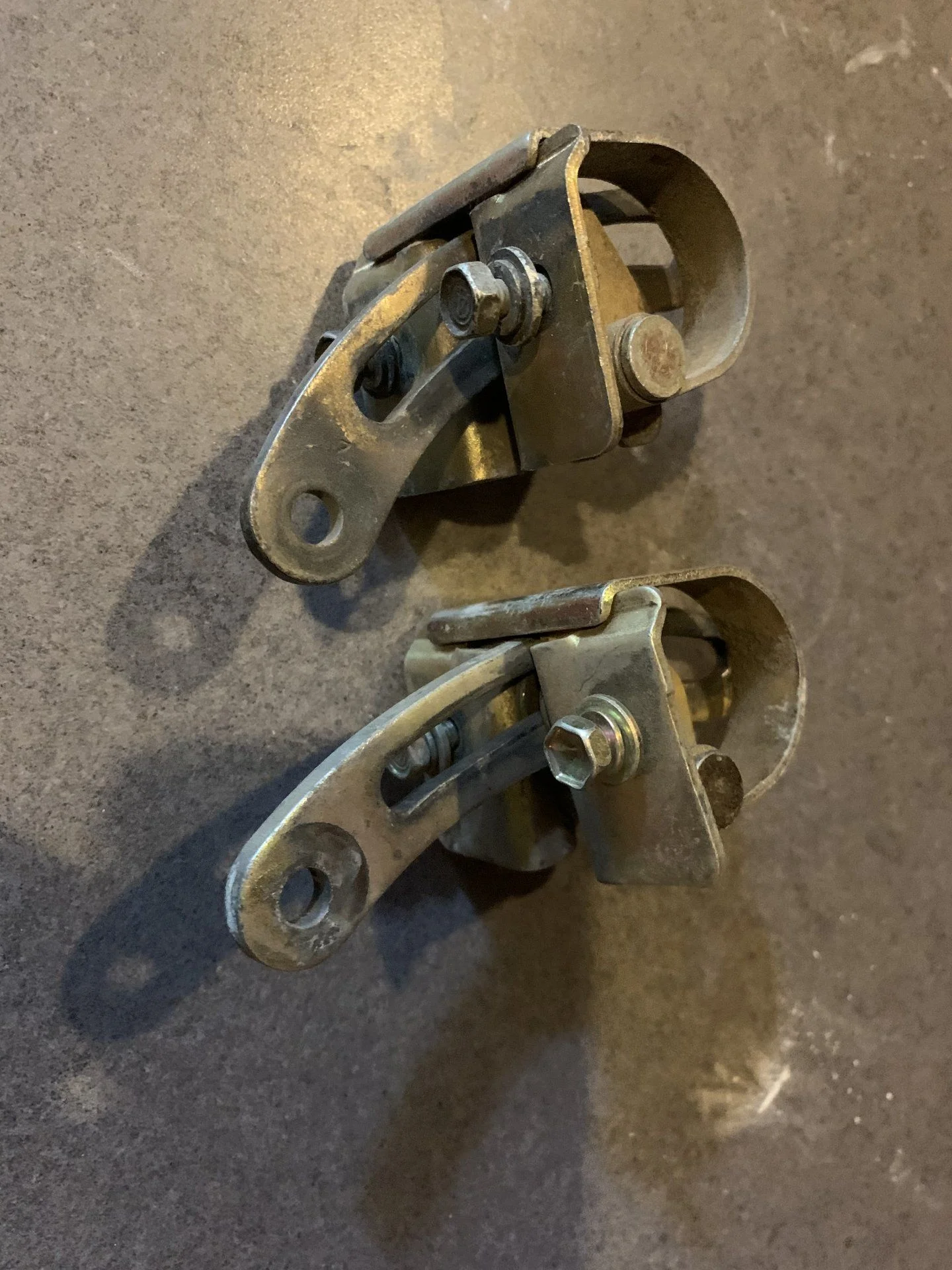

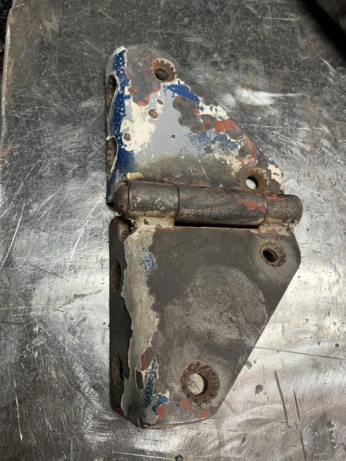

Starting to work on the hinges with @tornadoalleycruiser
elecrolosis was able to take hinge that would not budge, and make it swing freely. unfortunately, still could not get pin out, with moderate heat.
I ended up having to drill the pin out on this one. Will put brass bushings in and hopefully never have to work on these again.

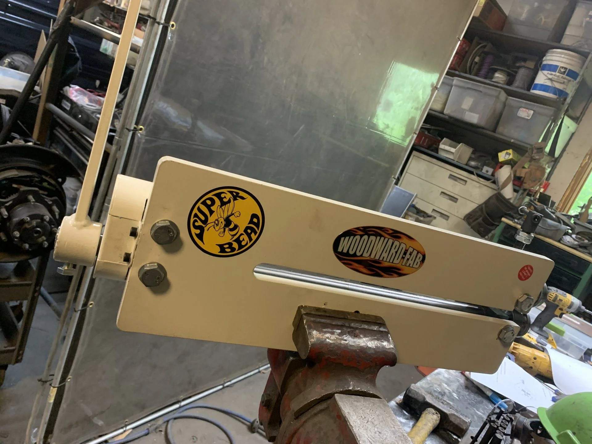

Got a new toy for the shop.

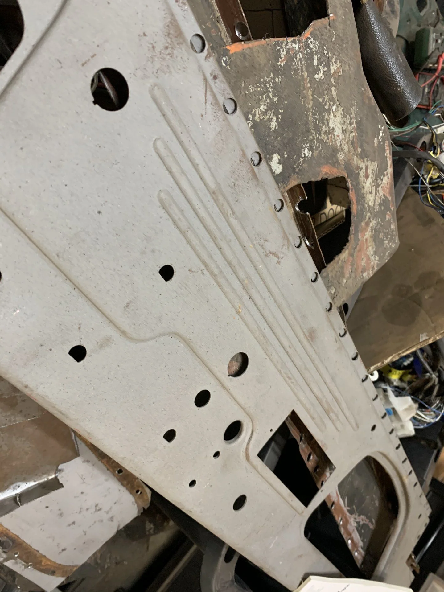

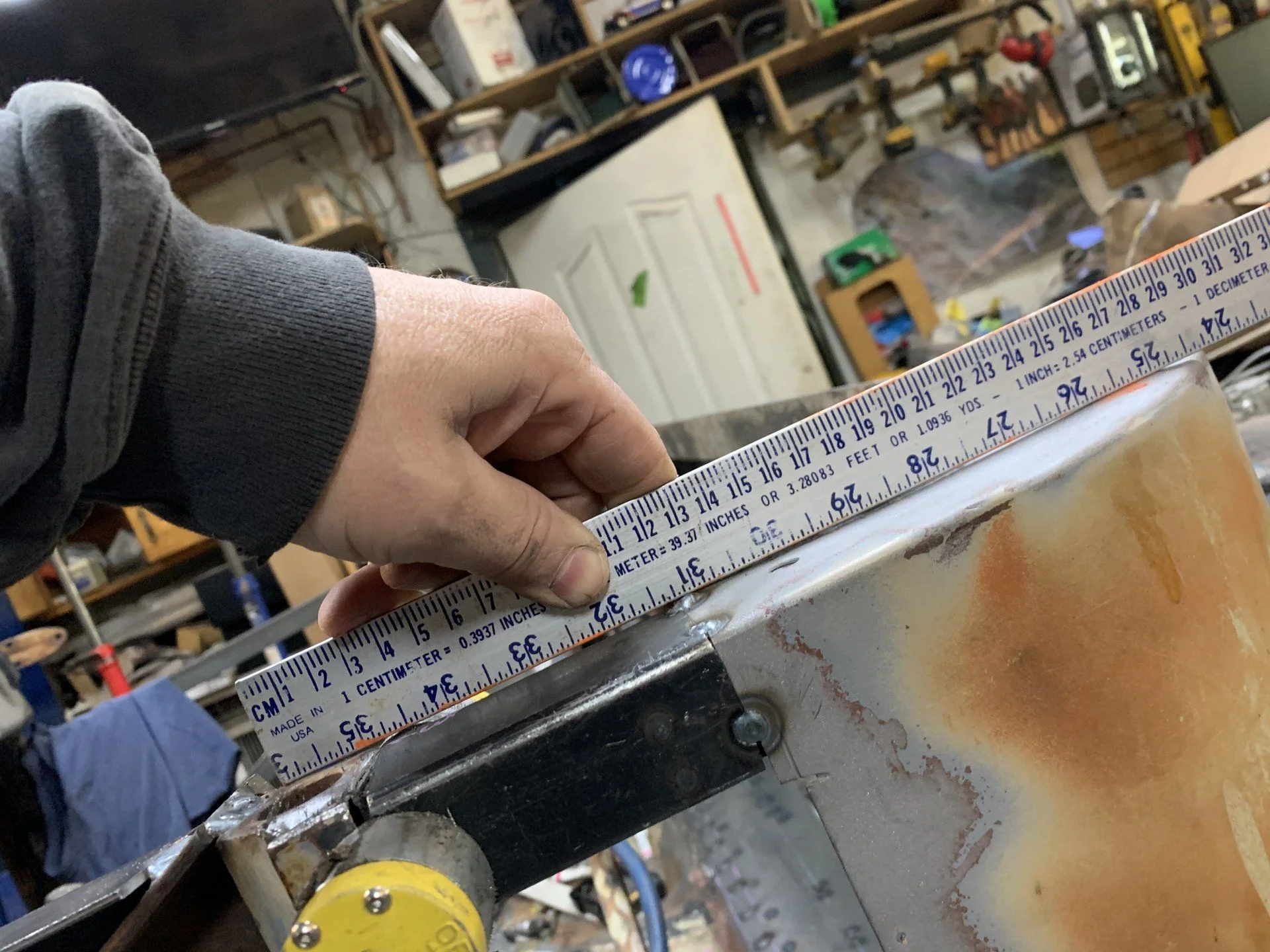

What did you try to mimic the dash when I get rid of the hump on firewall.

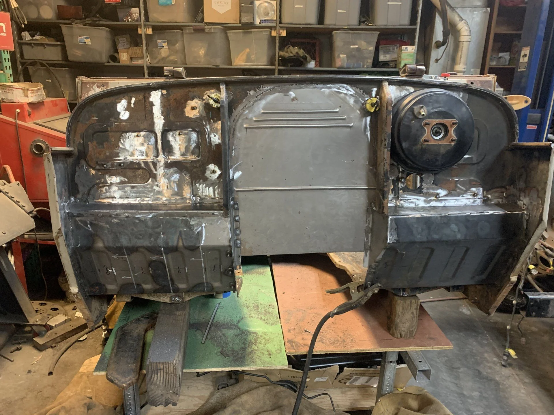

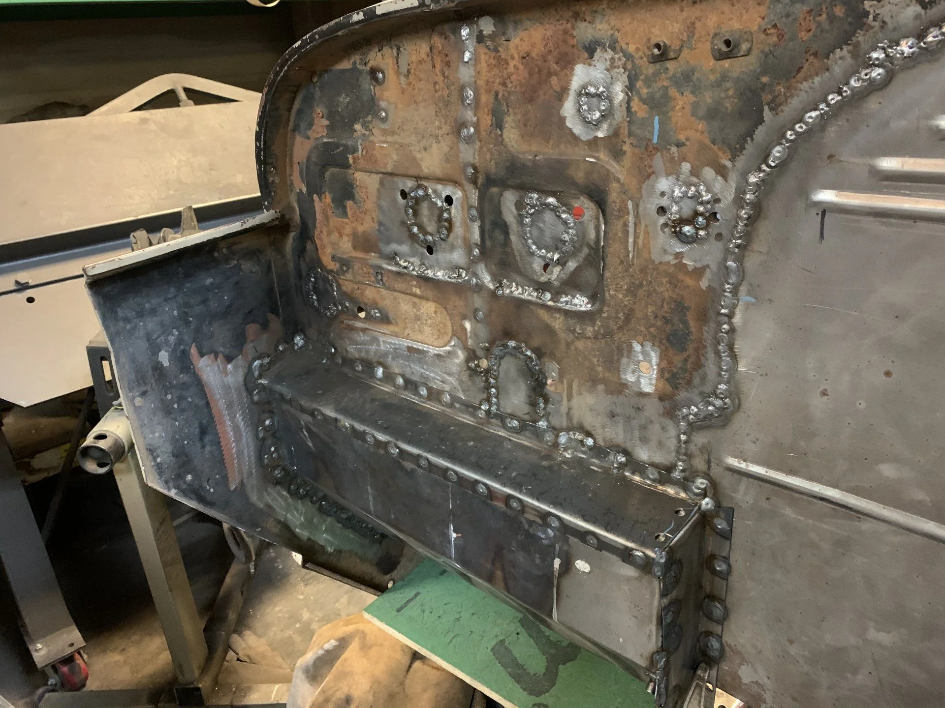

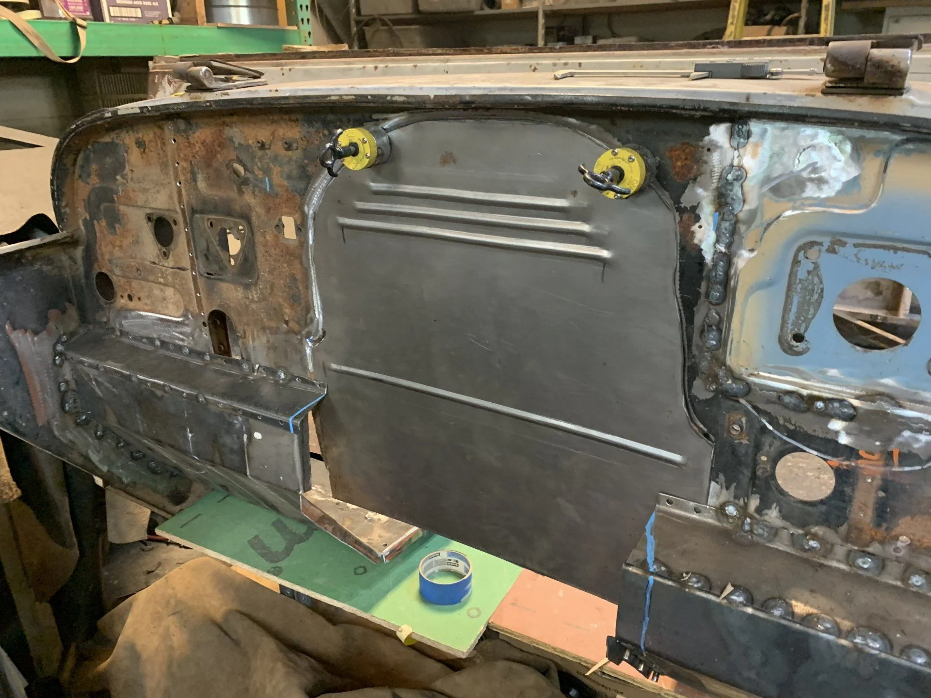

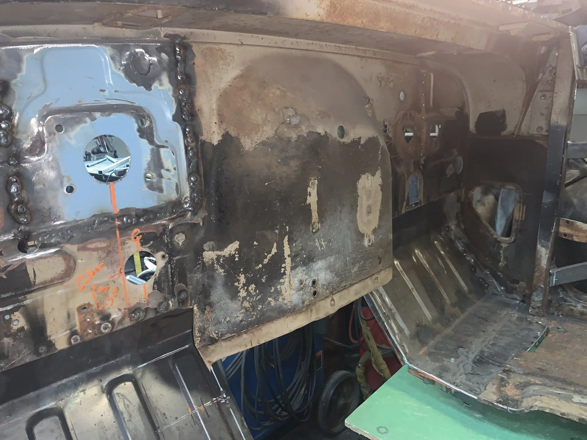

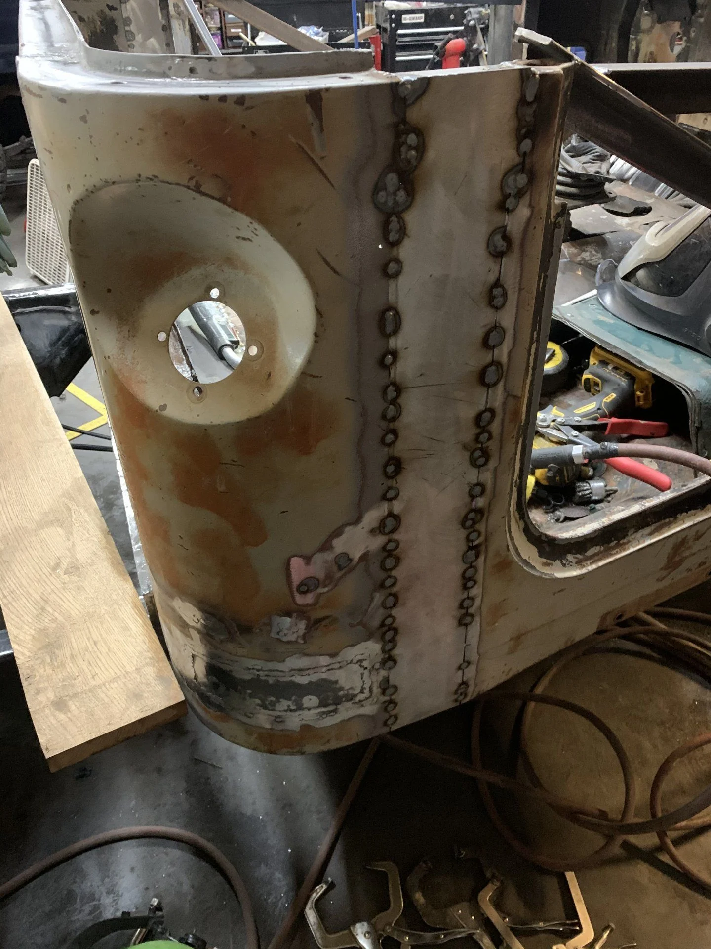

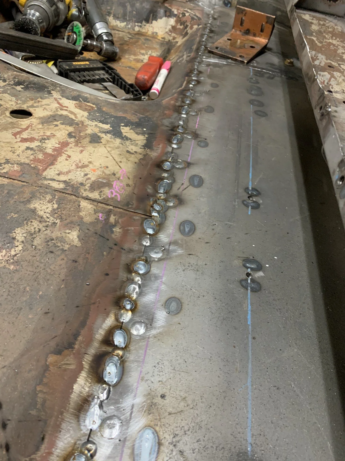

Tacked in place. Now I start working on Filling the dozens of holes.
I think I’m going to follow your lead on adding a few inches of legroom. Simple enough and my truck is already hodgepodged together so it doesn’t matter.

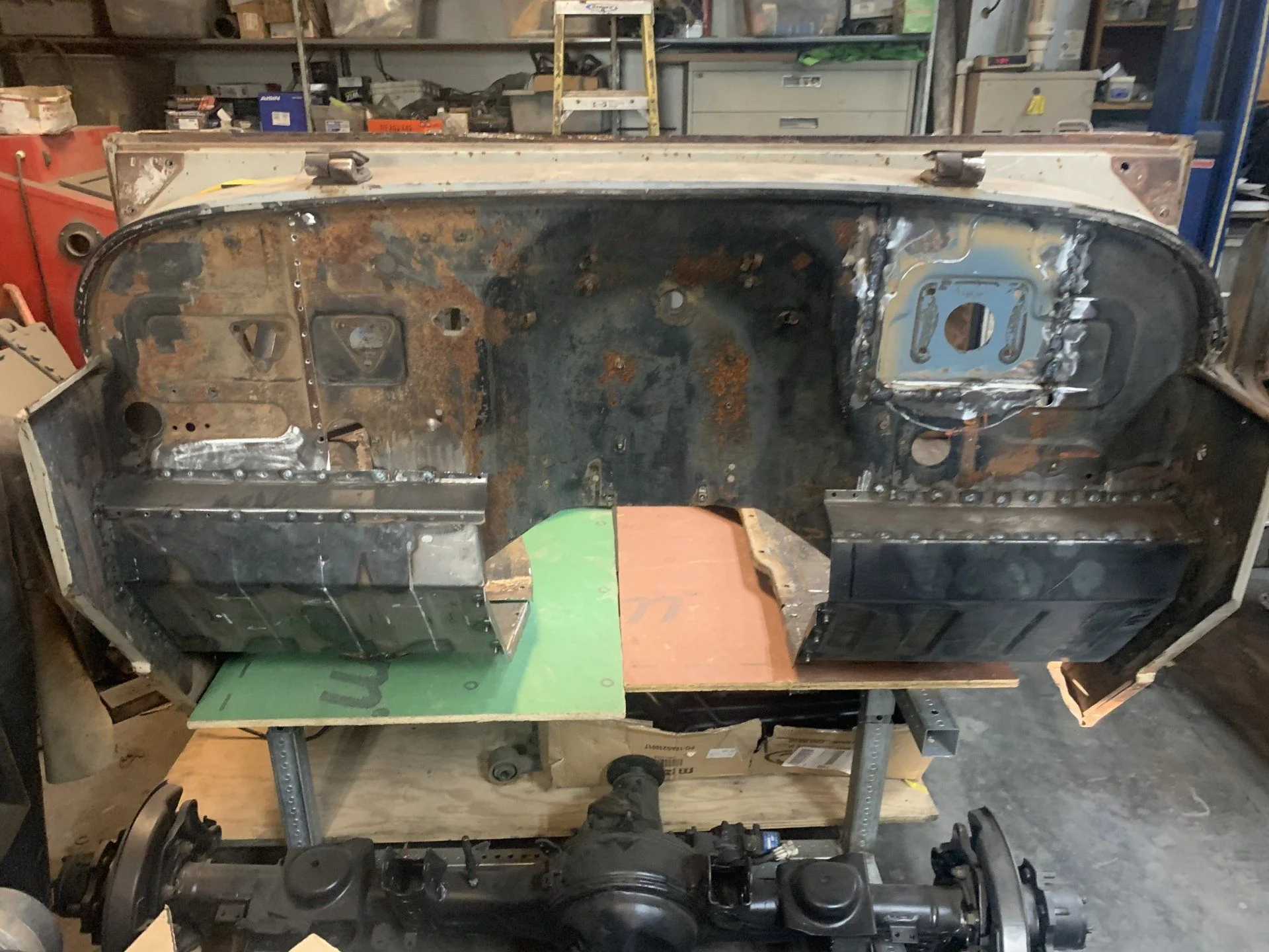

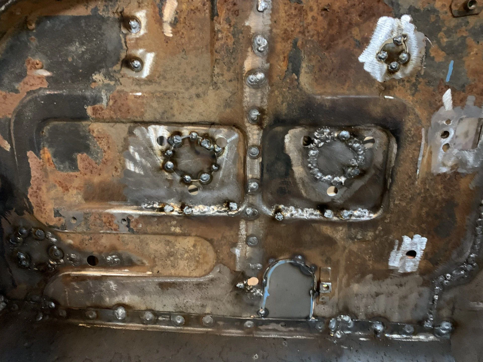

Starting to hate holes....
Did pick a set of later model door limiters on eBay
I just finished welding a bunch of holes on my frame. I hated the grinding and clean process more than the welding them closed. Good luck.

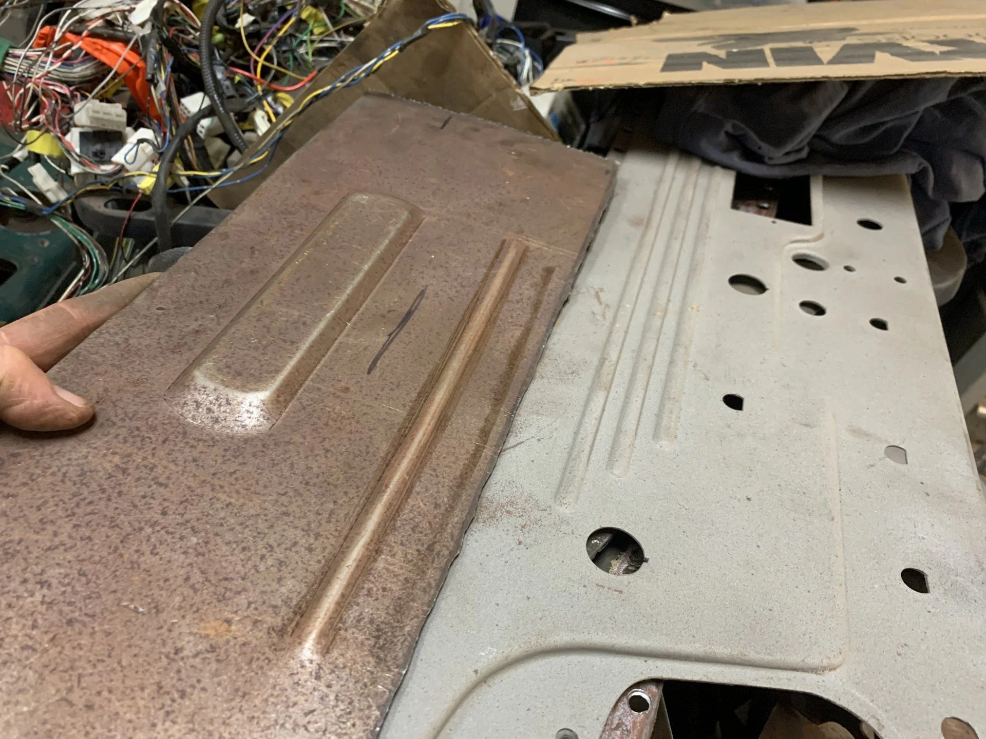

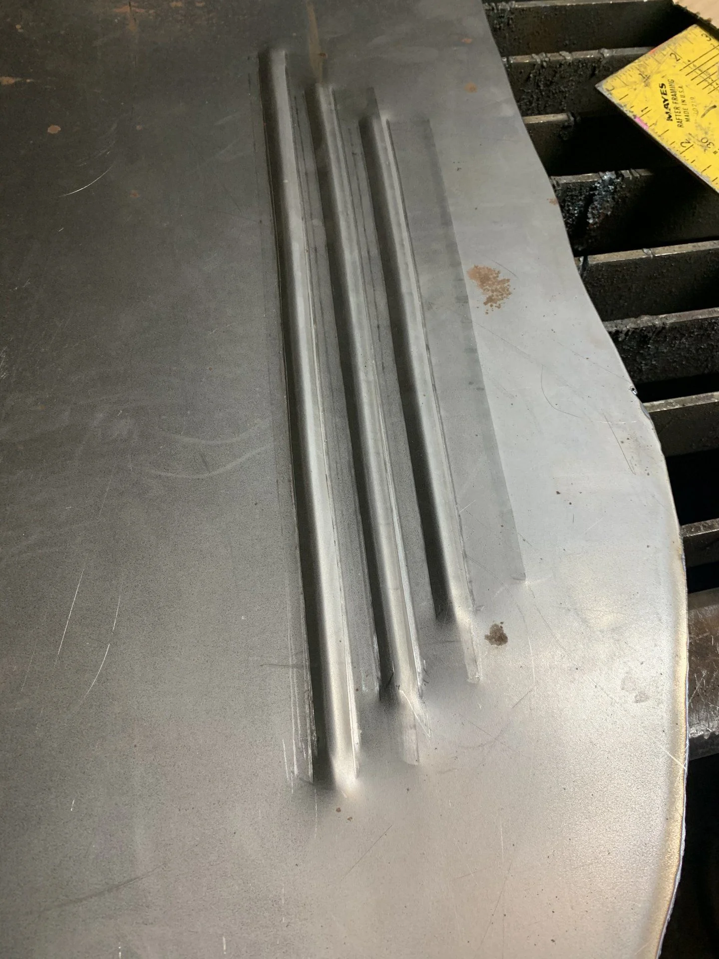

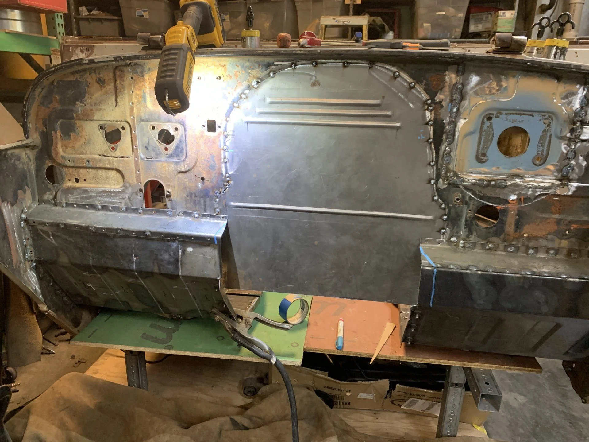

I like the ribbed panel you made for the firewall. Looks good.:beer::beer:

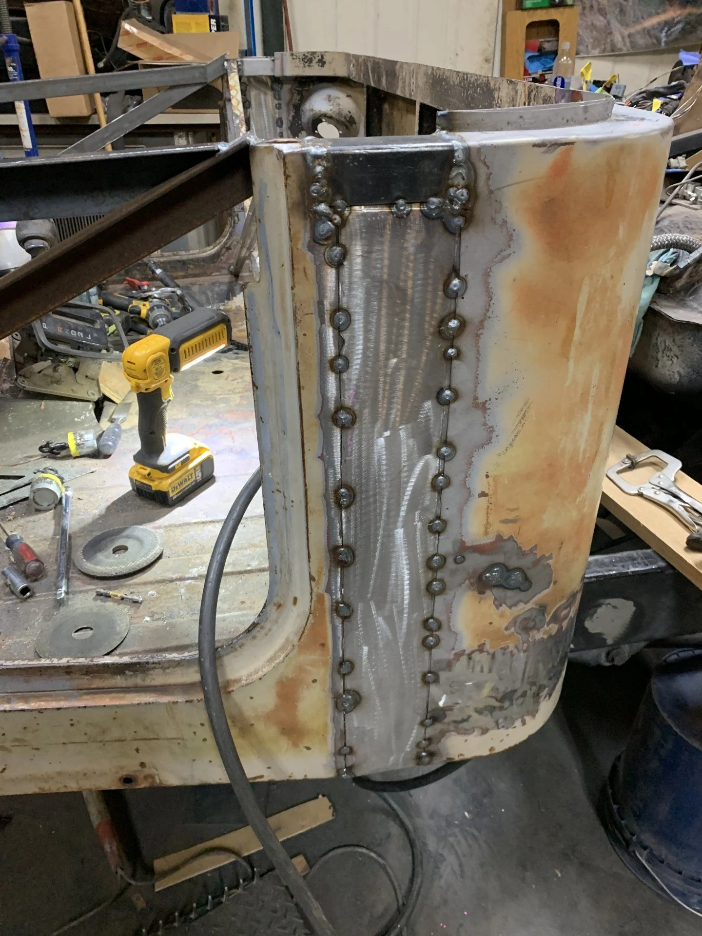

Yeah, way more work than I expected... got a little sunburn on my face as I kept tacking these holes without welding helmet on.... got the transition done for foot box out.

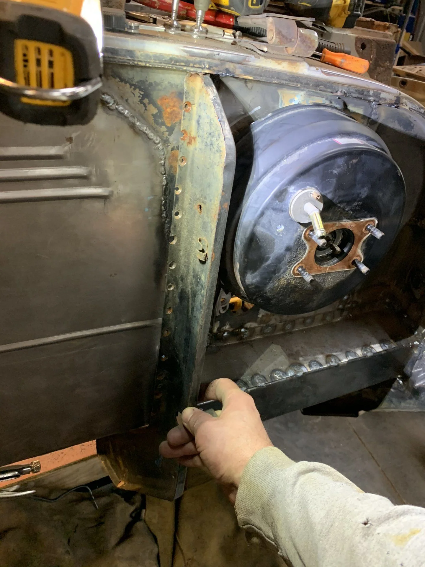

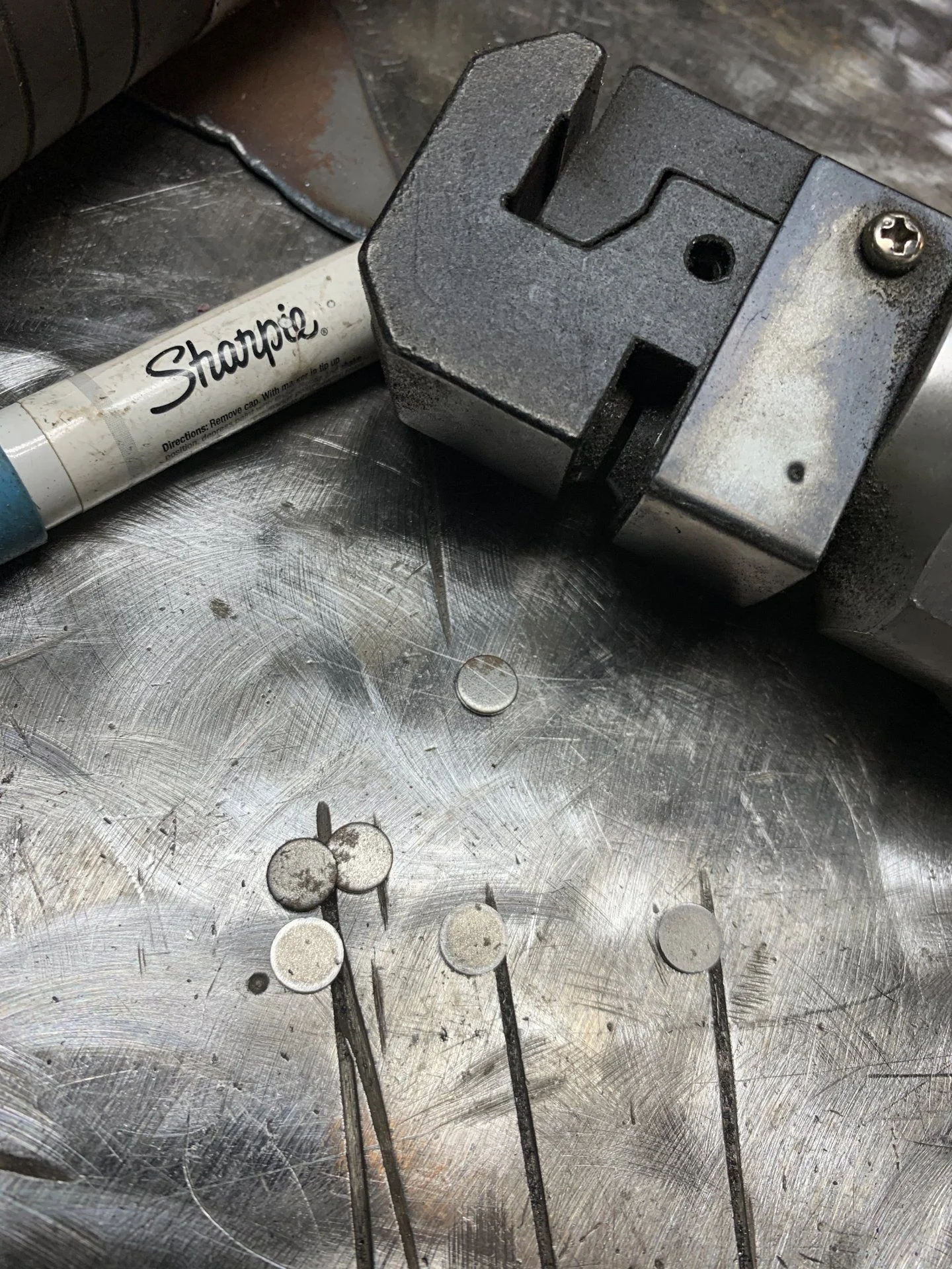

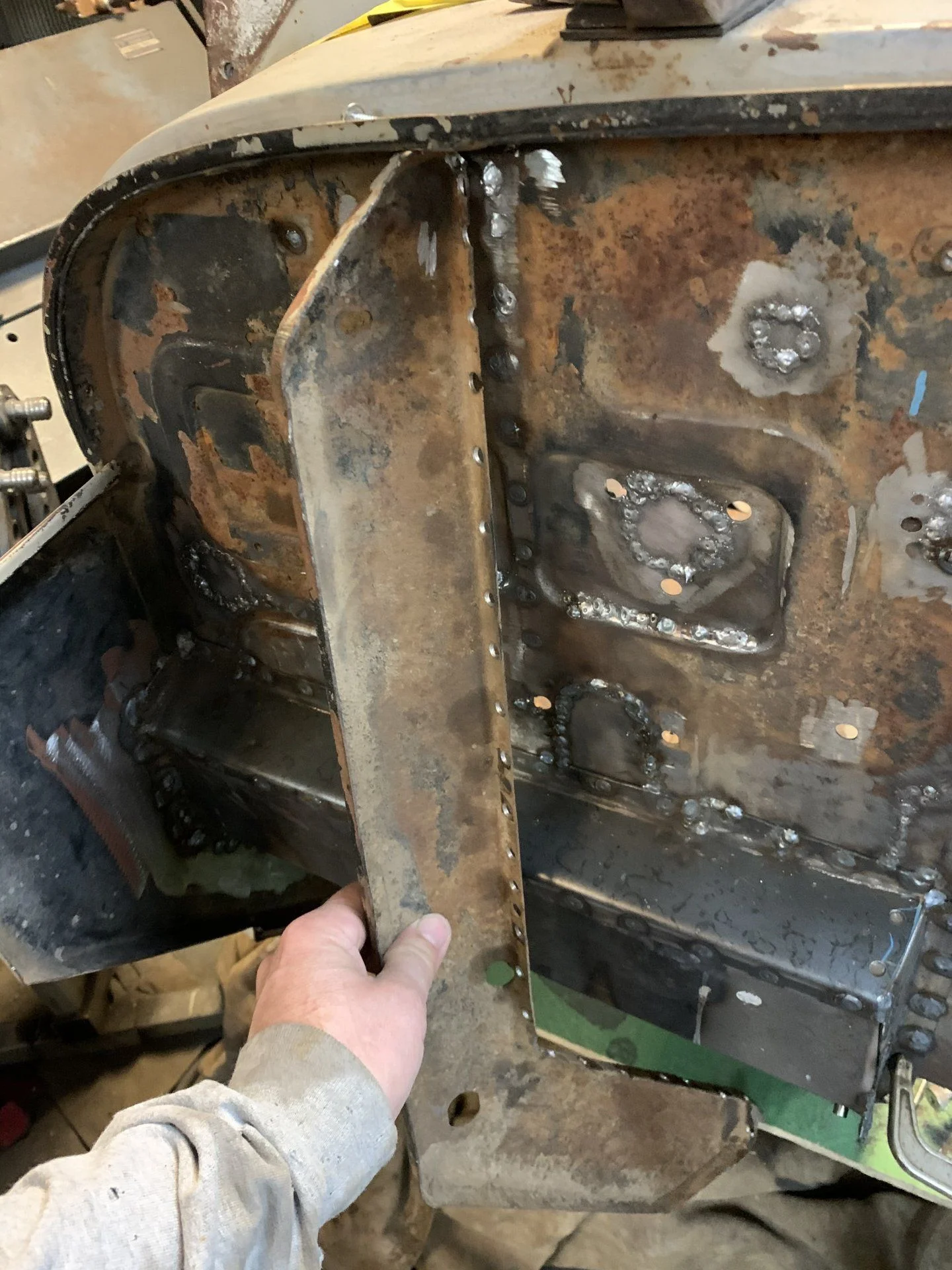

Realized my offset made good round plugs for smaller holes

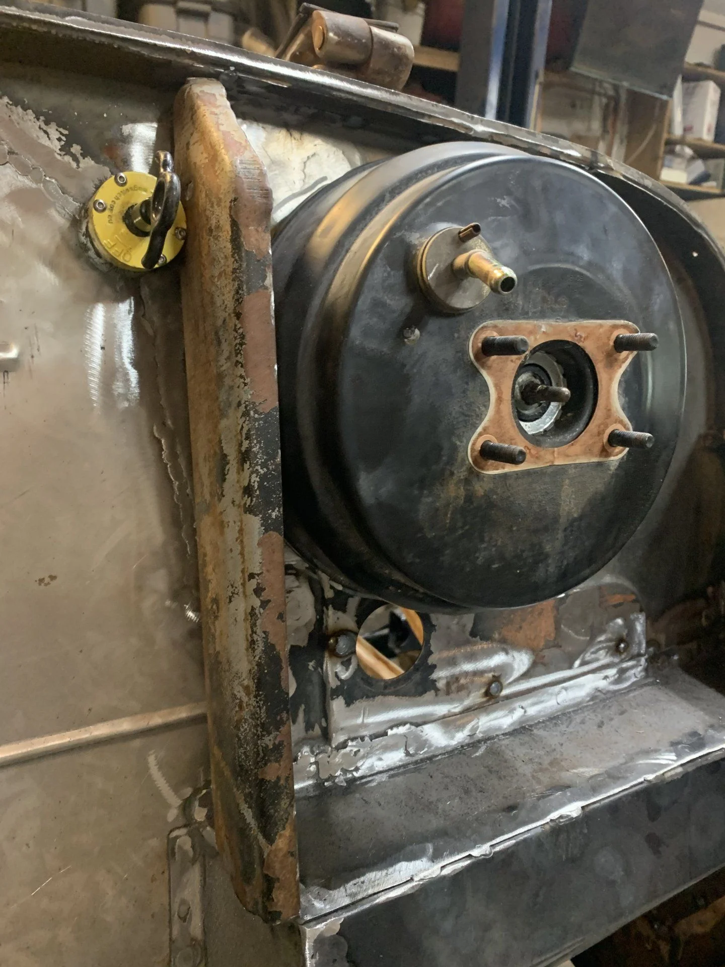

Thinking about putting rib back in, although the foot box made it much stronger
driver side might put rib on inside of master
Ribbed for , uhh.. yes the rib would look better.
Will tack them in then put the tub back on to make sure we have clearance from Clarence... quote from Airplane! that will released 40 years ago... things like that make me feel old.

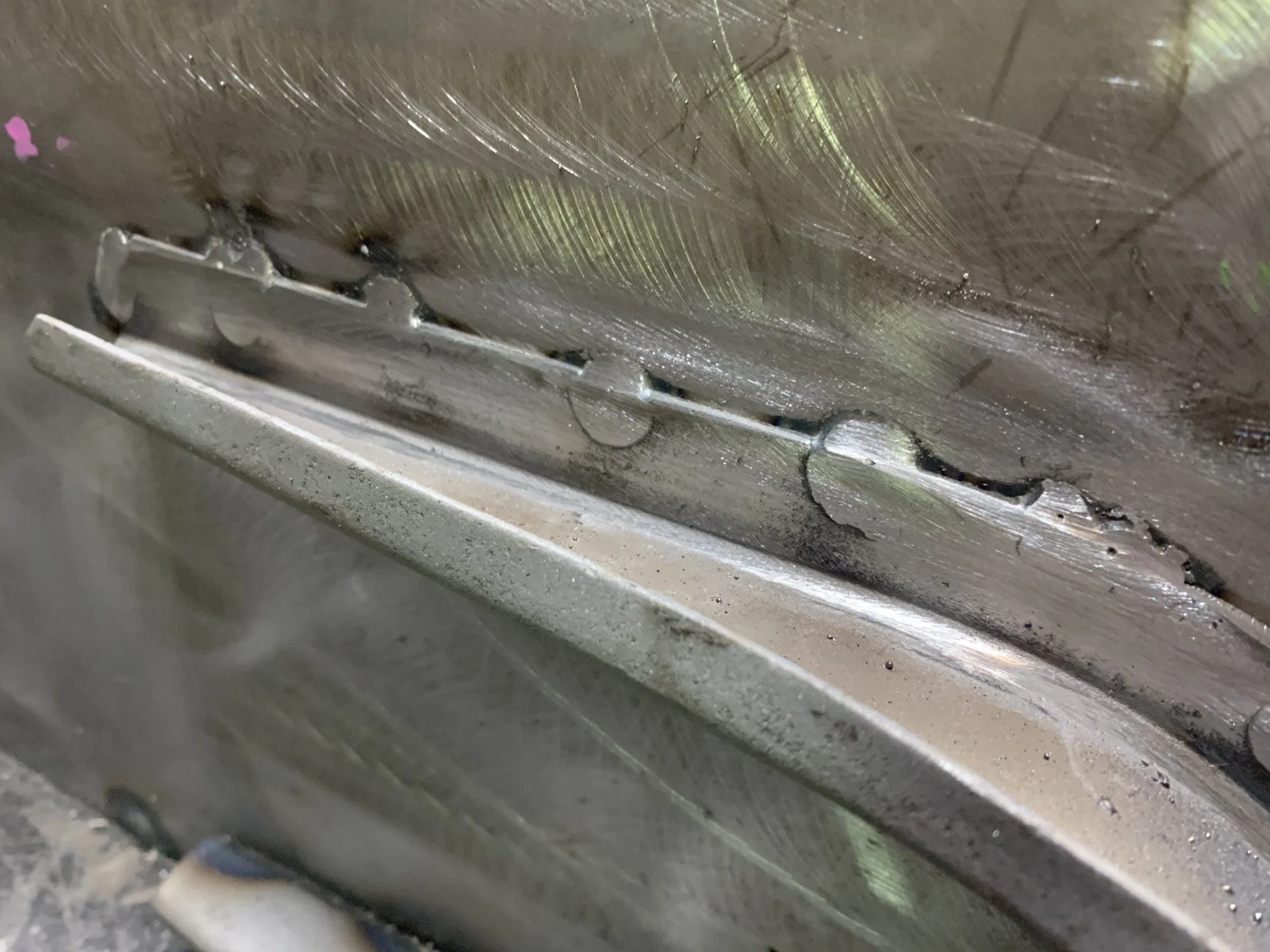

Filled last of the holes. Grinding and fitting... swapped sides of ribs to fit around the booster better.
