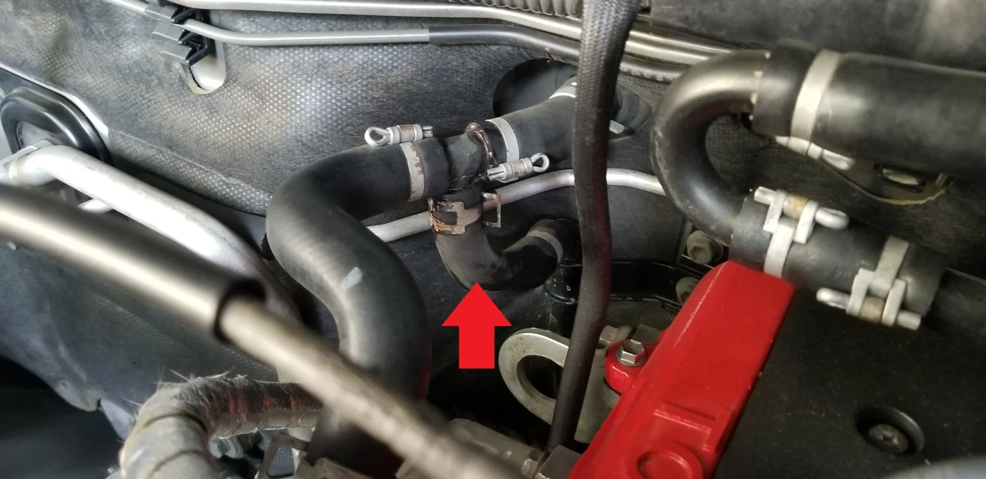

I mentioned earlier, somewhere along the way it changed. When you changed it, do you remember what kind of clamps it had on it? Were they OE like this?

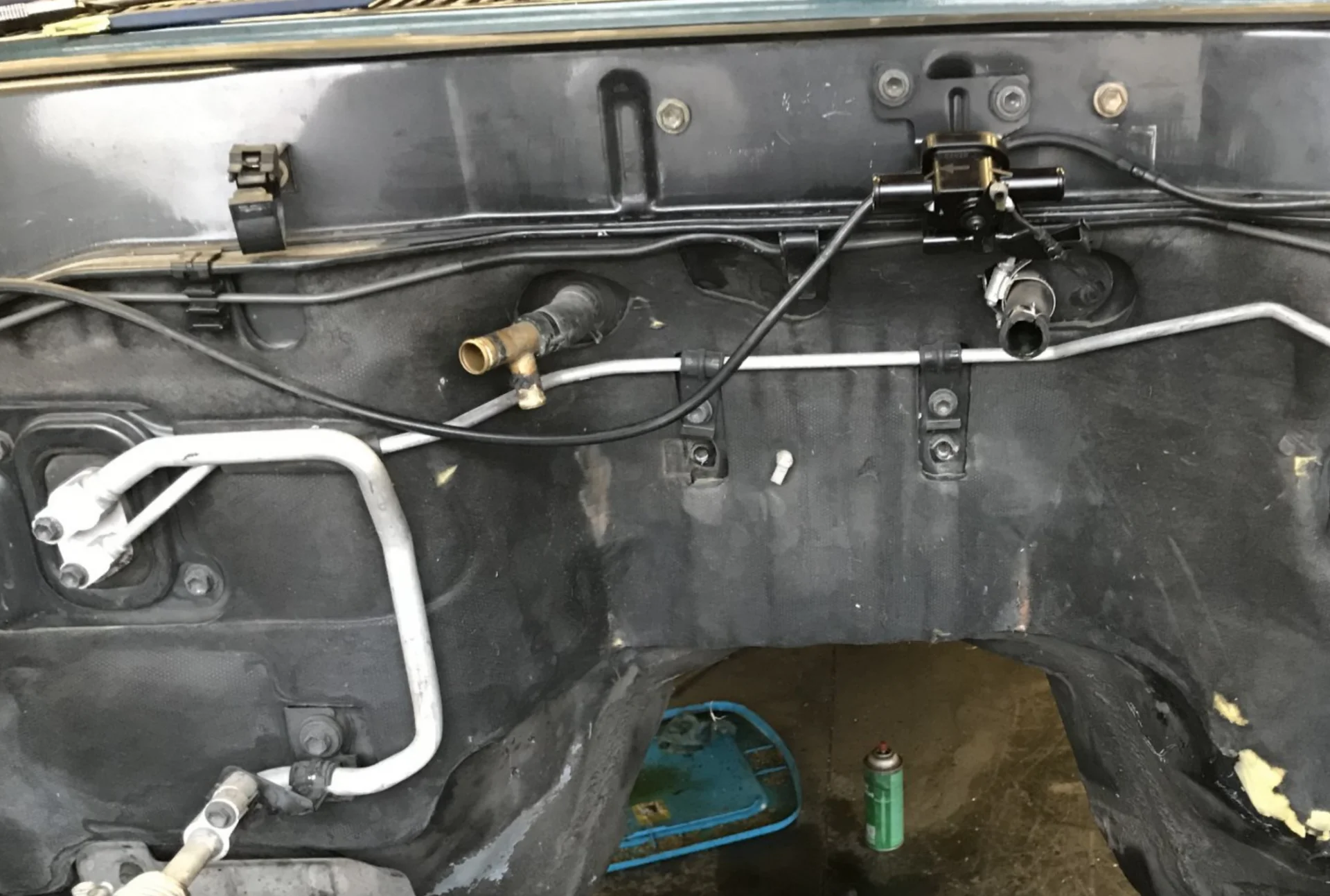

Here's a pic of @SNLC 1995 FZJ80 w/ brass Tee.

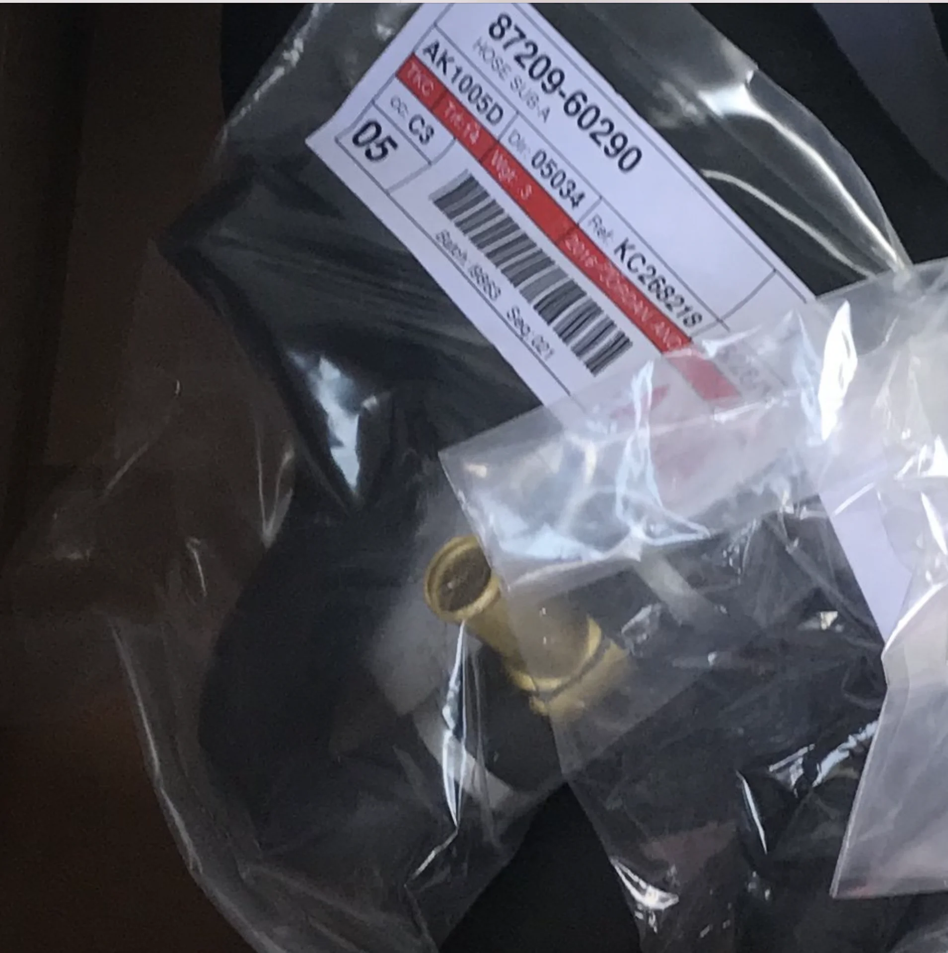

One more pic of 87209-60290 in the package with the coveted brass Tee. LOL.

So was the change from brass to plastic-- which would make sense based on the fact that the 100's have plastic. I will have to assume I just ordered a cheap plastic T with two expensive hoses I cannot use.
I guess I missed the caveat that Toyota eventually changed to plastic on the 80's- I jumped too soon.
Well, that last picture is dated/ordered May 2019.... so.... :meh: My guess is it will come as such.
And Super90's 80 series was a 1994 with plastic and SNLC's was a 1995 with brass. Toyota probably just used whatever parts they had on hand or could source at the time. I could only find two pictures of the replacement part assembly and they are both brass.

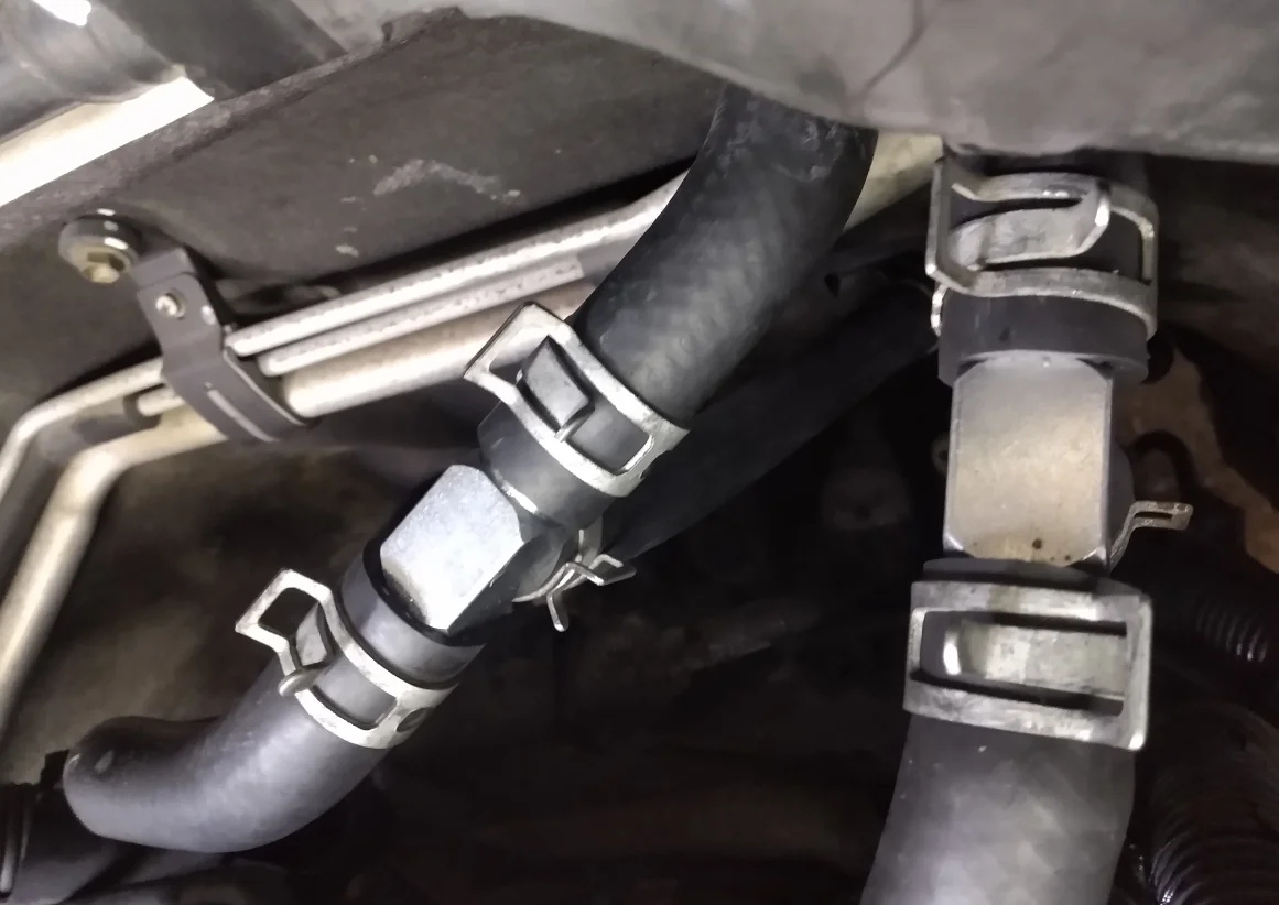

I am starting to feel hopeful that Toyota went from plastic to brass. I searched the 80 series forum and came across this from April 2021 where South Texas 97 shows his original hose set and the recently ordered replacement. If this is true then Toyota learned their lesson about using plastic Tees and switch to brass. Then went back to plastic for the 100 series. I can dream.

But what clamp to use. For some reason, on the 80's, the factory used the roll band clamp on the top legs and a spring clamp on the bottom. I assume because the top hoses come with the T and it would make for bulky packaging to use the large spring clamps.
Even though the brass walls are pretty thin I am going with my new spring clamps on all legs-- any thoughts from the forum?

My 4-seasons were weeping on the old hoses and I had to really cinch down the hose clamps to get them to stop. Yours look amazing with the new hoses and just the OEM spring clamps. If mine looked this good I would have not even begun to mess with them.
