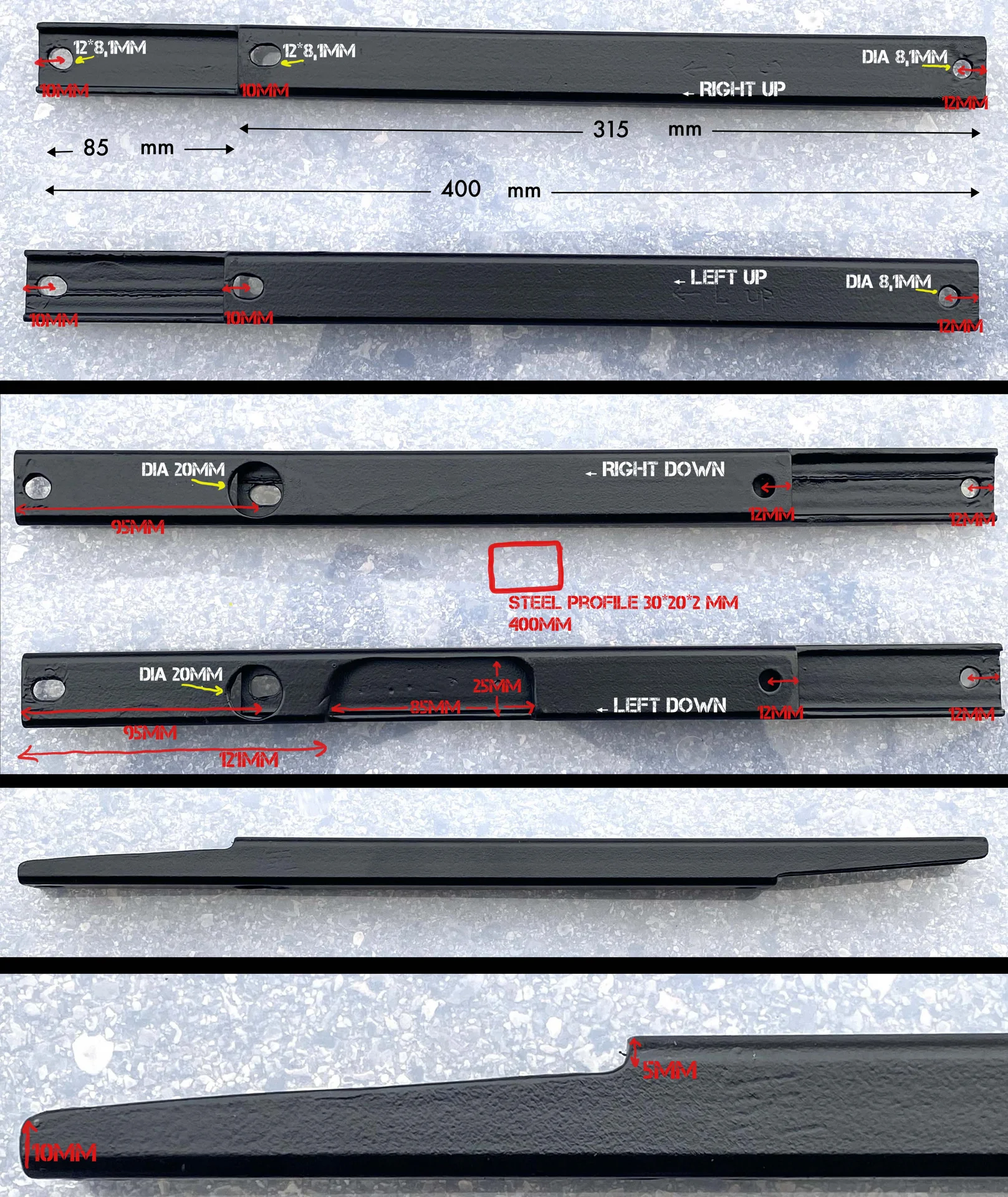

I’ve made my extension from the steel profile 30mm*20mm*3mm, I’ve checked the other dimensions (2 and 2,5mm), but 3mm is exactly right. Two profiles with 400mm length each (I’ve bought in Amazon precut profiles).
400mm profile provides exactly 8,5 cm extra space for the legs. It doesn’t touch the body in any position of the seat.
That’s my starting point - 2 profiles and a special tool for the 20mm hole - many shops have it. I also ordered extra nuts and bolts from Toyota (I like when it looks OEM).

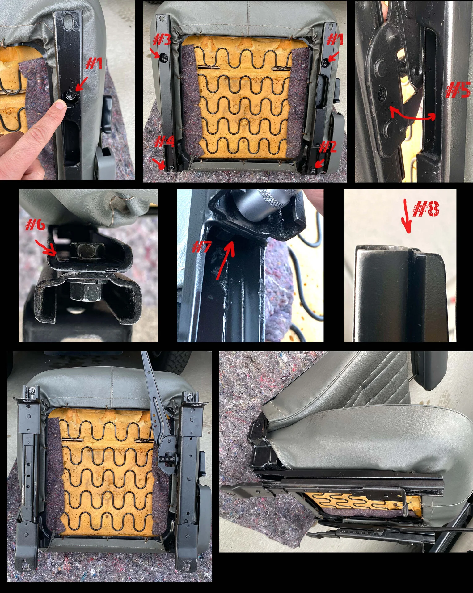

Step by step assemble

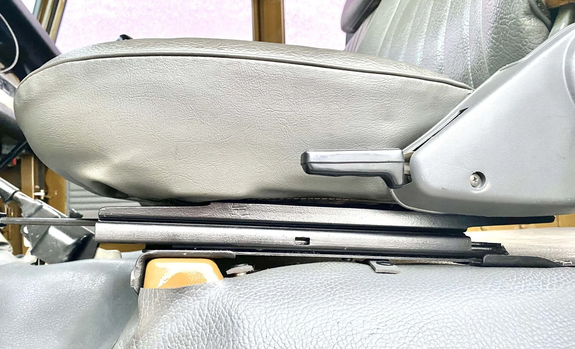

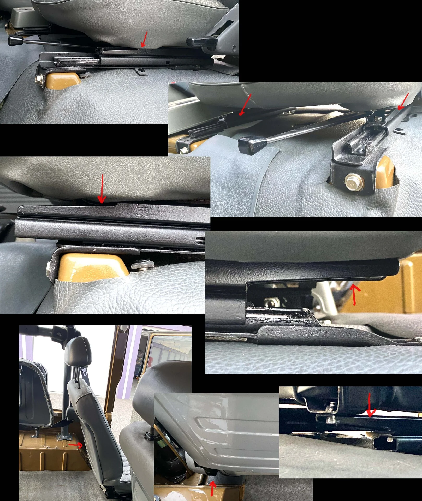

Few detailed pictures of the assembled seat
And the final look
