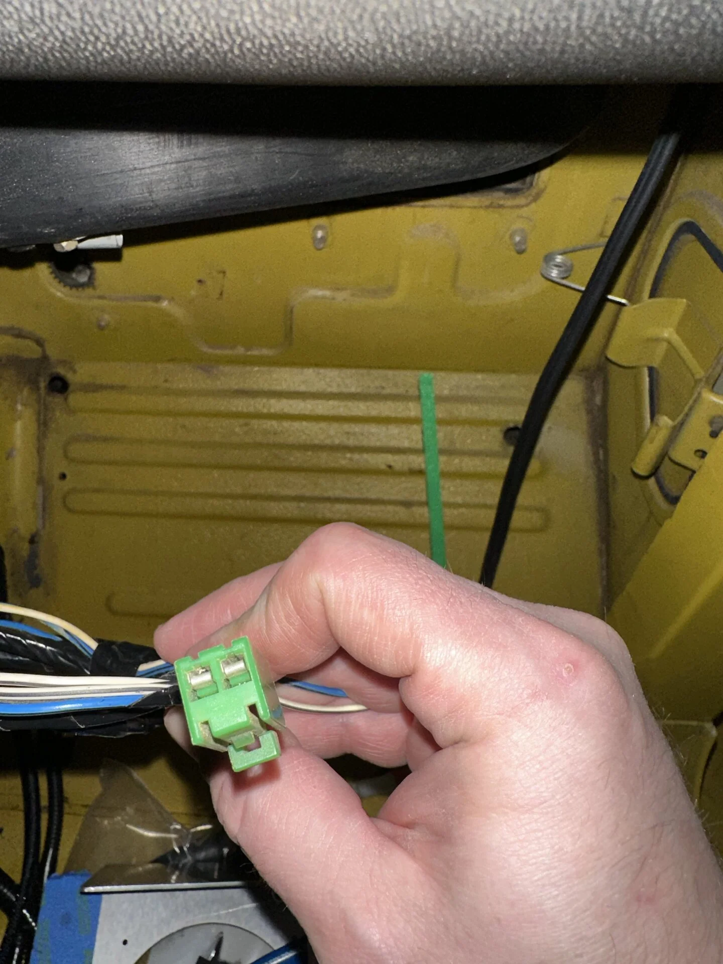

Hello, I have a wiring harness that runs along the trans tunnel and has 4 plugs in it that I am trying to identify.
One is for the rear heater
One is for the parking brake switch
One is for the seatbelt warning

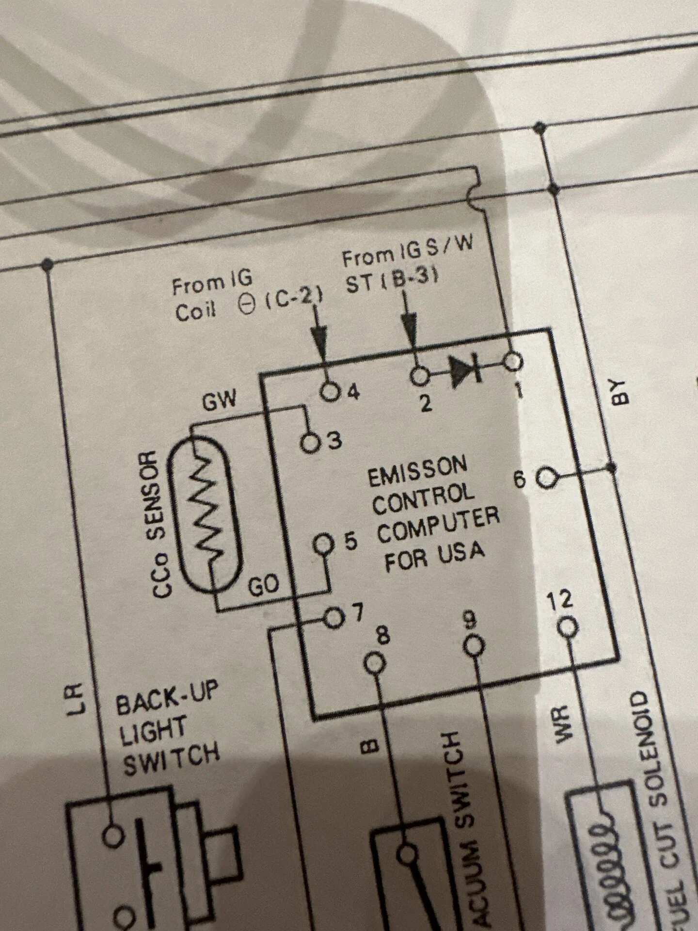

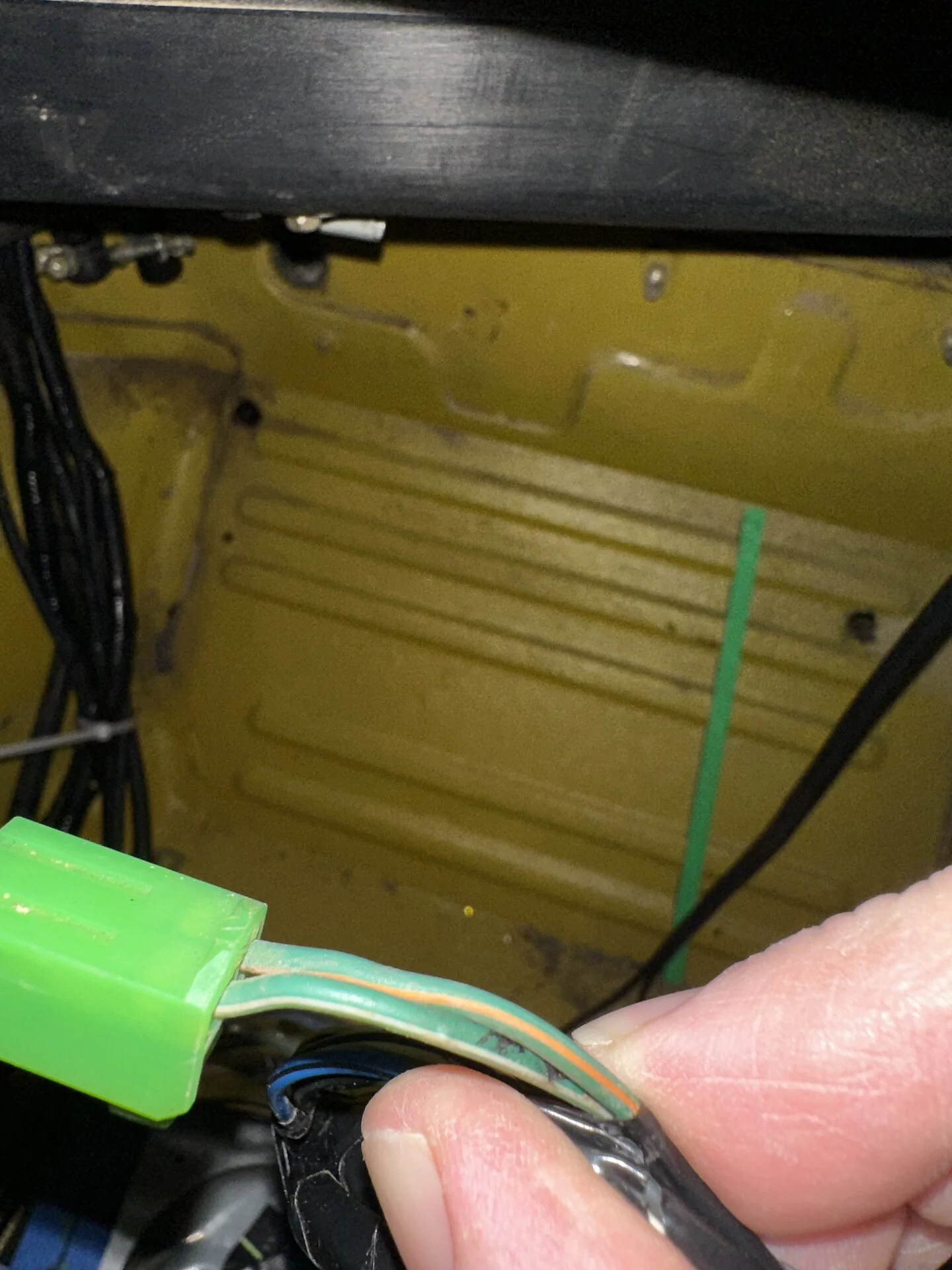

Then there’s this guy - green connector with green and orange and green and white wires attached close to the driver seat.
The only thing I can find is the CCo sensor which I assume is an early o2 sensor - is this correct? I guess I dropped through the tub floor versus going through the firewall?

is that the one that goes to that cat probe? WAG
You are correct. I posted this same question once. Should be a hole under the driver’s seat for it.
