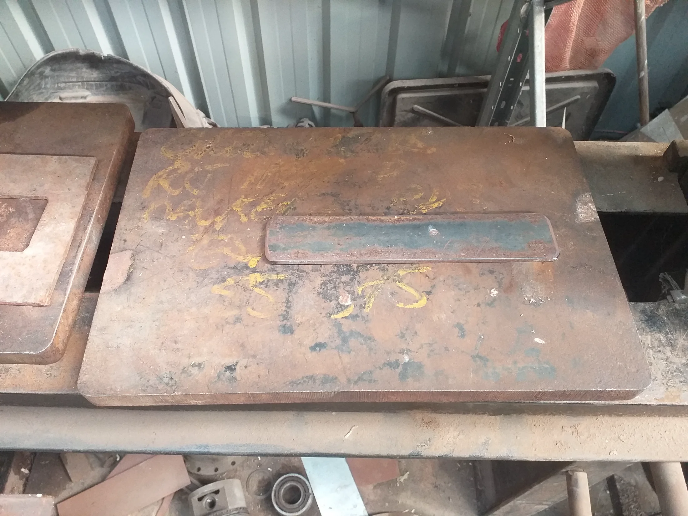

Yes, it's pretty simple and works well. I used a 15 ton press and made dies out of 2 x 1/4inch flat. If this is what you're wanting to do I'll see if I can post pics of the dies. Pretty sure I used 18ga, 1.2mm.

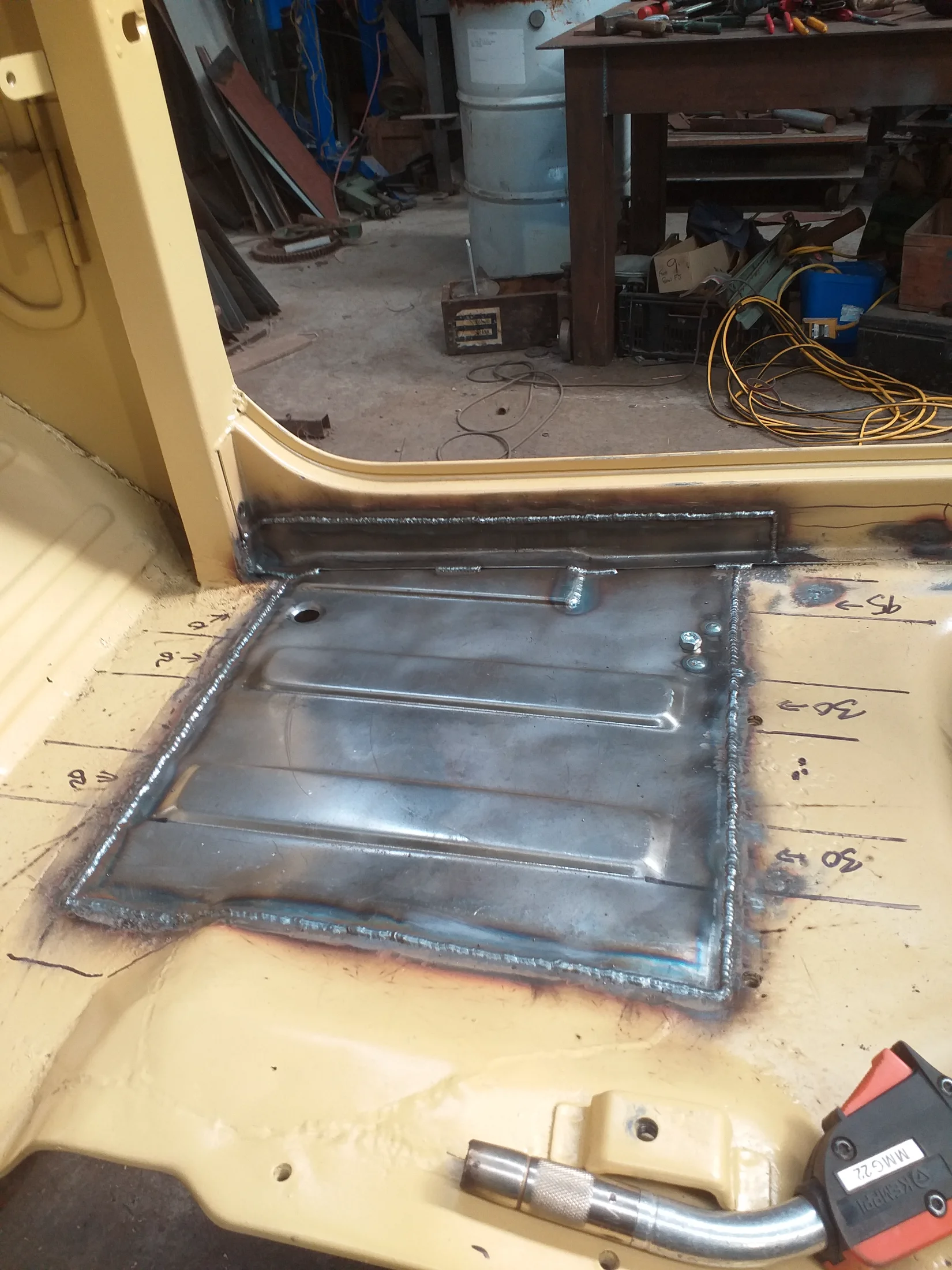

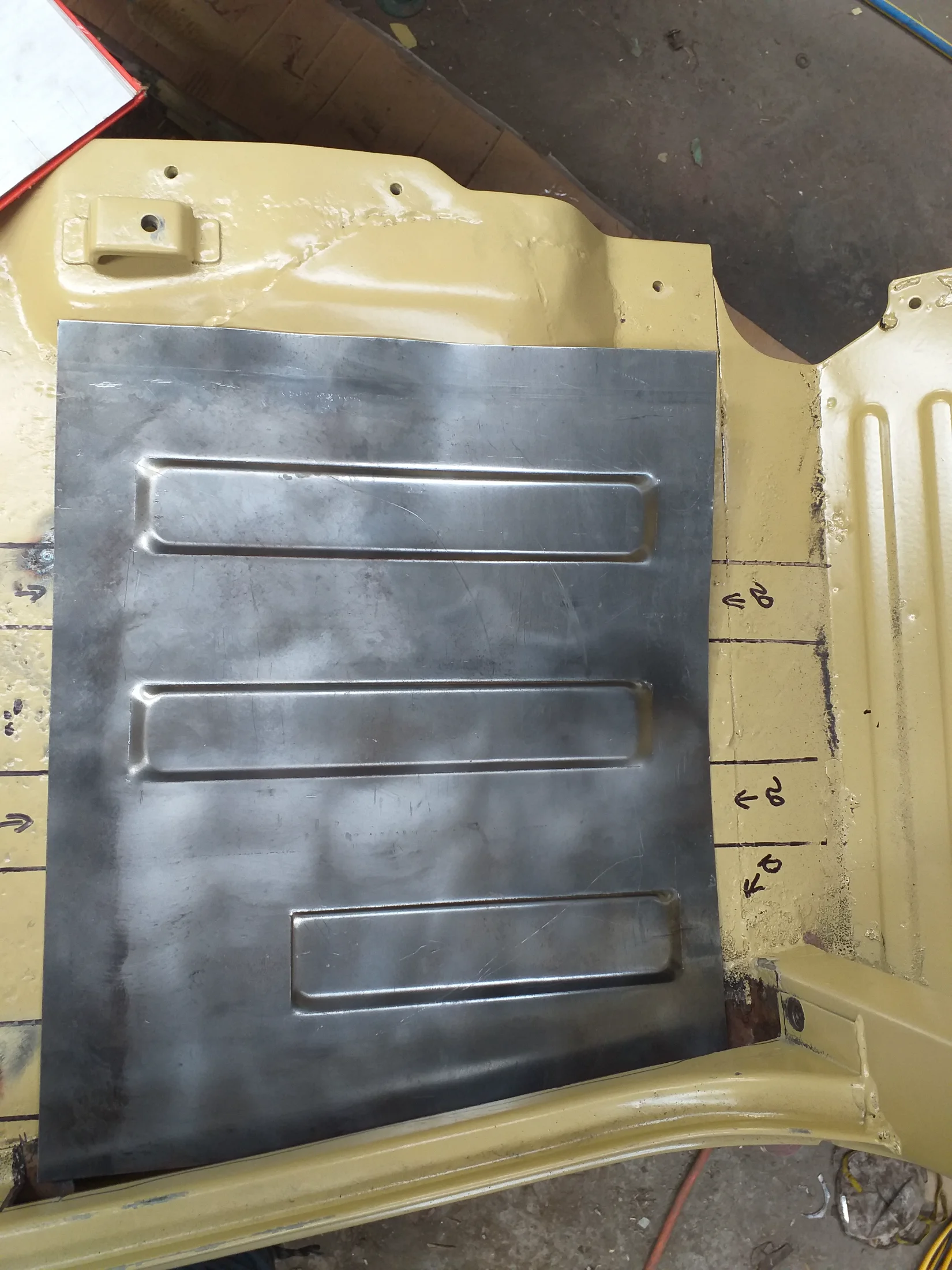

Here's pics of the dies, I bonded the flat shapes to the 3/4inch plates they're sitting on with mastic and aligned them by eye. Using 18ga you want 5mm gap down long sides and 10mm at each end - radius and smooth the corners well. I just tapped the blanking plate into the female die and shortened the male for the short pressing - I stuffed up here and misaligned the dies slightly which made a good louvre punch - you can see the weld along one end on the finished panel. Flat bar was 50x5 mm for the female, 40x5 male.
Here's pics of the dies, I bonded the flat shapes to the 3/4inch plates they're sitting on with mastic and aligned them by eye. Using 18ga you want 5mm gap down long sides and 10mm at each end - radius and smooth the corners well. I just tapped the blanking plate into the female die and shortened the male for the short pressing - I stuffed up here and misaligned the dies slightly which made a good louvre punch - you can see the weld along one end. Flat bar was 50x5 mm for the female, 40x5 male.
