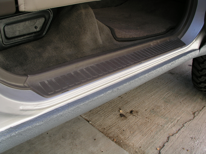

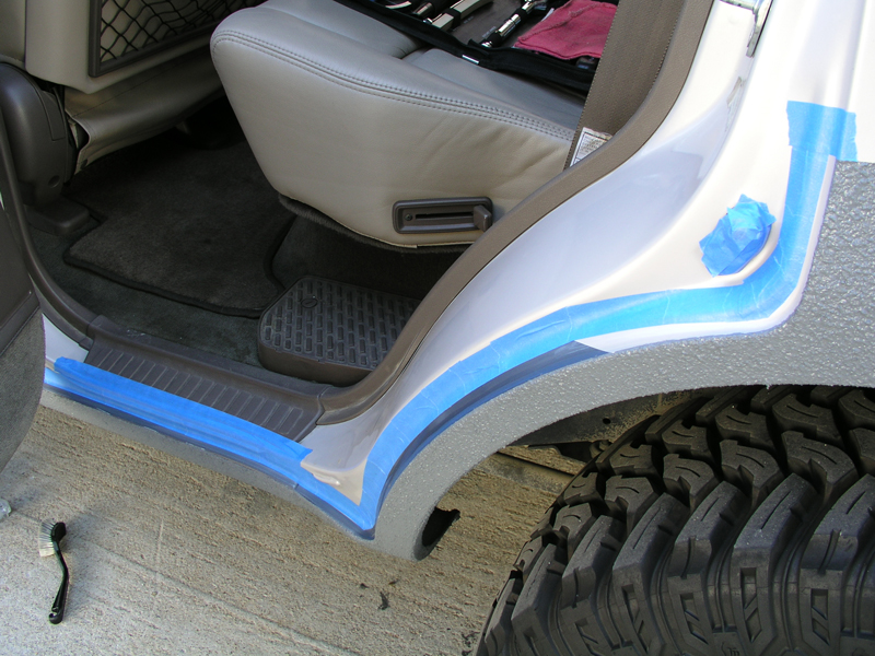

You will want to go back and do the door jambs. You need to get some product to wrap onto the door sill or you will have a problem with it peeling. Trust me I know.
