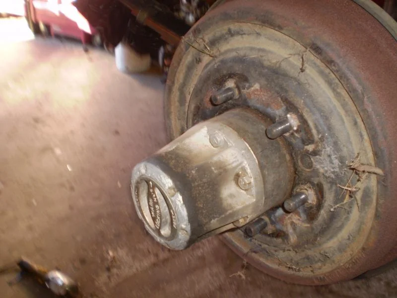

Called me based on someone's recommendation, and I sold him a front disc conversion, used FJ60 components.....
I used the starter bushing to make the tie rods fit the FJ60 arm......

Everything from the axle ball out, are from a donor FJ60 except the Warn hubs, he wanted to keep the old school look on the hubs.
Inner axles are fine spline, outer birfs are the fine spline FJ60

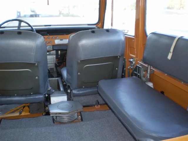

The seats can be fixed by lying on your back in the back and pushing up on the corners of them with your foot. Ask me how I know.

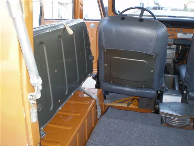

The AC case was poorly mounted and the plastic case was in pieces.....so I made a ''cradle'' to hang it in...
See the shiny aluminum band running under the AC unit?
I was gonna paint it black but it looked so nice I left it natural.
