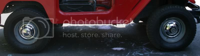

I have a 71 with drums all around and stock steelies. If I go to discs up front what are my options for front rims? Is there a matching disc rim?
Here's what I have...
pickup 76-79 disc brake wheels, for all 5 wheels
Thanks, that's kind of what I figured. I really want to keep the stock look. Off to the parts wanted section...

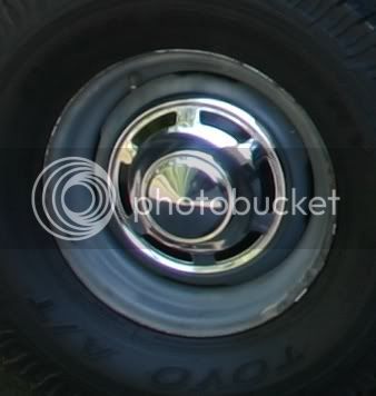

They should be early riveted rims. Can you tell by looking at this close up, or is its some you need to take the tire off to see?
Have you looked to see if you have the rivited (early to 8/75)or welded (9/75 and on) wheels?
I would check before you go buying more rims. I have had rims from an FJ40 that were datecoded(yes, there are stamped datecodes on the wheels) in mid '73 that were welded style, and fit with discs. pull one off, check to see if its riveted or welded and maybe you wont have to buy more wheels.
How can I tell?
How can I tell?
Take the wheel off the rig and look on the back side. The center section will either be welded or riveted to the outer section.
