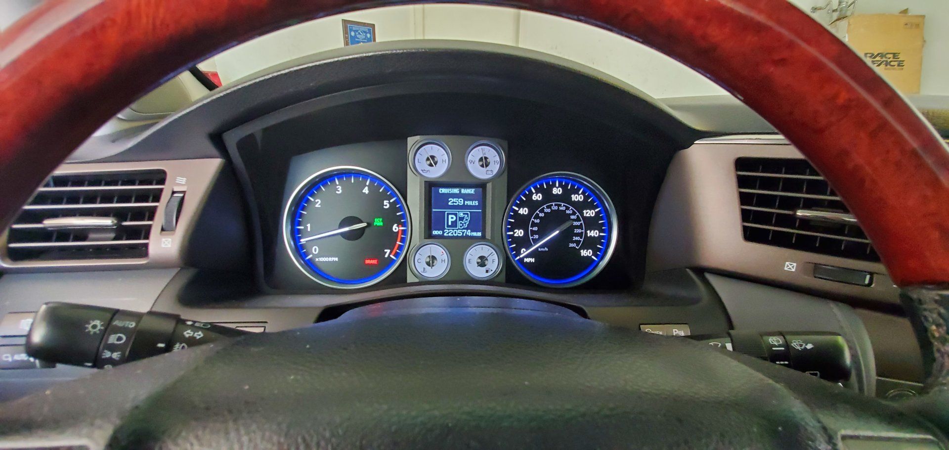

Today I attempted the first steps into getting rid of the AHC/AVS systems, I think I was successful. I still need to do some more testing to make sure warning lights don't come on, like taking out the shocks.
Here is what I did:
Put vehicle in low mode(didn't know what was going to happen, so I figured this was the safest setting to be in)
Disconnect the battery
Pulled the AHC relay in the engine compartment fuse box.
Pulled 2 ACH fuses and 1 AFS fuse from the passenger side fuse box.
Disconnected the AHC ecu in the back of the vehicle.
Waited 30 min.
Reconnected the battery.
The little lcd screen no longer shows the vehicle height position and no warning lights. The AHC/AVS levers and the off button don't do anything nor do the lights come on when toggled.
I drove it around the block up to 25mph without any warning lights. I was checking to see if it would try to raise itself up and throw an error.
I then disconnected the battery and put everything back together. All systems functioned as normal.
