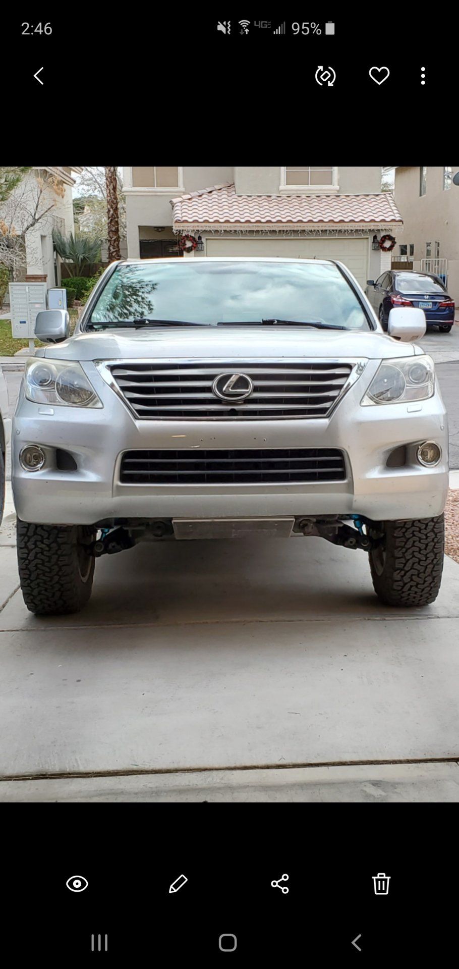

I think I need to lower this a couple inches. :)
I only backed it out of the garage, I need to install the rear stuff now.
No warning lights :p

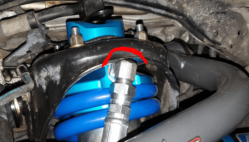

I need to figure out what to do with this. The reservoir elbow is binding witht the coil bucket. I already ground out some of the coil bucket and removed some material from the elbow.
From the pictures I have seen of the Tundra, their coil bucket is smaller than the 200. I guess I'll grind more out of the coil bucket.
Maybe cut this shape out and weld in a section of a tube.🤷‍♂️

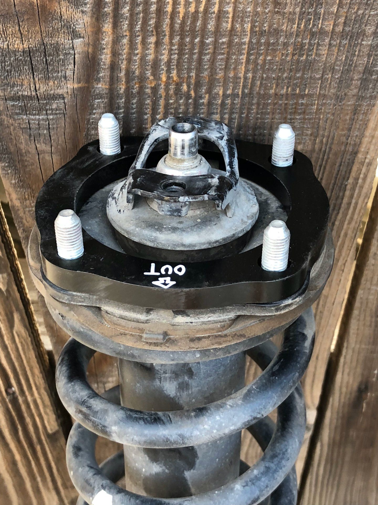

@turbo8 Do you have one of the front OEM struts disassembled?
Need some measurements of the factory front coil spring.
Free height -
Top of coil inside/outside diameter -
Bottom of coil inside/outside diameter -
Exploring aftermarket spring options for my LX570 while retaining AHC.
