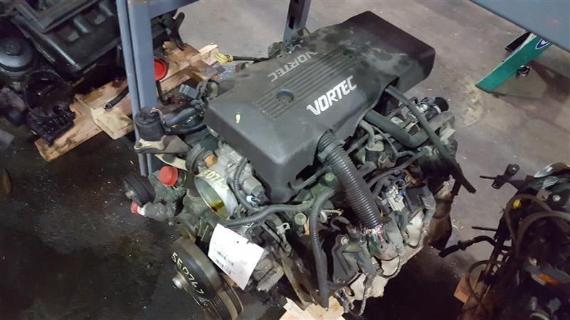

4.8 LS engine is on its way, 78,000 miles with video of it running and video of a compression test. Stupid cheap and shipped to my door. I think that soon these will be the next hot item like the 5.3 is now, so I'm happy to have gotten one while they're still inexpensive.

Speaking of Vortec:

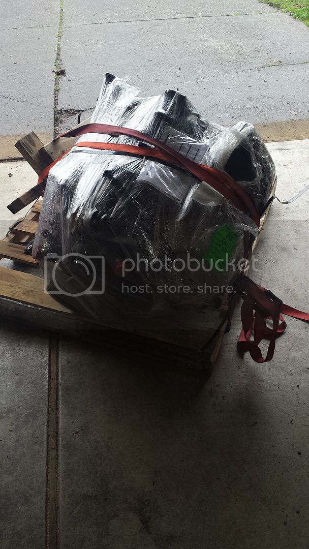

Engine arrived today, although I was not happy with the packing job from the seller, but for what I paid shipped to my door I can't really complain. I'm going to replace the oil pan gasket while I have it on a stand, but other than that I think it'll be good to go.
