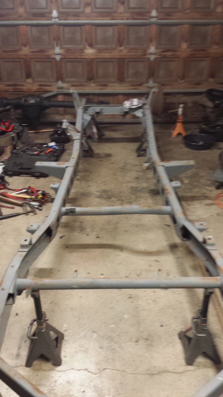

My friend had a spare frame, so rather than deal with all of the cutting off of the PO's suspension and steering box mounts, I'm going to start with a fresh unmolested frame. Hoping to get it home in the next day or so, and I'll cut off the front suspension brackets and start things for the 4x4labs saginaw conversion kit.
A nice clean frame, ready for building upon. I'll clean off the shock towers, step mounts, front spring hangers, engine mounts, transmission mount, and rear shackle hangers in the next day or two. I'm also hoping to have the rear spring hangers mounted and posibly the outriggers done in the same timeframe.

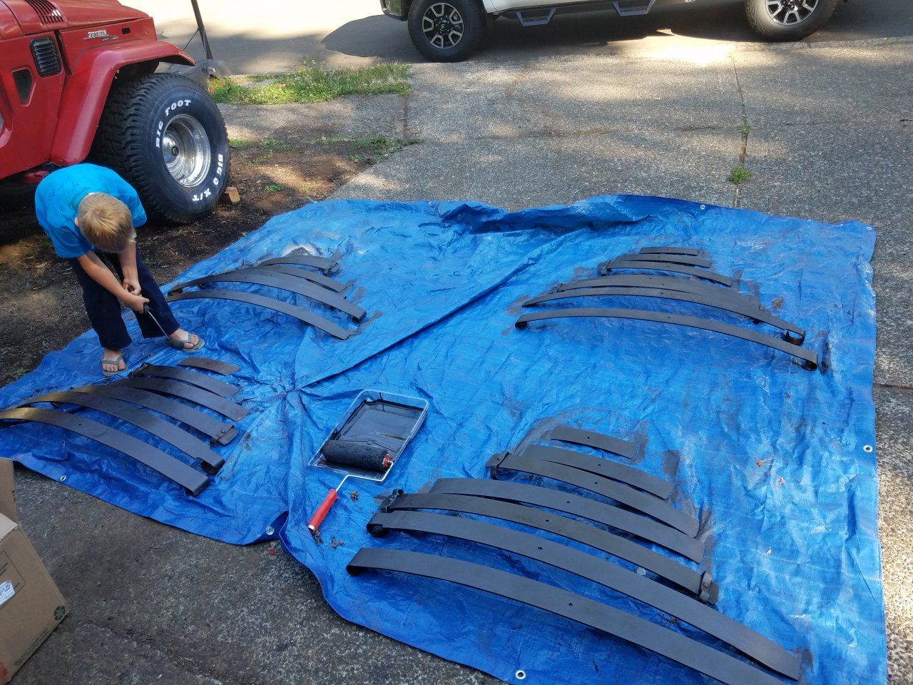

I've had so much going on with the truck that it's been a little hard to keep up with everything I've done. The front bumper/cross member is 80% burned in along with 4x4labs saginaw conversion kit. Spring hangers are 90% burned in, I just haven't had time to tear the springs down for my son to paint with graphite paint. Axles are pretty much ready to go (I couldn't get a pattern I liked on the front, so brought both axles to a pro. He ended up telling me the front was just about spot on and he only had to change the depth a touch. Money well spent for piece of mind).

Rear spring hangers are burned in, but I have to wait on some spring isolators before I put the springs back together. I've used SLIP before and had great results (plus it's phenomenal corrosion protection), so I'm using it here.
