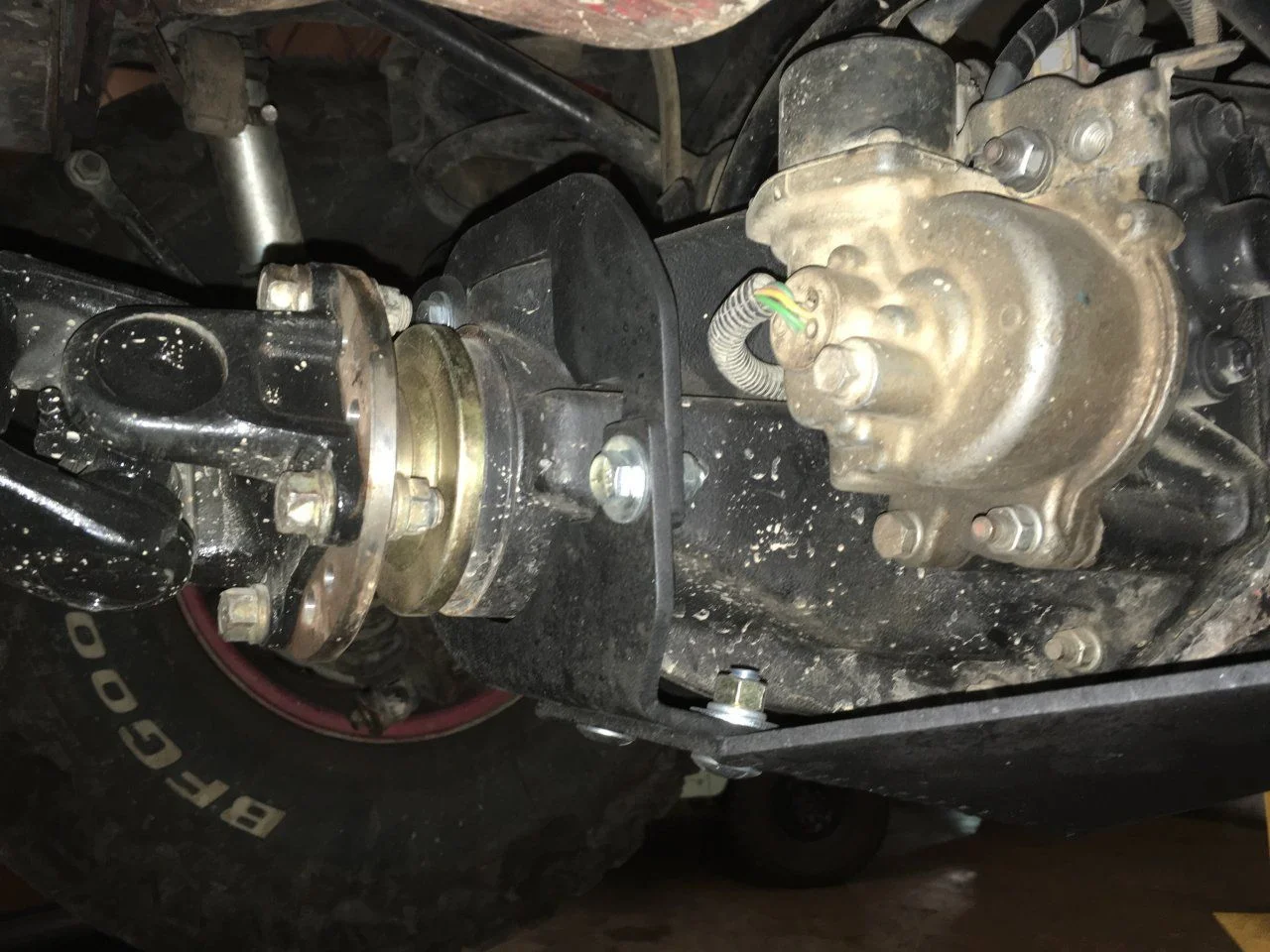

Got my Budbuilt in July I know Bud still makes them. Ive been very happy with mine
The RCI I installed last month...
