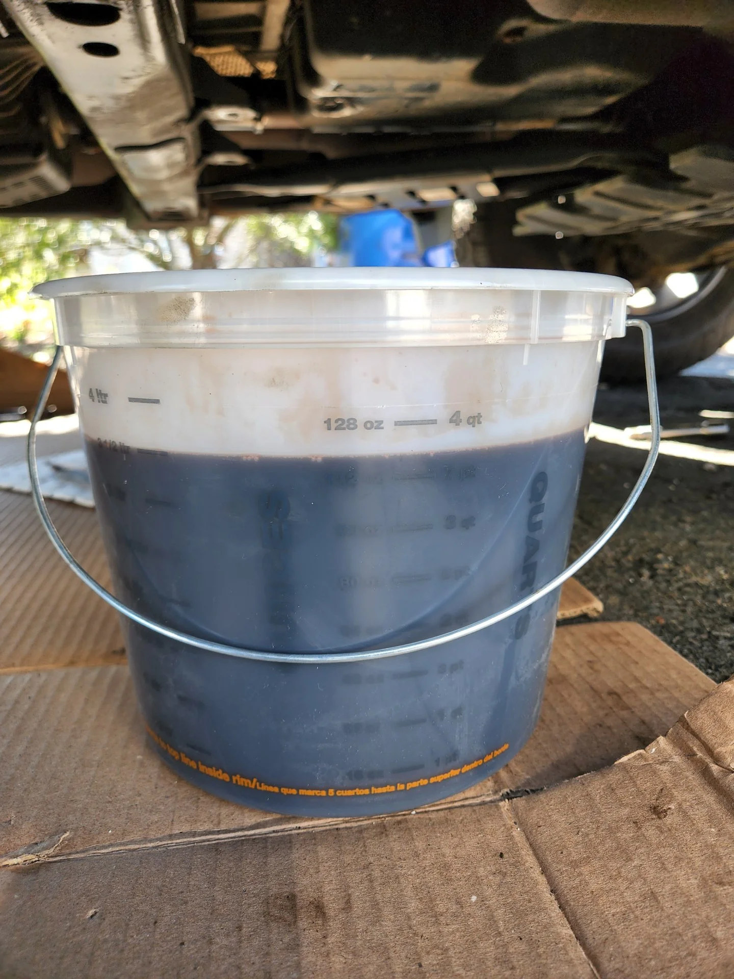

I recently changed the fluid on my '08 with 257k miles on it. I have no record of this ever being done, and it definitely hasn't been done in the time I've had it (4 years and the last 55k miles). Before the change I had some occasional mushy shifting, and in the morning it took 10 seconds for the transmission to "grab" when put in gear the first time of the day. A complete fluid change remedied these issues. I think Toyota deems this a lifetime fluid as in the lifetime most people expect from a vehicle. As second and third and fourth owners take advantage of the incredible longevity of these vehicles, there's no way any transmission or fluid can stand up for 15 years and 300k miles without some degradation....
Thanks for the post. Demonstrates an objective deficiency in performance that was rectified with ATF change. Exactly what I was curious about. But, I wonder if there would be any other vehicle that could make it this far with so little degradation? Still seems pretty durable to roll for 257k and just have minor problems. I wonder what that fluid looked like after 14 years!
The fluid was pretty dark, but not cloudy. Didn't smell burnt.
